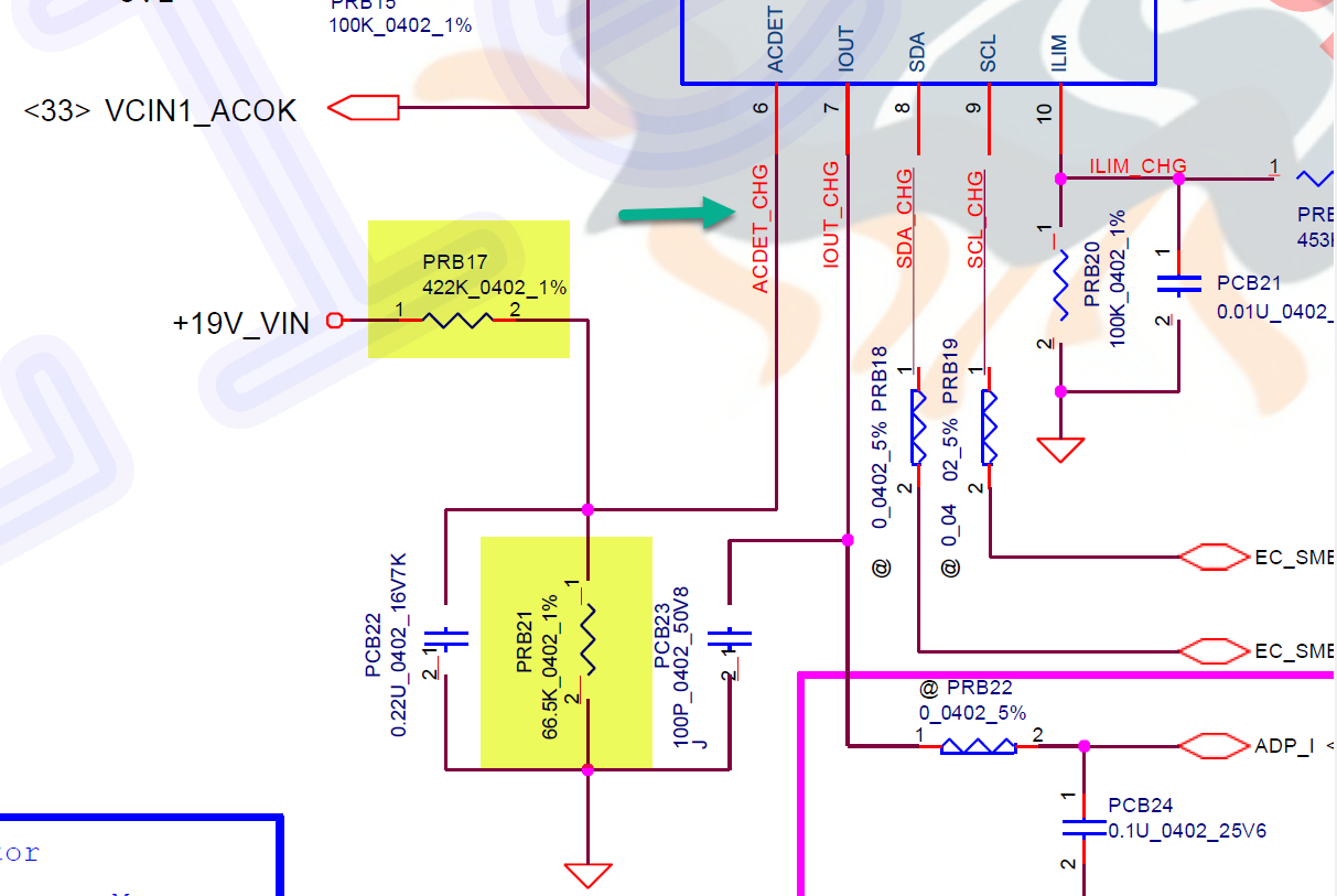

    10th generation hp laptop(LA-G07FP motherboard) missing ACIN signal.charger light not blow.when pressing power button, only 3 blinks display on dc adapter bulb(only once).but not turning on.original hp charger attached.charging port perfect.
    19v (gate 25v) main power rail ok
    RTC section ok.
    3vldo ok
    5vldo ok.
    ECON missing.no 3v and 5v always voltage.
    REGN,ACDET perfect.but ACIN missing.No short in ACIN path(good impedence)
    Replaced the bq24725a charger ic.but no result.still ACIN not generating.
    is this sort of error occurs from EC bios?what should i check further to fix ACIN signal.?

    Link or post the schematic. Unable to find the ECON netname in the schematic I have. Also where does ACIN signal originate?

            Re: LA-G07FP ACIN signal missing
            There will be required pull-up resistor on ACOK / ACIn pin since this is an open drain (also known as open collector) output.
            What is the voltage to ground of the other side of this pull-up resistor?
            With a logic low on this charge pin, the AC adapter is NOT OK.
              "PRB15" resistor side "1" shows +3VL=3.3v.
              side "2" of that resistor shows "0V"
              what should i do?I have tried another charger too.should i want to try any other charger also to test whether it is a charger fault?
                Review the voltage of pin # 6 = ACDET.
                What is the voltage to ground of this pin ? If this voltage is too low, the adapter will be deemed as not worthy to power this logic board.
                Next, remove all power. Meter in resistance mode.
                Measure the resistance across PRB17.
                Measure the resistance across PRB21.
                Post each reading.
                  ACDET voltage =2.7V
                  PRB17 412kilo ohm
                  PRB21 66kilo ohm
                    Look like good readings.
                    Focus on the EC. North of the UK1 symbol in the schematic are the power pins for this component.
                    Measure the voltage to ground of each such pin. Post each measurement.
                    In following the power sequence chart on page #5, the EC_ON should be high next, if this component is being powered and has valid firmware. This device has an internal 8051 microcontroller core that requires firmware to sample the GPIO pins and to drive the EC_ON function.
