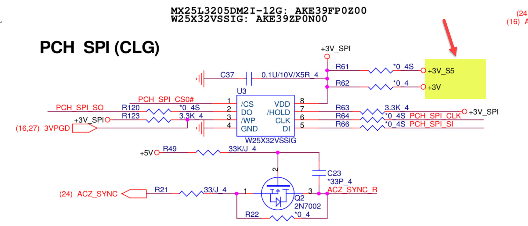

    Hi everyone, I hope you are having a good day.
    I have a laptop sony Vaio, DA0HK1MB6E0, MBX-247. REV: E
    The laptop suddenly shut down as the owner told me, so I did the normal check there is no short but the laptop it's not powering up and there is no light when I connect the adapter because there is no battery.
    so I checked.
    pu9:
    Vin: 19v
    Ldo: 4.89v
    Ref:1.99v
    Vcc: 4.89v
    Vdd: 4.89v
    output
    3.3v pcu.
    EN2: 4.89v
    but No sign for +3v or +3v_S5.
    also, there is no +5v_S5, I have changed the pu9 and the same result 5v still missing, so I tracked the Enable signal for the channel to the (KU1)
    Vdd: missing. (+3v)
    Vcc: 3.3v pcu.
    Avcc: 3.3v
    RSMRST: missing.
    5S_ON: missing.
    Power button: 3.3v.
    bios chip: U3 ( w25q32bvssig- windbond)
    pin number: 2 / 7 / 8 no volts.
    so I ordered a new bios chip and installed it without programming it, and the result surprised me, all missing volts are appear including S5_on.
    and now I have 3.3v pcu and 5v_S5.
    but on the power button, I have 1.32v.
    so I took it out and program it and the same old issue appears No 5v_S5 there.
    I have tried many BIOS.BIN files and no change.
    is this sign for bad (super I/O) do I have to change it? or there is something
    different I need to try.

      See attached. You have no voltage @ +3V_SPI ?
      If correct, then check the resistors that feed this rail as highlighted.
      What are the voltage to ground for these resistors?
      Which resistor is stuffed on your logic board ?

        I don't have voltage at pins: 3, 7 and 2. yes the +3v spl, +3v , 3v_s5 are missing from my board.
        but if I programmed the bios chip with different bios.pin, all missing volts will
        appear but (3.3v on the power button) will drop to (1.3v).

                update, I shorted pin 9 and the ground and laptop worked fine, then I checked the ribbon cable and it's damaged on both sides, I will order a new one or try to fix this then I will update you.
