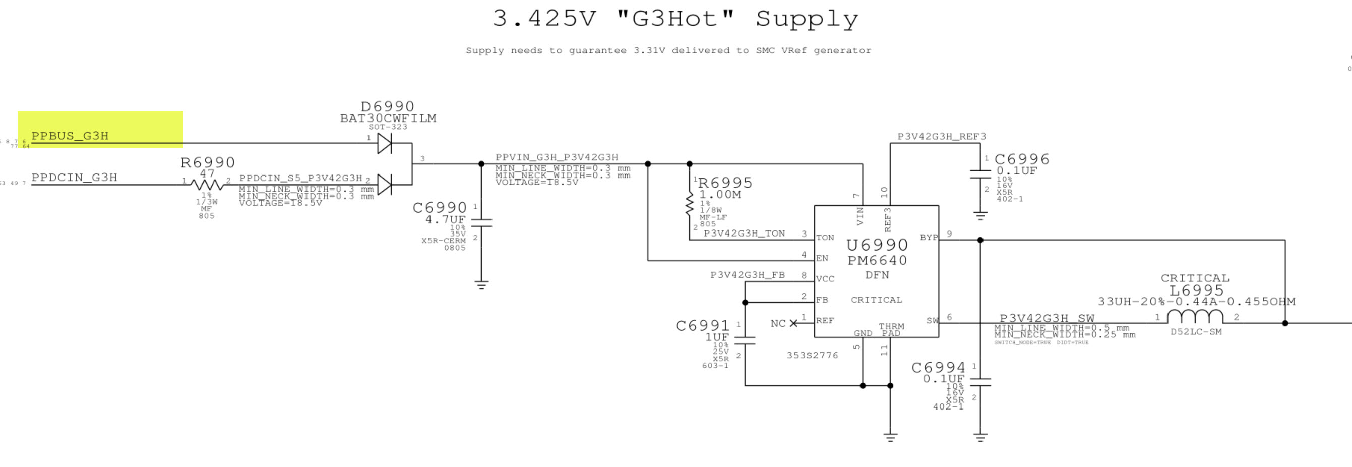

    Hi there,
    I got an 820-2936-B motherboard which was originally dead when came in. So replaced U7000, U6900 & Q7035. Now i have got 12.16v on PPBUS_G3H and 3.425 volts on pin 1 of L6695, but just 3.415V on pin 2 which is a PP3V42 line. I am certain that SMC is not being turned on as per the current PPBUS_G3H voltage.
    The issue i am trying to resolve is the voltage difference on pin2 of L6995. Any ideas as to what could be pulling it down???

    Remove all power. Meter in resistance mode.
    Measure the resistance to ground on pin # 2 of L6995.
    The voltage drop is not much and may be ok as-is.
    What is the resistance ?

        So ~560 ohms to ground. That is low.
        The rail travels all over the logic board. Start with reviewing the caps on this rail.
        Flux and remove C6999. Then measure the resistance to ground again on pin #2 of L6995.

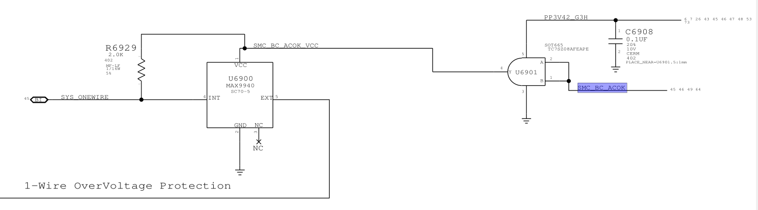

                    What is the voltage to ground of SMC_BC_ACOK ?

                        The 3.425V value is required to power the parasitic one-wire magsafe communication device inside the magsafe power adapter.
                        This is the voltage of SMC_BC_ACOK which is used to power the security device and also to light up the magsafe head to be green or orange. It is a low value for your case. Needs to be higher.
                        Remove all power, measure the resistance to ground of PP3V42_G3H.
                        What is the measurement?
                        Attach the power adapter.
                        Also measure the voltage to ground of pin # 3 @ D6990. What is the reading?

                          Pin #3 @ D6995 measures 16.8 volts. Resistance of PP3v42 to gnd is 0.570k ohms. Something interesting happens as well. If i remove F7040 i get 3.421 volts on pin 2 of L6995. When F7040 is inserted back, the PPBUS comes back to 12.16 volts but PP3v42 @ pin 2 of L6995 is back to square one.

                            Good that you tested this permutation. Suspecting that D6990 is leaky.
                            Remove all power. Meter in diode mode.
                            Red meter probe on pin #1. Black meter probe on pin #3. Meter should conduct. Reading?
                            Reverse the probes and the meter should block. Reading ?
                            Repeat for pin # 2 and #3 combination. With red lead on ANODE (back of arrowhead); meter should conduct but block other way around.
                            Confirm it.
                            If available, replace this part and test again.

                                The pin 1 & 2 of D6990 is giving readings in diode mode even when the probes are interchanged with GND. Bizzare.!!! I might have to remove D6990 and test it. Will try that. Any other pointers???

                                  Re: 820-2936 PP3V42 being pulled down.
                                  If available, replace this dual common cathode diode.
                                  For testing, meter in diode mode. No power.
                                  Red meter lead on the anode (back of arrow head); black lead to the common cathode (the regulator Vin).
                                  There should be a voltage reading as the diode conducts in this forward direction.
                                  Reverse the leads and the diode should not conduct.
                                  Repeat for the next leg. Post each measurement.

                                    I noticed something interesting. R7005 has gone to a high value from 20 ohms to 293 ohms. Do you thing this is connected to our problem.I shall post the readings of D6990 shortly.
                                    • mon2
                                      • Dec 2019
                                      • 14473
                                      Yes, this value should match the original. Please replace it.
