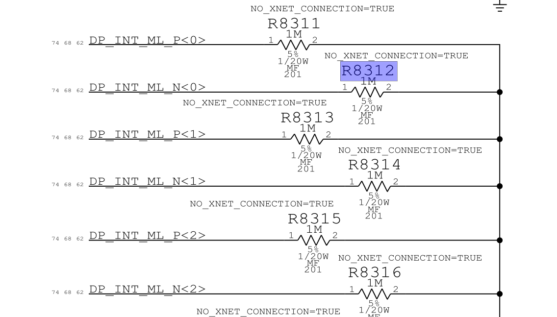

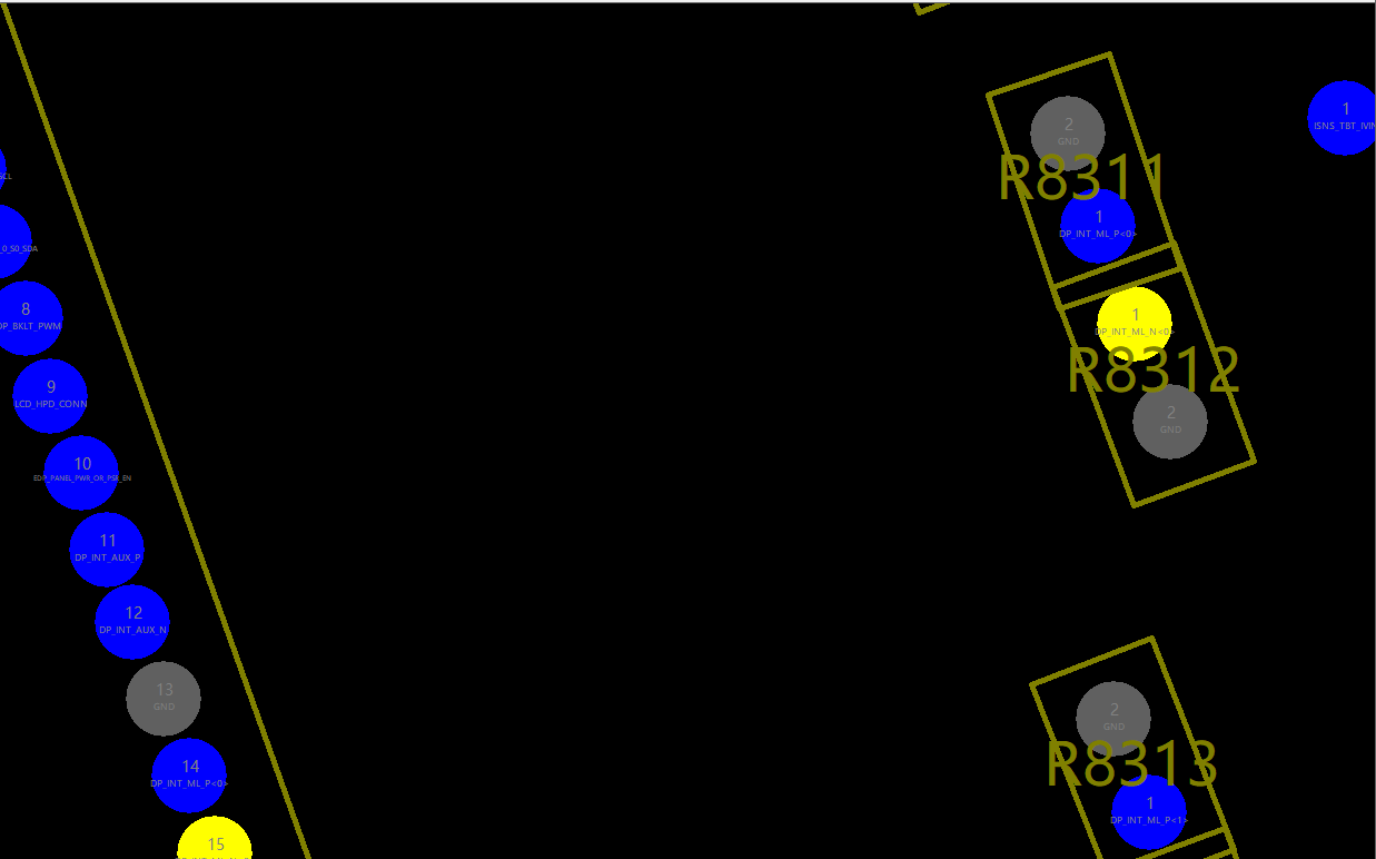

    820-3476-A Pulled resistor R8312
    Hello everybody.
    First comment that I am a computer technician, not an electronics specialist, but I do like it.
    I tell you, by accident I have pulled the resistor R8312 and the GND pad of a motherboard 820-3476-A, the line is called DP_INT_ML_N <0> and it goes to pin 15 of the J8300 connector.
    The screen works and I don't know if it can be without that resistance. I guess not, but ... is it possible?
    Thank you.

    Re: Pulled resistor R8312
    R8312 = 1Meg, 0201, 5% pull-down resistor (to ground).
    Recommend to place this part back on but is a very weak resistor value and you may be ok to work without it.
      Thanks mon2, for now I will leave it without soldering.
