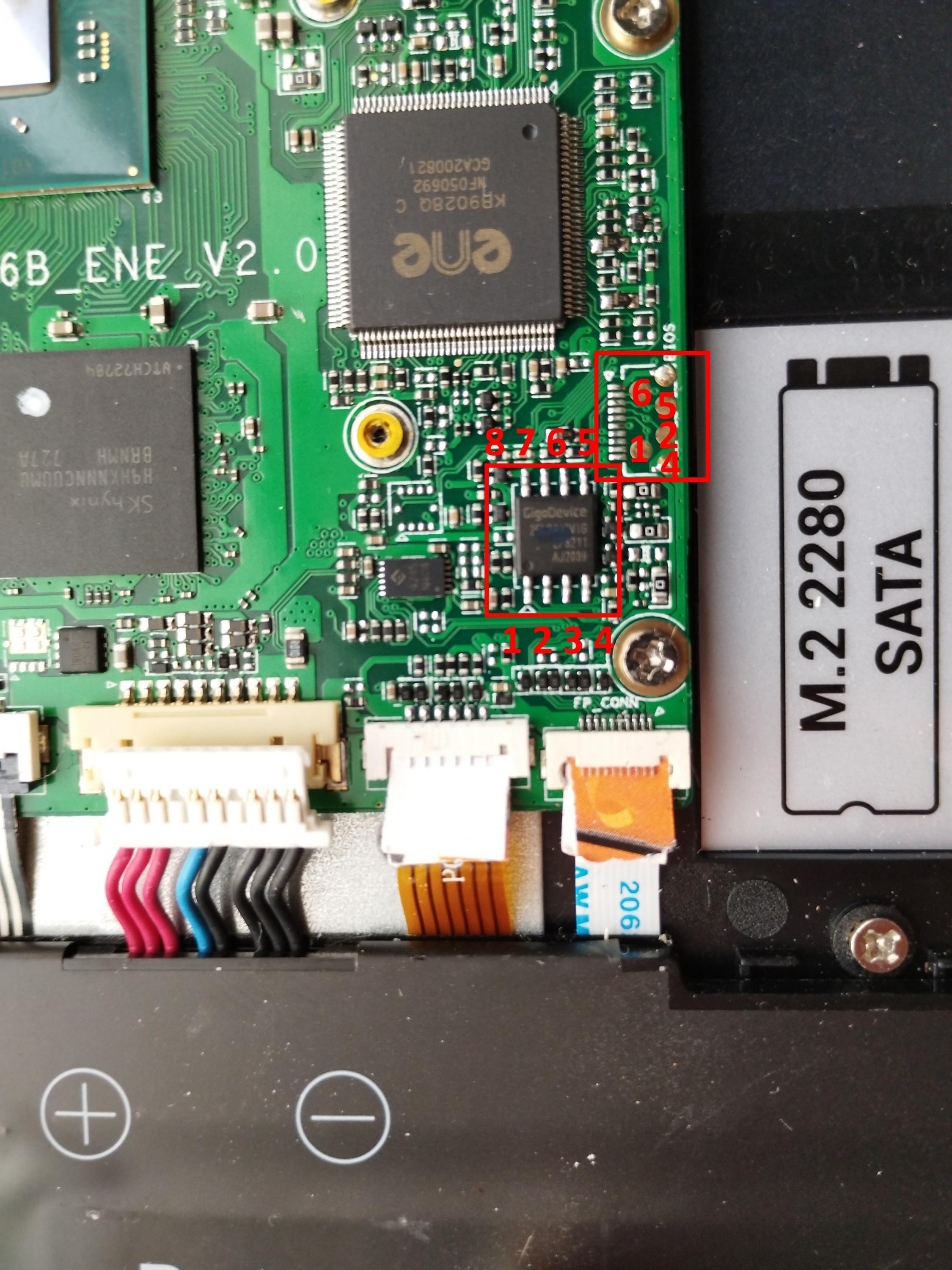

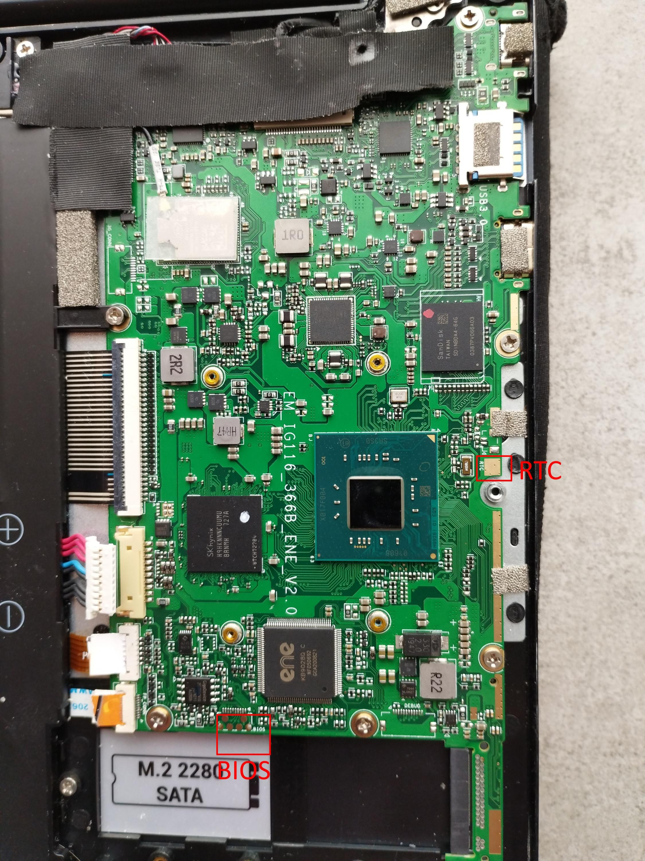

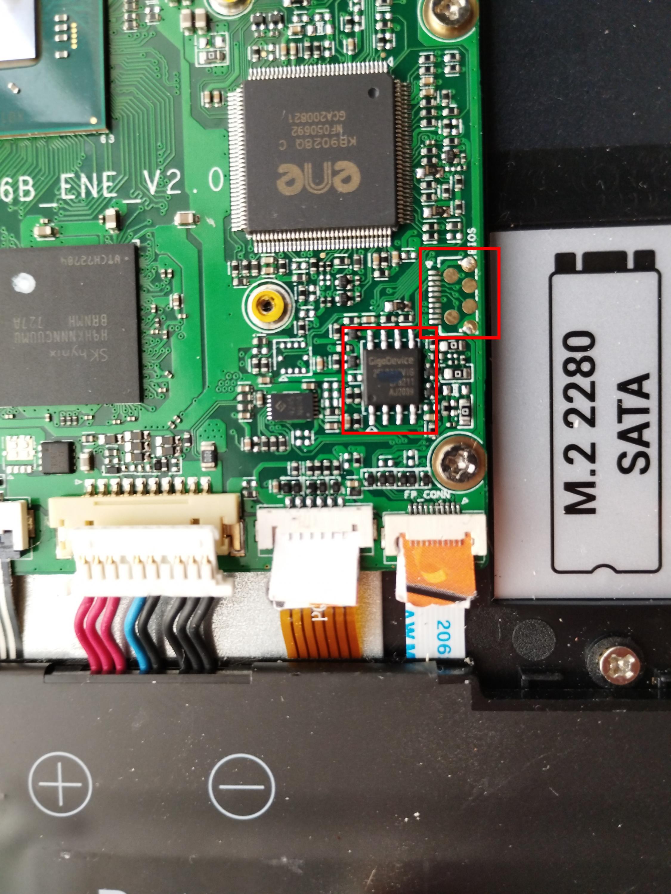

              • highsnoop
                • Feb 2023
                • 21
                • IDF
                Re: Clear CMOS on unowhy Y13 Ultrabooks on motherboard
                This is the picture of a part of the motherboard.
                You will see the bios chipset and the connector to manage it.
                I think something can be executed from here to reset or update the code when the laptop boot on a black screen

                  • highsnoop
                    • Feb 2023
                    • 21
                    • IDF
                    I watched a lot of youtube videos on eproom flash in recent days
                    But this problem (black screen after changing a setting in the bios) happens several times on noname motherboards (like pipo X8)
                    Because the manufacturer uses a common bios with all the options not available on its own device
                    I can't read the chipset number So I can't figure out how to make a short circuit (pin x to pin y) like a clearcmos jumper without the risk of burning it.
                    My last chance, as you both said, is to read the eproom with my rasbperry (I've never done that before ) to read/delete/write I also don't know the voltage for this chipset (3.3V?)
                    any help are welcome
                    Thks

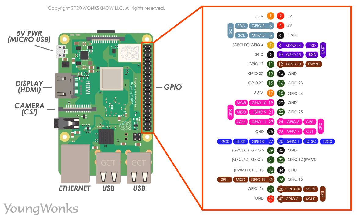

                      • highsnoop
                        • Feb 2023
                        • 21
                        • IDF
                        https://github.com/bibanon/Coreboot-...h-Raspberry-Pi
                        But does each chip have the same schema ?
                        example
                        https://1.bp.blogspot.com/-oqp22M52C...o2+diagram.jpg
                        Can i used only pin : 1 2 4 5 6 only (used O for the welding) ?
                        • reformatt
                          • Feb 2020
                          • 1501
                          On board read/write of SPI25 EEPROM's is a bit hit and miss for me. It's quicker just to hot air it off and put it in a programmer. If the EEPROM is near anything heat sensitive (or I don't want to take the board out), I use Chipquik on the pins and it will just come off with an iron.
                          Any SPI25 programmer will work, even CH341. You may need a 1.8V adaptor though if the EEPROM you are trying to read is 1.8V variant. Check datasheet of the EEPROM to confirm.
                            With difficulty i Can read the chip ref
                            Gigadevice
                            25lb64cvig
                            Ef8211
                            Aj2039
                            The voltage seems to between 1.65 and 2.0
                            Here is the Doc https://www.mouser.fr/ProductDetail/...IVPR6ZyQ%3D%3D
                            If you confirm, i will buy a ch341 like this
                            ch341a
                            Sorry for sponsor but not choice 🥴
                            Thks for your help

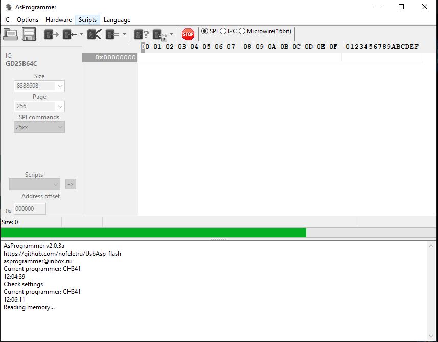

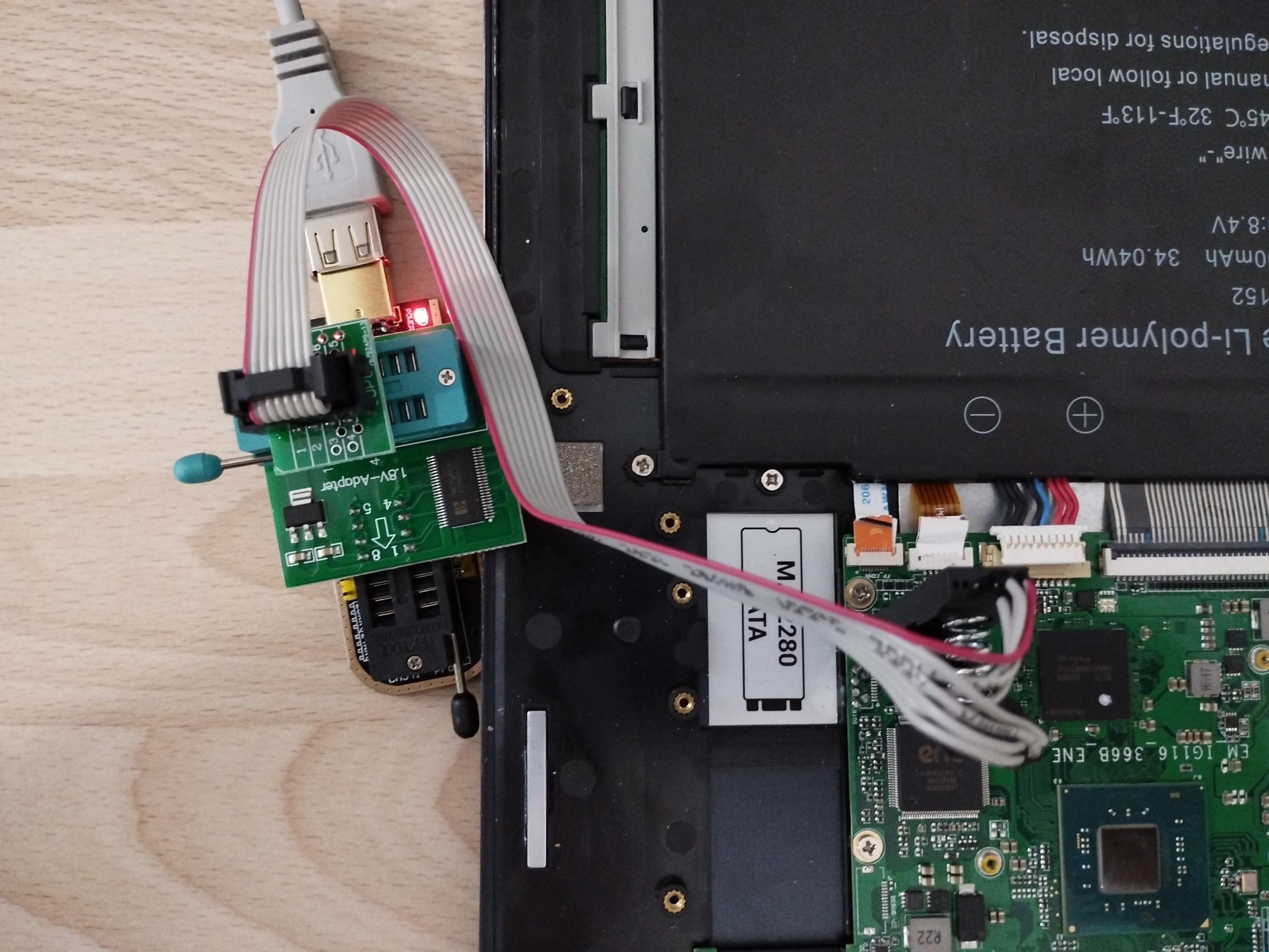

                                • highsnoop
                                  • Feb 2023
                                  • 21
                                  • IDF
                                  I received everything needed but I find an empty chip
                                  Before plug ch341a key on pc (windows 10), i check with a tester the good contact with pins on motherboard to the adaptor 1-1 2-2 3-3 ....
                                  The chip doesn't be found with asprogrammer, i selected GD25B64C in the device list manually without success
                                  thanks for what i am wrong
                                  • mon2
                                    • Dec 2019
                                    • 14667
                                    Be sure your tools are supporting and configured for 1v8 operation. Otherwise this flash chip will be killed.
                                    You will need to remove the flash chip off the logic board and then proceed to use the programmer to read / write / erase the chip.
                                    Be very careful on the hot air tool that can and will hurt the display or any nearby plastic parts. Keep the air flow low and ample flux to remove the part. Practice if required on other donor boards first.

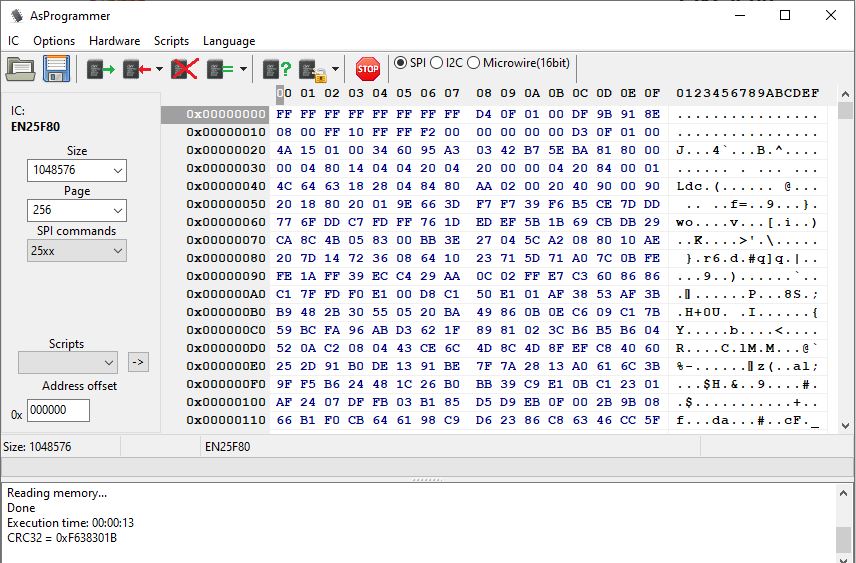

                                    • highsnoop
                                      • Feb 2023
                                      • 21
                                      • IDF
                                      i tried with another chip from an older motherboard
                                      Asus M4A785STD-V
                                      Chip : CfEON EN25F80
                                      https://pdf1.alldatasheet.com/datash...N/EN25F80.html
                                      Full voltage range: 2.7-3.6 volt
                                      so without 1.8v adaptor i get something from the chip (No detect automatically, i selected it manually)
                                      see capture too confirm
                                      So the issue can be from Adaptor or chip
                                      I don't have others chip in 1.8v
                                      • highsnoop
                                        • Feb 2023
                                        • 21
                                        • IDF
                                        I used a voltmeter between 8 and 4 and I get 1.8V so the voltage was set correctly.
                                        So I think it's the connection with the clamp around the chip...
                                        I will try to weld it but it's very very small....
