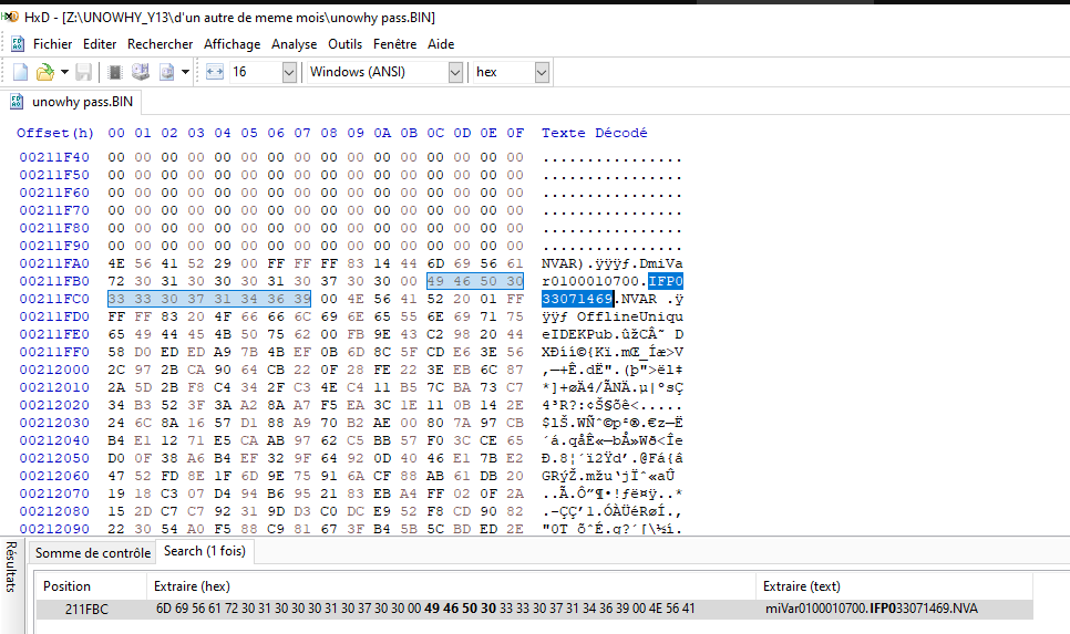

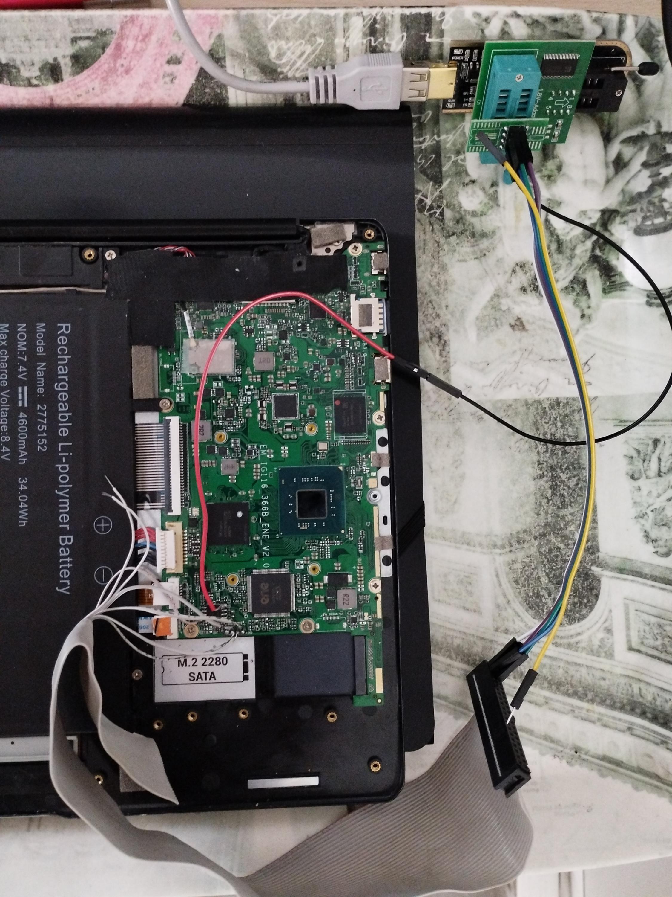

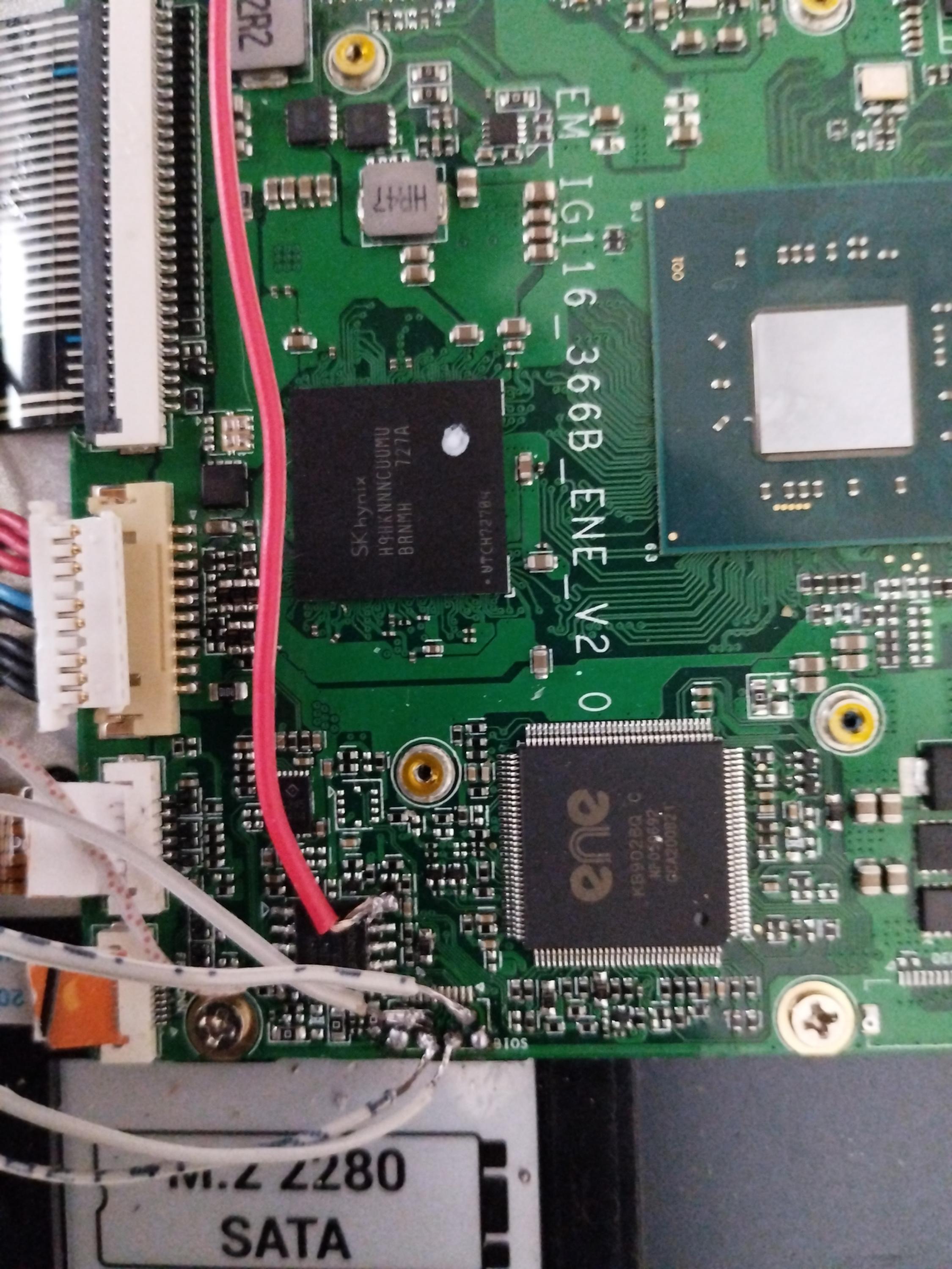

      I managed to solder directly on the chip after one hour of fight.
      I got the dump of my bios (I doing it twice time to compare result and the both files are identical).
      Does the parameter to change in the file is my picture proposal (A Vs B)?
      Thanks again for your help and hope my story can be help anyone in this adventure
      or if someone can provide the same bios version (i don't know what is it) without password

          CH341a + adaptor 1.8v
          For the driver + tools : Driver+tools
          Impossible de lire la puce avec la pince, j'ai directement souder (voir photo) les pin 1 2 4 5 6 8
          Attention ce n'a pas été facile car c'est très petit et la solution avec l'air ne pas convaincu avec le nombre de petite résistance proche du chip.
          Pour l'instant je suis toujours bloquƩ et en attente d'un modification de mon Bios ou bien d'un bios compatible pour le remplacer
          Impossible to read the chip with the pliers, I directly solder (see photo) pins 1 2 4 5 6 8
          Attention it was not easy because it is very small and the solution with the air does not convince with the number of small resistance close to the chip.
          For the moment I am still stuck and waiting for a modification of my Bios or a compatible bios to replace it

              With the AMIBCP tools i read my dump
              BIOS Date: 10/28/2020 19:55:13 Ver: 3BAPS05
              American Megatrends Inc.
              V0.5.0_P1S0M2E0F3L6B0T0P2G00A0U0D601_ENE
              10/28/2020
              Can i set option directly from this tools or can i do it with another one ?

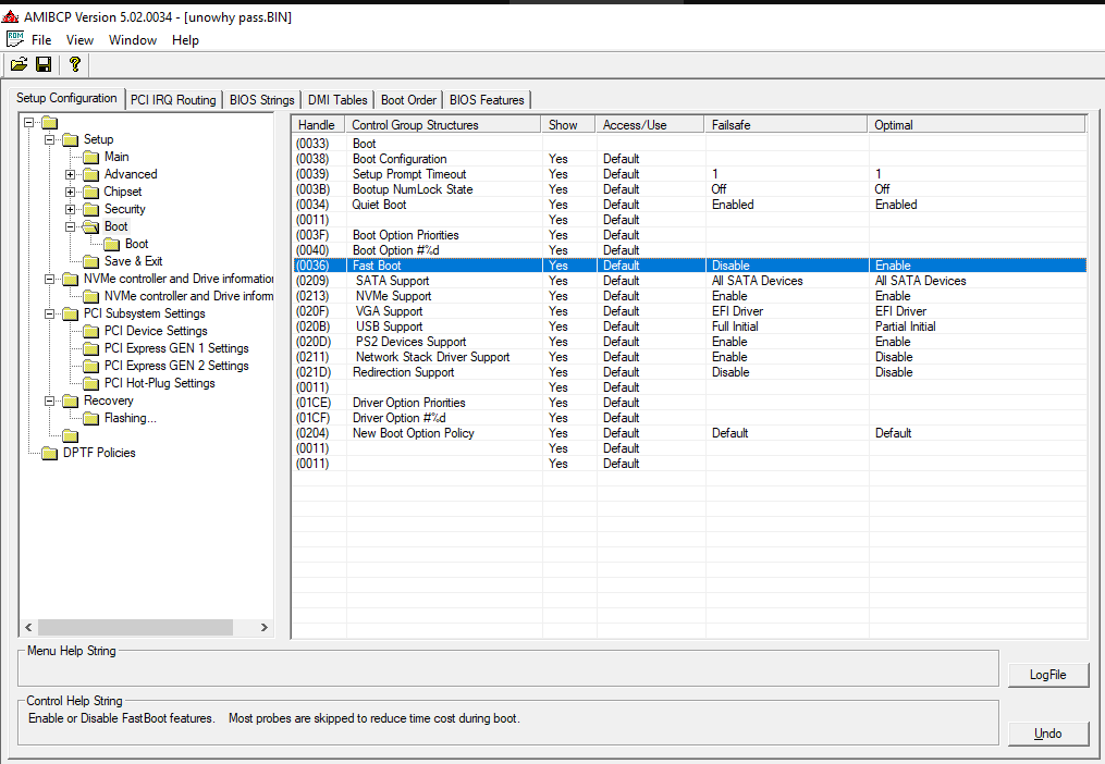

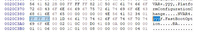

                  I also am facing the same black screen as I wanted to install Manjaro Linux using a USB key and modified
                  * / Setup / Chipset / Southbridge / OS Selection from "Windows" to "Linux"
                  * / Setup / Boot / USB Support from "Partial Initial" to "Full initial"
                  after save & exit got the black screen...
                  So I ordered my ch341a... am waiting and discovered AMIBCP
                  Have you tried opening your own dumped "borked" bios bin file in AMIBCP, changing the Setup/Boot/Fastboot parameter (cf. attached screenshot), saving under new name and flashing the modified bios ?
                  Bios contains the Serial Number of the Y13 computer (cf. attached screenshot)... so maybe its not just information and checked agains someting/somewhere and that's why flashing someone elses Bios is not working for you when you flash it...
