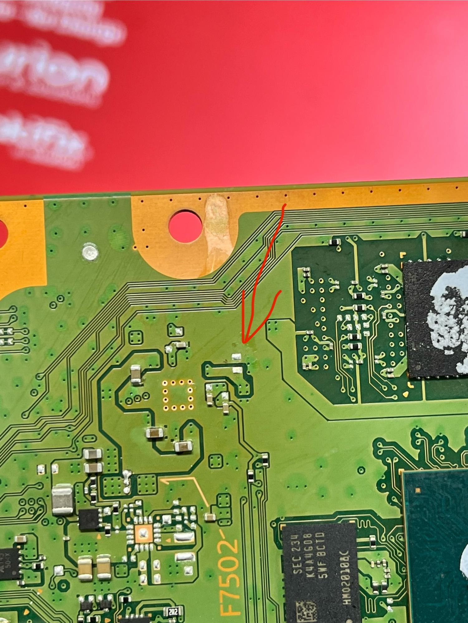

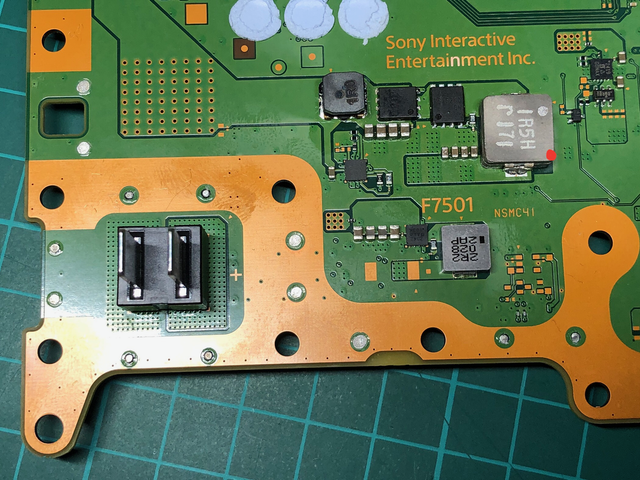

    PS5 brief power won't start
    powers on + beeps briefly for a second displaying a blue light then powers back off
    • checked all fuses ok
    • checked for voltages, found 12v, 5v, 3.3v, 1.8v (I am not 100% sure where to successfully check for all)
    • started checking each inductor ohms to ground, all ok apart from a 1R5 near the DCIN, shorted 0.3ohms
    • checking components around the inductor appears a small plane on the front of the board is shorted progressing through to a plane on the rear side
    • surrounding circuits not on this plane are not affected
    • I have check caps around the board in each various circuit for a similar short and have found none (so far)
    • everything appears localised to this single area
    • I did remove the mosfet on the right (stupidly) as I had a lapse of judgement and forgot the inductor to the right was still in circuit. I tested it off board anyway and it's fine

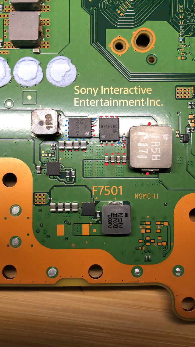

    red shorted (0.3ohms) , blue not shorted
    shorted inductor
    top of the board
    back of the board
    mosfet? end of the back of the board shorted trace (I can't find a datasheet)
    I don't have voltage injection + thermal yet but I'm in the process of buying both.
    I am wondering where to progress through to next. The short seems so localised to this single area that I am tempted to start removing the ceramic caps but wondering if anyone has any further input.

    Re: PS5 brief power won't start
    found out it was one of the small caps below one of the mosfets which had gone bad, replaced it for another and it's back up an running

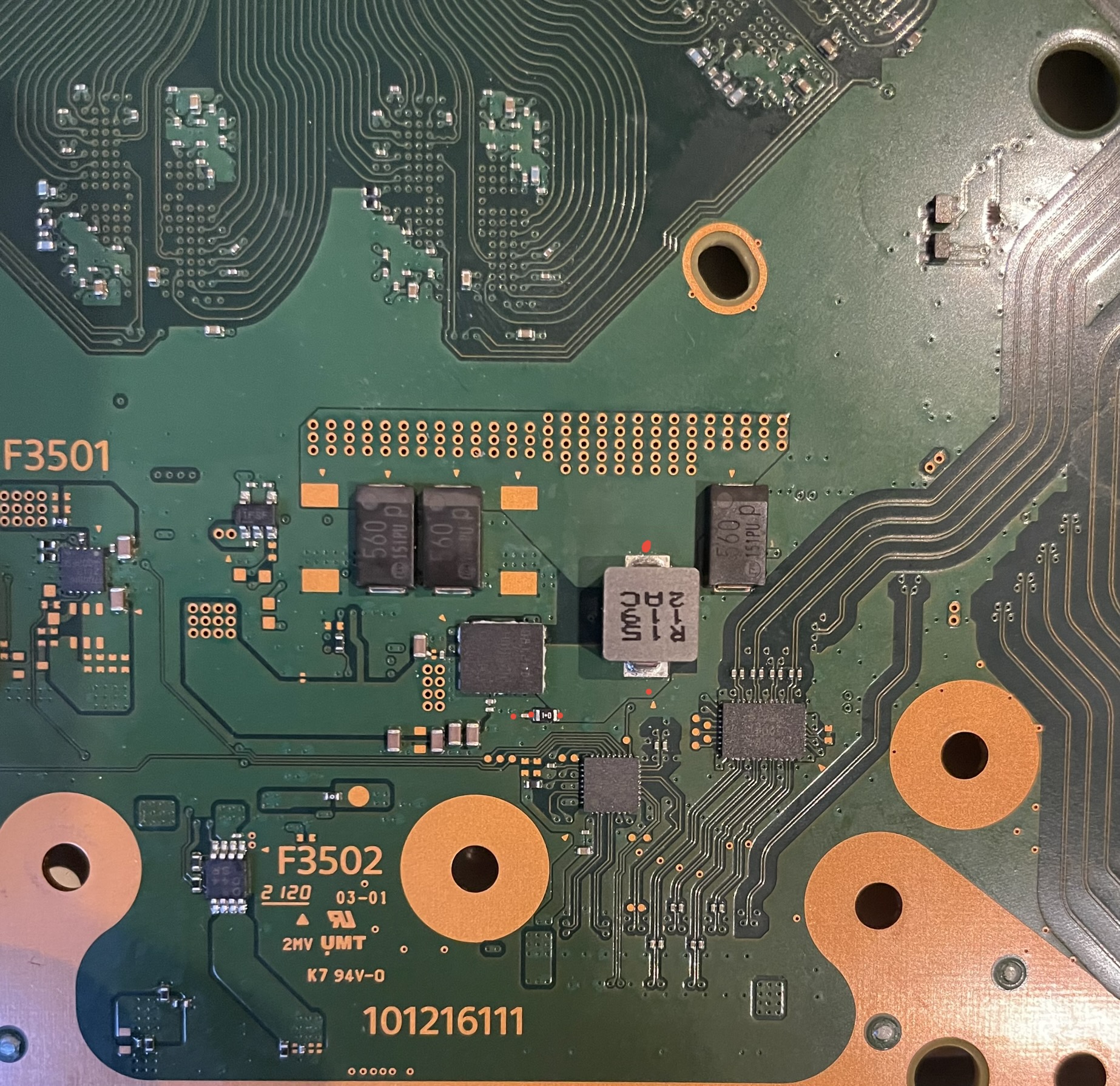

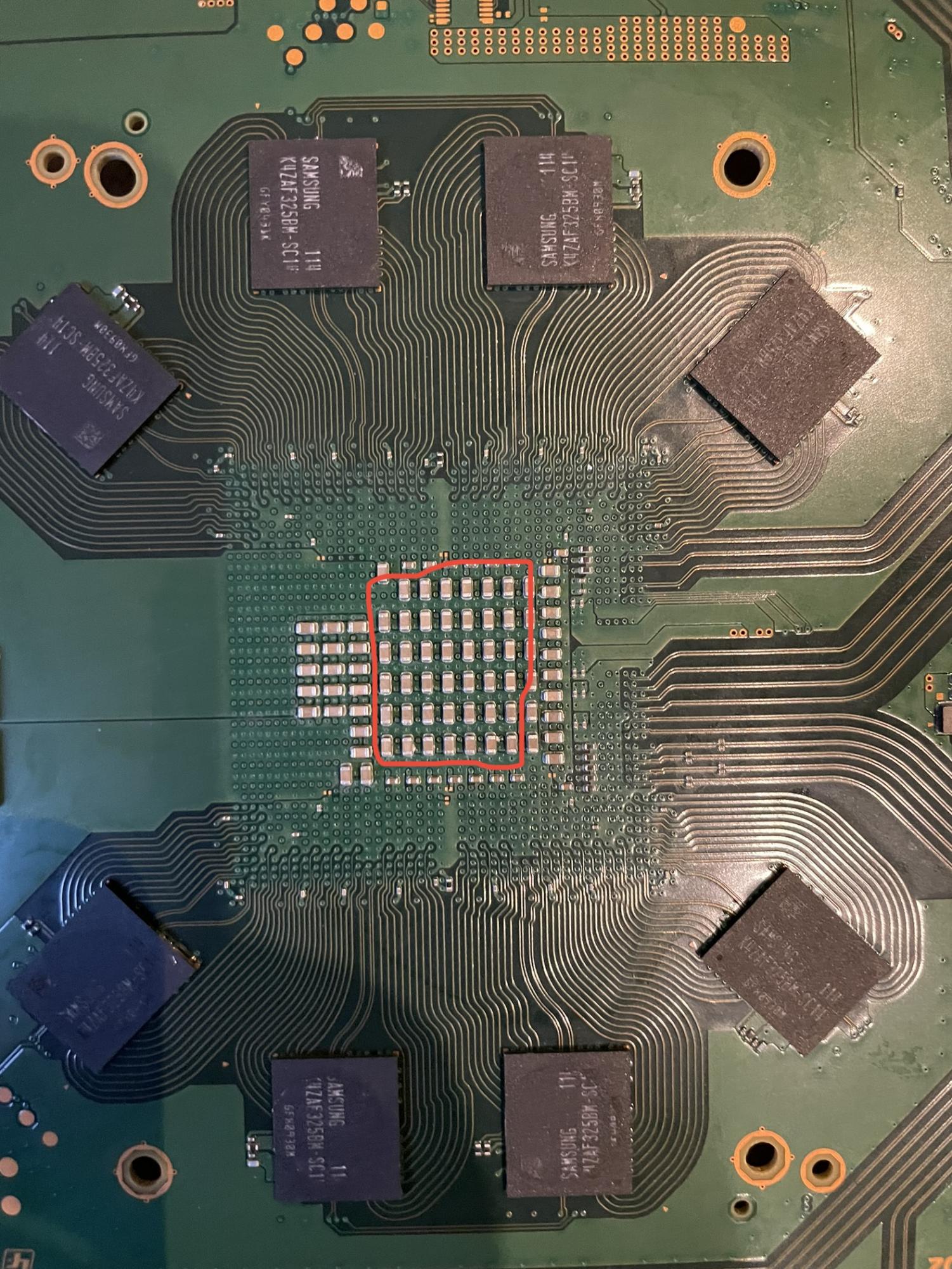

                    My ps5 dropped and has same issue 1 second blod.
                    Back and around the APU the capacitor are shorted. Is this normal?
                    I don't see any video where these capacitors are measured.
                    apart from that everything is alright and can’t find any other problems.
                    I would appreciate any help!
                      Is it just low on resistance or is it a dead short?
                      • Son23
                        • Mar 2023
                        • 2
                        Dead short

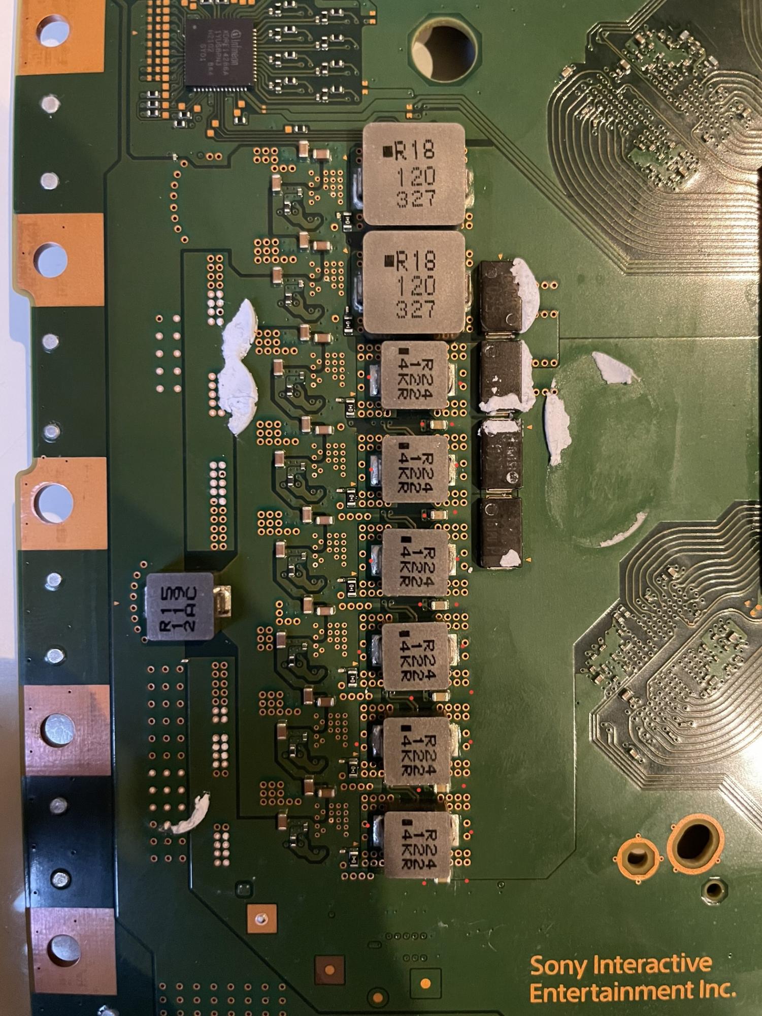

                          Originally posted by Son23
                          Dead short
                          What is shown in the photo is the choke (inductors), they will show a short circuit.
                          If it fell, then the chip most likely fell off (the processor under the radiator), only a reball will help, if the nickels on the motherboard under the processor have not come off.
                              Dead short
                              not sur dead short on those beware tey have low resistance

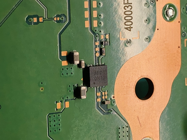

                                Hello can someone help my were i can get this cap.
