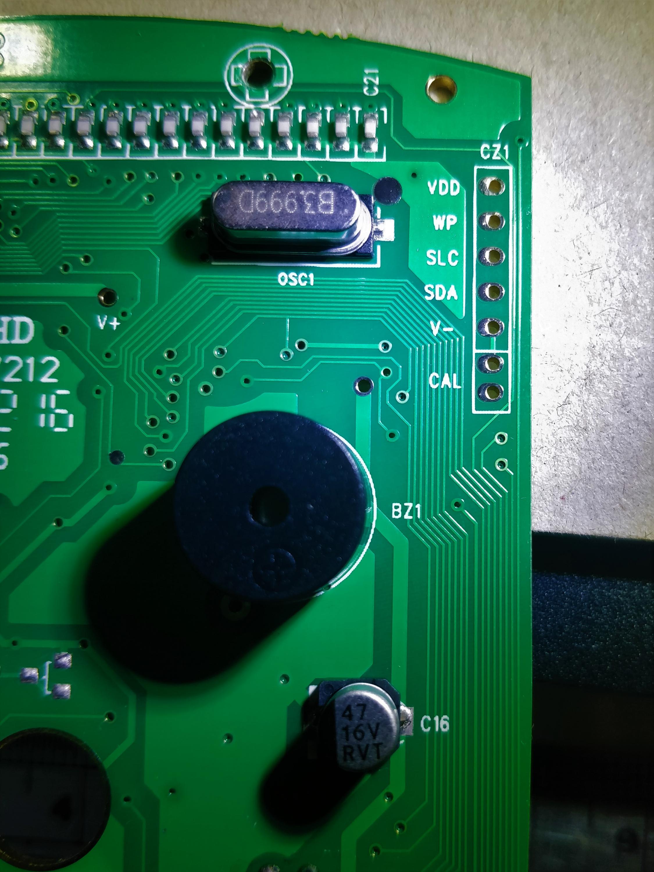

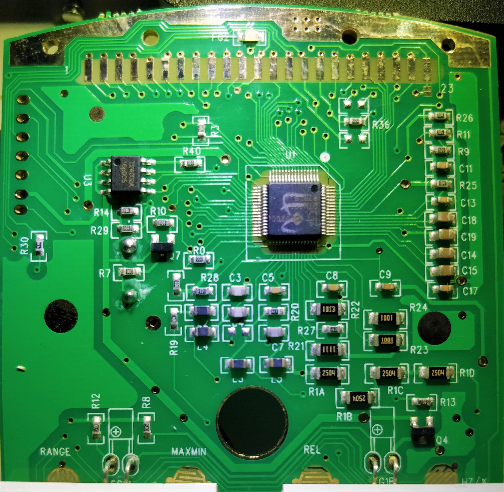

    I've got a UT139C that powers on for a second with an ErrE, before switching itself back off.
    I haven't found much information about this, other then the error being caused by the EEPROM (both on the internet and from fellow members here). While I'm using a cheaper multimeter temporarily, I'm trying to troubleshoot this... hoping it won't go to trash
    I've opened it up and did a visual inspection. Unfortunately I couldn't see anything obvious, everything looks clean and as new. No signs of damaged components.
    I'm attaching two photos: one of the eeprom area, and the other I think are the rails on the back that end up to the eeprom (?). Also attaching datasheets.
    And because I'm doing this to learn, and I'm still new to this, I have a couple questions.
    1. What are the components starting with L? I know C are usually caps, while R are resistors, F fuses and so on.
    2. Laugh at me, but, where do you find ground on these 2 layer boards? On laptops it's easy cause these are usually screw holes/ports etc.... What am I missing?

      L are inductors.
      do you have an eeprom programmer?

                Post the EEPROM file you have, to see if it can be fixed.

                    check the tracks between the eeprom and the main chip.
                    here is a schematic of another meter with the same chipset,
                    and a datasheet with example schem on page 17

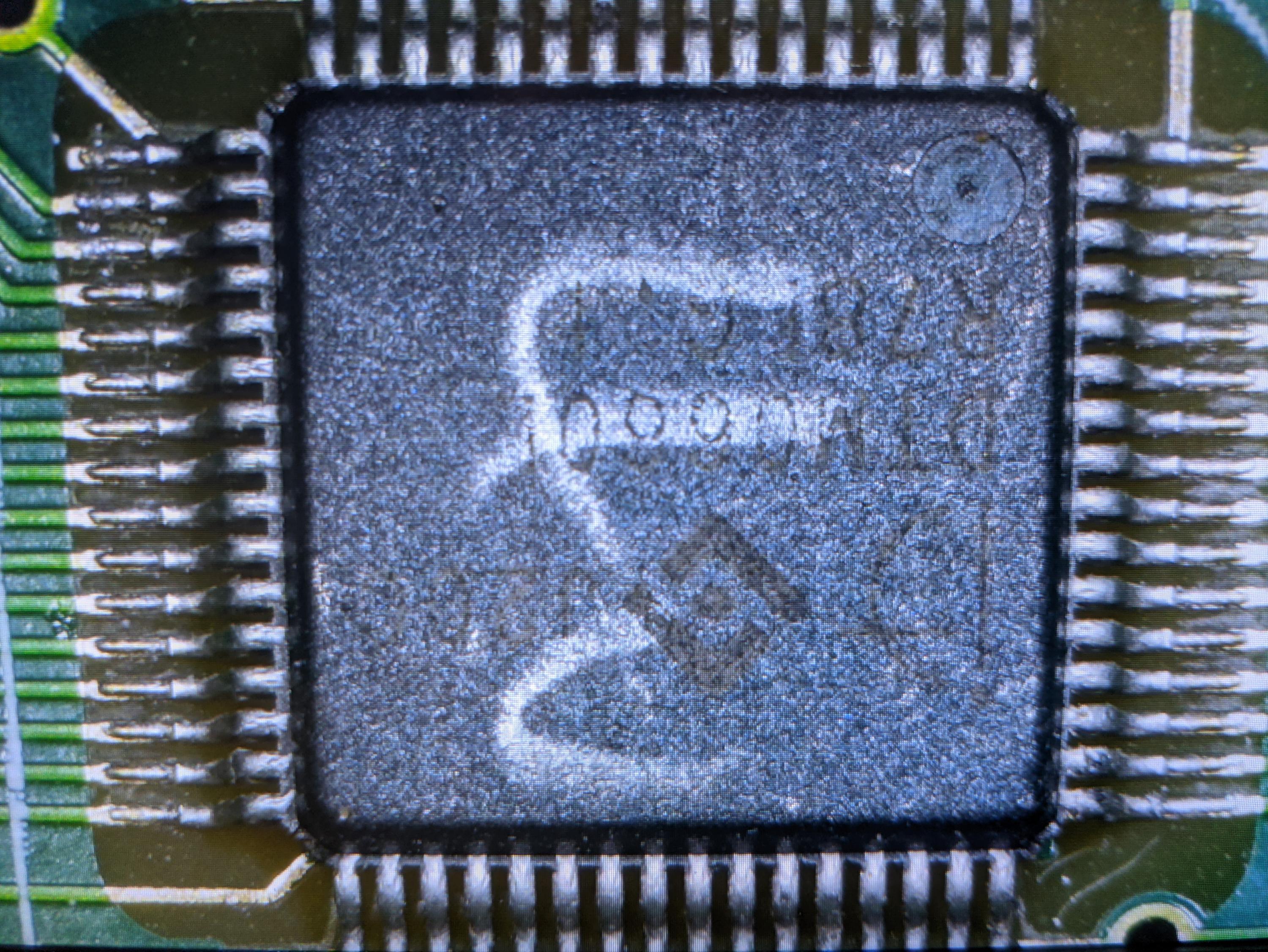

                        I looked at your EEPROM dump with a hex editor and did not see any errors. I can't know what every byte should be, but I did not see anything corrupt.
                        Check the EEPROM pullup resistors on SDA and SCL are OK, is R29 soldered on both sides? The main IC DTM0660 looks like solder balls are behind/under the pins?

                          All resistors seem to be soldered fine, but I'll re-flow them just in case. I also measured them and the readings are good.
                          About the solder balls, do you mean in between pins? If so, it doesn't seem like it under the microscope, and I didn't reflow it or touch it in any way.
                          I also tested in continuity between the DTM0660 and the EEPROM IC, in case there's a broken trace, but all seems fine.

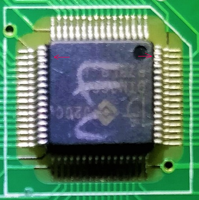

                            No, the solder bridges I see are UNDER the pins.
                            You can poke a wire or paper clip (gently) through and see if you hit them. Usually they are solder balls from extra paste and can poke out.

                              Doesn't seem to be the case, must be the quality of the previous photo

                                Reflowed the resistors, still the same. While it seems to be interesting, I don't think it's worth working on it anymore. The only thing I miss about this is that it has auto range, and the other ones I have do not.

                                  did you check the eeprom is getting power?

                                    For some reason EEPROM power has a R40 100Ω resistor to +V, and it's supposed to have a bypass cap 0.1uF across power and gnd but I don't see it.

                                      Check with an oscilloscope the data line, clock and the main oscillator for activity.
