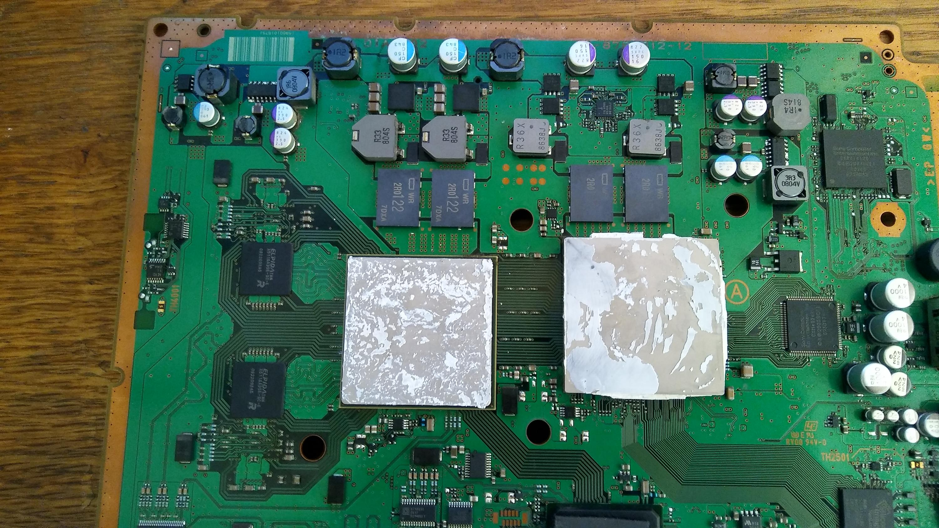

    So thats pretty much ylod... You will need to replace the NEC / tokin caps/// there are 8 on each side.. they are above the cpu and the rsx on each side of the board... This was really tricky for me to do first time , but i got the hang of it... its big capacitors you cannot miss them... look up NEC/ Tokin Cap replacement on google ... and you will find plenty of answers...the way i did it , is take a sharp screwdriver(the one with the pointy tip) and use alot of hot air on them and SLOWLY pry them off ... Keep the air on the pads to clean them up... Be very careful if you are forcing , because you might drive the screwdriver when they pop off and damage something else... but i had 100% success rate with this so dont lose hope. Replace 2 caps and check , and repeat untill the ps3 starts working. There is probably a disk inside the tray too.
    good luck!

      It might not be that this is the issue tho... but im pretty sure it is... check the voltages first on the main line just in case... it might not be the ylod !

            Yes stj the green led comes on,fan starts then 2x 3 beeps then red led flashing no video

              You are right sigmeyer there was a disc in the tray

                  Which are the nec/tokin caps
                    • 31214
                    #49
                    Re: Ps3 fat Cechk04 no power
                    2R0 122
                    although your seem to be made by nippon-chemi-con.
                    which is something i'v not seen before!!

                        unlikely, i think the boards are made in korea by Asus.
                        here is a pdf of what there is to find.
                        you need to replace them with 4 tantalum or polymer 330uf caps
                        it would be worth trying to find which is shorted with a low-ohms meter or maybe an esr tester given the number of them!

                          Ok i have an autorange meter,do i have to tes them out of circuit stj

                            Dont bother testing ... They will always show as very low resistance or a short... you should get around 3 or 5 ohms or something like that ... but it doesnt matter... 1 Cap is equivalent of 1200uF ,you can go a bit higher then that... like 1300uF each. Its gonna be unusually difficult ... you'll see when you try

                              Ok sigmeyer two of them are 1200μf and the other two are 1000μf,are they 2.5v

                                2R0102 and 2R0122

                                  ok i see they are obsolete

                                    Ps3 has video in AV and plays a game disc but fan is high and shuts down after a few minutes and the ps3 is in demo mode,i must still change the caps,is there anything else i must check
                                      • 31214
                                      #58
                                      that's NOT the caps causing that - bad caps would stop it running.
                                      i dont know about demo-mode, not heard of it.
                                      but the fan is a clue that the temps are too high - did you use silver or carbon based paste when you re-assembled it?

                                        V1 thermal compound is what i used on the two heat sinks,which is the right paste to use and there are you tube videos about demo mode,i wanted to update it and wouldnt because it is in demo mode

                                          i know FSM - factory service mode.
                                          i'll have to look demo mode up.
                                          why did you want to update it?
                                          hopefully so you can hack it with custom firmware like "Rebug"
