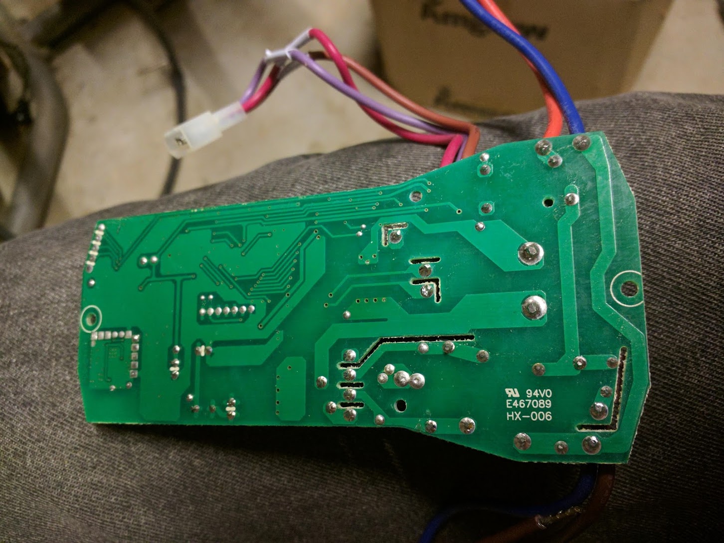

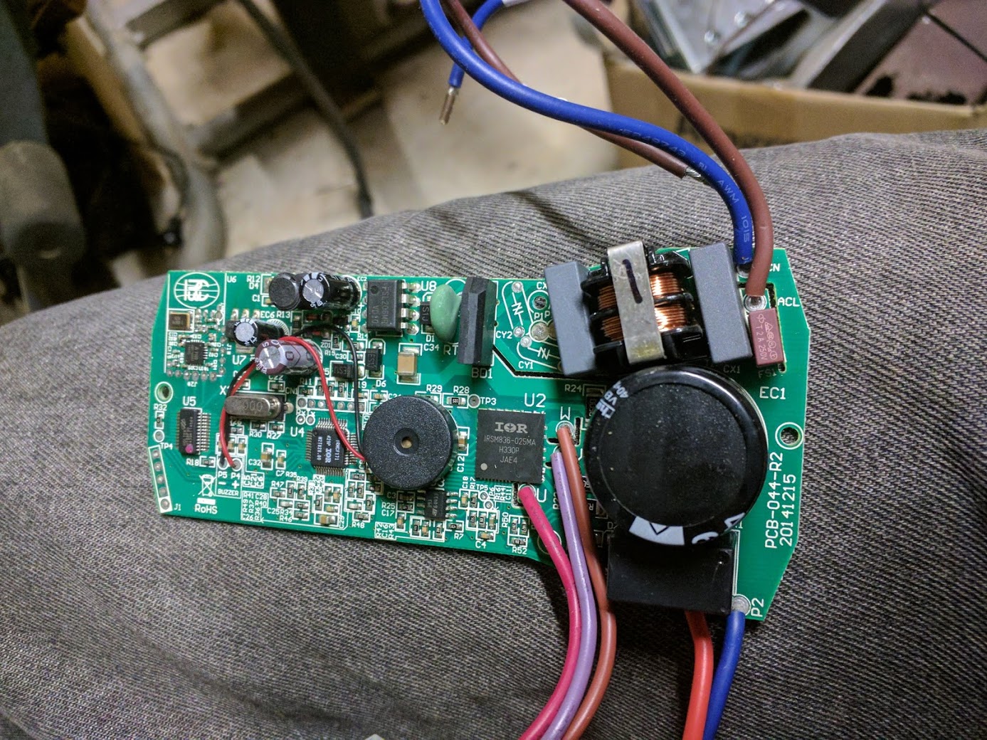

    Hi All,
    I'm having a problem with a DC ceiling fan controller (from a Mercator Trinidad fan). This operates via a remote. The light works fine, as does re-pairing the remote (an audible beep is emitted). The fan function itself however does not. This leads me to believe the issue is more than likely with the DC power control part of the circuit. I have another known good controller for comparison.
    When it first started having issues - and this might be key to forming a theory from someone more experienced than I - it initially wouldn't work until after the AC isolator wall switch was on for some time - sometimes even taking a few hours from pressing a fan speed button on the remote until the fan actually started turning.
    I suspected capacitor issues originally, due to it having some lag time before it would work. Here are some pics - visually all seems okay.

    Has irsm836-025ma dc power control module https://cdn.badcaps-static.com/pdfs/...33a5dc8694.pdf
    Tp5 and Tp6 correspond to pins 5 and 6 on the dc power control module, and the description from the datasheet is;
    5 | /FLT | Fault Output Pin
    6 | Itrip | Over-Current Protection Pin
    Focussing on pin 5, and the description for fault in the datasheet "Once the fault condition occurs, the FAULT pin is internally pulled to VSS and the fault clear timer is activated. "
    VSS is described as " 9, 39 | VSS, COM | Ground for Gate Drive IC and Low Side Gate Drive Return "
    Should I be interpreting that as it's been pulled to ground (hence the .5v reading vs the 3v on the good controller) therefore it's detecting a fault?
    I've hit a bit of a wall here - any suggestions that may help me out?
    Also - for the DC motor feed wires (U/V/W) I get 2v out of U/V/W +gnd and 26v from tp3(dc bus voltage)+U/V/W.

                      There should be a current sense resistor (0.5Ω) between ground and the VRU,V,W pins Is it ok? If the fan does eventually run I would think the ic is ok.
                      There are only 2 reasons for the Fault output being high, you say Vcc is ok, so an over current detect must be occuring

                            I'd measure ohms from the FAULT pin to VSS, to see if the big IC has failed. It's only supposed to assert FAULT as long as VSS is low, under 13.5V or motor overcurrent - but that one clears when motor current is normal.
                            These IC's usually blow up when they short so I'm wondering what went open-circuit to act as the fuse.

                                You say you have another controller, does it run THIS fan properly? It looks like U4 is the driver ic (IRMCK171)? It could be that it is not providing the drive signals for the ipm. This ic operates at 3.3 volts so there must be a 3.3 volt regulator on the board, maybe U7?
                                Also what is the number on U3?
                                • 265chemic
                                  • Jan 2020
                                  • 19
                                  Re: DC Ceiling Fan Motor Controller / receiver
                                  Yep, the 'good' board runs the 'bad' fan just fine. One of the first things I did to make sure it was isolated to the board.
                                  U4 is a IRMCF171 - https://www.infineon.com/dgdl/Infine...53567246602737
                                  I've included a better picture too.
                                  My next steps were;
                                  - Check between VR1/2/3 pins 12,13/14,15/20,21 to VSS - there should be a .5ohm resistor(s). Make sure this/these test okay. (Marked R500.) Tested - all ok. Are R22/R23/R24.
                                  - Check between pin 8 and VSS for a 1nF cap. Test. (possibly the biggest brown SMD cap near the bridge rectifier.) Is actually C17. Measures approx 1x2mm measured w. calipers. Removed from board and tested, seemed to get 85uf/.15esr initially, then stable @ 42.4uf/.15esr. This seems way too high.
                                  - Check between pin 8(RCin) and 34(VCC) for a 2M resistor. Test. (Expect Marked 205) is actually marked 684, is 680k and measures ok. Pin 8 goes to 34(VCC) via resistor and diode D2 upstream, and also after resistor branches off into into pin 1,3 of U3, which is st electronics 393 60413 - approx 5x4mm in size. Can't find exact data sheet but likely this - SO8 package (https://cdn.badcaps-static.com/pdfs/...e33e2ff658.pdf)

                                    After testing the cap I attempted to resolder it back - it escaped my tweezers, shooting off somewhere into the ether.
                                    That said, out of interest I reinstalled the controller and it worked after sitting switched on for 48 hours or so. Does this give any more certainty the cap was at fault? Is there a way I can find a replacement without having to measure one off the good board? From some research it sounds like the size plus voltage may be indicative of capacitance in general, is that right? It's from a 15v part of the circuit.
