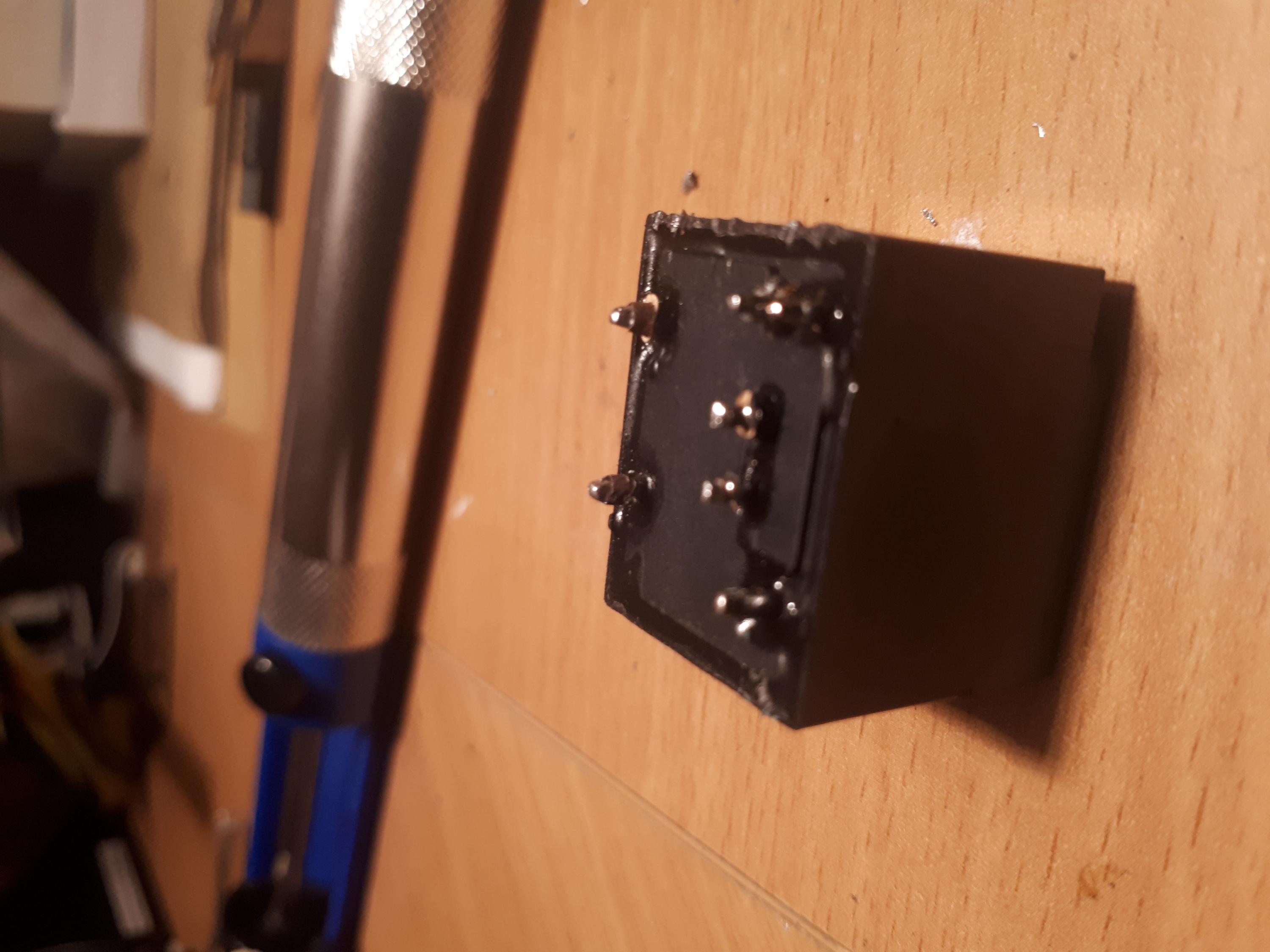

    Relay out. How do I go about testing?
    • redwire
      • Dec 2010
      • 3912
      Re: Speed controller for golf trolley
      This thread has info on how to test a relay: https://www.badcaps.net/forum/showthread.php?t=71359
      Run a 12V light bulb, like a car tail light as a load on the contacts.
      An ohmmeter is not suitable to measure contact resistance, you have to put power through them.

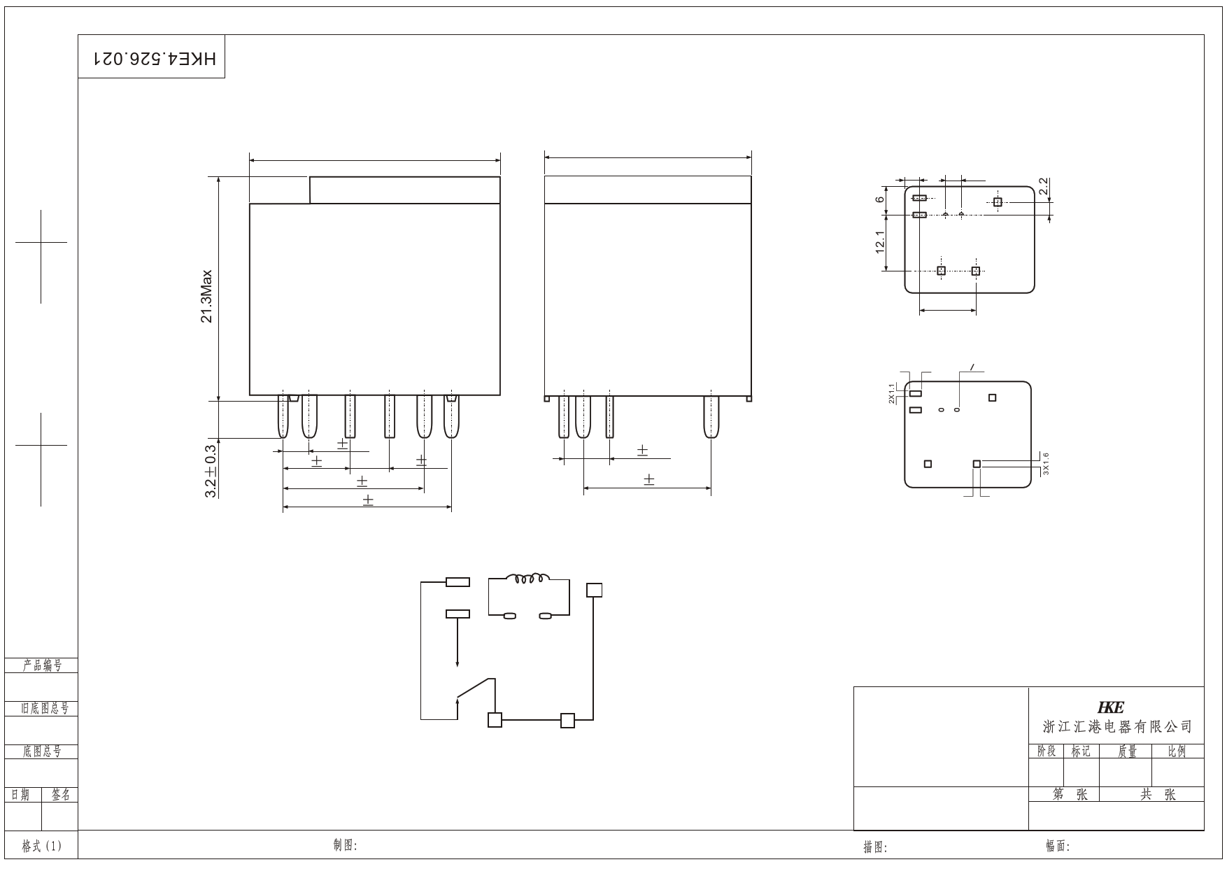

          P/N of the relay will help to locate the pinout of the relay.
          • R_J
            • Jun 2012
            • 9588
            This should be the pinout for the cma4-s-c-e
            Here is a better pdf
              on on relay is it ?
                • 31199
                spdt - unusual pinout.
                • petehall347
                  • Jan 2015
                  • 4439
                  • United Kingdom
                  so like same as this ?
                  • R_J
                    • Jun 2012
                    • 9588
                    #29
                    Except the relay needs to be energized to change the state of the contacts, when power is removed it goes back to the N.C.contacts
                    Unlike your switch which will stay in either position, unless thats a momentary switch

                        Guys if I bought the relay and the mosfets. What else could be wrong with the board?
                        Thinking I might just buy em and stick them in??
                          • 31199
                          #32
                          everything could potentially be wrong.
                          if you power the relay, does it click?

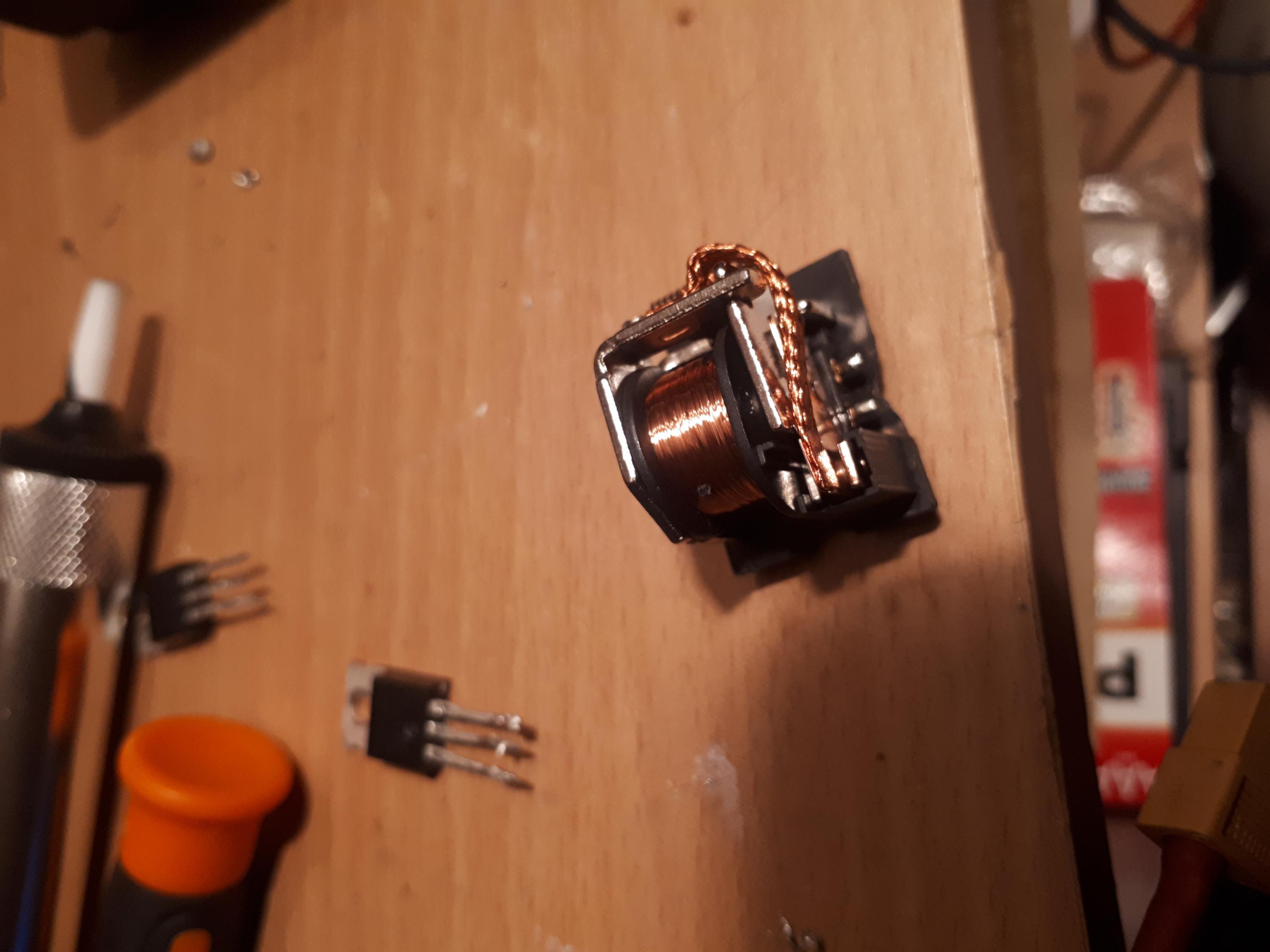

                              Anyone care to enlighten me which points are the positive and negative
                              • redriddick
                                • Dec 2014
                                • 93
                                • Ireland
                                #35
                                Ok so relay is clicking
                                • redriddick
                                  • Dec 2014
                                  • 93
                                  • Ireland
                                  #36
                                  Also fyi. The trolley only moves forward. There is a pentintometer in the handle to adjust the speed.
                                    • 31199
                                    #37
                                    relay clicking - 50% tested.
                                    coil works - now to check the contacts.
                                    i like to open the cover and just LOOK at them - it's a lot simpler than using a meter.

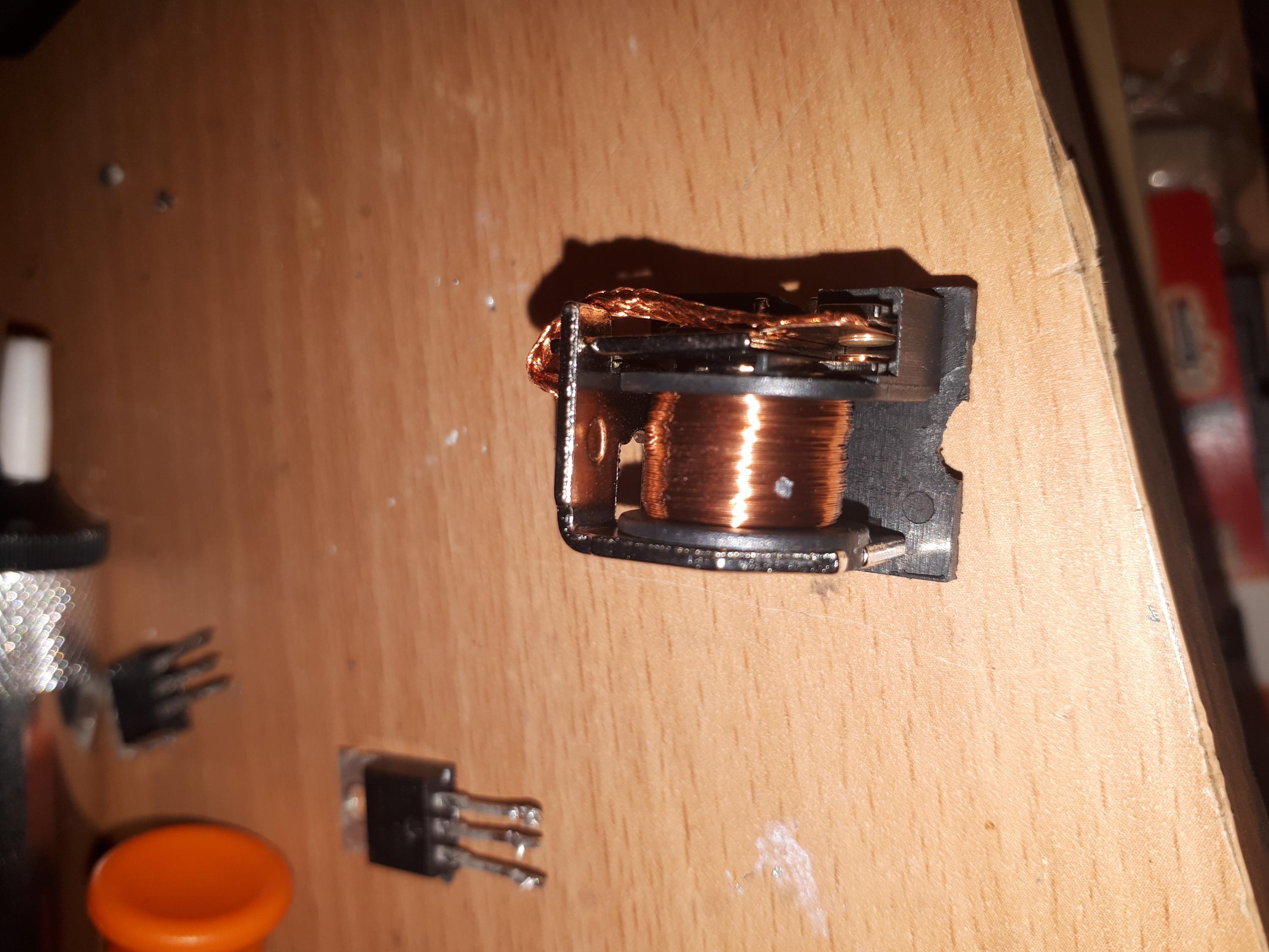

                                      #38
                                      Will open it up later and have a look.
                                      • redriddick
                                        • Dec 2014
                                        • 93
                                        • Ireland
                                        #39
                                        Contacts are like new.
                                          • 31199
                                          #40
                                          then it's good - on to the rest of the board.
