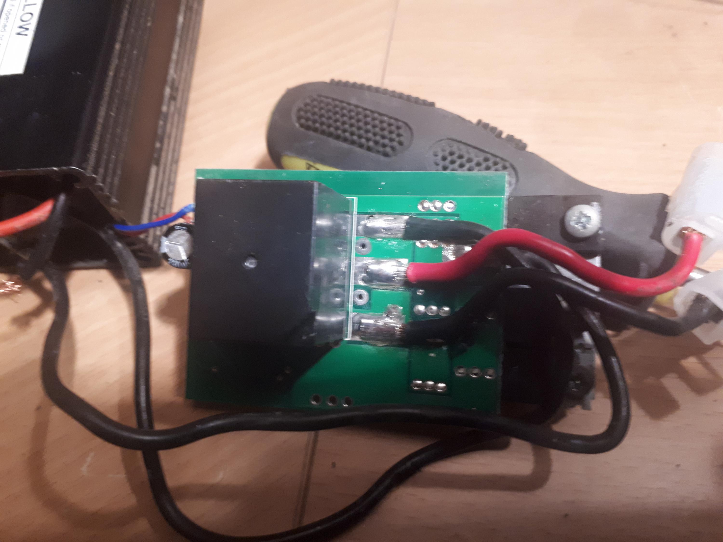

    Hi guys,
    Strange one here. I have a few speed controllers off some electric golf trolleys. They are not working and usually give trouble. New ones are about 80 euro so I said I might give it a go to see about fixing em. I will upload photos later.
    Any help will be much appreciated

                          Re: Speed controller for golf trolley

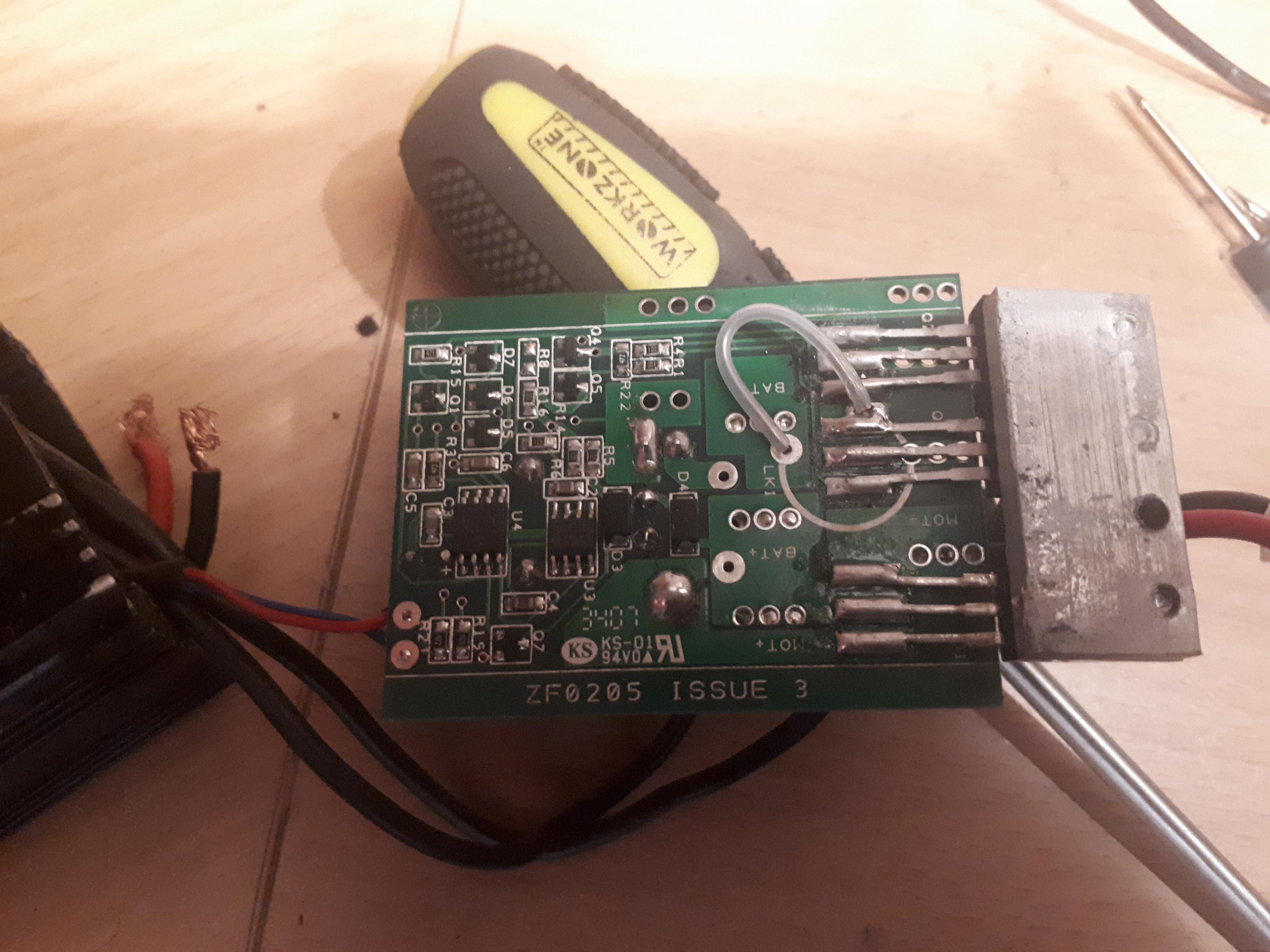

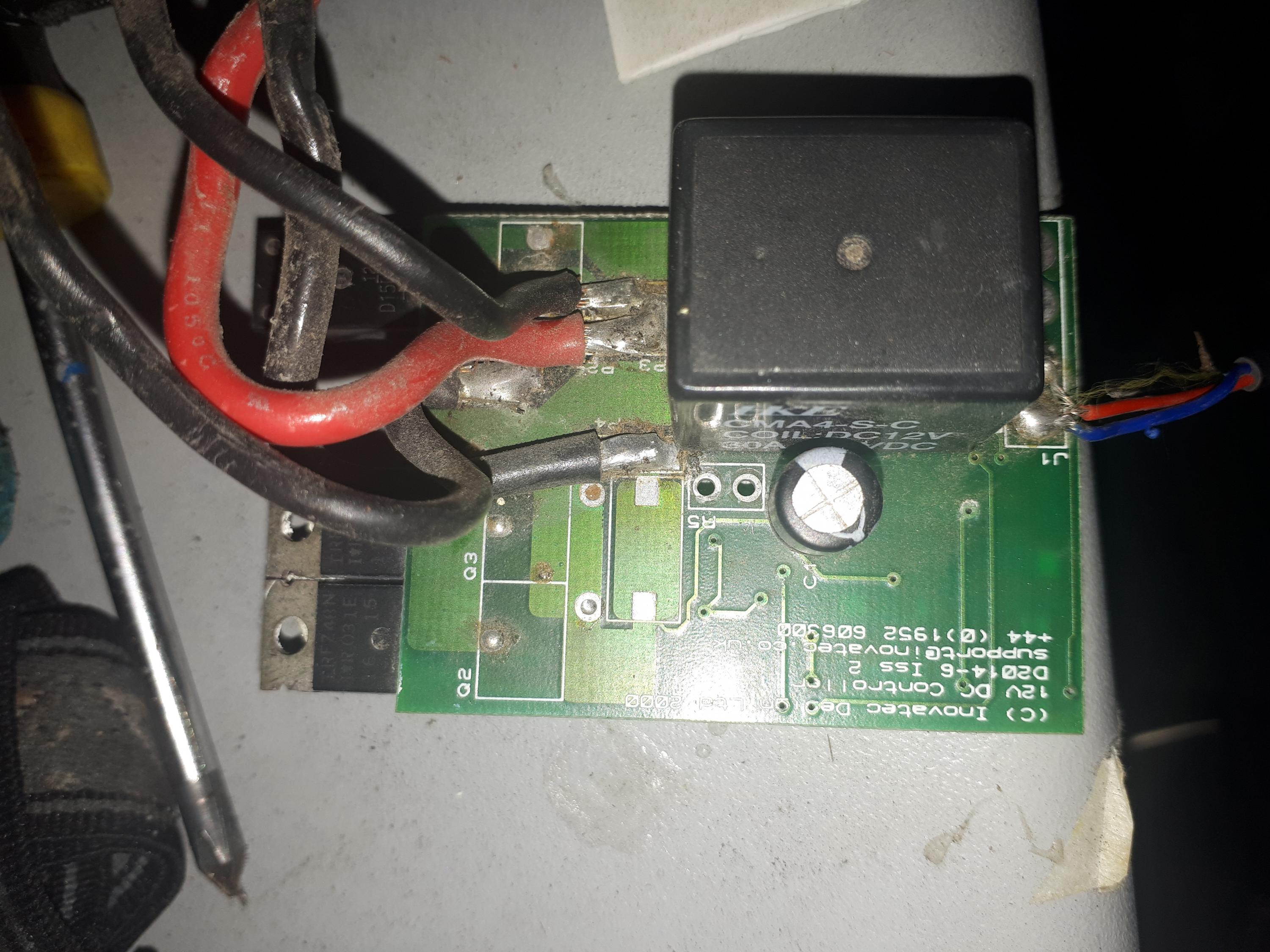

                          Can you post a picture of both sides of the controller board and the motor
                          • redriddick
                            • Dec 2014
                            • 93
                            • Ireland
                            Pics of one of em attached
                              • 31294

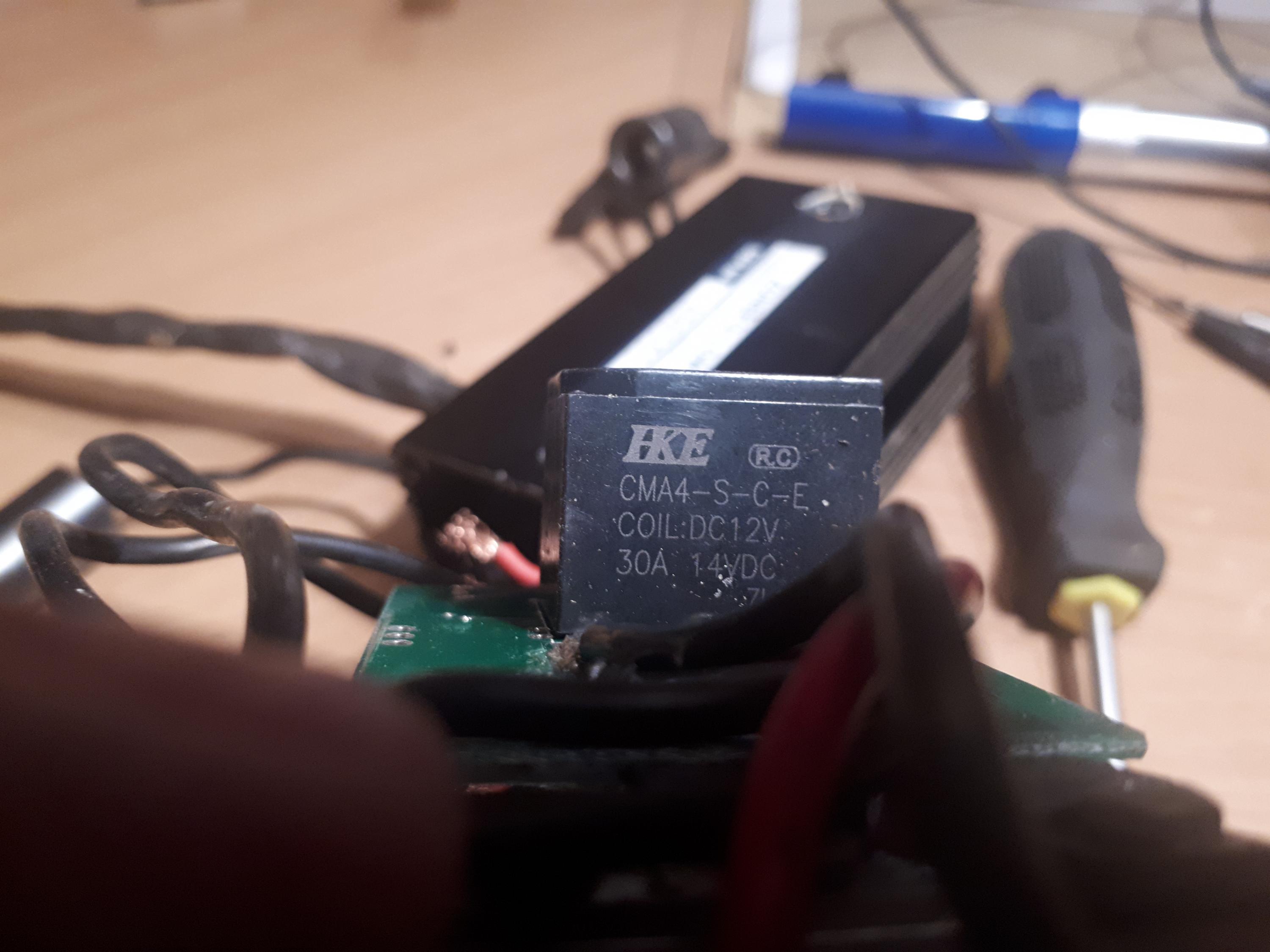

                              start by removing all the flux & shit from water ingress,
                              then remove and check the relay.
                              btw, the red & blue are touching - it should have used a connector there - cheap shit.

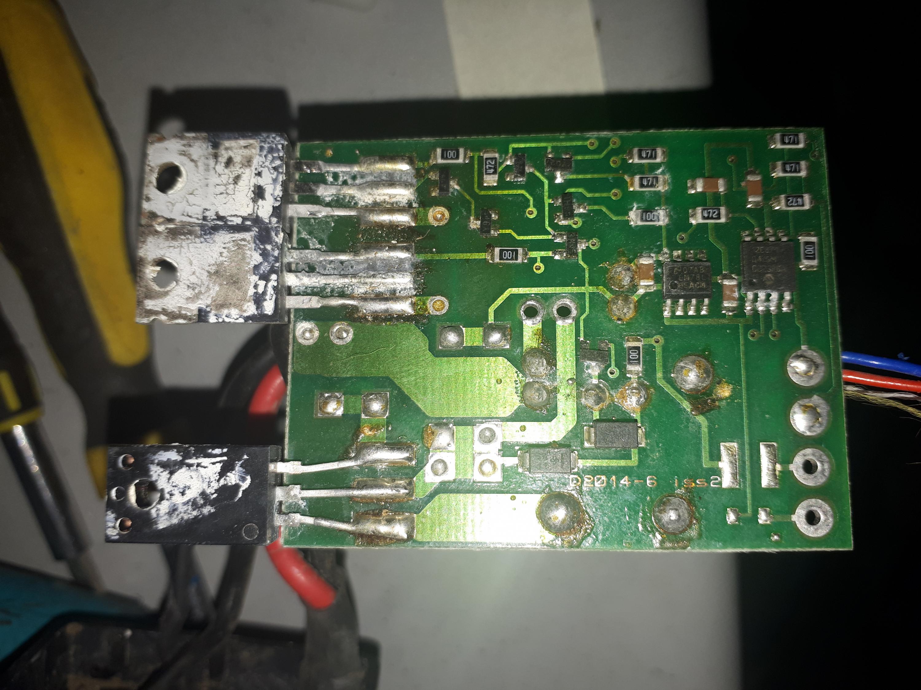

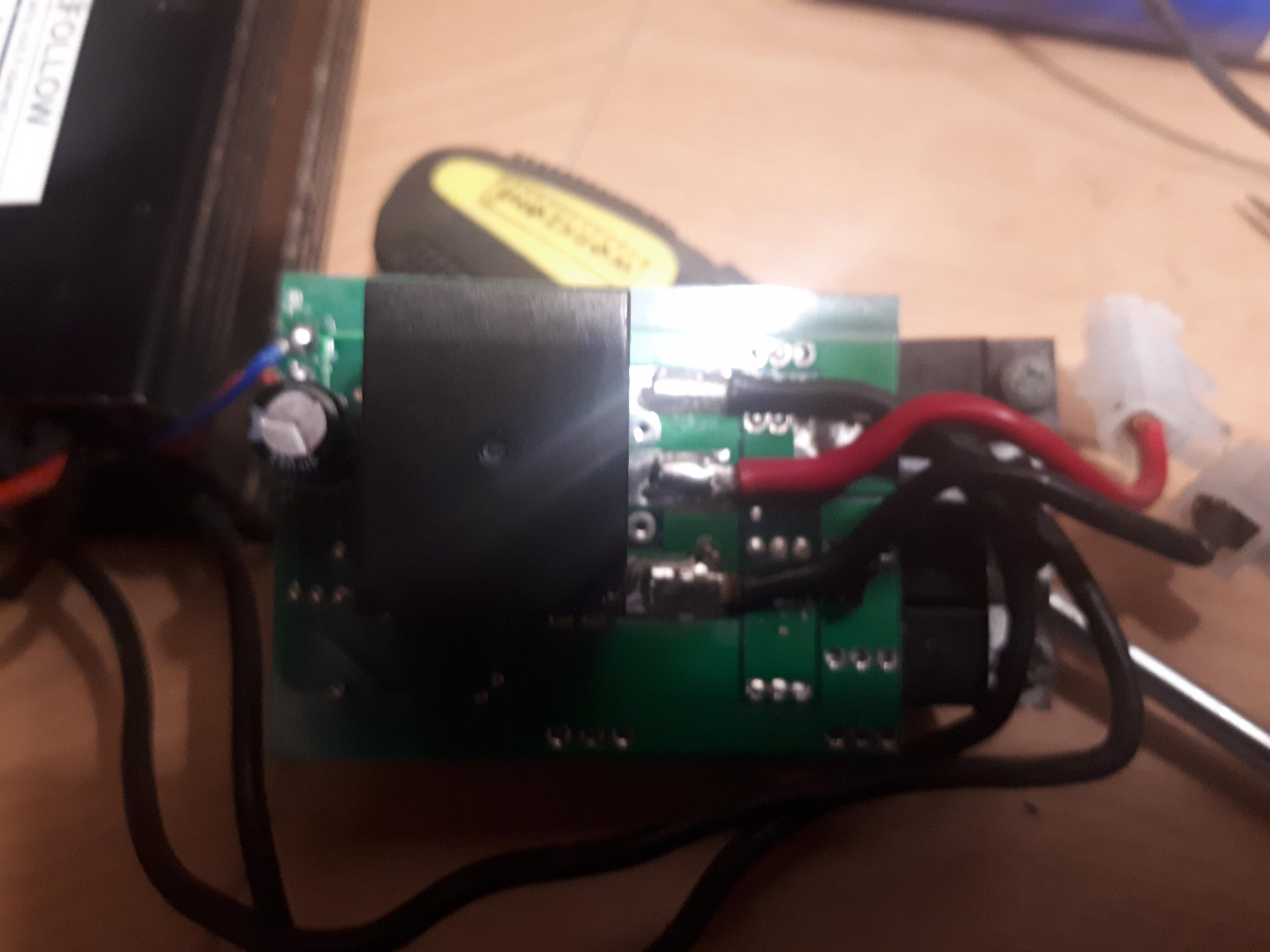

                                Here is another one, which is in better condition.
                                • redwire
                                  • Dec 2010
                                  • 3912
                                  I'd check the two power mosfet's for shorts. The third TO-220 part seems to be a dual diode. Look for 5V at regulator U3 which powers U4 MCU, to see if the logic/MCU has power. I think the relay is part of a half H-bridge for direction?
                                    • 31294
                                    i still suspect the relay - when mosfets short they usually explode.
                                    • redriddick
                                      • Dec 2014
                                      • 93
                                      • Ireland
                                      Tested mosfets and I think they are ok but I really need a new multimeter.......
                                        Will test the relay tonight .....runs to Google how to test a relay
