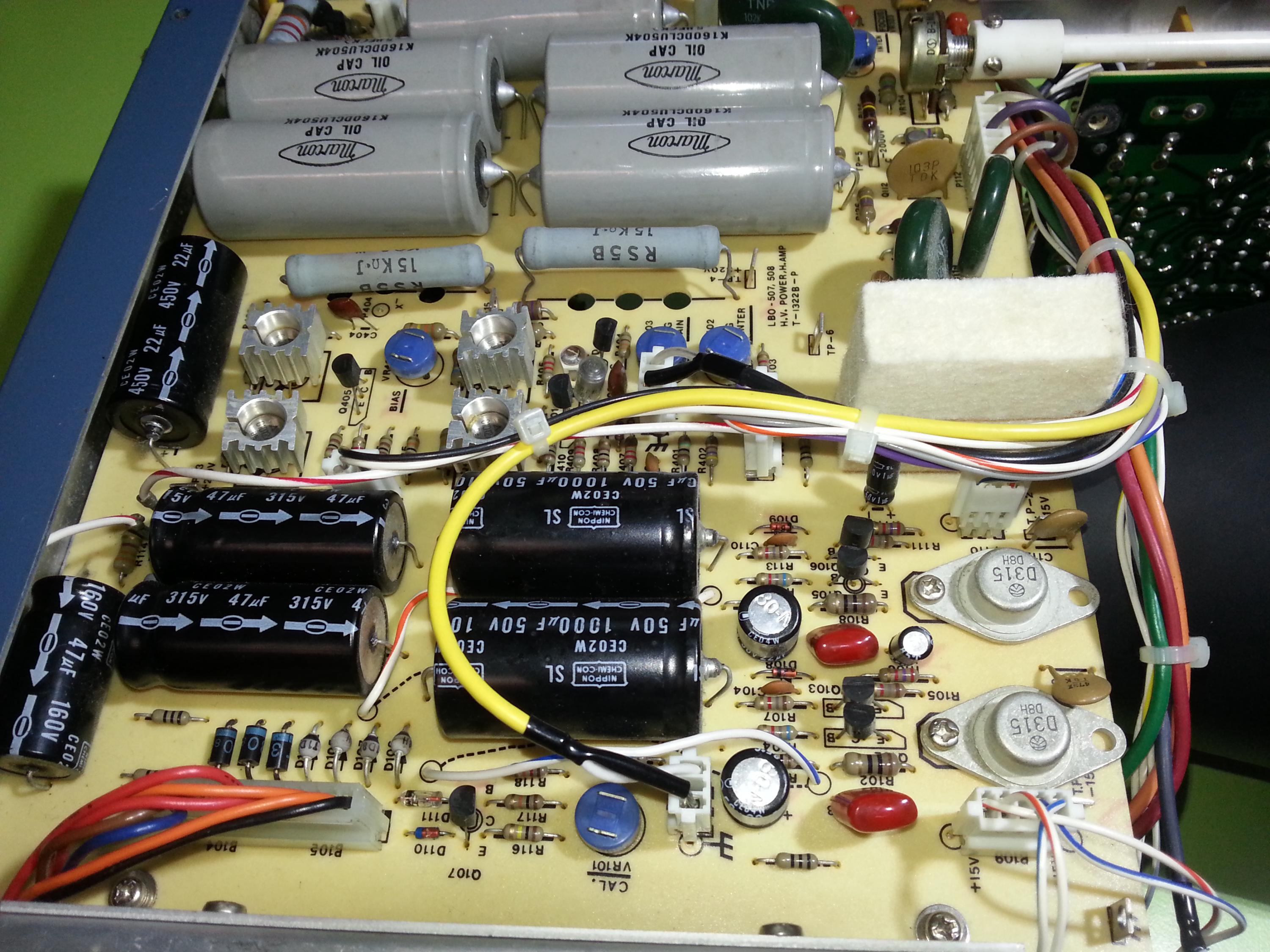

    Good day folks. Some of you may remember that a while back I posted about this scope, how I found it in our junk pile at work and decided to have a play with it. Well in the meantime, my "colleague" took on the challenge himself and wouldn't let me go near it, so I don't know what he's done to it or how it actually behaves, because I haven't plugged it in.
    Now, it has landed on my table at last and he told me "it's got poor sensitivity"...is that a thing with scopes ? "Low sensitivity" ? Now I don't know sh!t about scopes TBH, so it's a learning experience for me too.
    I took a peek inside and noticed two varistors with cracks in them on the board with the large caps on it (see the pics). I swear, I suck at this CRT stuff In the schematic I attached, on page 37, they're D116 and D117. 102K would imply they're 1000v varistors, which the schematic indeed confirms. I couldn't find the exact datasheet, but a fairly close one hinted that I was right: 1000v. They read completely open with my meter. Now why would they pop ? From what I can assume: the transformer on the left (PT101) chucks out 930v. It goes through the large C117 "oil capacitor" and into the string of diodes which rectifies it in negative, so only the negative peaks go through. For those to pop, it would mean the voltage went higher than 2000v, which is what the little label tag TP.5 tells us it's supposed to be on that point, so perhaps it was a simple overvoltage scenario, since I don't see any regulation to prevent it: it relies solely on the stability of the mains input. Any fluctuations on the mains will show up on the output on that X-former, thereby affecting the point after the diodes too. If it got a surge on the primary hard enough, the secondary voltage could've ramped up....just a theory.
    Aside from that, since that's certainly not the problem (I'm betting it would work without the varistors entirely) what should I look out for in a generic sort of way ? Any specific parts on old scopes that go bad faster and easier than others ? It's only a speculative discussion at this point since without plugging it in and showing you chaps what it actually does, it's hard to pinpoint. Photos are pretty random too, since there's a lot of space to cover and I didn't catch everything. I can provide better ones if needed. Cheers guys. Thank you.
    Wattevah...

    Re: Leader lbo 508 oscilloscope help
    vdr's can fail with age,
    desolder them and meter them - i bet they show resistance.
      I did but they don't: no reading at all, so that's why I'm saying they're "good". A friend of mine who's also into electronics and who owns an electronics supply shop from whom I wanted to purchase replacements said that's just the coating cracked due to heat and not actual damage, so they can be reused as such or even omitted entirely, which I agree: they're not the problem here, since the chap said the scope does turn on but doesn't behave properly...I'm guessing it doesn't show the correct values or something...
        I agree the the varistors are likely ok and just the coating cracked, Find out what the problem is. Likely dirty switch contacts due to the lack of use.
            NO don't run it without the varistors.
            They are used as high voltage zeners for the scope, and in the HV power supply as a shunt regulator.
            The Marcon oil-filled caps are probably toast, they do not last for some reason.
                See if this helps, the voltage is kind of missleading 102k 1000v @1mA
                This page seems to lists the toshiba http://ashop.bg/termis-pozis-varisto...a-toshiba-1fxg
                This looks close TND14V-102KB00AAA0 (Page23)
                  make sure you dont use smaller ones, the size is an indication of the energy it can clamp.
                    I think TNR 15 series is 17mm dia.? Bourns MOV14D pdf 14mm but diagram shows 16.5mm max dia. and all I see for 1kV parts, no larger but maybe Epcos has some.
                    Testpoint TP-5 is -2,000V so D116 and D117 are 1,000V varistors.
                    102K015 1,000V@1mA MOV-14D102K
                    820K015 820V@1mA MOV-14D821K
                    681K015 680V@1mA MOV-14D681K
                    561K015 560V@1mA MOV-14D561K
                      How are the other two mov's D118 & D119 ?
                      This site has some info also (the lbo508 they repaired uses 681k in that location) https://www.eevblog.com/forum/repair...oscope-no-crt/
                      These might be the ones TNR15G102K United Chemi-con

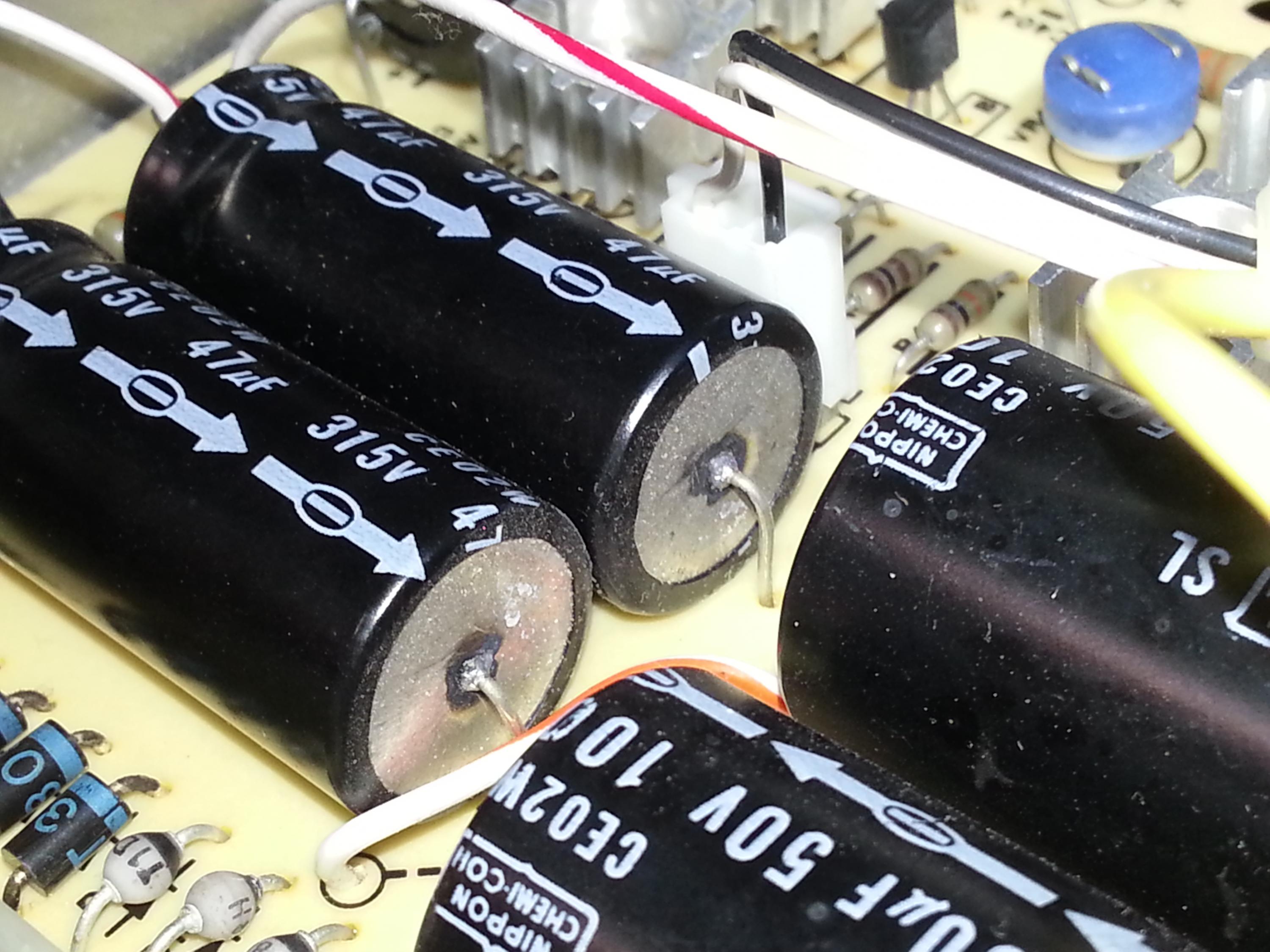

                          Here's another thing I noticed, though again, I'm not sure it's entirely related: some of these Nippon Chemi-Cons have this black....stuff at their ends which seems to rub off if I try to wipe it, so could it be they're going bad ? Again, it's likely not related to the main issue, but still...in fact I put back the varistors at my "shop master's" request....on your head then, pops Haven't tried it yet...still waiting for his "signal".
                          Wattevah...
                            • 31002
                            the black is oxide from the spot welds.
                            those may be fucked btw,
                            in my experience low value high voltage caps fail relativly fast.
                            • redwire
                              • Dec 2010
                              • 3906
                              That looks like splatter from the (-) weld to the can.
                              I think with old electrolytic caps the first failure-mode is drying out, as the rubber bung shrinks and leaks with age?
                              They probably need reforming if the scope was sitting for years.
                              Anyone know why the Marcon oil-filled HV caps fail? They go low value and I thought oil doesn't evaporate easily. Unless they are an oil/electrolytic hybrid.
                              "Established in 1942 by the Toshiba Corporation, Marcon Electronics Co., Ltd. was acquired by Nippon Chemi-Con in 1995."
                              I would recap the scope, those caps are all pretty old.
