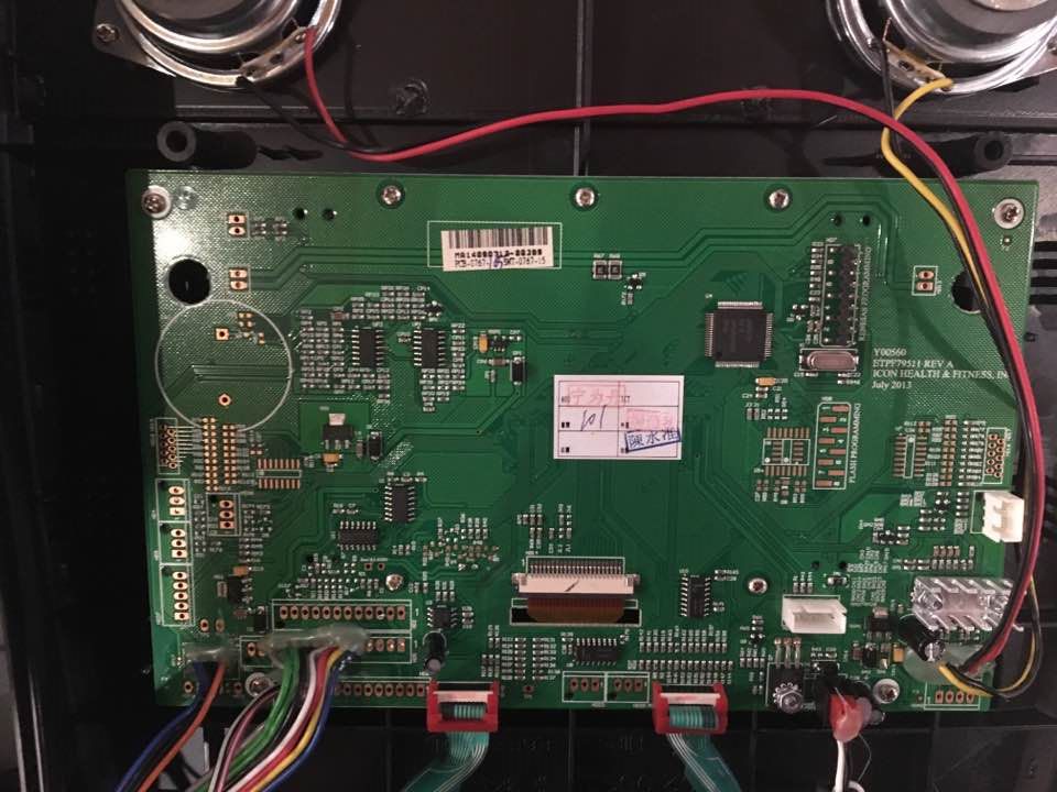

              Re: Like New Nautilus Exercise Bike has Dead Panel
              Can I see good clear straight shot of the console board?
              • vestaviascott
                • Aug 2018
                • 100
                  Too blurry to me to read anything on the board, see it for your self what you can see in that picture.
                  I am trying to locate Voltage regulator IC's and some Voltage test points on that board.
                  I think I can see one 3-pin regulator.
                        Pictures are too poor, there has to be regulator some where on that main board.
                          I'm taking these with iphone in HDR mode. I'll try again this morning with a lens over the phone to see if that helps. I will also take 4 zoomed quadrant shots of the main board. Coming up!
                          Really appreciate the help.

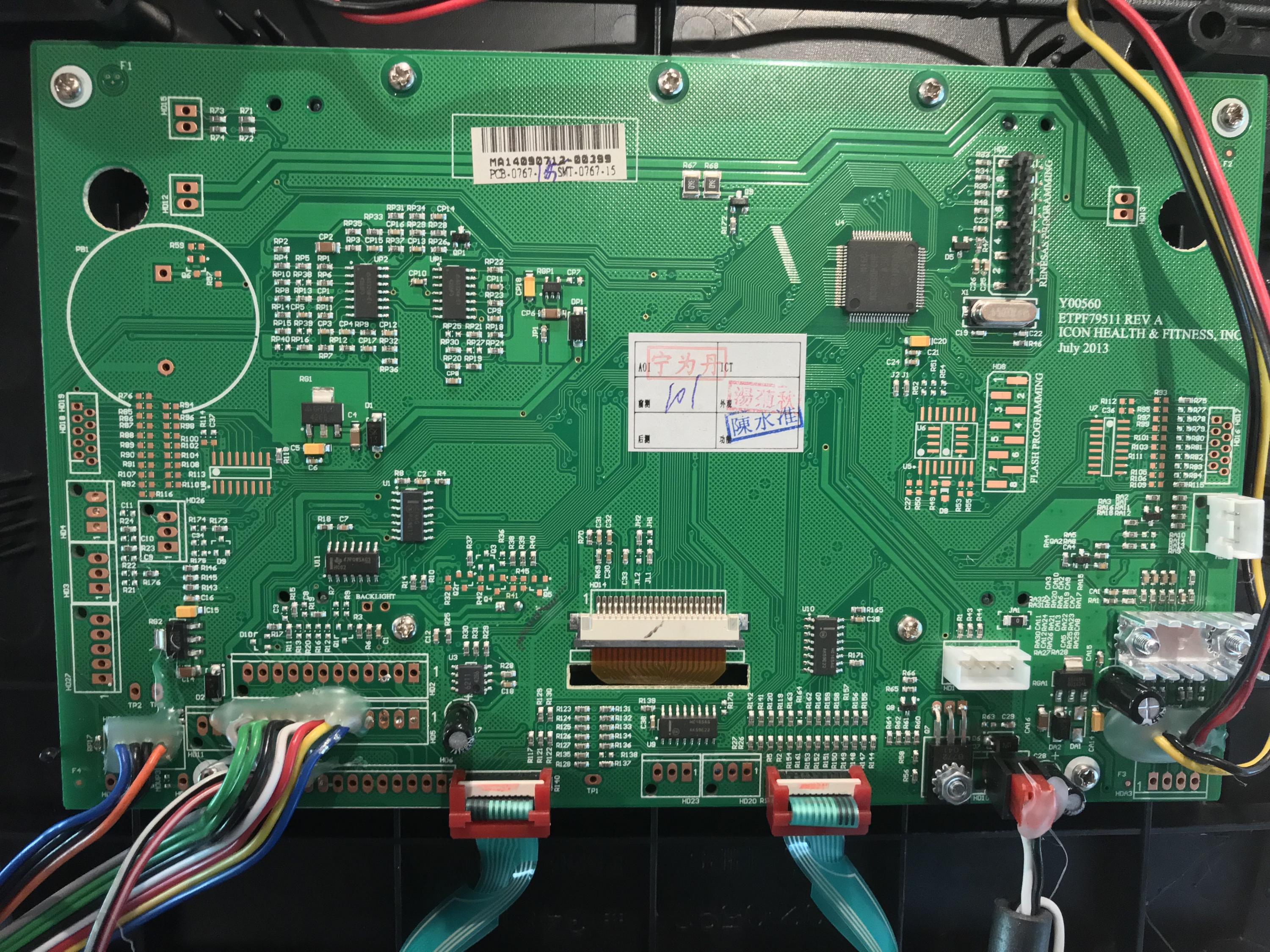

                                Here's an ultra high res shot I took from my wife's iphone 7. THIS IS THE MONEY SHOT!

                                    #37
                                    That is better!
                                    I see 3 regulator IC's RG1, RG2, RGA1, please get the P/N as printed on them, then check the DCV on all 3 pins against GND (you can use HD2 pin 1 empty connector pad for GND ref. point).
                                      Awesome. Here are the P/N's:
                                      RG1 = 3940M3 501434L
                                      RG2 = GH16D 4266J2
                                      RGA1 = 3940M3 501434L
                                        ...then check the DCV on all 3 pins against GND (you can use HD2 pin 1 empty connector pad for GND ref. point).
                                        Are these the right test lead placements?
                                          yes. Basically there are different voltage rails for different IC's to work. So, you got some thing like: 5V, 3.3V, 2.5V and 1.8V.
                                          1st pin is power input, 2nd pin is GND or ADJ and the 3rd pin is power output.
