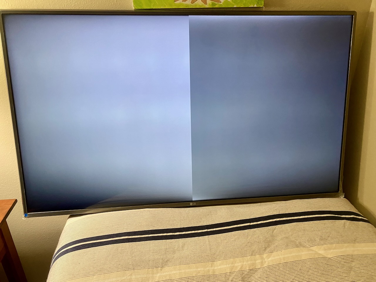

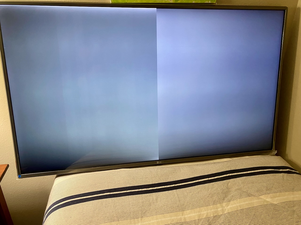

    LG 49UJ6500 LCD panel lighter band that goes away

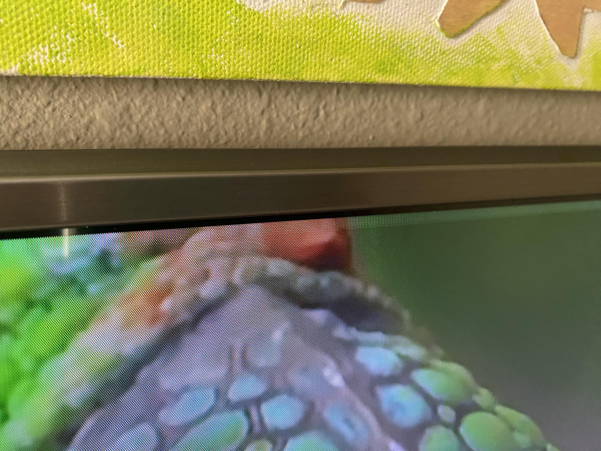

    49UJ6500 LCD panel has a lighter band on top when first powered on. Goes away (or gets much fainter) after TV on for a few min. After powered off for awhile and power back on, same band appears. If powered on immediately after powering off, no or much fainter band. Running the latest firmware.

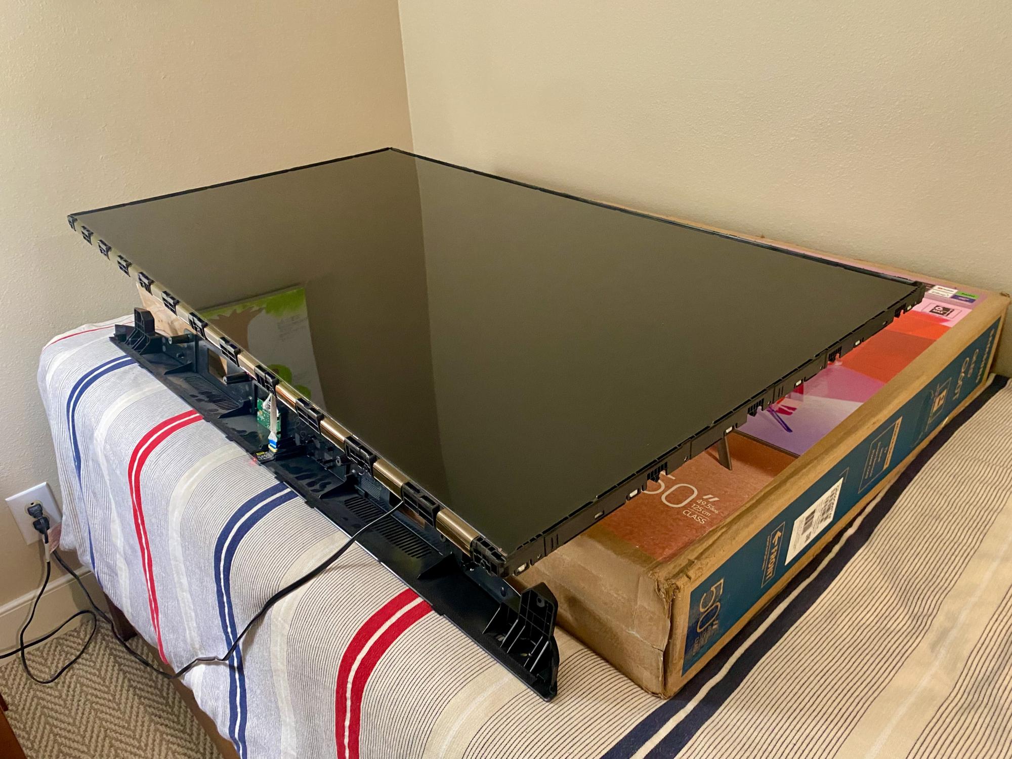

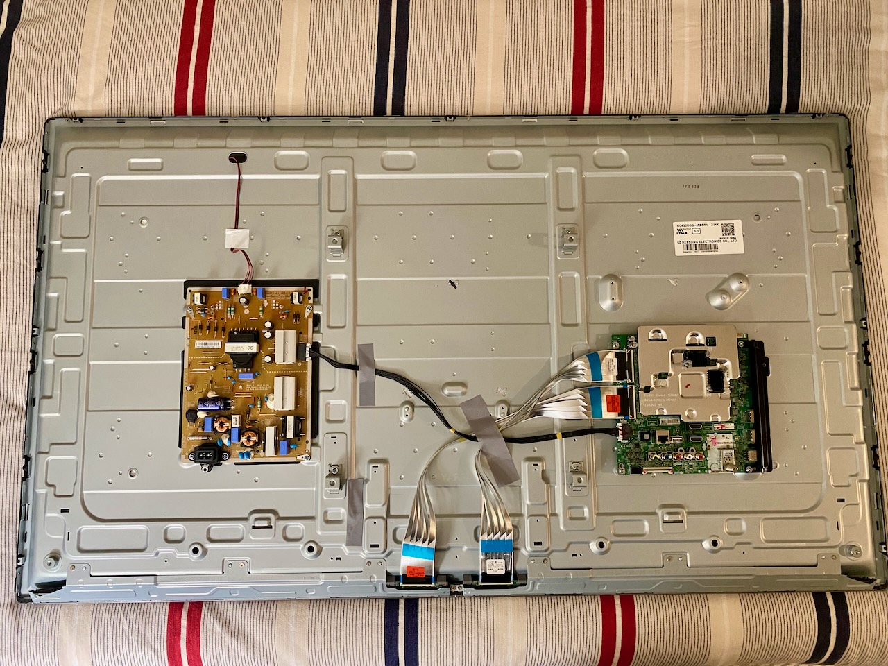

    Disassembled the TV and lifted the LCD panel during testing. Band is on the LCD panel (can see the band on the panel as I lift it slightly) Backlight is perfectly even at the top edge. Double checked LCD panel alignment in the frame and is perfect but since band moved with the panel, its on the panel. Reseated both ends of the 2 T-Con flex, no change.
    Have seen similar on 2009-2011 Apple 27" LCD panels made by LG. Those will exhibit lighter band on left edge if not used for awhile. Goes away after awhile and don't come back as long as the i27" Mac/Thunderbolt display (these devices use this particular LG panel) is plugged in
    Anyone know what this is? on the Apple 27" LG LCDs, panel seems to want some current flow to get rid of this problem. Appears similar on this TV panel.

    Re: LG LCD panel lighter band that goes away

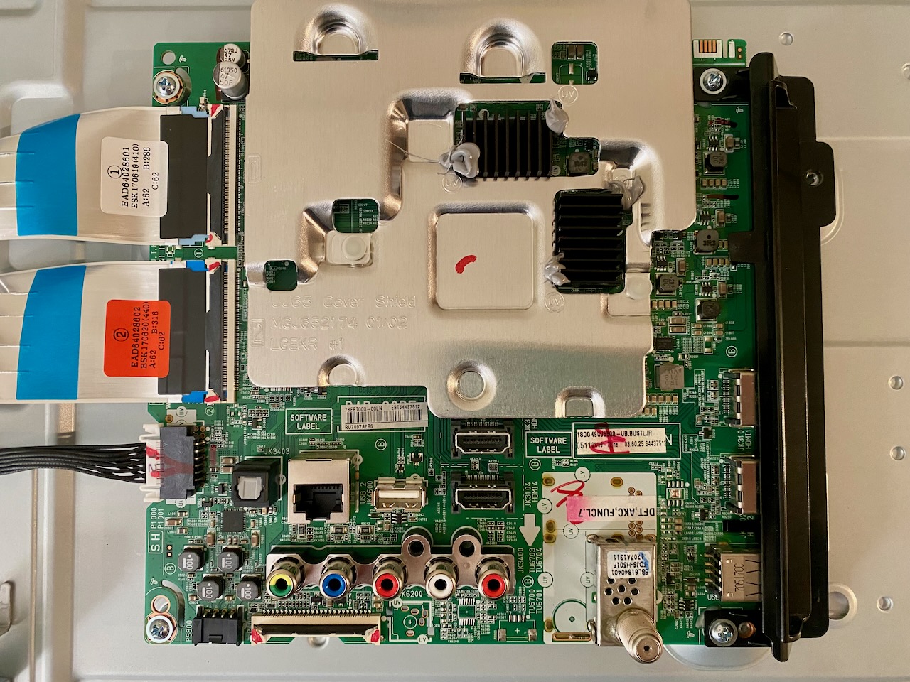

    Try to disconnect the harnesses going from the main to the matrix in turn. Will there be this stripe on each of the halves of the screen.
    • howardc64
      • Jun 2017
      • 652
      Looking at the screen
      Left side T-Con flex removed (white stickered flex)
      Right side T-Con flex removed (red stickered flex)
      When plug both T-Con flex back in, only right side shows band. Eventually becomes faint and disappears after few min.
      Looking closer at the band with magnifying glass shows its pixel color error. So maybe t-con section on the main board

          The fault is mostly on the panel's gate drivers, are them of COF type? Therefore side tabs?
            Hair dryer heat sink area near T-Con connectors and turn-on TV. Perfect pixels at the top so definitely thermal related on main board.
            I'll try reflow next. Have pre-heater, good hot air station, no residue flux for BGA reflow and toaster oven (haha). Toaster oven has been the easiest in the past... less chance of over heating but I guess stresses the whole board.
              Reflowed. Seems to make no difference. Hair dryer different parts of main with heatsink off, no difference.
              When remove both T-Con connector from main, sometime lines/band appear and repeatedly do this while power cycle. Sometimes no line/band appear and repeatedly do this while power cycling. Gently pressuring upper panel corner doesn't change top lines/band.
              Strange.

                  4K panel, no side COF tabs. Took off bezel
                  • Gently pressed upper corner and all along left and right edge.
                  • Pressed panel bottom COF tabs on panel and on driver board.
                  No difference.
                  Tried taping both T-Con flex connector in various locations. No fix.

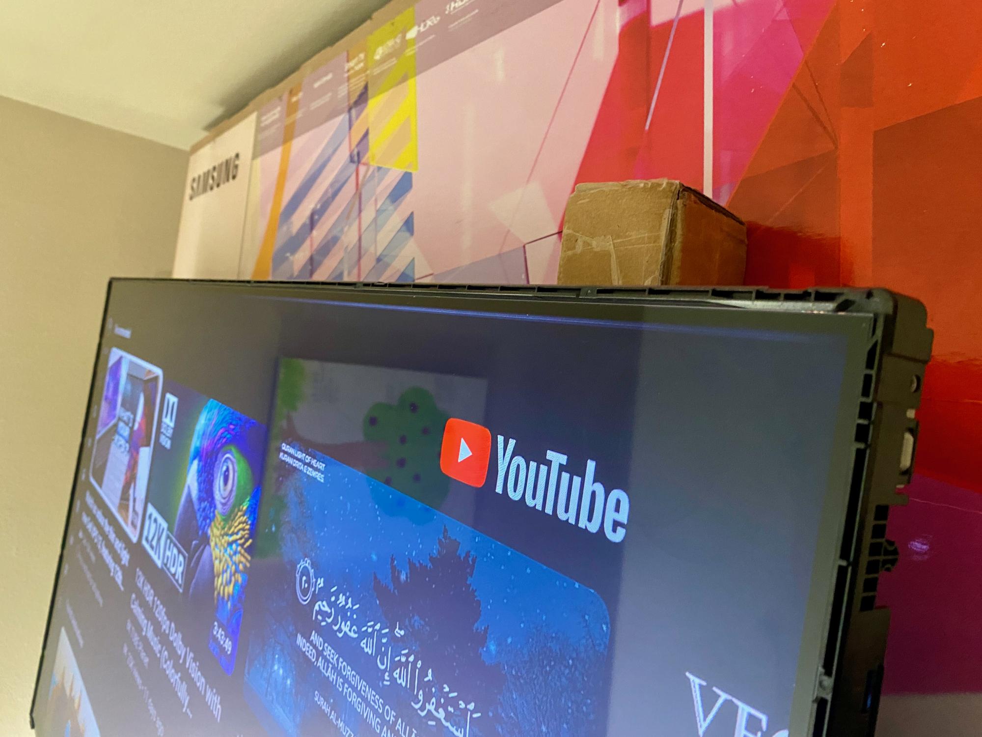

                    Looked up Apple 27 LG LCD bright line problem since its common. A poster comment its from IPS overbias
                    https://www.ifixit.com/Answers/View/...ears+in+corner
                    This LG TV is IPS panel so decided to run the following youtube IPS panel exerciser
                    https://www.youtube.com/watch?v=BFUv...0jimbojones000
                    Stopped the video @ 20min. Solid bright colors would have brightness flicker afterwards (not my eye, wasn't looking at the test before turn it off) which eventually steadied. Turn off the TV for an hour and back on, lines are gone! Only changes are
                    Heat sink back on main board with 2 spring clips
                    Ran IPS video exerciser
                    Turn it off and back on after 20-30min. No more lines...
                    Put the rear TV panel back on, moved to different room. Lines are back.... But of course lines fade after running the TV for a few min. Perhaps I'll just leave it this way.
                    Strangest problem.
                      Think I finally found the failure and non failure mode. it is EXACTLY same as 2009-11 Apple 27" LG IPS screen failure mode.
                      If TV is plugged into the wall but powered off. After a couple of hours, no more lines on future power-on
                      If TV is unplugged for just a few min. Next power on will have lines.
                      This is similar to my Apple 27" IPS screen experience. I have seen many all with same behavior.
                      This behavior is the cause for confusion while diagnosing this problem. Power connection is constantly being unplugged during various disassemblies and test while chasing various suspected causes. I only discovered this after stopped assembly/disassembly/moving the TV which all required unplugging the PSU.
                      Anyway, don't know why but these LG IPS panels is either getting some power or avoid discharging completely with the TV plugged in but powered off.

                                  • howardc64
                                    • Jun 2017
                                    • 652
                                    Re: LG 49UJ6500 LCD panel lighter band that goes away
                                    An interesting update. The light band seems to have gone away...
                                    After plugging the TV in for a week and using it (rarely and briefly). Unplugging it for 2x 24 hour cycles didn't result in band appearing at the top anymore.
                                    Interesting result. I guess something takes many hours to fully charge up or discharge haha.
