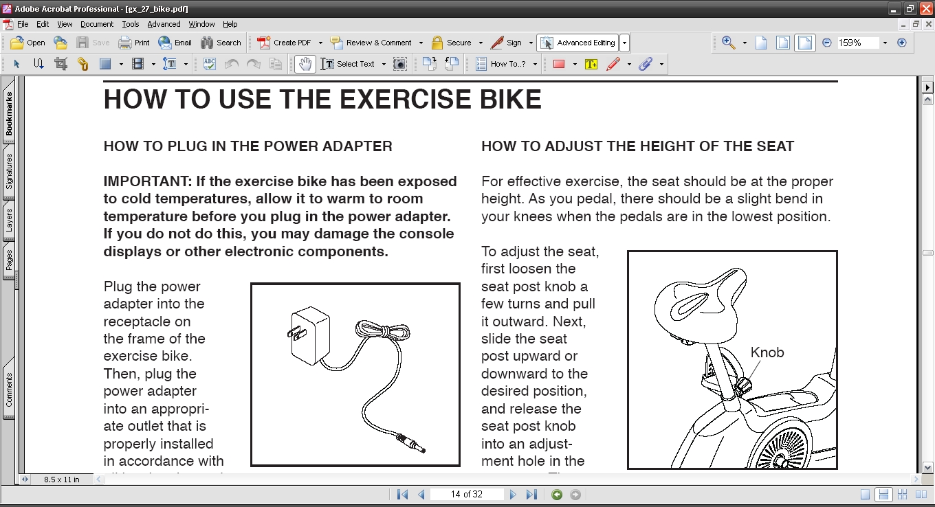

    The power requirements are 9 volts 2 amps:
    The power adapter (bought from Amazon. The bike came without a power adapter):

    1) So the red power connector has 3 wires? RED/WHITE/BLACK red?
    2) Is that the correct power supply? Did you verify the polarity requirement of the center pin?
    3) Where does the power supply cord go to? I do not see which connector it fits into.
    4) Pictures #6 looks like the terminal for the Black wire with white stripe is coming off the connector.

      First thing you'll notice is that the power adapter has *two* conductors -- the outer "sleeve" and the inner contact. The illustration on the adapter shows that the sleeve is "-" and the inner contact is "+". (Get this polarity wrong -- backwards -- and you'll likely toast whatever you plug it into!)
      With your VOM/DMM on the ~20V DC scale, you should be able to verify something akin to +9V (undoubtedly HIGHER!) is present when you insert the positive DMM lead into the inner contact and hold the negative lead against the outer sleeve.
      If you don't see voltage (and the correct polarity), your adapter is defective (unlikely given that it is "new"). Or, you aren't making good contact with one or both DMM leads.
      If you see a negative voltage, then you may have the leads swapped at the DMM (red is positive, black negative).

                                  As you can see in your post # 1 & 11, you show someone else picture (FRP?) of the DC input jack which we cannot see how 3 wires are soldered to the DC input jack, you need to show the pictures of your unit.
