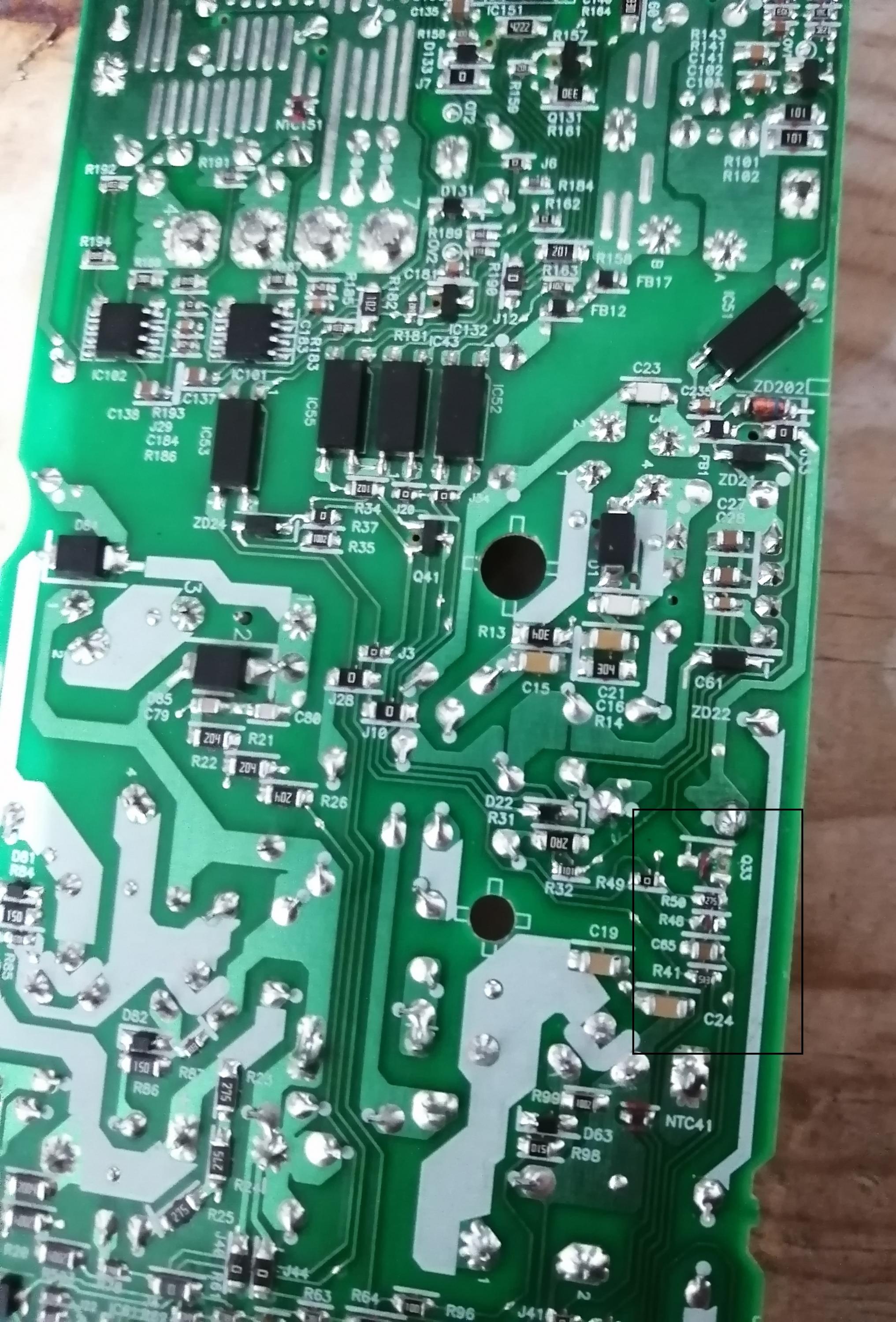

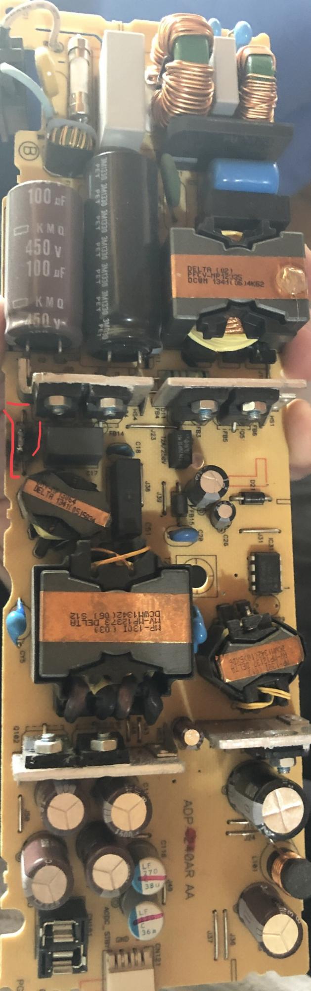

    hi, does anyone know the value of this resistance located in F3?

    im not sure but maybe ask on this group f3 i think is a fuse have you tested other parts for shorts as thats parts blown for a reason.

      Re: resistance burned adp 240 ar power supply ps4

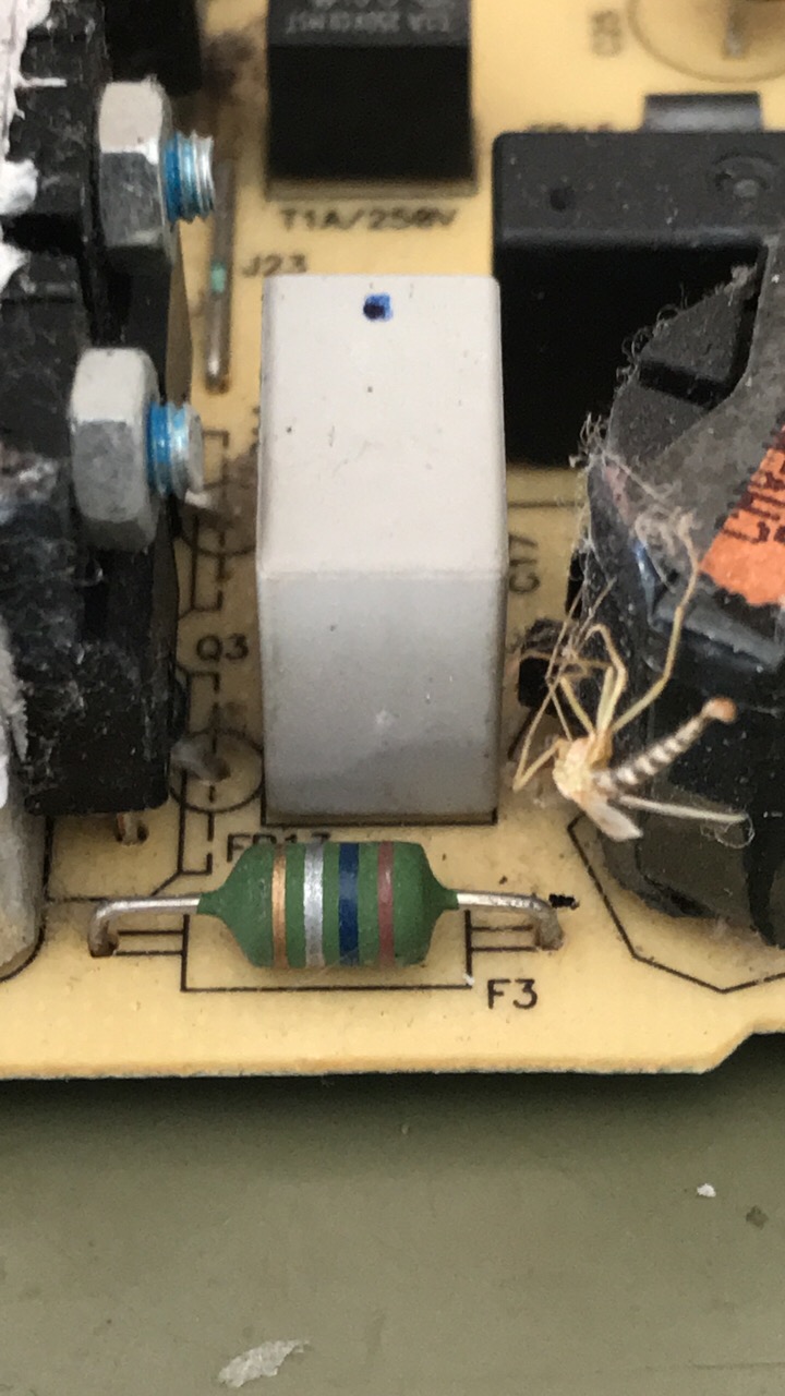

      I've got a ADP 240CR here.
      Colours look to be brown, blue, silver, gold. Has continuity like a fuse.
          is it a fuseable resistor? just wondered by the f marking on the pcb so 0.16 or 0.26 ohms 0.5 watt i guess

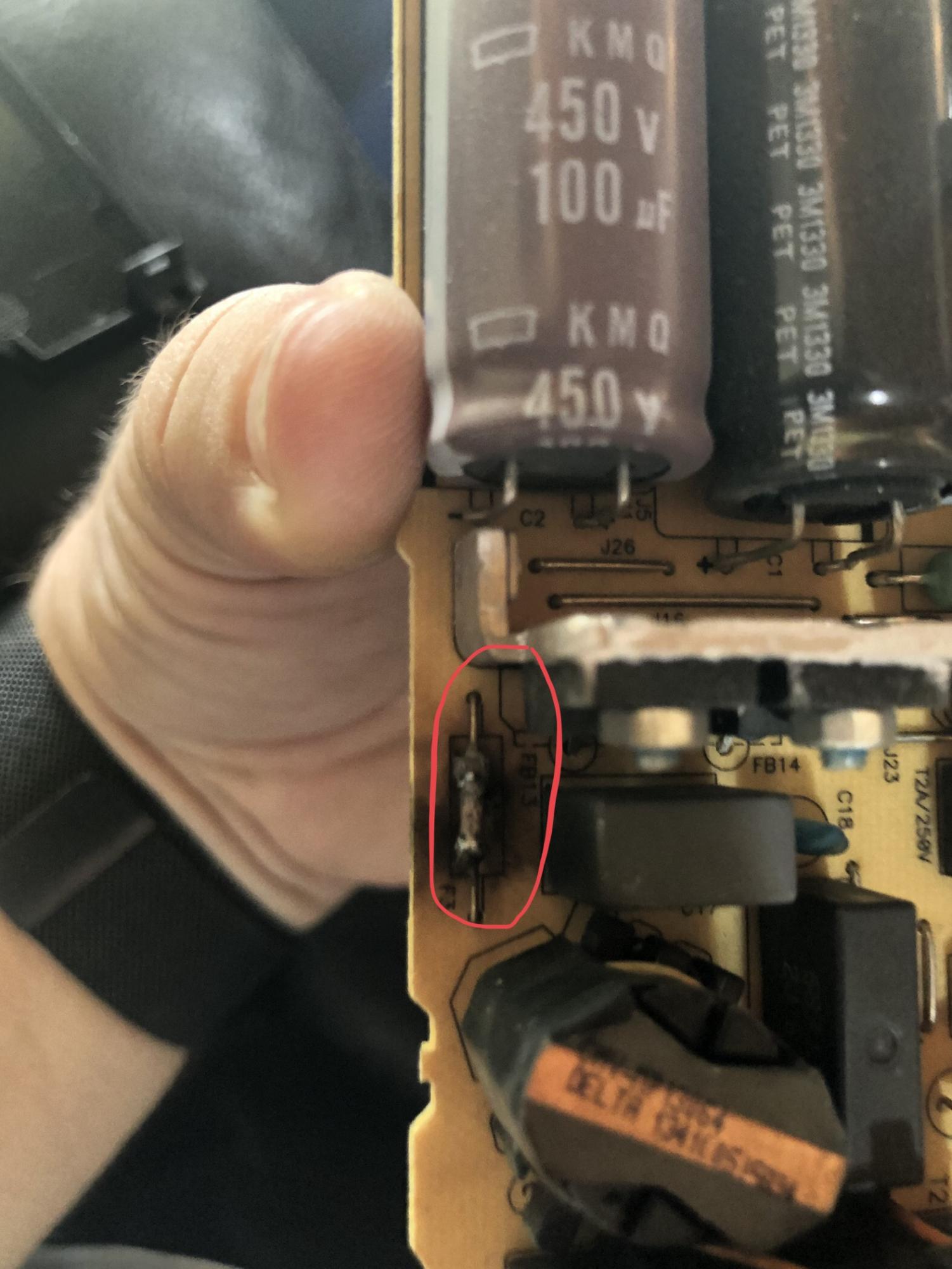

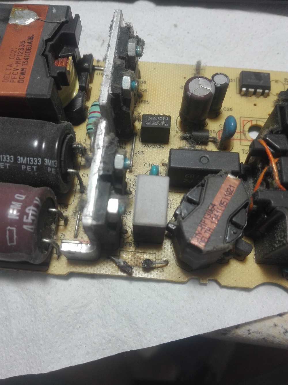

            Here's a pic. And I have some if you need it. Did you repair what caused it to blow?

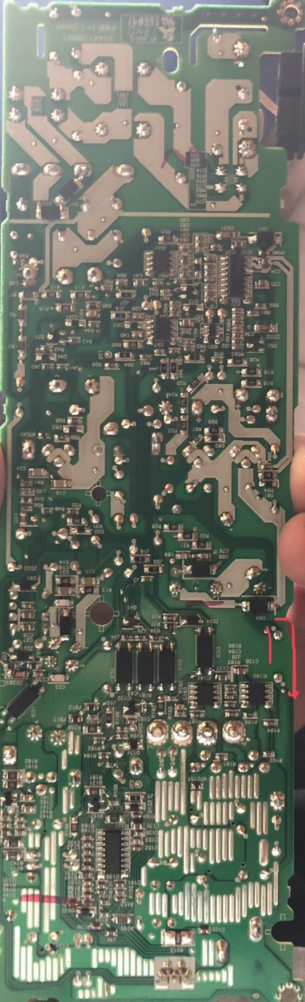

              You should upload good clear hi-res straight shot pictures of the whole top and bottom side of the board so we can see how that resistor connected in the circuit.
                thanks to all, is a low resistance 0.16 ohms that serves to protect 2 mosfet q2 q3 with the initials TK12A60U, these are short, check also IC DDA001AG that is not shorted to be successful
                    Originally posted by Twobit
                    Did you have a part number at all that I could use to search at Australian stores (jaycar or rs-components)?
                    I tried looking on RS components AU, and couldn't find anything that matches for you. Even eBay didn't offer that much choice, which was a surprise to me. But I imagine if you can't find a 0.16 Ohm 2W or 3W metal film resistor there, perhaps going with 0.15 Ohm 2W or 3W metal film should be OK. Just make sure to go with metal-film, as they are typically flame-resistant/proof and/or fusible.
                    Also, that resistors seems to be connected to the MOSFETs for the main PS section (Q2 and Q3), so those might be blown too.

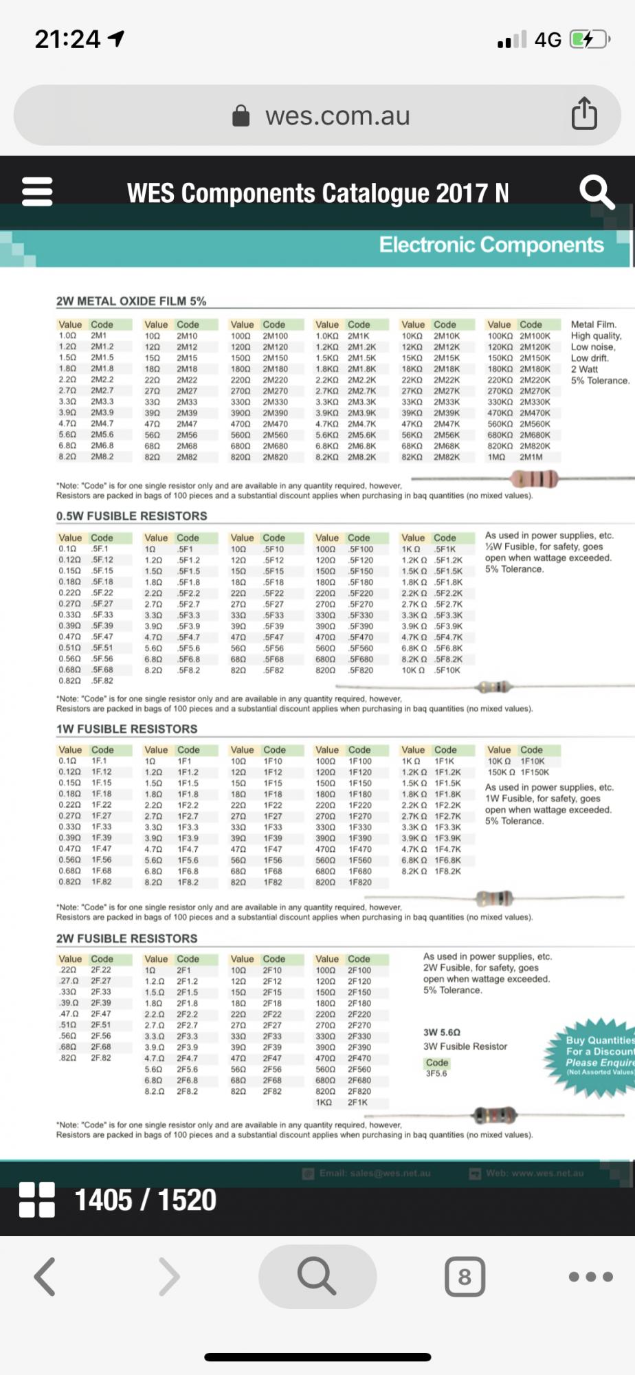

                      Thanks for the help. I found a few places (sadly interstate so $10postage) which have the Fusable Resisters. The 1/2W suggested above seems a bit low and looks thin. They have 0.15 and 0.27 ohm options which seem close enough given a 5% tolerenace. I am just unsure on the wattage.
                      The attached image is from the distributer the shops I found are wagneronline.com.au and aztronics.com.au.
                                Originally posted by Namen Victor
                                Mine has no Continuity, and no burn marks. Can I replace it with a Wire ?
                                No.
                                Those low resistance resistors have a very important purpose - they allow the controller to determine how much current is going through the primary side. They are also usually fusible, meaning they (should) go open-circuit to protect more damage to other parts.
                                Replacing it with wire is not a good idea, even just for testing purposes.

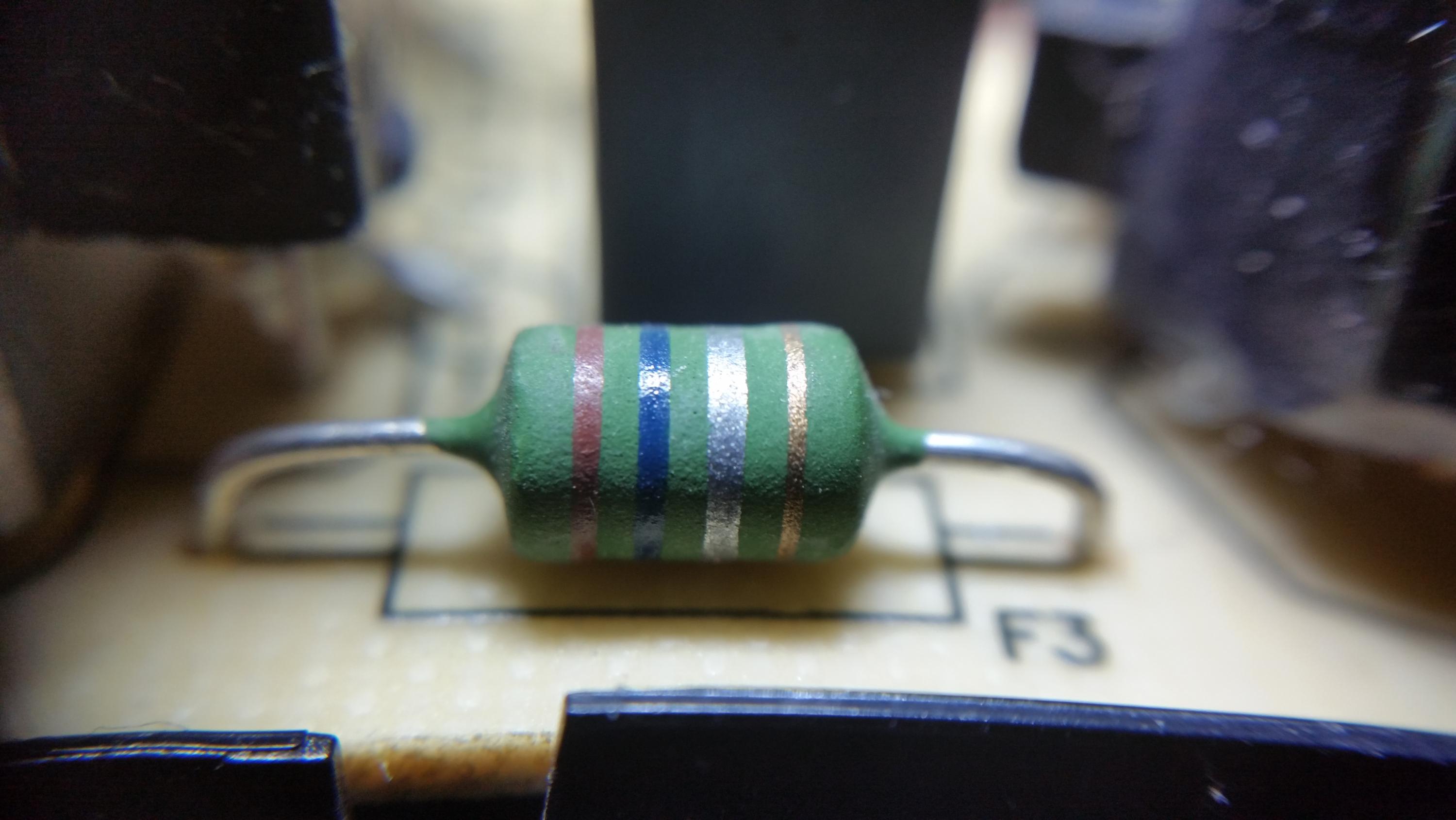

                                  Hello, I have a faulty ADP-240AR for which I had to replace two mosfets as these showed continuity on all three pins and I also replaced an IC DNP015 (i saw a youtube video) but still the power supply doesn't bring up the 12V rail when trying to power on.
                                  Now I saw the F3 and I measured it and it has no continuity. It looks like a resistor but it says F3 so it must be a fuse and I think it is broken as it has no continuity.
                                  Mine has the colors red, blue, silver and gold (0.26 Ohms).
                                    Ok so far I have found an part number which might be useful, now I have to find a supplier that doesn't charge me too much shipping costs for just one or two of these resistors
                                    part number: KNP100JR-73-0R16
