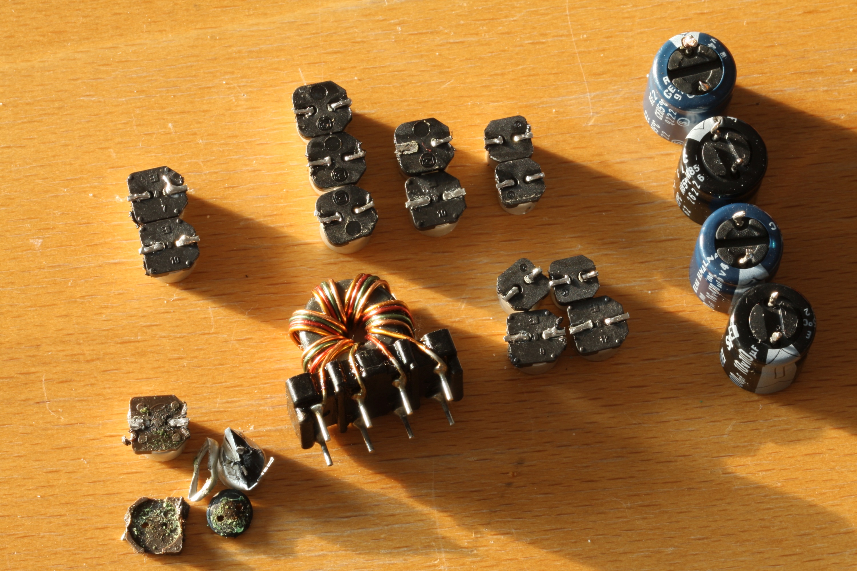

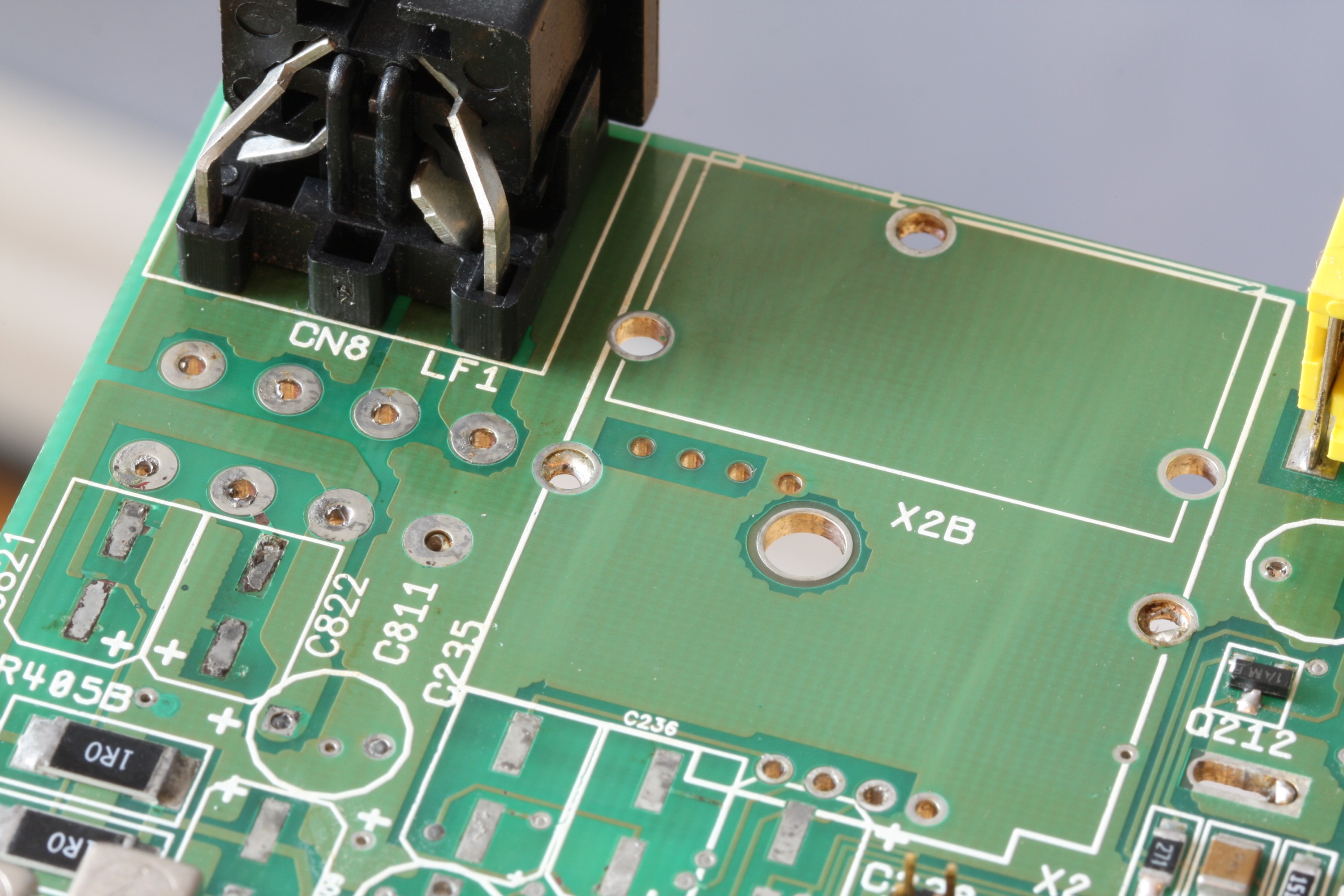

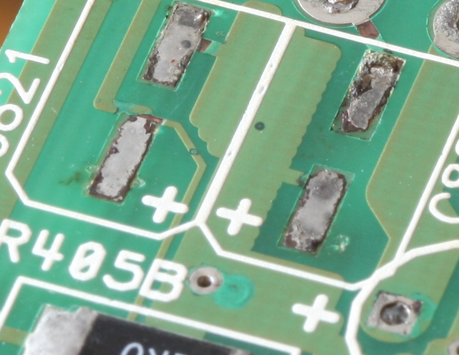

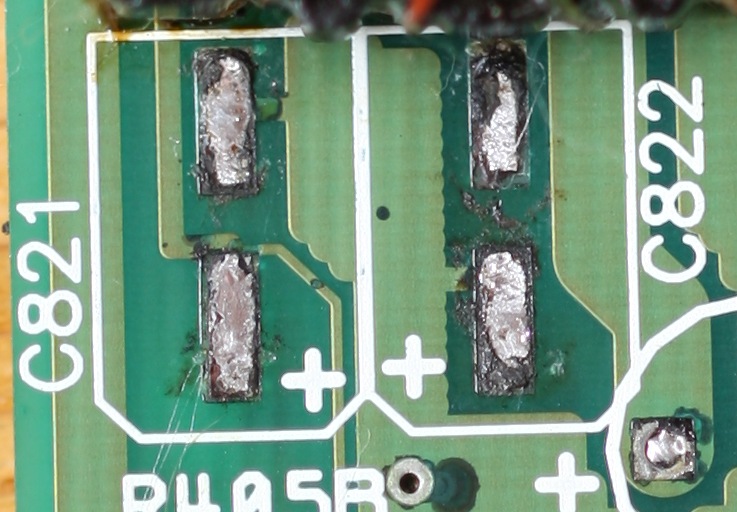

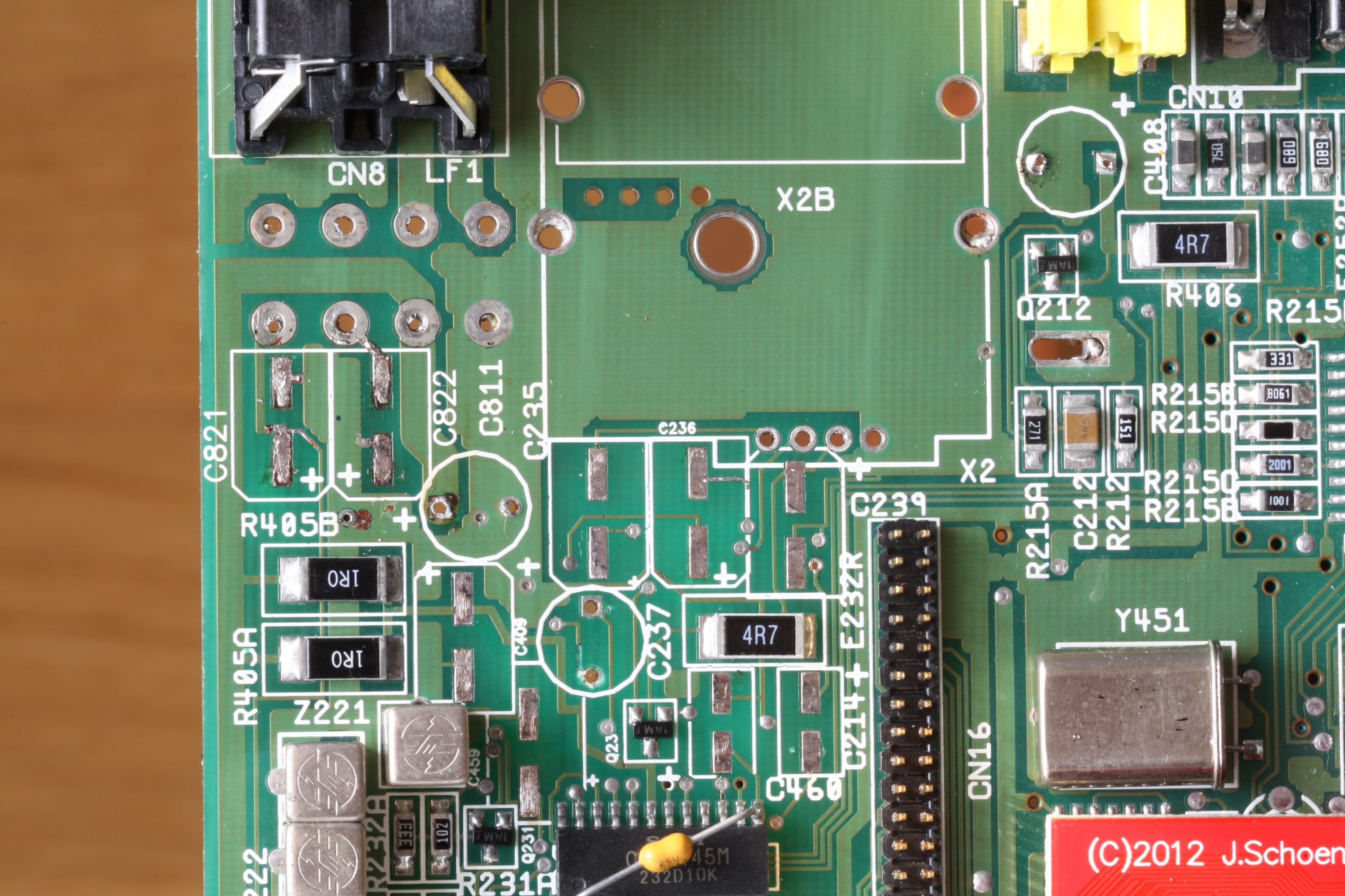

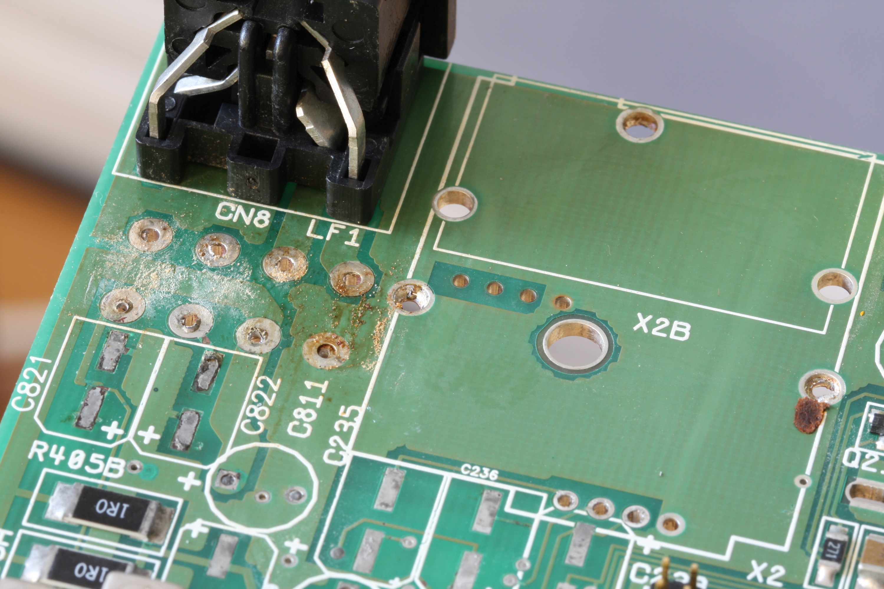

    Hi, fixing up an Amiga 600 for a co-worker.
    Caps C821 & C822 have leaked electrolyte causing the PCB to corrode.
    You can see how it looked after desoldering the caps in IMG_6993
    I have tried my best to clean it, the aftermath in the remaining pictures.
    After this I've also tried baking soda mixed with water to stop the chemical process.
    But I'm not sure if it's the best way, Googling gives very conflicting results.
    I'm thinking of using Vinegar (acetic acid) but just wanted to ask first if there are any recommendations either way?

    I have used both with good success in the past, but for commercial repairs given the extent of the damage to the pads and some of the traces if this was a repair job I was working on the pads and some of the traces would be replaced.
      • 31277
      Re: Amiga 600 PCB corrosion from capacitors leaking electrolyte
      i usually scrape off the laq and tin the nasty bits.
      so now you need to see if you get get tants or poly's to fit on the pads.

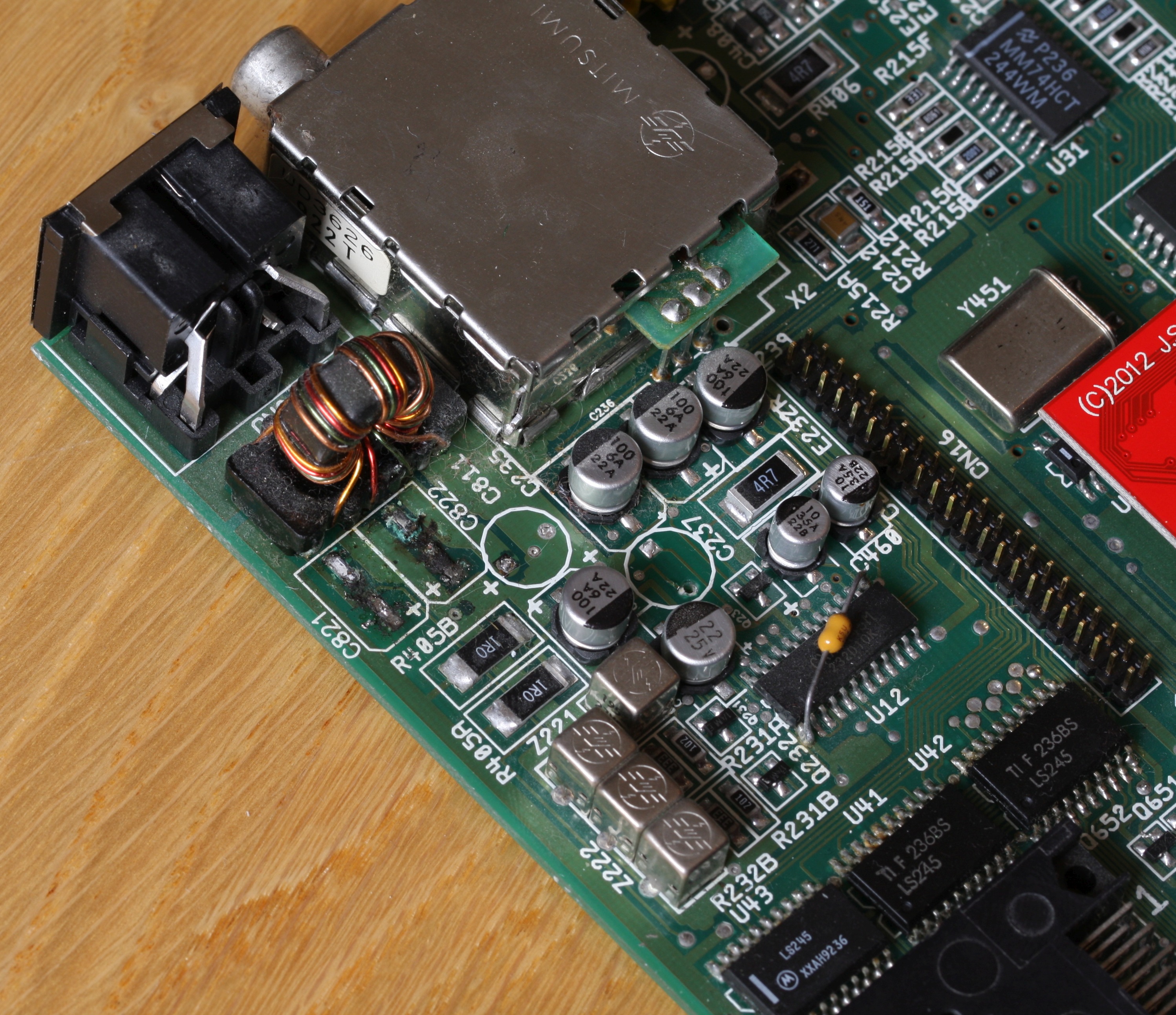

        Used acetic acid now, it sure worked allot better, I could see bubbles and hear fizzing as I put it on the areas with leaked electrolyte
        After that I poured some distilled water over it, and finished with isopropanol alcohol and then a thorough run with an air compressor.
        I could however see that under the choke it still looked like shit, and before I got a continuous stream of crud from there when trying to get a cotton swap under it.
        So off it went, and oh my, that was a good idea.
        I also removed the RF modulator, because I was not sure I got the area under it clean, but it was ok.
        Next up will scrape the traces as recommended and apply some fresh tin, but that's for another day
          Scrape the traces and tin them would be my choice as well. I've fixed a few like that over the years.

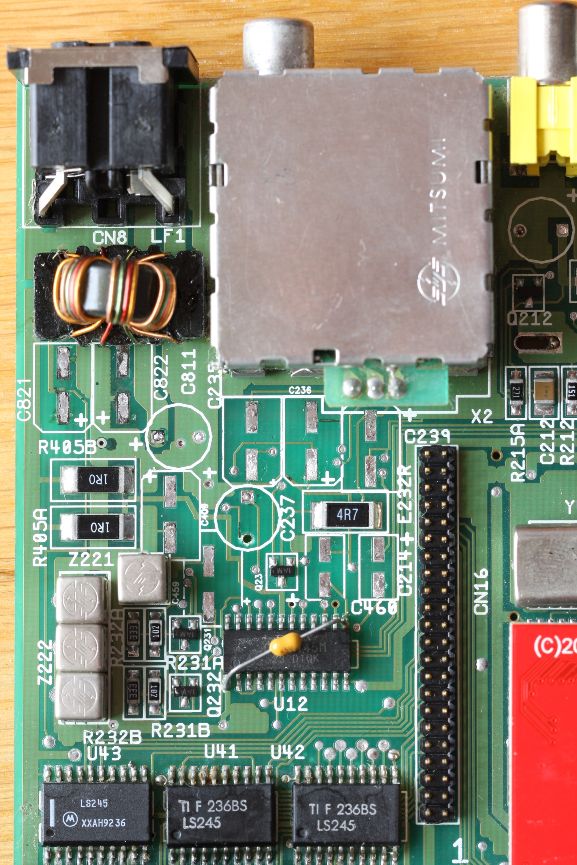

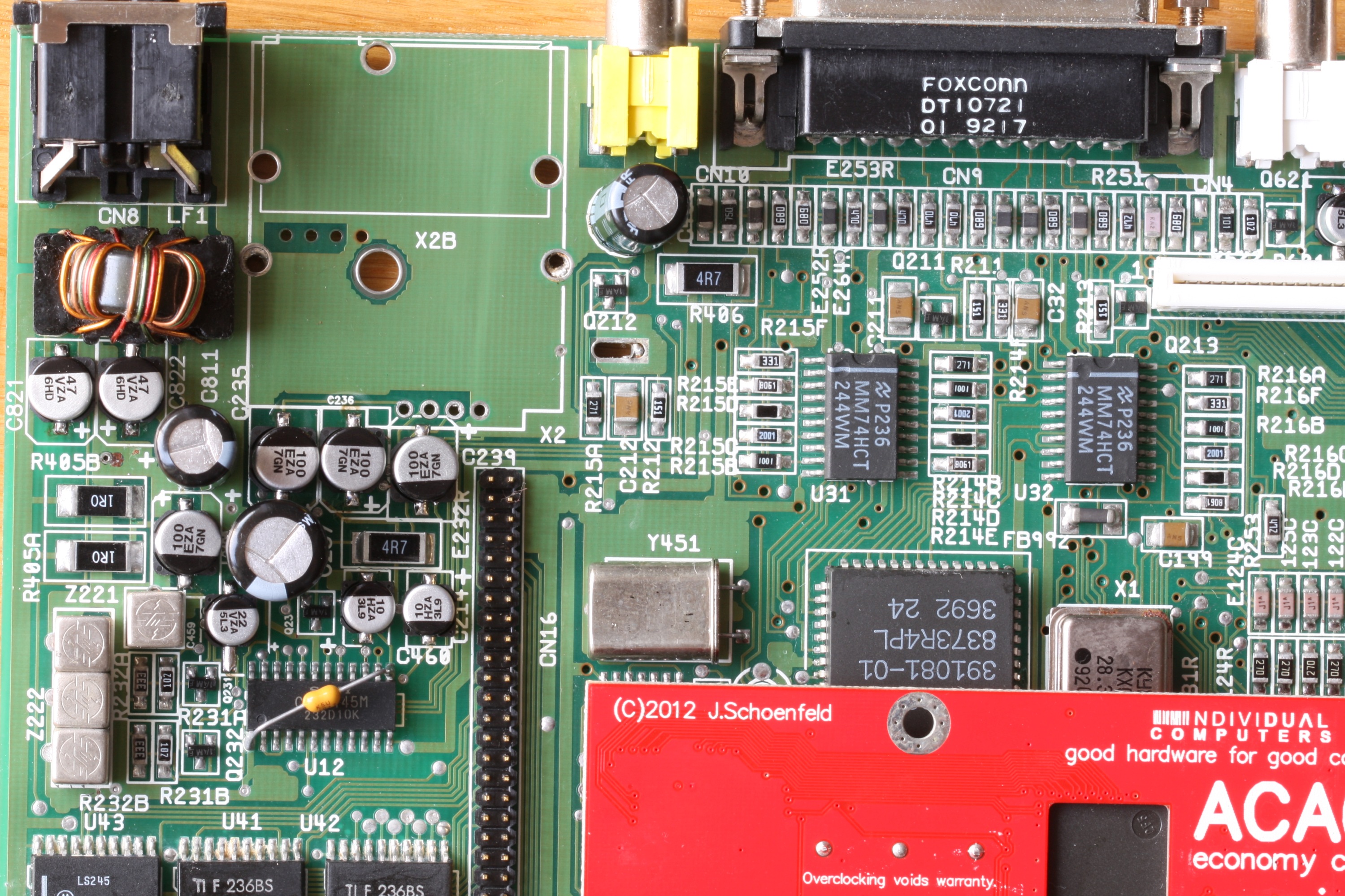

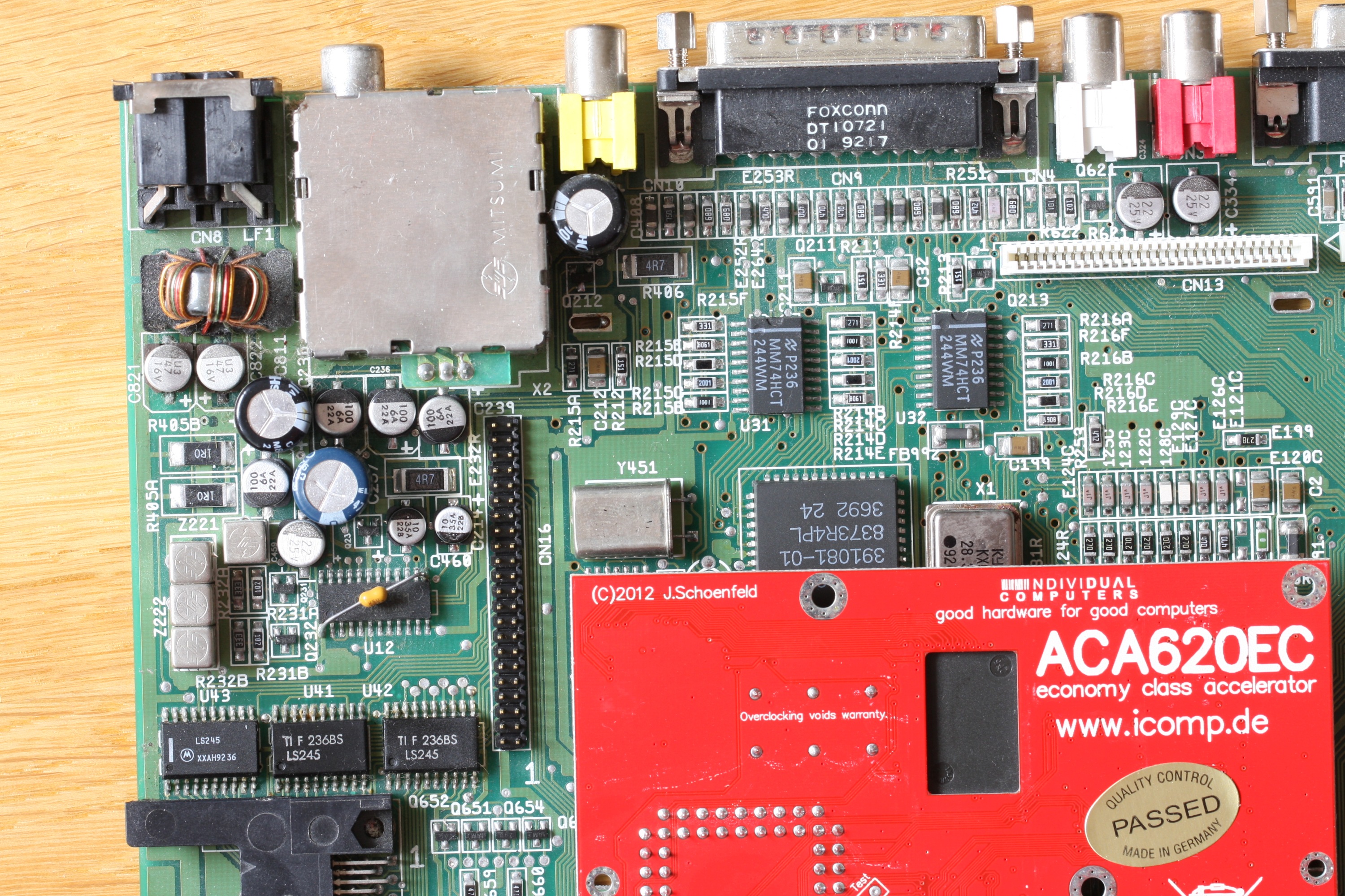

            your pics are different places
              looks a lot different with the common mode choke and the rf modulator removed, doesn't it?
              Though I'm surprised, thought electrolytic capacitor electrolyte was usually some fairly neutral solvent, frequently organic; versus a battery which typically has some strong base in it that would eat aluminum.
                i first saw pics 3 and 4 then saw later the other ones .. no doubt cleaner but not same places .. unless i am completely insane .. rectangles verses circles with holes .

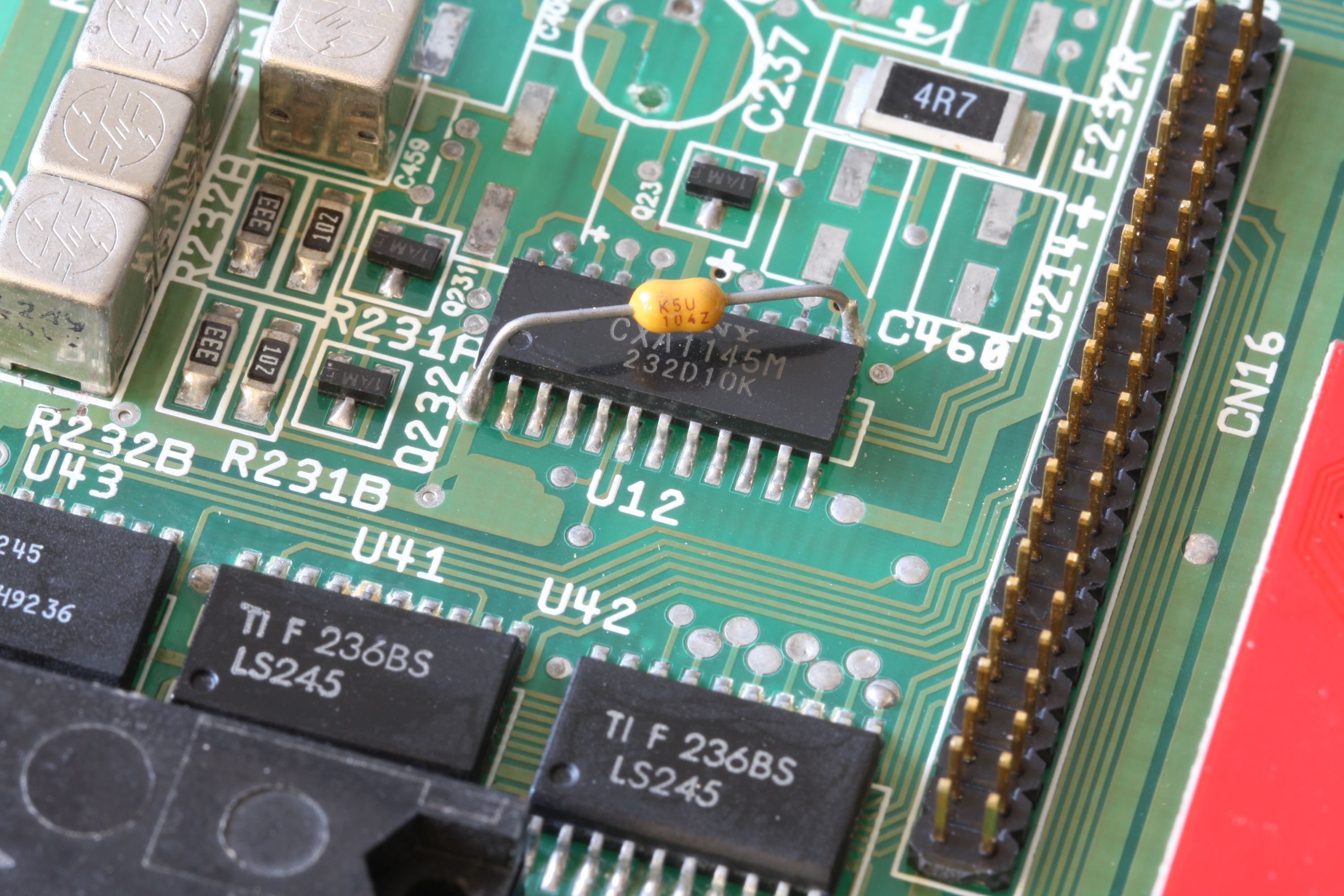

                  They are of the same place.
                  As I wrote and eccerr0r also commented the pictures in my second post are with the RF modulator and choke removed.
                  Compare them with the first picture in the first post, and look at the only thing remaining: the power jack, than you will understand petehall347
                  It was surprising seeing the action of the acetic acid yesterday on component U12, there must have been allot of eletrolyte under it because it was really fizzing and bubbling
                  Attached a picture of it I took yesterday afterwards, looks like a bought one
                      Scraped the traces & retinned the pads and naked copper, and then new caps installed.
                      Boots up fine
                      RF modulator left out as the owner is thinking of installing a VGA port mod.
                      It's not like the RF modulator was useful anyway even when the thing was new!
                      Caps were bought by the owner, using this list: https://www.ikod.se/repairs/capacitor-lists/
                      I don't like the through hole caps, while the originals also were 10mm the hole spacing is 5mm and the circle on the PCB is for 8mm caps.
                      I would have used the ones listed below.
                      Anyway, it's a minor nitpick and those caps are newly launched by Panasonic, so probably didn't exist when that list was made

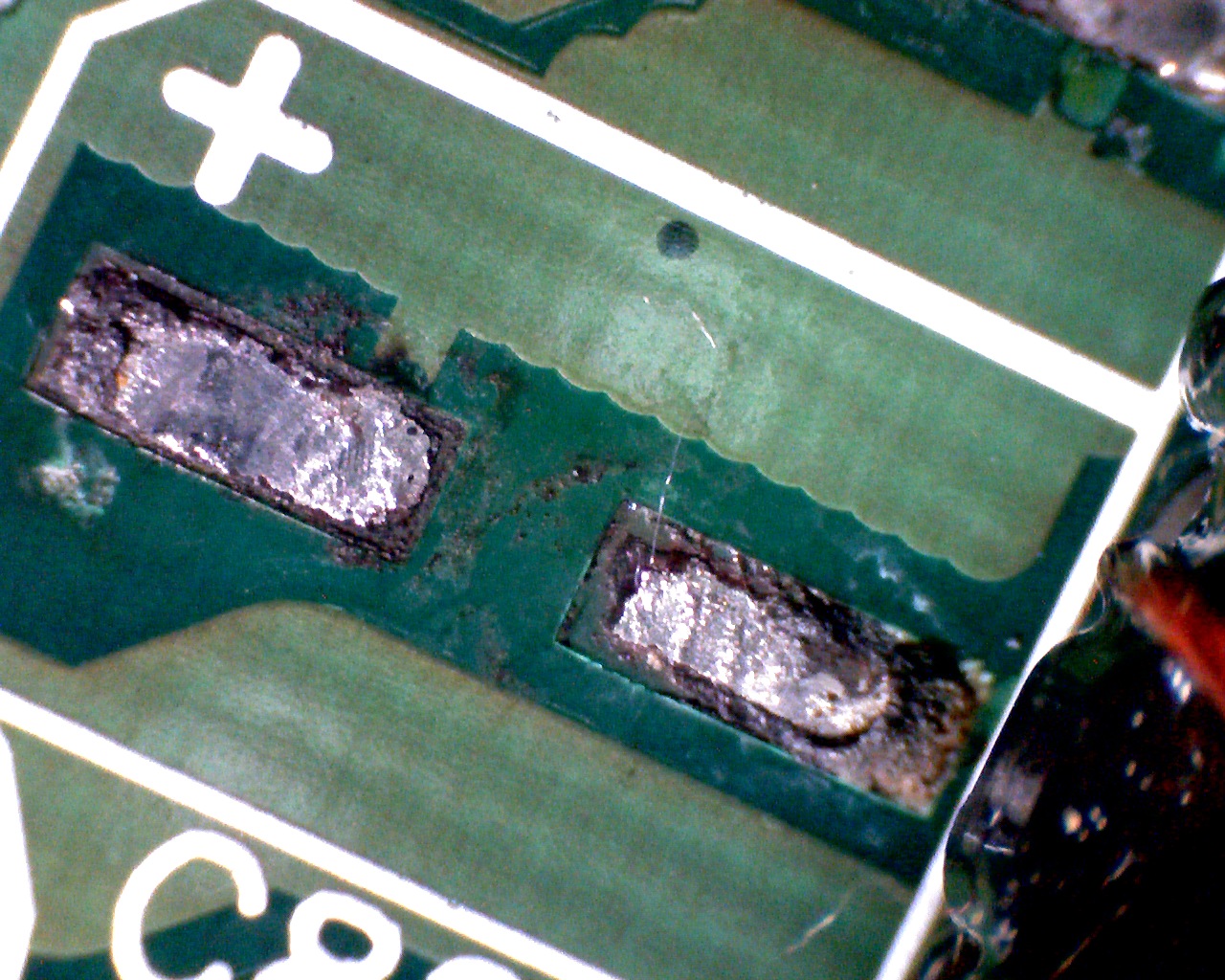

                          It's the capacitors, there was liquid underneath them, however this was caught early.
                          It was only C821 & C822 that had leaked significantly, I used two irons to remove the caps.
                          It was no problem at all with all the other SMD caps, but C821 required allot of heat, so on C822 I cut it off instead.
                          That's the only area that was really bad, under the other caps in the same area there was just a tiny leakage so far.
                          If you do a Google search you will see that this is a super common issue with the Amigas (leaking electrolyte from the SMD caps).
                          Also the issue is hard to see, I have uploaded one more picture to the OP, it's almost impossible to see the damage in it, because it's localized under the capacitors.
                          All that's visible is that the solder pads for C821 & C822 are a bit dull.
                          I'm not sure what you mean with an easy cleanup, I had to use IPA, Acetone, Acetic Acid and finally distilled water then finishing up with IPA again.
                          This included lots and lots of scrubbing too, in all probably spent two hours in only cleaning the board.
                          Oh, and also the test with baking soda but not sure that did anything at all.
                          Or maybe you mean the stuff under the choke? Yea that could be something else, cleaned up easily with IPA and looked very different, could just be soldering flux maybe.
                          (Remember that the cleaning under the choke was done after the cleaning of the rest of the board had already completed).

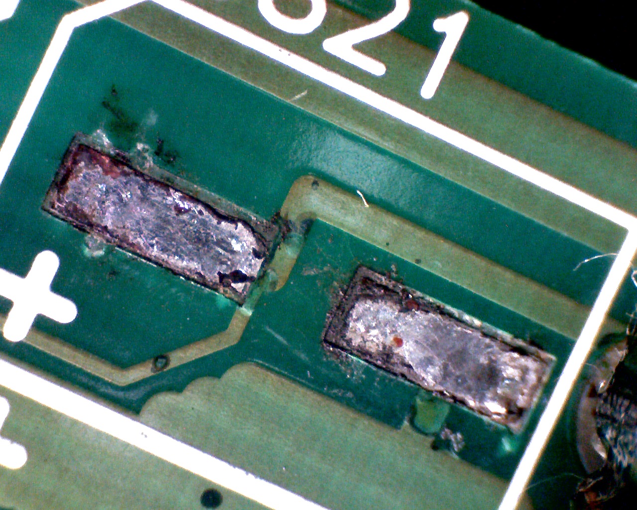

                            impossible cleanup is if the electrolyte actually attacked the metal - the metal would be pitted and the soldermask damaged. Neither of these appeared to have happened.
                            • Per Hansson
                              • Jul 2005
                              • 5895
                              • Sweden
                              Then you need to adjust your eyesight, like petehall347
                              For your reference, pictures can be clicked for higher res versions.
                              But I have uploaded crops of the relevant areas here, so you don't have to
                              The pads have been eaten away, only about 75% remain.
                                Nope, you were lucky. No solder mask damage except from your physical cleaning.
                                  • Jul 2011
                                  • 6070
                                  To me it looks like the out edges have been eaten way however I think you still have enough to work with but some how you need to make sure that t
