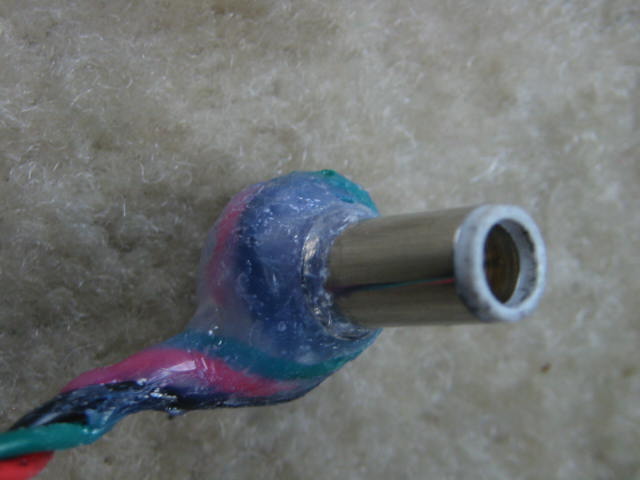

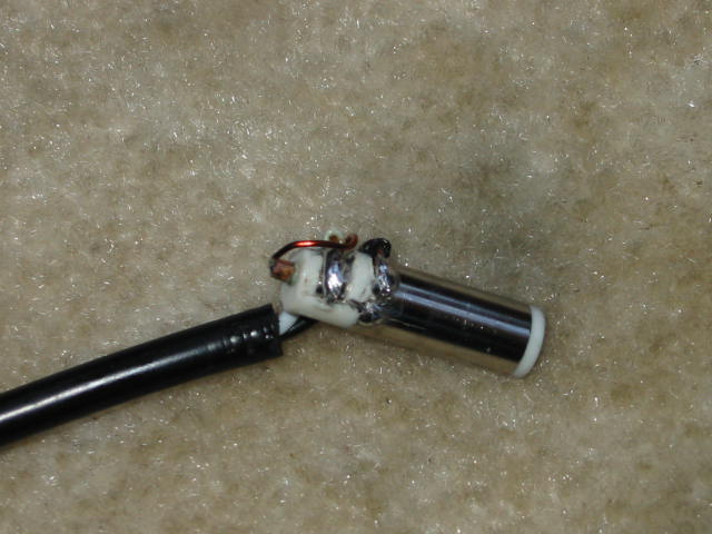

          Dell 65-Watt power adapter cable repair
          Does anyone bother to fix laptop power adapters anymore? I know replacements are pretty easy to find and often quite cheap too – even the OEM ones. Nevertheless, I hate waste, so I still “fix” (cobble / hack / McGyver) these when possible.
          For this post, I have a 65-Watt Dell OEM power adapter with a “big barrel” plug. It was a freebie from Craigslist with a box of other adapters, all mostly non-working. As with most OEM adapters, I usually find the failure to be either a short or an open-circuit in the cable on the DC / output side of the adapter. Very rarely it’s something else.
          For short-circuit in the cable, I typically see that near the adapter side, right where the cable enters the adapter. And it seems to happen more often with cables that use coaxial construction – i.e. ID wire in the middle, followed by an insulation layer around it, followed by the positive (+) conductor wires wrapped around the insulation, then another PVC insulating layer, then ground conductor wires, and finally the outermost PVC insulation. On the other hand, if the cable has an open-circuit, it’s usually near the plug side.
          This one was a bit more interesting though. The Craigslister / person who I got it from already had attempted a repair… and not too bad of job, if I may say (at least the soldering part about it.) The adapter must have suffered from an open-circuited wire(s) near the barrel plug end, because the person soldered new wires from the plug to the cable on the adapter. I forgot to take pictures of this, but the soldering wasn’t bad. Likewise, where the wires were soldered to the cord was also done decently, as seen here.
          The problem, however, was that the person only used electrical tape to hold / “secure” the newly-soldered wires on the barrel plug. As expected, electrical tape doesn’t provide a rigid support, so the wires that were soldered to the barrel plug all ripped out again. Otherwise, I checked everything else with the adapter, and it was OK.
          In the process of doing so, an idea came to my mind: why not wrap the wires around the plug (after soldering them?) I figured this can provide stress-relief on the solder joints on the plug end.
          So I decided to try this idea. Here’s how it looked with the wires soldered and wrapped around the barrel plug:
          I tested my theory by tugging on the wires, and indeed they wouldn’t pull directly on the solder joints on the barrel plug. With some glue or potting material over them to secure them better, I imagined (hope) this would allow the repair to last a little longer.
          Speaking of potting / gluing, I was debating what to use for this. The standard stuff I always keep on my bench is hot glue and silicone/caulk. JB weld and epoxy probably would work better. However, I didn’t have these in stock. So in the end, I went with the easiest/quickest route – hot glue. I considered silicone before this, but wasn’t sure if it would hold up any better (and I only had one kind left, which was some very cheap stuff.) Plus, I haven’t tested it long term to see if it’s non-corrosive. Most silicone/caulk tends to give off acetic acid while curing, which could be a source of corrosion.
          So, hot glue it was! To make the hot glue adhere better to the metal on the barrel plug, I pre-heated the plug with my heat gun. Then, with the plug still hot, I quickly potted everything with hot glue. The result… wasn’t very pretty, but it seemed to hold relatively well (time will tell, of course.)
          Finally, I re-soldered the wires on the other side to the ones on the adapter’s cable. Like I said, the person that tried to fix this didn’t do a bad job with the soldering. However, I didn’t like the way the wires were “poking” out, so I re-soldered them. While at it, I also slipped on some heat shrink pieces to put on both ends. The finished adapter looked like this:
          Note that I intentionally didn’t cover all of the “new” wires with heat shrink tubing. The reason why is because heat shrink tubing tends to be a little too stiff once tightly shrunk around multiple wires. And for a laptop power adapter cable, it’s probably better for the cable to be a little more flexible, especially around the plug side. In fact, this is what I believe causes most of these adapters to develop open-circuited wire(s) near the laptop power connector (when used by less-than-careful owners, of course.) Dell in particular likes to add large ferrite beads near the plug (or at least it used to on older adapters like these), which further aggravates the issue, IMO.
          Another consideration to keep in mind: where the power plug on the laptop is – i.e. on the back or on the side of the laptop. This could matter depending on how/where the laptop is used. Why I mention this has to do with how the wires/cable comes out of the plug. In the case of my repair above, they now come out sideways, almost 90° to the axis of the barrel connector, whereas the original wires came out straight from the back of the barrel connector. When the laptop is used on a flat, solid surface, this doesn’t matter much. But when it’s used in bed or on the lap (like many people do… hence laptop ), the cable can push up or pull down onto the barrel plug, causing stress both on the wires in the cable and on the connector in the laptop. I find this to be the case more often with laptops that have their connector on the back. So this is one reason I put the wires at 90° relative to the barrel plug. On the other hand, if someone trips over the cord, a straight-out cable-plug design would be better, since it can just pull out of the connector on the laptop without causing any side-loading forces. In contrast, a 90° design will cause a lot of sideways forces, both on the cable wires and the connector/plug in the laptop. So both of these designs have pros and cons. In the end, I went with the 90° design, because I left this power adapter as a spare for my uncle’s Dell Latitude E6400, which has a plug on the back and I figured this would suit the design better.
          Anyways, not sure how long this repair will last. The adapter is still sitting in a drawer as a backup. However, I also fixed the power adapter for my uncle’s Latitude E6400 after this one (in the same fashion) and I do have the results. But I’ll post that in another post here (need to finish typing it up, though.)
          Again, I figured I’d post this here, since it’s probably a “worthless” repair in a sense that it takes relatively long time to do compared to just going out and buying a new / another power adapter. Doing the failure & engineering part was the fun for me, though. I’ve seen many such power adapters fail and also fixed a good deal of them in the past… just never put so much thought into it before as I did now.

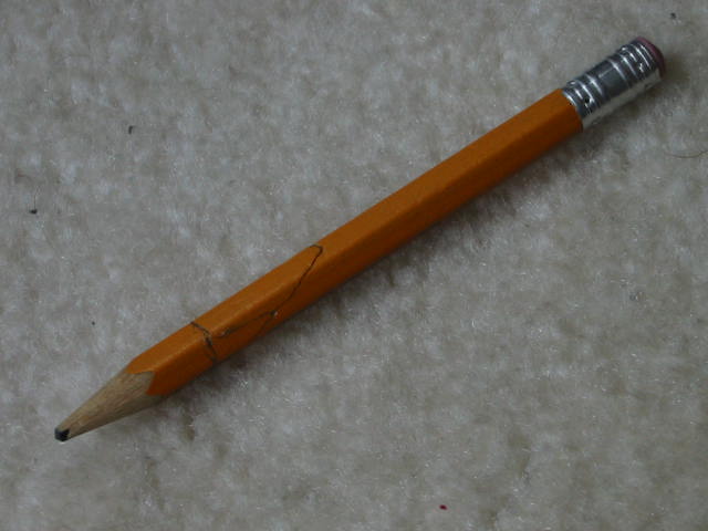

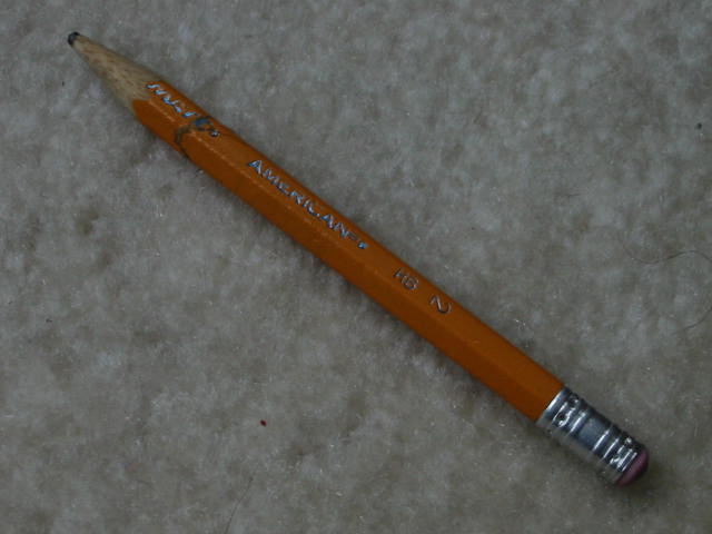

                    Wooden Pencil Repair
                    OK, this one is self-explanatory.
                    Seriously, how much is a simple wooden pencil worth these days? A few cents, maybe? Does anyone even care to use wooden pencils anymore? My guess is, probably not. But even 2-3 decades ago when I was still in school, I remember no one cared about them back then either.
                    In the case of the above pencil… wind back about 15 years to my high-school days. Some kid was just goofing around and took another kid’s pencil, then broke it in half and threw it around in the classroom. No one bat an eyelash, of course. Inner me: grrr… must not waste! Must fix!. So of course I had to I pick it up… and I guess I’ve always been a master hoarder after all.
                    Anyways, since I picked up all of the pieces, I was able to glue it back together with wood glue in one of the engineering elective classes I was taking. The repair lasted me through the remaining two years of high school. Then the pencil broke again (I suspect the classroom wood glue was a little “expired”, as many times people forgot to put the caps back on – another grrr to trigger my OCD. ). Regardless, I glued it again (this time with a slightly different/better wood glue of my own.) And it’s been fine since then. Believe it or not, the pencil was actually almost twice as long as seen in the above picture. I’ve just used it for many years afterwards. In fact, it didn’t even dawn on me how worthless of a repair this was until I picked it up again the other day to write something down. It needed sharpening, and that’s when I noticed I’m about to grind away at the broken part soon.
                    I guess it’s because I consider a pencil to be a tool – one that let’s you write stuff down… and I’ve always had respect for any kind of tools.
                    So there’s that worthless repair.
                    On the up side, I NEVER had to ask my parents to buy me pencils or pens for school. I was always loaded with all kinds. In fact, many kids knew me as “that kid” who they could regularly “borrow” a pencil from. And if/when they forgot to return it – no worries! Sooner or later, the same pencil would find its way back to me / my backpack again.

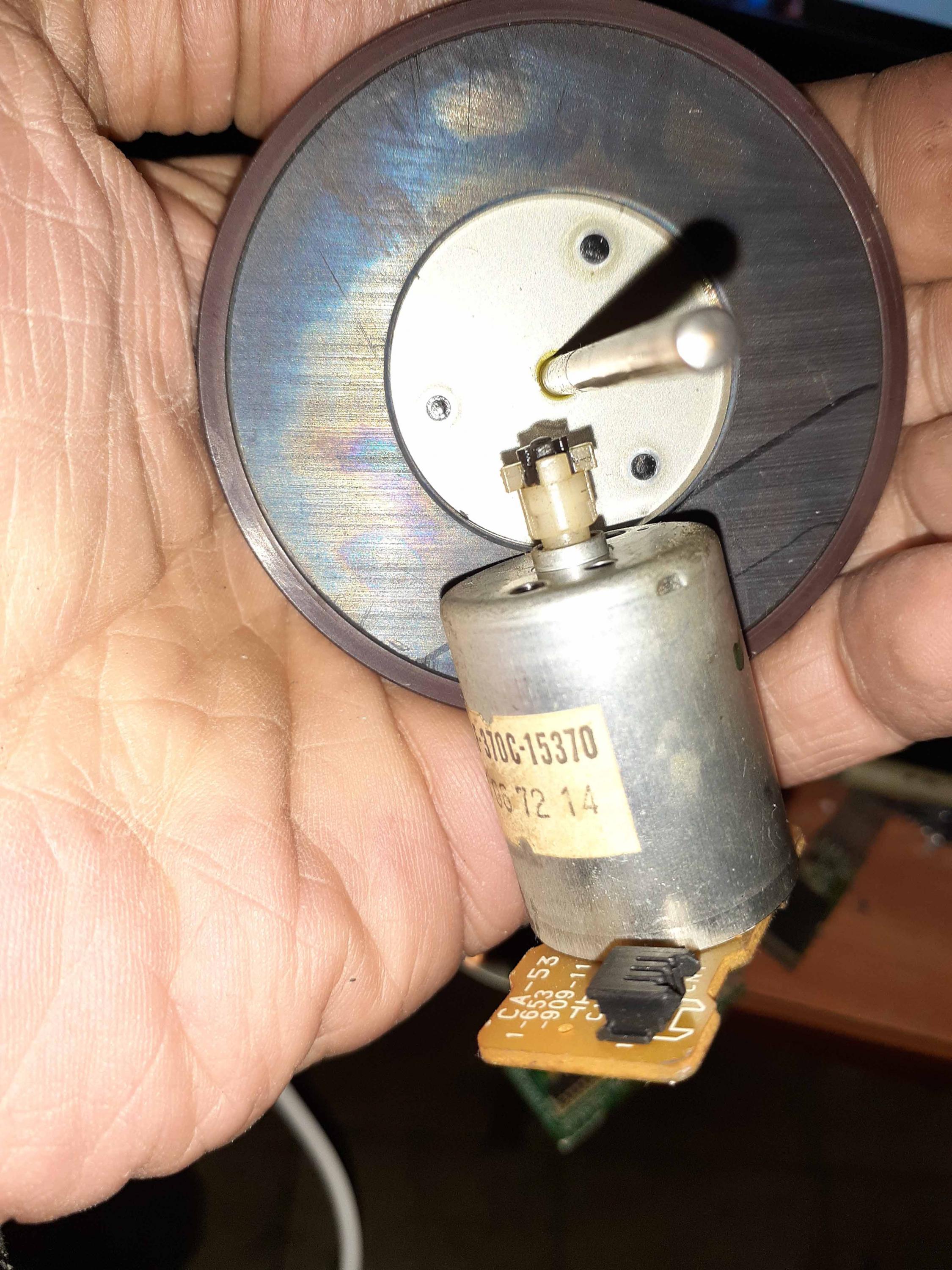

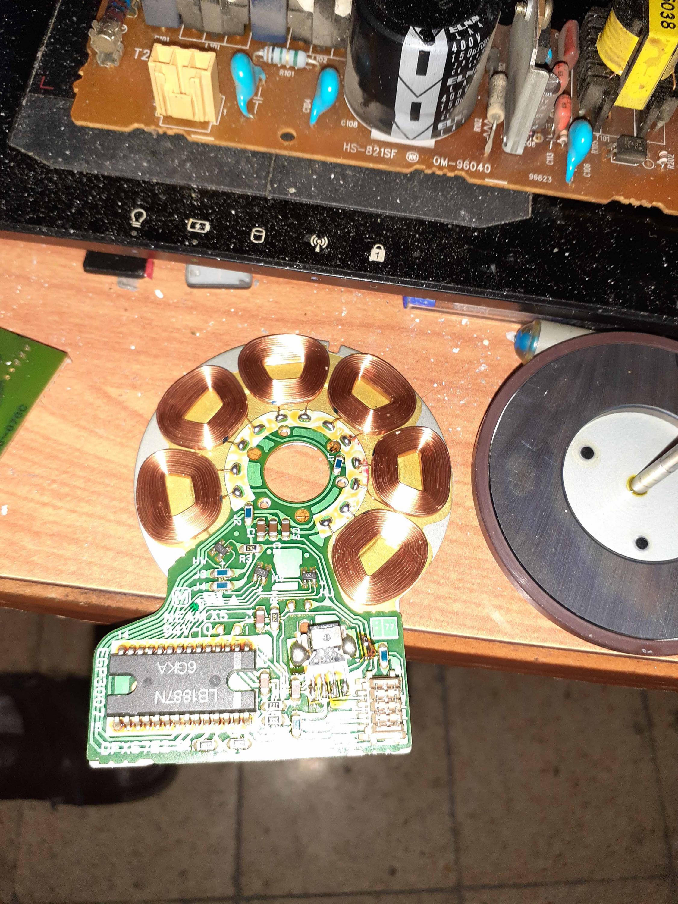

                      This is or was a Sony x317 VHS system , given to me one year ago for free . They told me it's intermittently working , and gradually became frustrating to deal with . When I had a chance finally to take a thorough look into it , I made many mistakes as taking the whole thing lightly . I've already have a good system for converting into DVDs and so , so it was a light repair to begin with.. First mistake was tryin'it with an important tape for me , although it worked well for 15 minutes or so . Ejecting and inserting repeatedly only worsened the situation and at that point , it was put aside for later disassembly .
                      When I opened it some weeks later , I took my first measurements on the power supply unit under load then some measurements on main-board and things turned out very normal . My thoughts gradually went into the mechanical system being the one causing the real problems .
                      And here came my Second mistake when I broke the soft 4 plastic wires from the read head to the main board . Although it could be an easy repair , but further disappointments were when I disassembled the mechanical systems and more weary belts and clutches started to put on heavily on my thoughts .
                      further on , three dead roashes was it ..
                      So I decided to change my priorities to salvage my precious tape and extract the magnets (I love magnets ) , dynamos and any other things useful for my projects . Next , it was a full tear down to the last screw and ring , testing my old times speed and abilities at it , lol ..
                      By the way , I didn't forget to extract a good quantity of grease since this is best quality you can ever find and don't tell anyone I told you so

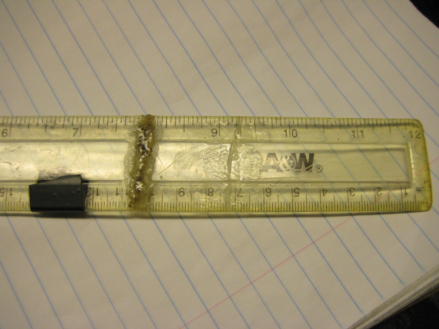

                                lol good job, alas I think I'd draw the line at that because I can't - with a no longer straight or accurate ruler...
                                Well, it's still accurate... so long as you use it for relative measures only (i.e. if you measure something to be 11" with this ruler, then you must use the same ruler when measuring something else. Otherwise, you'll get a disagreement.)
                                I also have a (soft) tape measure that suffers from this - the plastic has stretched, making the first 4-8 inches (10-20 cm) a little longer and more "stretched" than what real inches / cm should be. I used it like this for a long time without knowing when cutting various small lumber pieces for a few projects, and still didn't get more than a mm or so error... so I guess it's still somewhat useful. Now that I know, though, I don't use it for stuff where I need really good accuracy. In some cases, I can get up to 2 mm difference, which can be very annoying and not work right in some cases.
