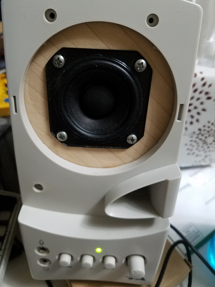

        I tried to fit a different speaker in those computer speakers that smoked a long time ago. The sound quality isn't worth the parts cost (Peerless TC6FC02-04 drivers, on sale at Parts Express for $9.80 each) and the time it took for me to cut those adapters. They sound about the same as the original drivers, but with less bass. However, I haven't changed the driver in the left speaker yet, and the amplifier has a problem with weak bass in one channel that I never figured out.

          ^ Nice!
          So wait, you bought those drivers specifically to fix these speakers? At almost $10 a piece, I can get a 2.1 system in good working condition around here. But I guess that was the point of your repair/exercise, wasn't it. Fits the thread pretty well.
          As for the weak bass... I imagine that is likely caused by a bad cap somewhere - either electrically leaky or high ESR / low capacitance. If you swap the input signals going to each pin on the amplifier IC and the weak bass follows, the issue is before the amp in the signal circuit somewhere. And if the issue doesn't follow, then either bad output coupling or feedback cap in the channel with the weak bass. And if it's neither of those, perhaps the amp is bad. In that case, crank it up to the max and let it smoke itself out?? Bonus points if you use an adapter with voltage rated very close to the absolute maximum rated.
          Anyways, that modded/repaired speaker looks totally badass like that. Love it!
          Unfortunately, I'm too cheap to spend any money when it comes to stuff like that... but NOT time. I posted this repair on a pair of cheap Acousitc Audio speakers a while back... and looking at it again, I certainly should have put it here in the worthless repairs thread.
          So perhaps if you want to waste even more time with these speakers, you can try to rewind the old smoked drivers, if you still have them.
          As for my more recent worthless speaker repairs... I did two speaker surround jobs: one on a single Boston HD8 speaker, and another on a pair of old and kinda crappy Philips speakers. Both of these were too cheap to waste money on surrounds... so I did them the same way I did my good ol' Realistic Nova-18 speakers: made the surround myself from paper. Though on that note, I should say I've improved the "quality" of my surrounds quite a bit. Seems that paper towel and latex house paint make for a decent surround material. Perhaps I should post pictures of these two with some details how to make them. The Nova-18 speakers were my first try... and they still work! I actually listen to / abuse those speakers quite often. They don't sound good, but there is something about their heavy speaker cones that produces a strong vibration in the chest and makes them sound 10x louder than they are. And being mid-range "bright", they actually sounds OK for everyday listening. Also, after all these years of me occasionally abusing them (cranking the volume to silly levels where the speakers distort... but still don't burn out for some reason), the paper surrounds have finally broken in to the point where they don't make any noise with high cone excursion (>5 mm each way). This is where the paper towel + latex paint helps on my "improved" versions, as that material doesn't need breaking in to get rid of surround noise. It's still an extremely lo-fi repair, though.
              I kind of did, but they can be reused for other projects. I'm curious to see if I can make small speakers that don't completely suck. Some companies have tried, but they just boost the "midbass" range into distortion (which most 2.1 computer speakers and all mini-stereo systems also do). Where I live, the only way to get computer speakers for $20 is to buy new, and everything in that price range is the kind of stuff that has fake reviews on online stores.
              From what I remember, changing the input caps affected which channel had weaker bass, but the actual cap value didn't matter. It also doesn't affect headphones, which is strange. The headphone jack is connected to the main amp output with ridiculous 390 ohm series resistors. Maybe I need to get some more 100uF caps to see what happens if I swap the caps around the TEA2025B.
              I thought about it.

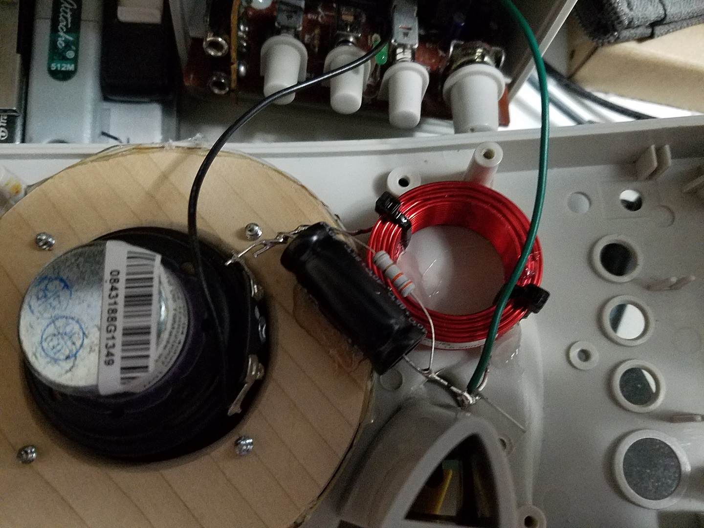

                        I made my speakers more pointless with a notch filter to get rid of the big hump in the midrange response (I have to use a third-party website because the Peerless datasheets are broken). That 2kHz peak was annoying and caused that "tinny" sound. I haven't trimmed the leads yet because I don't know if I have the correct resistor value yet.
                        I don't think these drivers are really worth the money once you add in the price of the filter components. There are even other Peerless 2" drivers with flatter frequency response, like the TC6FC00-04 (although the off-axis response looks worse). At least the magnet structure they use has a weak external magnetic field, so they can be used around CRTs.
                          LOL! But also really cool to see such a tiny speaker used in place of a full-range speaker.
                          Yeah, I think the sound would still be "tiny" no matter how many notch filters you have or how big they are. The speaker itself is rated from 150 Hz and up, with a self-resonant frequency around 170 Hz. So it's really more of a mid-range / tweeter driver... and 2" diameter is right for that anyways. Actually, I'm quite surprised that such a small driver can go so "low" in the frequency response.
                          Your notch filter really inspires me to try and do the same to a pair of headphones I found recently for free (they came in a small PC PSU parts lot.) For the most part, I can correct a good deal of their frequency response with an EQ in WinAmp. But TBH, I never really liked how software EQs sounded in Windows (especially when pushed really hard to correct a lot.) So I'm curious to see if a hardware notch filter / band-gap filter could do them better justice or not. They have really really strong bass, which I'm OK with. But the mid-range is even stronger - in fact, so strong that it took me to a while to figure out what exactly needed correcting, since they sounded like listening through tin cans under water - literally! I'm not exaggerating a single bit. After severely attenuating the low-mids and mid-mids, then boosting the low-highs, mid-highs, and high-highs... they sounded... acceptable. It's the strong bass that I like about them. However, the #1 thing that I absolutely hate about those headphones is how tight they are on my head, and I don't have a big head. They are over-the-ear design, so after about 1 hour, my ears felt completely numb. I remember playing around with some woodworking clamps in my uncles workshop when I was a kid - particularly, how I thought it was funny to tighten them around my head (and maybe that explains my loony behaviors at times ). These headphones simply reminded me of that with how tight they were. Ugh!
