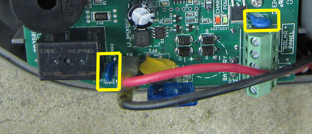

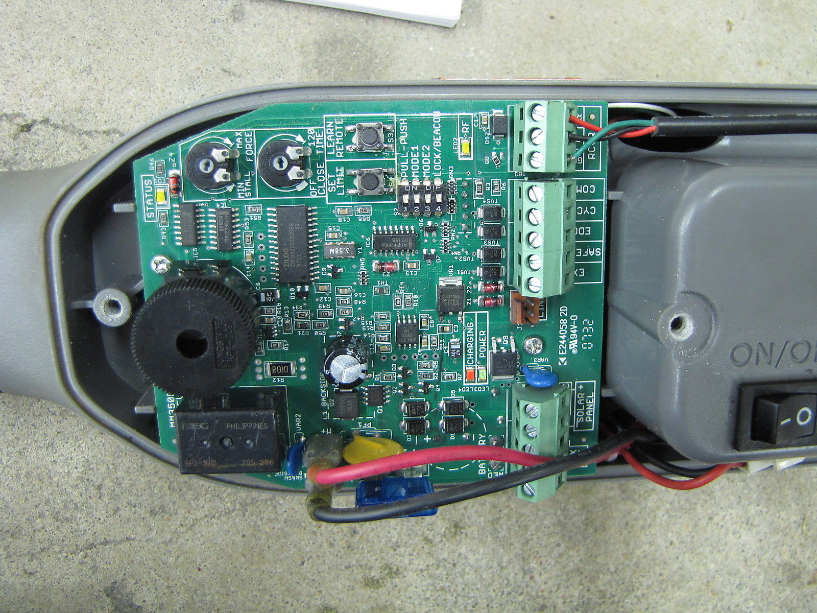

              Ok heres a couple of pics I can try to get a few better pics if needed.
              The location of the cap was located at R12. It was almost burned in half and completely broke upon removal.
              • cmstech
                • Oct 2010
                • 19
                Re: Mule 350 Gate Opener
                Original refurbished board showing cap thats blown in yellow box. Only if that pic was hi definition. Others have had the same CAP blow only to have to purchase another board then another in 6 months. Not a path I wanna take at $159 each. Thanks for the replies everyone!

                    A picture is worth a million words. The piece you circled is marked R12 - it is a Resistor, not a capacitor, and by the looks of it it also had a value printed. The value is important in this case.
                    Judging by its size, it is a shunt resistor for measuring the current that goes through it. You are likely to have other components shorted downstream if that blew. Check for a short with your multimeter from either of that resistor's pads to ground.

                      Here is a pic of an undamaged board. The markings on R12 are R010

                            There are a couple of varistors on the board for over-voltage protection. It is possible one or both are shorted.

                              Btw, R12 is a current sense resister. Value is 0.01 ohms. I can't tell the physical size from the pic but this one may be close: http://www.digikey.com/product-detai...FCT-ND/1775054

                                      VAR2, next to the relay, is across the red & black wires going to the motor. With the red & black wires unplugged, just measure across the varistor with an ohm meter. If you measure a short, remove the varistor and check again.
                                      VAR3 appears to be across the solar panel. You can look at the circuit traces to confirm. Disconnect the solar panel and measure the varistor with an ohm meter. Again, if you measure a short, remove the varistor and recheck.
                                      R12 appears to be used to check the current of the motor. If so, a shorted VAR2 would burn it up.
