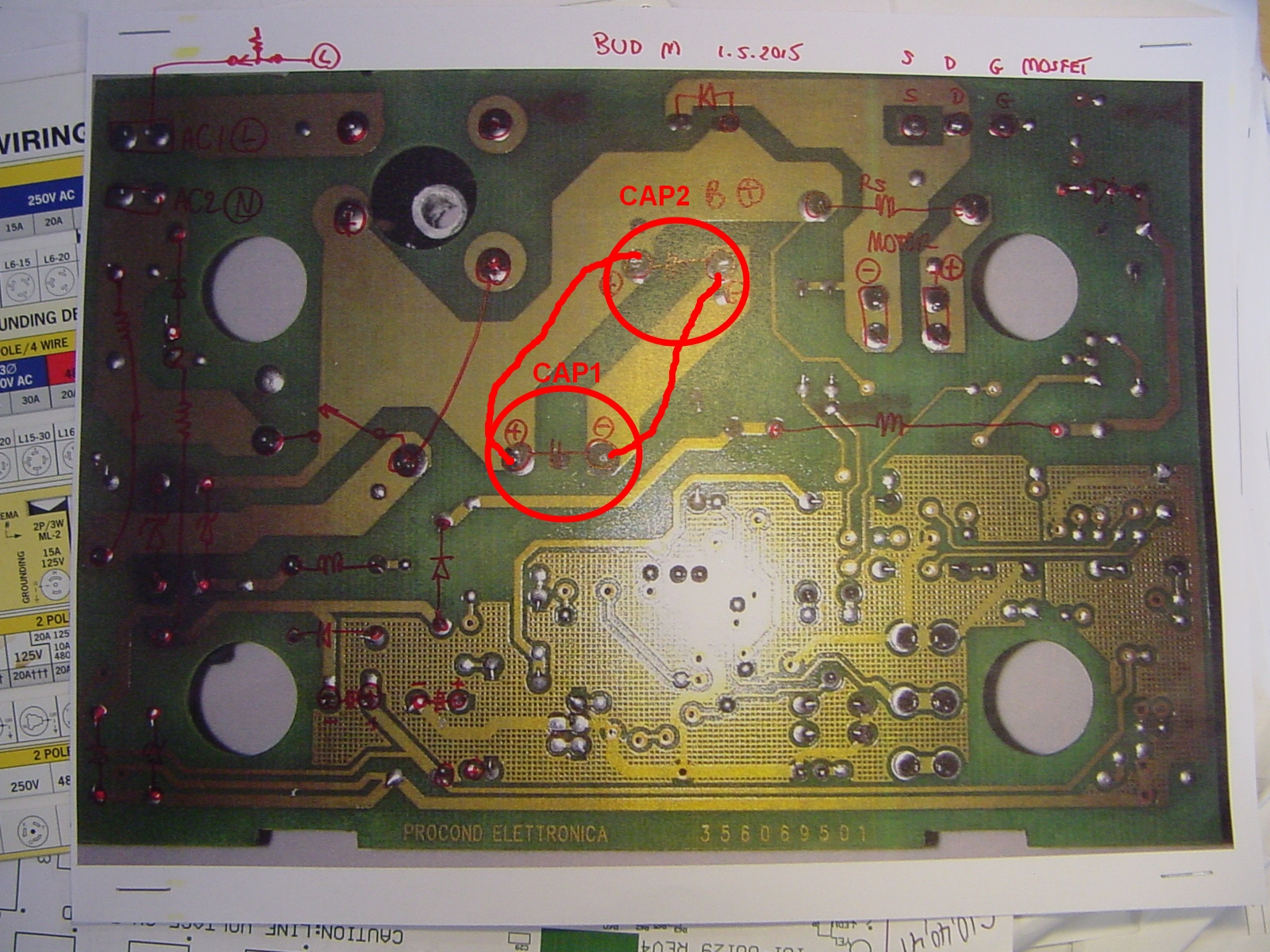

    "But what about the -49 on the other filter."
    OK, please do the resistance testing between the Negative legs of the two cap and between the positive legs of the two caps to see if they are connected in parallel with each other or not.
    It also sounds like you may have intermittent connections some where sine the relay is now kicks on.

      Ok I get a reading when I test them together, 1.962 on negative and .522 on positive.
        #123
        Re: Help with Motor Control Board
        So the resistance reading of the negative leg of one filter cap to another filter cap negative leg is 1.962 Ohms, and the resistance between the positive leg of one leg to another positive leg is 0.522 Ohms?

            So basically they are connected in parallel if the resistance are that low which means the DC Voltages on the legs of both cap should be around 160VDC, so I am not sure how you get -49VDC on one of the cap.

              I have tested them several times and the one closest to the relay has 166.6 and the other -49. If I switch it to AC that ones gives reading of 63.2VAC

                  That has to be measurement error, as you can see the terminals of the caps are connected to each other with big copper traces.

                    I bet there are bad connections on those caps. scrape some of the paint (about 1/8 in)from the copper trace around the capacitor connections, then resolder them. I can't tell from the picture but it looks like the cap leads have metal gromets and these can cause poor connection to the actual copper traces.

                        BudM how about just soldering a wire between the caps legs to make sure there is not some sort of a bad connection. A voltage reading and a Ohm reading are differences in the meter. Perhaps the Ohms per volt of the meter is acting as a voltage divider with the bad connection of the cap that reads -49 volts and the ohm reading of the meter, by supplying its own current at a low level, can not detect the bad connection. It is a thought, how ever twisted it might be. And Crrose glad your hanging in. That is the only real way to learn this stuff.

                            Since I have wires soldered to the caps, can I just connect the positive to positive and negative to negative joining the caps together to see what happens? And I have tested and retested them, still get the same results. -49VDC and if I switch leads I get +50VDC on that one cap, and I did confirm I was testing correct wires.

                                I would remove the solder around the cap legs that is showing 49V and inspect the pads real close to make sure that the copper pads are not islands and the pads are actually connected to the large traces.

                                  I took it back off to check the cap legs and noticed I had confused one of the rectifier legs with the cap leg so it was not soldered correctly. I fixed it and now get 166.4 on both caps.
