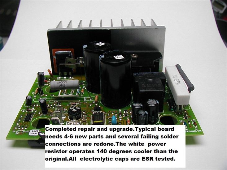

                  Hi here are a few links that has some info regarding this board the red black and white wires appear to be signal voltages for the speed?
                  http://www.fitnessrepairparts.com/cart/ViewItem/6005147
                  http://www.mc70repairexpert.com/default.html
                  The following one is for an upgrade board but I have included it as it suggests
                  the P1 potentiometer is to adjust the signal to the panel rather than the actual speed?
                  http://www.treadmilldoctor.com/troub...uctions-02.jpg

                      Info from selldoor is interesting since the repair modification is around that over heated area of those two diodes and the resistors.
