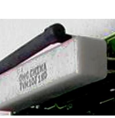

    In post #35, Budm mentioned the motor is driven by the power mossfet. Is there a way of checking that or bypassing to test?
    My soldering skills aren't that great so I try to avoid as much as possible, kind of afraid of removing the caps to test resistance, besides I don't have an ESR meter.
    I guess If I need to unsolder the resistors I might as well replace them if I knew what to buy. No markings on them.

      Re: Help with Motor Control Board
      "In post #35, Budm mentioned the motor is driven by the power mosfet." - I will re read
      This a test for mosfet but I dont think it can be shorted
      If you have a manual range multimeter, set it to 200 ohms (two hundred). You can test a mosfet (Q, IC designation) "in circuit" by (power off and unplugged)
      a) black on pin 1- red on pin 2 - record ohms
      b) black on pin 1- red on pin 3 - record ohms
      c) black on pin 2- red on pin 3 - record ohms
      If any ohm reading is less than 30 ohm you might have shorted mosfet. Remove from circuit and repeat the tests to verify.
      Resistors - not caps - resistance measured with meter on ohms.
      Sometimes the resistance does not show correctly as it may be affected by other components so you have to lift at least one leg to isolate it - In this cas lifting one end may damage the resistor, hence removing it.
      Next time the board is out have a look at that bottom joint - first have a look on the pictures- even a poor resolder attempt might be better than it is?
      EDIT hehehe - you changed your post while I was working on an answer
      Just try testing th eresistors on the board and see what they test at.

        A: black pin one and red pin 2 no reading
        B: black pin one and red pin 3 the longer I hold it the higher it goes, removed when 94
        C: black pin 2 and red pin 3 no reading
        • Crrose
          • Dec 2013
          • 165
          • Usa
          #144
          You know I did this the other day looking at my notes and at that time I had:
          A: black pin 1 red pin 3 = 94
          B: black pin 2 red pin 3 = 521
          C: red pin 1 black pin 2 =611
          D: red pin 1 black pin 3 = 112
            Well I think we know what one of them might be.
            I reckon TVM10J1KO
            http://oneic.com/s/tvm10j1k.html
            So that is a wirewound 10watt 1Kohm I think?
              Think you had it on diode setting then though?

                Good call Selldor, I just checked in diode mode and getting all the readings like before. I'll also look for the resistor you just posted.

                  I guess i'll finish up for today and try to get those resistors replaced.
