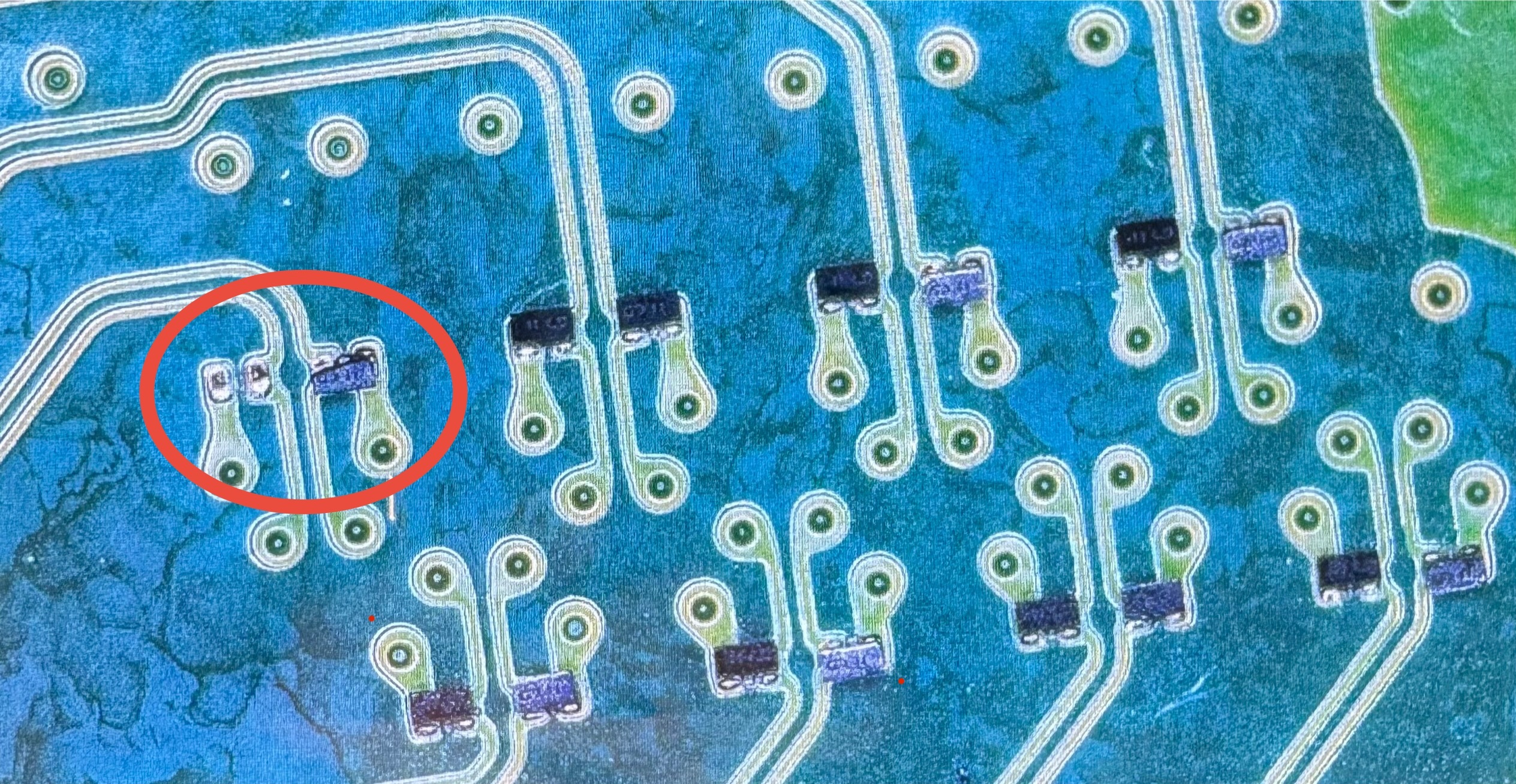

    EDM-020 motherboard, can anyone identify what the missing component is so I can order another, and perhaps what it does? It is on the liquid metal side of the board, opposite end from the ports.

    Diode, DF2B5M4SL

        That was it, thanks!
