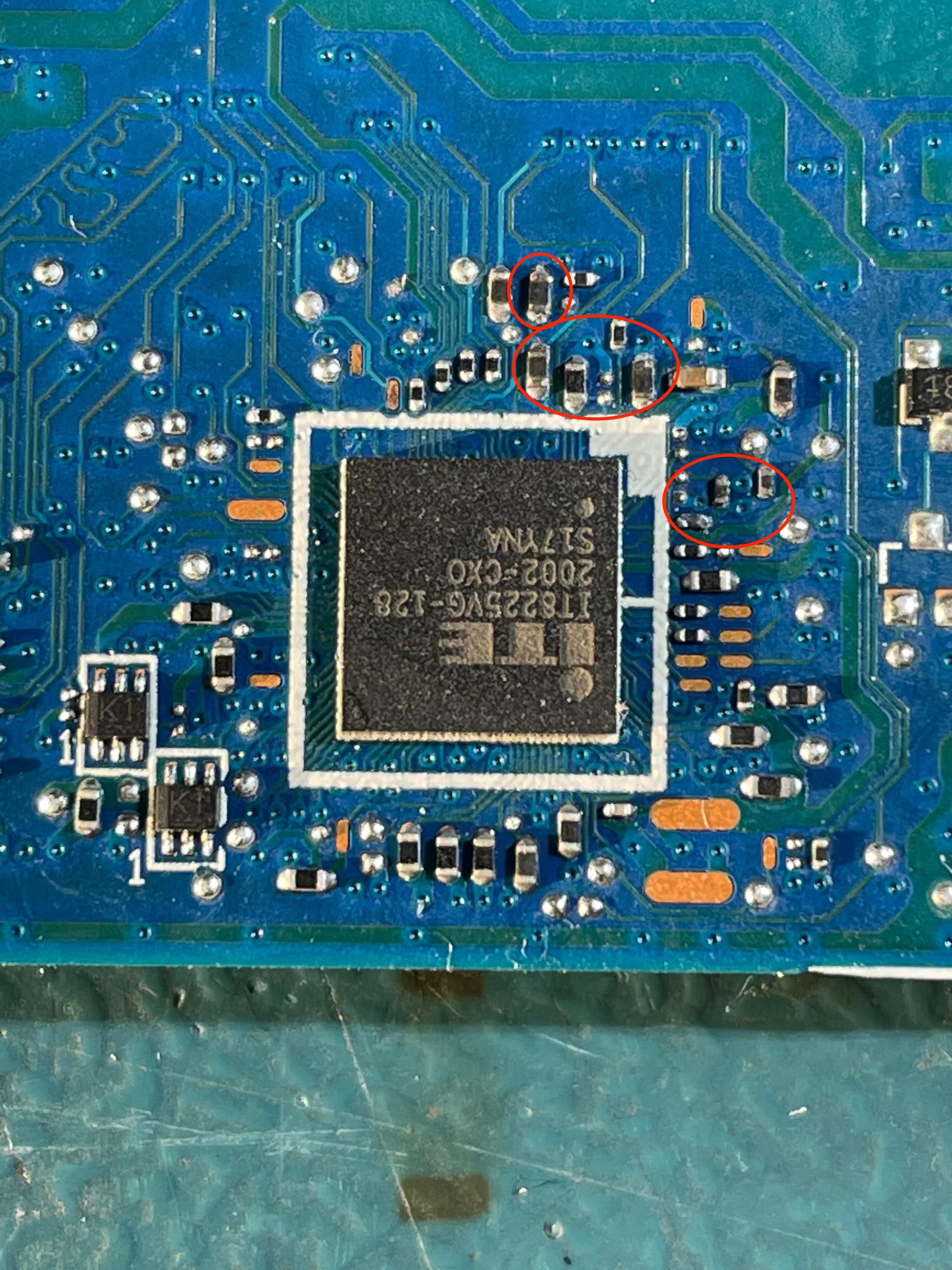

    Hi guys,
    I have this UX534FT motherboard with some resistors damaged by liquid. Can't find any schematics.
    Could you identify the value of selected resistors please?

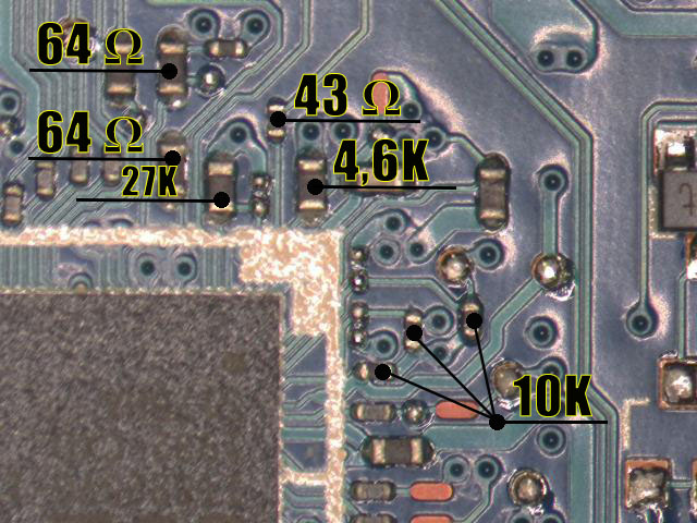

    Re: Asus UX534F MB:UX534FT components identification after liquid spillage.
    Hi mate,
    I'm asnwering in place of Pedro because he doesn't write in English, he understands well enough though.
    Attached is the schematics with the values you needed measured in motherboard.
    I hope this info is still useful to you.
