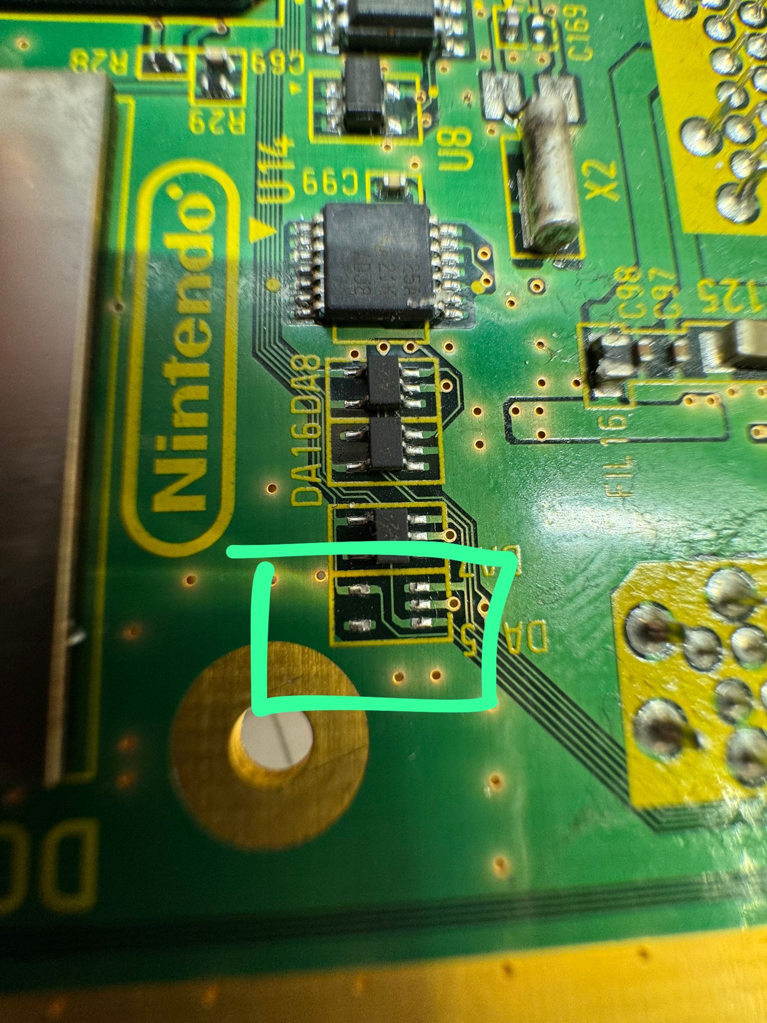

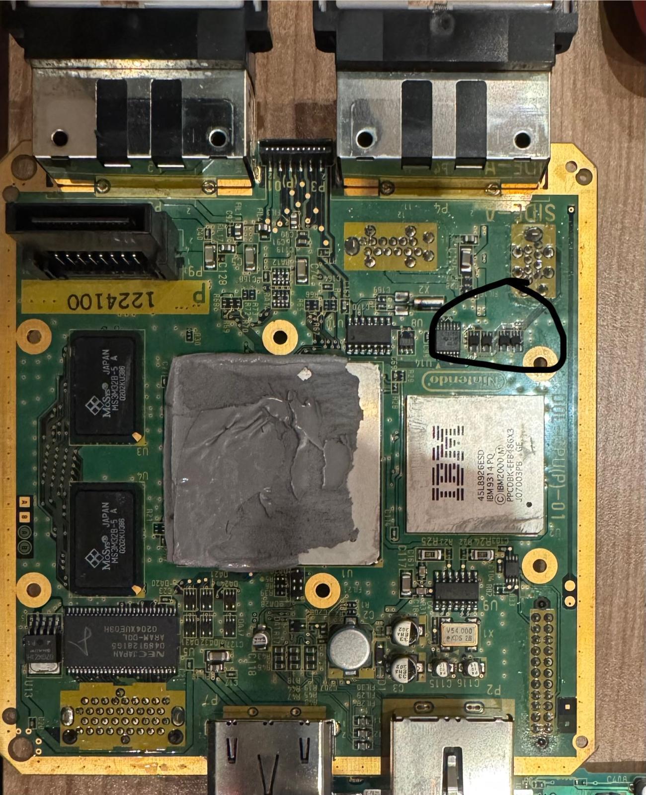

Nintendo Gamecube missing component DOL-CPU(P) - 01 (Side A)
This topic has been answered.
  • Baspotv
    replied
    Originally posted by lotas
    Well, you can measure the resistance between 1, 2, 3 pins with a multimeter and check that these are diode assemblies or digital transistor assemblies, especially since they are designated Dxxx on the board.
    Just checked, you were right tysm you saved my Gamecube! Do you know by any chance where I can get a cheap laser for the GC?
    Leave a comment:
  • lotas
    replied
    Originally posted by Baspotv
    I checked on another board and there the Component is marked A1. How can I know or how do you know that it's the 1SS308 and not the UMA1N?
    Well, you can measure the resistance between 1, 2, 3 pins with a multimeter and check that these are diode assemblies or digital transistor assemblies, especially since they are designated Dxxx on the board.
    Leave a comment:
  • Baspotv
    replied
    Originally posted by lotas
    The A1 marking is hard to see; if A1 is there, then this is assembly 1SS308.
    A1=1SS308
    A2=1SS309
    If 2 pin is connected like the third assembly, also with 2 pin, then this is A1.​
    I checked on another board and there the Component is marked A1. How can I know or how do you know that it's the 1SS308 and not the UMA1N?
    Leave a comment:
  • lotas
    replied
    Originally posted by Baspotv
    Are you sure that the other component is not A1 marked, bc right next to it there is one component marked A1 and the other one is marked A2
    The A1 marking is hard to see; if A1 is there, then this is assembly 1SS308.
    A1=1SS308
    A2=1SS309
    If 2 pin is connected like the third assembly, also with 2 pin, then this is A1.​
    Leave a comment:
  • Baspotv
    replied
    Originally posted by lotas
    The marking on your missing component is not A1, but A2, and it looks like a -1SS309 diode assembly.
    Are you sure that the other component is not A1 marked, bc right next to it there is one component marked A1 and the other one is marked A2
    Leave a comment:
  • Baspotv
    replied
    Thank you so much and sorry for the late respond, I had many problems to solve in the last few weeks
    Leave a comment:
    replied
    pins 1 and 3 go to the serial port,
    pin2 goes to ground - but on the complementary part it goes to vcc
    pin4 goes to the main chip and the serial port.
    pin5 is not used
    Leave a comment:
    replied
    well mine has different markings.
    and the 4 arent the same, it's 2 pairs of possibly complimentary parts
    the missing one is "M5C"
    the one next to it is "M5B"
    they are going to the internal serial port used for stuff plugged into the base.
    probably buffers or line-drivers - i'll try to id those numbers
    Leave a comment:
  • lotas
    replied
    The marking on your missing component is not A1, but A2, and it looks like a -1SS309 diode assembly.
    Leave a comment:
    replied
    not yet, need a couple more days.
    i had to spend half the day cleaning it and finding a new fan.
    also it has a lithium battery that will be dead by now.
    it's not rechargeable, it's just a cr2032
    your friend better understand that the lasers do wear out if he uses it a lot.
    Leave a comment:
  • Baspotv
    replied
    He wants it to be fixed without the modchip, he's a videogame collector and wants it to be like original, he already has almost every game on dvd, so for this device I only need the capacitors and the part that is missing, were you abled to figure out what this part is/does? And btw thanks for your help already
    Leave a comment:
    replied
    i wouldnt try to fix the dvd,
    just fit the €4 modchip and get a €2 micro-sd adapter from aliexpress.
    this is the thing you need with the modchip to get it going:
    https://github.com/emukidid/swiss-gc/releases
    the modchip redirects reads from the dvd to the sdcard,
    swiss is your boot-menu & ISO loader
    Leave a comment:
  • Baspotv
    replied
    Thank you, I dont think so either, i guess its the capacitors, now I am on my way to order a new set for the GC. I don’t have any other idea what could cause the issue except for the disc drive itself.
    Leave a comment:
    replied
    pure coincidence, i just got a gamecube to strip down for a good clean and fitting a modchip.
    i'll see if i can identify the part at the weekend.
    i think the problem is unrelated though, the dvd drive may have issues but the area in your pictures is i think related to video output - i'll find out.
    your friend should play games from an SD card btw.
    https://github.com/webhdx/PicoBoot
    Leave a comment:
  • Nintendo Gamecube missing component DOL-CPU(P) - 01 (Side A)
    So today I was checking on a GC board that I got from a friend and he told me the GC would get an error and doesnt want to read games after a couple of hours gaming on it. So I suspected it to be some bad solderconnection or an capacitor, when checking the solder connections of various components one of them was so loose that it flew off. I think the component right next to it is the same. The board says it's DA15 and I've never heard of that designation. The Text on the component says A1, and this also doesnt help me out. Maybe one of you guys knows what part that is so I can order it instead of buying a broken board and stealing it from that one.
  • badcapped
    Nintendo Switch draws 470mA one side on 5v only and boots ...
    by badcapped
    Hello
    I have done some Nintendo Switch Consoles, but this one is getting to me.
    I am a few years from 'retirement' and things are getting hectic - just to get on with daily repairs I do to get to the 'retiring' time!
    I am no expert on consoles but here it is and I am not much on forums, although I would love to - I have not time, with family commitments too - everybody always asking for something!
    It came with its charging port 'snapped' from its welded anchor plate.
    I believe customer had previous problems and wiggled connector for a long...
    12-04-2021, 02:45 AM
  • flibidy
    Magnum IA.100 Amplifier Switches on, No Output, Possible Input Side fault?
    by flibidy
    I have here a Magnum IA.100 which belongs to my parents.
    The unit powers on & when the relay kicks in, you get a pop from the speakers (this might sound weird but is usual behavior for this amp). However, you get nothing coming through it from any of the inputs & no pops and crackls from any of the controls.
    Because of the sound from the speaker when the amp turns on I have assumed that the output section probably works but I could be wrong & I'm not sure how to test that side of things further.
    What Ive done........
    01-01-2025, 01:26 PM
  • SRO2
    Missing component on Nintendo Switch
    by SRO2
    While changing the charging connector on a Nintendo Switch, a component flew out because of the hot air coming from the hot air station... I would like to know if any of you know the reference of this component?
    I attach a picture with the location of the component. Thanks for your help!...
    10-11-2022, 03:30 AM
  • Tomylee
    No LCD image after connector replacement – lifted components and damaged resistor (Nintendo Switch Lite HDH-CPU-02)
    by Tomylee
    Hi everyone,
    Sorry for the person who’s going to read all this !
    I'm on a Nintendo Switch Lite, motherboard HDH-CPU-02.
    While replacing the left joystick, I had to remove the motherboard to access the connector underneath. When I lifted the LCD connector latch, it broke (the plastic had become brittle over time), so I replaced the entire connector.
    During the desoldering of the LCD connector using hot air, three small components located just below the connector (likely 0402 capacitors) came off and remained stuck to the bottom of the...
    07-11-2025, 11:52 AM
  • ugamazing
    820-02020 PPBUS_AON missing
    by ugamazing
    Board had no history of liquid; unsure of drop history, but no signs of damage of any kind worth noting.
    Charger sitting at 5v/0a. PPBUS is at 1.9v-0.9v steady cycle (peaks, drains, loops). Confirmed CHGR_EN_MVR is missing, but DCIN was reaching ISL just fine, so replaced ISL--no change at all. Confirmed pp3v8_aon is also missing--and being unsure *exactly* which signal appears first (or if they are simultaneous), I inspected PMU/U8100 area and found no shorts, but also found PP3V8_AON_MPMU_ISNS_VIN missing (not shorted). Replaced U8100 just in case (have had them fail in weird ways),...
    02-05-2025, 04:21 PM
