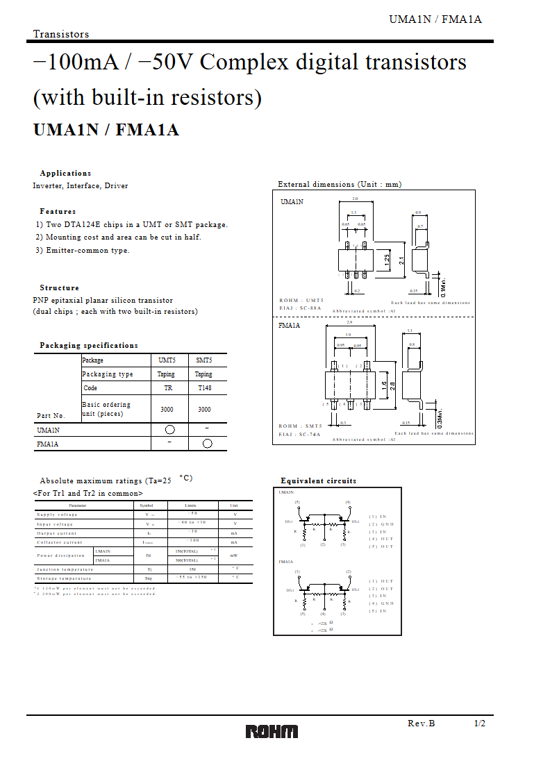

    So today I was checking on a GC board that I got from a friend and he told me the GC would get an error and doesnt want to read games after a couple of hours gaming on it. So I suspected it to be some bad solderconnection or an capacitor, when checking the solder connections of various components one of them was so loose that it flew off. I think the component right next to it is the same. The board says it's DA15 and I've never heard of that designation. The Text on the component says A1, and this also doesnt help me out. Maybe one of you guys knows what part that is so I can order it instead of buying a broken board and stealing it from that one.

    Originally posted by Baspotv
    I checked on another board and there the Component is marked A1. How can I know or how do you know that it's the 1SS308 and not the UMA1N?
    Well, you can measure the resistance between 1, 2, 3 pins with a multimeter and check that these are diode assemblies or digital transistor assemblies, especially since they are designated Dxxx on the board.

                The marking on your missing component is not A1, but A2, and it looks like a -1SS309 diode assembly.
                        Are you sure that the other component is not A1 marked, bc right next to it there is one component marked A1 and the other one is marked A2
                        • lotas
                          • Jan 2016
                          • 4829
                          • Russia
                          The A1 marking is hard to see; if A1 is there, then this is assembly 1SS308.
                          A1=1SS308
                          A2=1SS309
                          If 2 pin is connected like the third assembly, also with 2 pin, then this is A1.​
                            A1=1SS308
                            A2=1SS309
                            • lotas
                              • Jan 2016
                              • 4829
                              • Russia
                                Just checked, you were right tysm you saved my Gamecube! Do you know by any chance where I can get a cheap laser for the GC?
