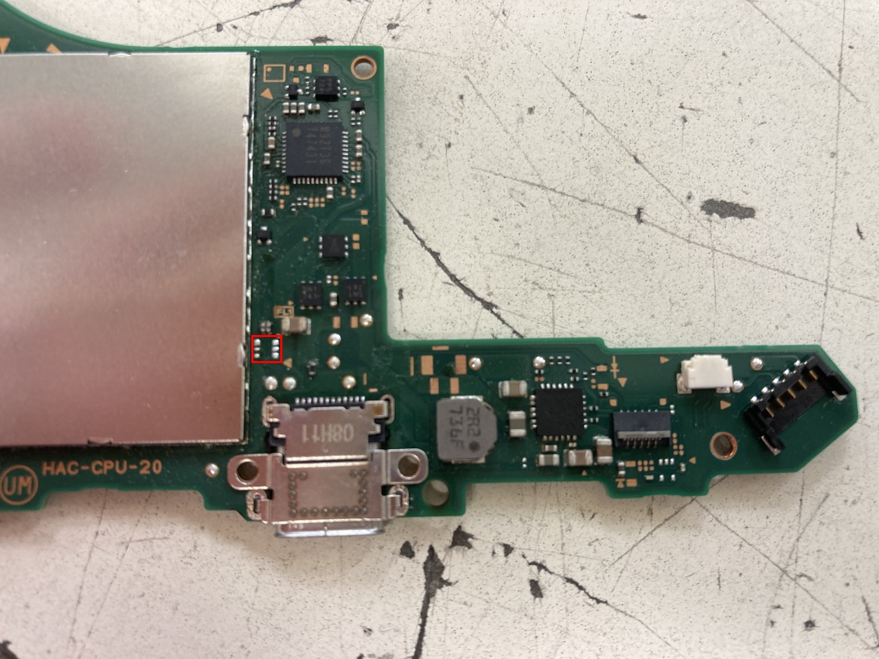

    While changing the charging connector on a Nintendo Switch, a component flew out because of the hot air coming from the hot air station... I would like to know if any of you know the reference of this component?
    I attach a picture with the location of the component. Thanks for your help!
  • lotas
    • Jan 2016
    • 4899
    • Russia
    Re: Missing component on Nintendo Switch
    These are TVS Diode ESD Suppressors, everything will work without it (on HAC-CPU-20) they were not installed.
    https://gbatemp.net/threads/dead-boa...-found.574427/
