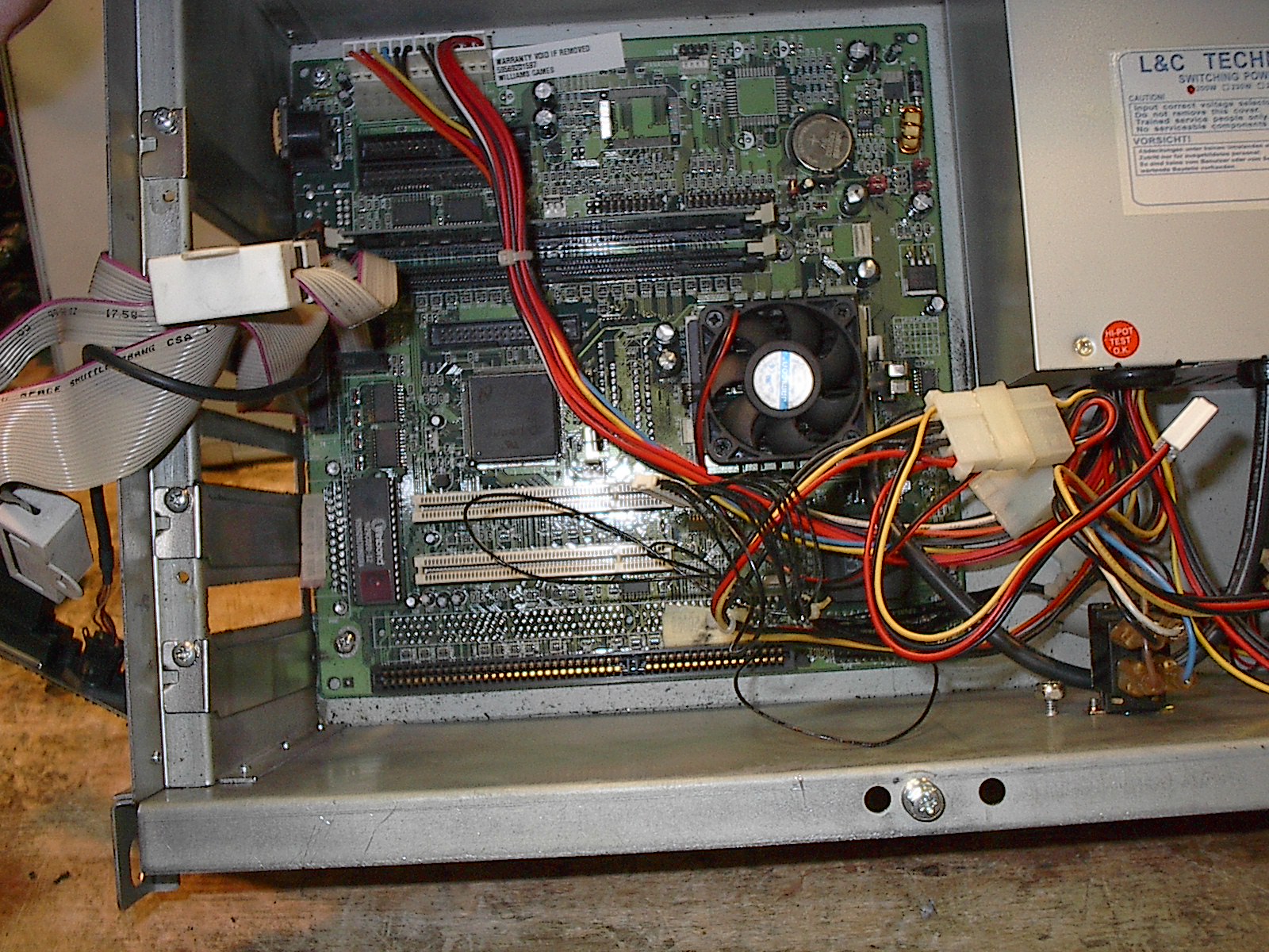

                  Re: Arcade games and bad caps...
                  Here's the Star Wars pinball 2000 board with bad caps. Hard to see in the picture though.

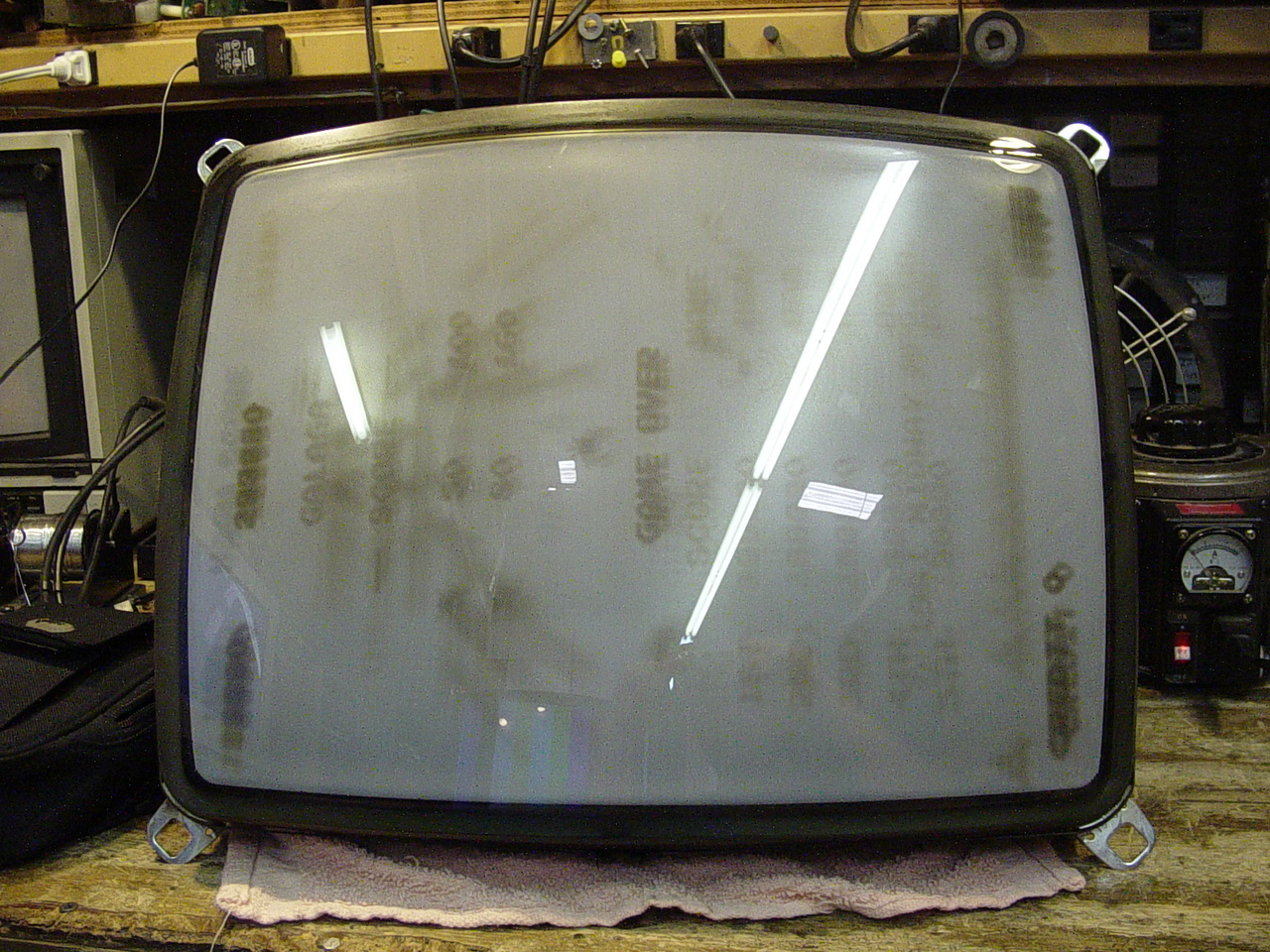

                    Here's a pic of a really toasted tube that came out of a game with around 175,000 or so hours on it. The monitor had all the original caps on it and it finally started to die out after 20+ years of continuous operation in a bar.
                    The best part is, the tube still had a good picture aside from the burn. RCA made good tubes back then. I recapped the board and replaced the tube with one from a TV I picked out of the trash, and it looks like new now.
                    I can understand the non-moving parts of the display burning in, but this one even burned in paths from the moving objects.
                      Hey that old tube has ccfl backlight I see from your pic.
                      Jim
                      • Maxxarcade
                        • Jul 2006
                        • 973
                        Ha! Even if it was, no ccfl could ever touch the lifetime of a good ol' crt
                        I also just noticed you can see the reflection of the recapped monitor with the new crt, running for testing behind me.
                            Oh look...the Star Wars board has an L&C power supply. No wonder it died...
                            It's weird how much it looks like an AT PC. The other one, not so much, though.

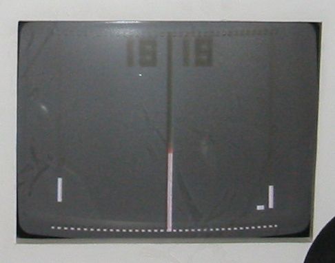

                                I've frequently seen arcade games with the INSERT COIN message badly burnt into the CRT. The problem seems to occur most on the projection CRT monitors, but also on standard CRTs. I've even seen the INSERT COIN message burnt on the newer plasma displays used in games such as House of the Dead 4.
                                Incidentally, the plasma screen can't be 'read' by the gun in the same way as CRTs, so they have to put small IR-LEDs around the screen - but that's another story.
                                I've attached a picture of the monitor from an original Pong game that was on display in a museum. It was actually switched on while I took the picture, but because of the flash the camera's exposure was drastically shortened. Therefore, not much of the actual image was shown - but the burn is clear to see.
                                Being Pong, I'm sure this wasn't the original B/W CRT that came with the cabinet; it would have long since failed. But still, being on for all the time the museum is open has taken its toll on the replacement screen.
                                Speaking of bad caps, I haven't actually SEEN any in arcade games but I'm sure I've seen symptoms before! I saw one game that only booted up properly every 4th or 5th time, and often froze in mid-game. Another one was doing a ROM test error on startup, with a different ROM failing each time!
                                I wonder what would happen if the caps went bad inside a one-arm-bandit machine? Would it keep paying out indefinitely? Would you spin a win and it not register? Probably the worst thing that would happen is you'd put your money in, then the game would reboot and reset the credits to 0.

                                  It could be the original CRT; we have quite a few b/w games from the 70's (space invaders, asteroids, pong/hockey, atari football etc) that still have the original CRT's in them, and they are burned just like that. We have an Asteroids here that actually has spots where the phosphor fell off the glass in the burned spots, and it still has decent brightness on the good phosphor.
                                  Projection displays do burn much faster though because of how bright the CRT's have to be. The on-time and the fact that the cooling fluid can only dissipate so much heat in the poorly ventilated cabinets doesn't help either.
                                  As for plasma, I've heard they actually burn faster than most regular CRT's do...
