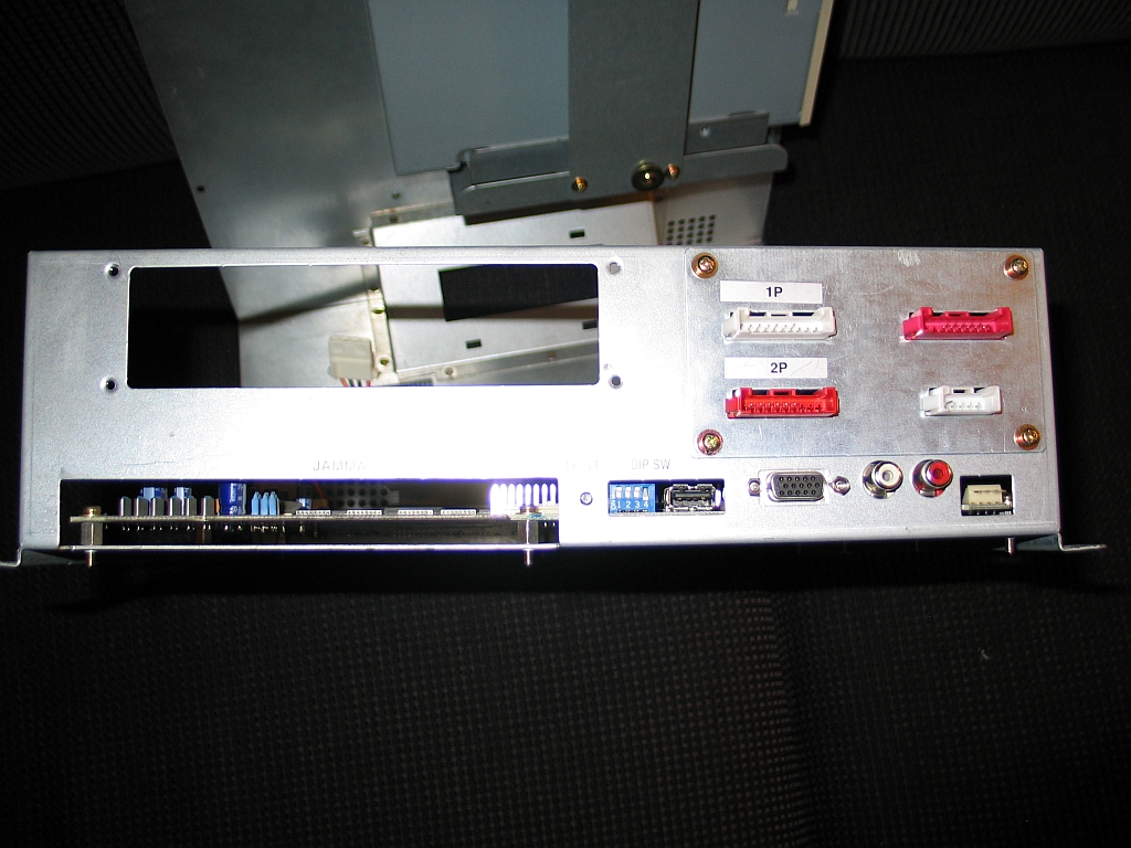

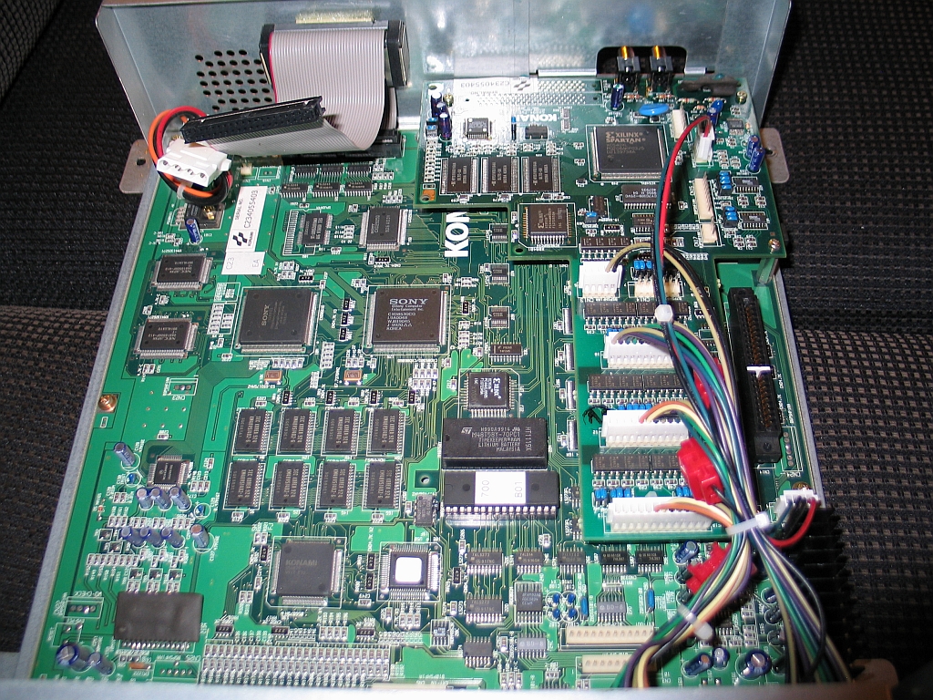

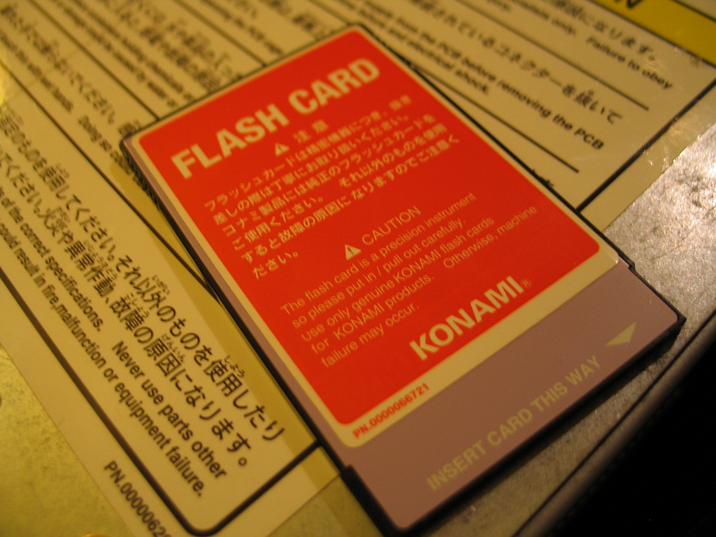

    Got hold of this arcade main unit yesterday, is's a Konami DDR board with the pcmcia card and cdrom.
    I did notice only Rubycon and Matsushita caps, all rated for 85 degree.
    Anyone know how to check if this thing is working ? 12V or 24V ? how many amps ?

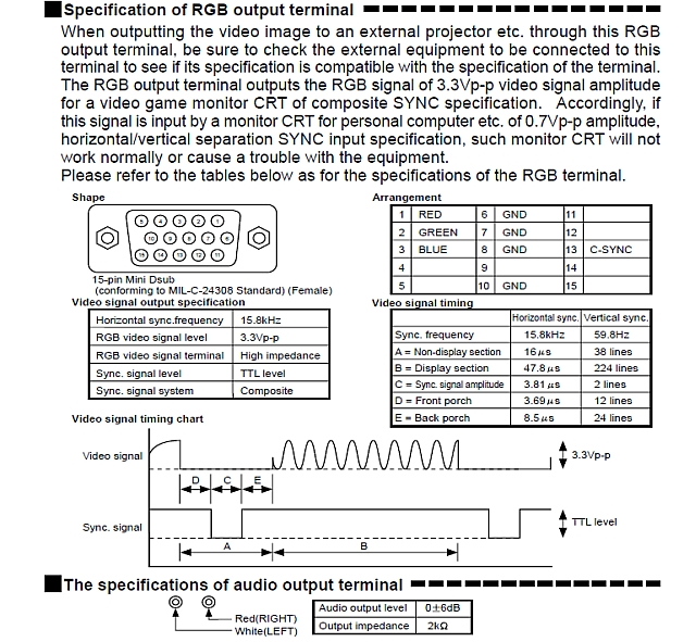

    Is this 15KHz or 31KHz vga ?

      iirc 31.5

        Looks like this unit is 15KHz, can do a scart workaround to see if it works.Also found the blue security cassette so now this is complete.
