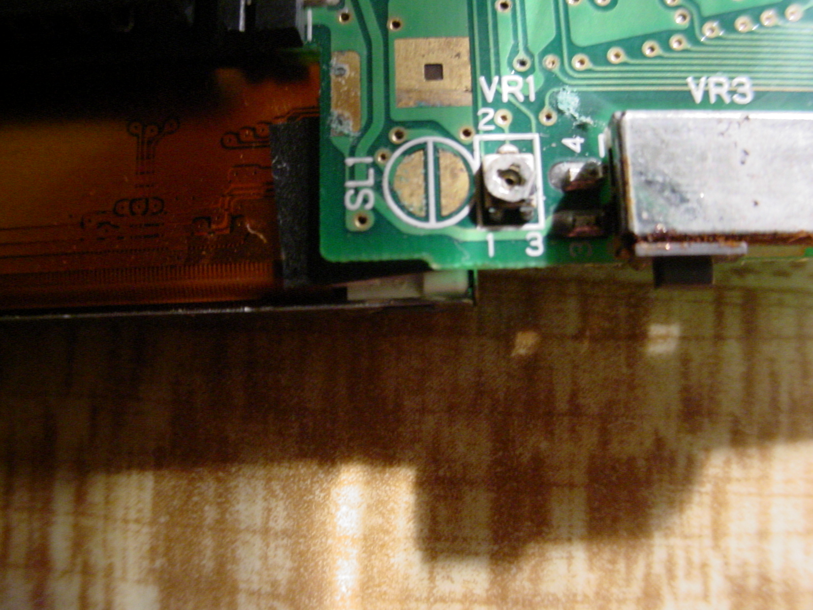

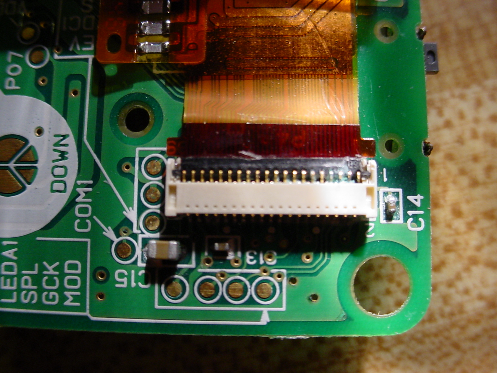

    My granddaughter's DS game stopped working on the lower screen. It has a back light, and you can hear some sound, but no video. Got it apart and found a cap that looks bad. It is next to the data ribbon going to the lower screen. There's corrosion on the cap and the connection. I can't tell what this cap is other than C14. I can't find a diagram or parts list. I've not worked with anything this small. It appears to be a surface mount and half the size of a match head. Thanks for any help identifying this little devil.
    The second pic is the backside of the board, it's a pot, I found something on it in an older thread.

                C14 is a multi-layer ceramic capacitor. These ceramic caps normally short out if they are bad. Measure the resistance across it with a multimeter. If it doesn't read less than 30 Ohms, it's probably fine. If it does read less, remove it and check it again out of circuit.
                If it is bad, normally I just find a junk board and pull one off that's the same size. So far, I haven't had a case where this doesn't work.
                Be careful with those ribbon cables and connectors - they are very easy to break! After opening a few of these DSs, I find them not worth my time to repair now.

                    I removed connector and cleaned everything up (cap C14 doesn't look so blown up now) put it back together & same results, no lower screen display. I probed around on that cap and got no readings, there are a couple of other tiny caps on that board, I got some readings from them. So now, I'll find a lookalike on an old board and try to replace it. This will be like tyring to solder under a flea's wing.
                      I doubt the problem is with any of the ceramic caps. The whole area around the connector looks like it has some corrosion/water damage to it. But perhaps, that's just how the picture came out.
                      Can you post a full picture of the board? There might be some fuses. I know the game card slot has quite a few of them.

                      Did you really remove the connector (as in desolder it) or did you just remove the ribbon cable from it? Also, how did you clean it and what did you use for the cleaning?
                      I would suggest cleanning the connector with 90% (or higher) alcohol. If you can, gently try cleaning the pins inside it as well. Like I mentioned earlier - BE VERY CAREFUL! Those connectors and ribbon cables are extremely fragile.

                        Yea, this is a learning experence. I learned this cap is too mirco sized to mess with. I took one off an old MB that was close to the size of that one. When I removed the one from the DS, that thing looked the size of a grain of sand, OOPS.
                        I did get the cap replaced, finally, but that wasn't the problem. After i got it off and looked at it under a 60x scope, it was clean. Gave me a bad feeling.
