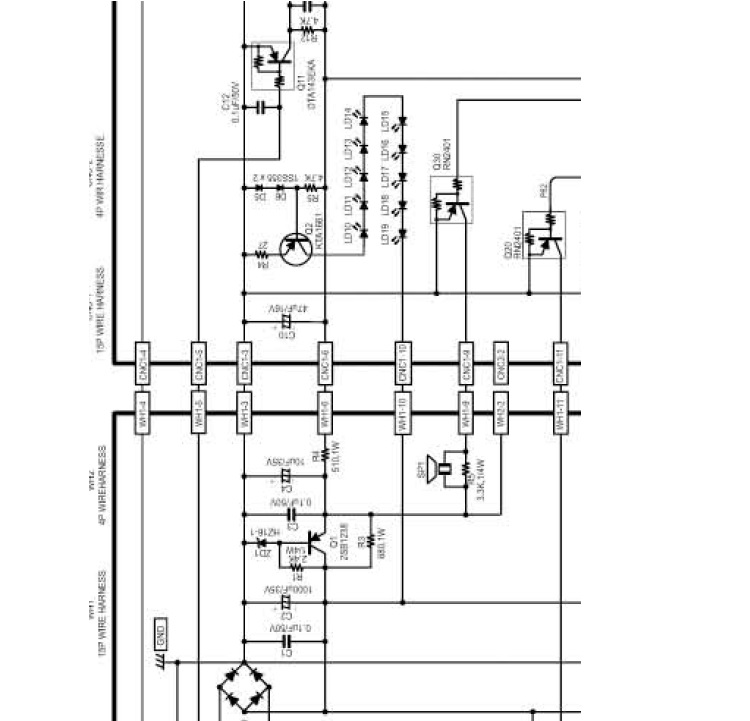

    Need help fixing mums Sharp microwave oven combi.
    R-595 (sl)a
    Backlight has gone. Can still see digits buy super dim.
    Anyone with microwave experience help me out here ?

    Are you sure it uses a backlight or is it a VF Display? post pictures of the control board

        If it is a R-959, the display is an LCD with 10 led backlights (D10~D19) in series with a driver transistor Q2
            Thanks RJ. Sounds right about the number of LED's. There's a good few of them in series. So if I replace that tranny, then all should be good ? Do I need to replace and SMD caps too ?
              • 31248
              Re: Sharp Microwave - no backlight
              if the leds are in series a bad one will stop them all
              having said that - it doesnt look like they are driven hard

                It's gradually dimmed over a period of 1 year. So LED's are probably good, but the Driver has failed.
                Any idea what the tranny part number is, or equivalent?
                  • 31248
                  no, but try reading the voltage across each led instead of just blindly changing stuff.
                  did you meter the transistor?

                    I'd have to desolder the whole LCD panel to gain access to the LED's behind it. Thanks Sharp. Lol.
                      • 31248
                      well if you can get to the transistor you can test that with a meter
                      10 leds in series is gonna need 20-30v so thats what needs to be seen

                          Looks like the supply for the led circuit is around 18 volts, Q1 is the regulator transistor, C4 is the reg. output cap, R4 seems to be 51Ω1W then there is another C10? 47µf/16v so the actual voltage for the leds is likely around 10~12v, the schematic gets blurry when enlarged.

                              What about Q2 ? It's directly connected to the LED.

                                Q2 is the driver .

                                  Yes Q2 collector connects to the led string, the emitter connects to a 27Ω resistor which connects to the +18 supply. The transistor base gets biased on by D5,D6 and R5
