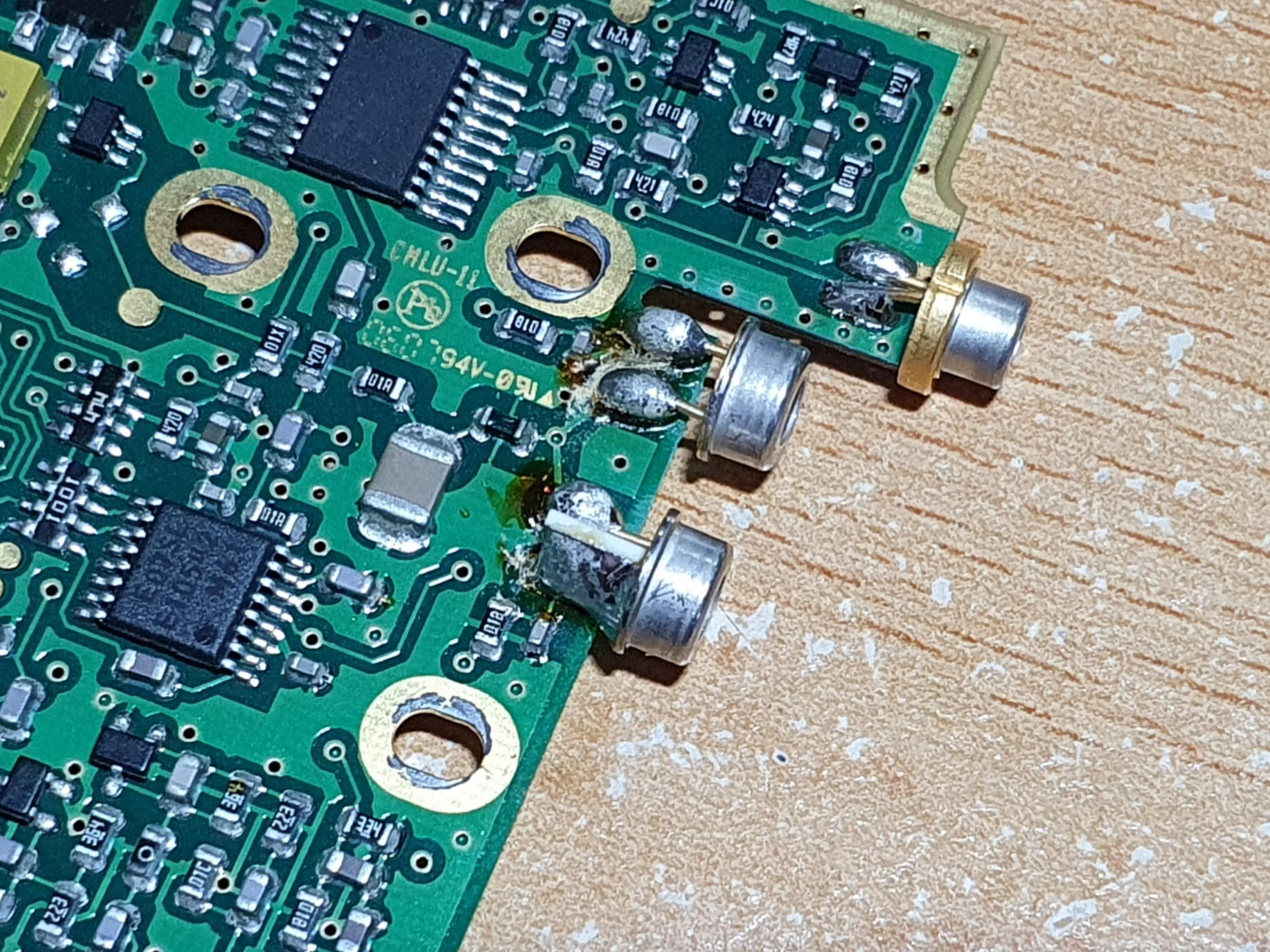

    Good day folks.....wow, seems like forever since I posted anything here Still alive and well, thank you I guess you could say I've become more independent and able to work stuff out on my own. This one though goes way over my head and I doubt is fixable, but maybe some bright spark out there has an equally bright idea.

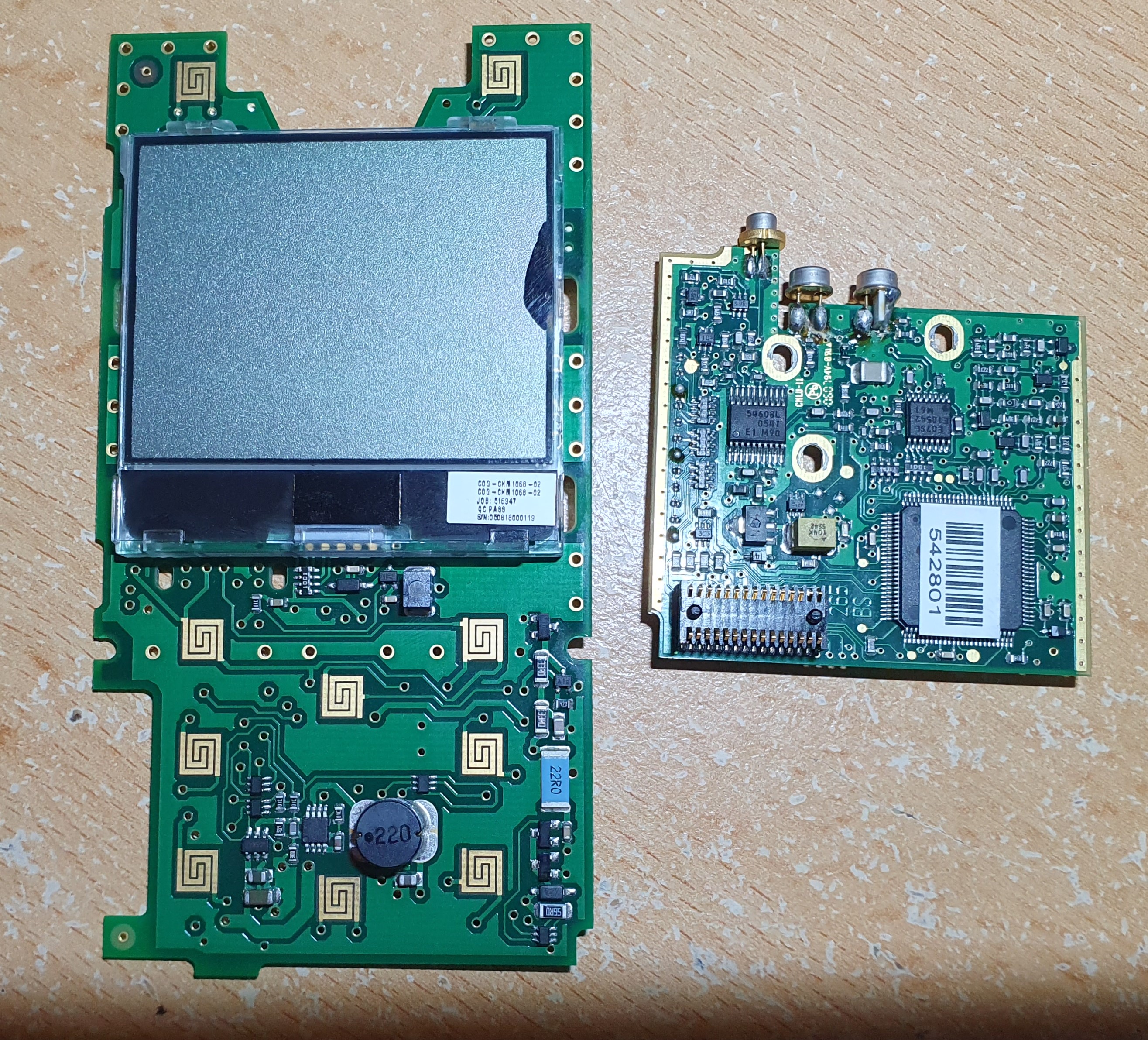

    So: my Hilti PD30 laser meter quit on me just the other day. It was working fine, I set it down for a while and when I tried using it again it gave me an E276 and wouldn't do anything else. I tried taking out the batteries, all that standard stuff but nothing changed. Absolutely no information online on what the error code even means either...
    True, I THINK it did suffer an impact from a falling spirit level at one point. As you can see, the LCD has a black spot on the right edge, so that may have ultimately knocked something else out of alignment. I inspected it under the magnifying glass as much as I could, but didn't spot anything.
    Another thing I noticed is that, initially after the impact, the meter did display its "regular" screen upon power-up - the error didn't show up until I actually tried to fire the laser. The laser would just flash briefly and THEN the error showed up. After removing the batteries, now the error shows up immediately at power up. This led me to believe something died in the optics part (though not necessarily related to the shock): photo transistor or laser diode.
    One thing I tried was powering the laser diode (which is the capsule sitting higher than the other two) directly with my power supply set to a low-ish voltage of 2.5v and around 300mA. It did come on, so I assume the diode is fine.
    Another theory is that one of the photo-transistors "went out", the board reads the current through them at start up, gets nothing in return (or an unacceptable value) and thus throws the error. No idea what them photo transistors are though. All I see is that the diode has 3 leads, the transistors have 2 leads, presumably the light itself acts as the "base". This also doesn't explain why it initially gave the error when the diode fired while now it does it immediately...
    Any two-cents would be appreciated

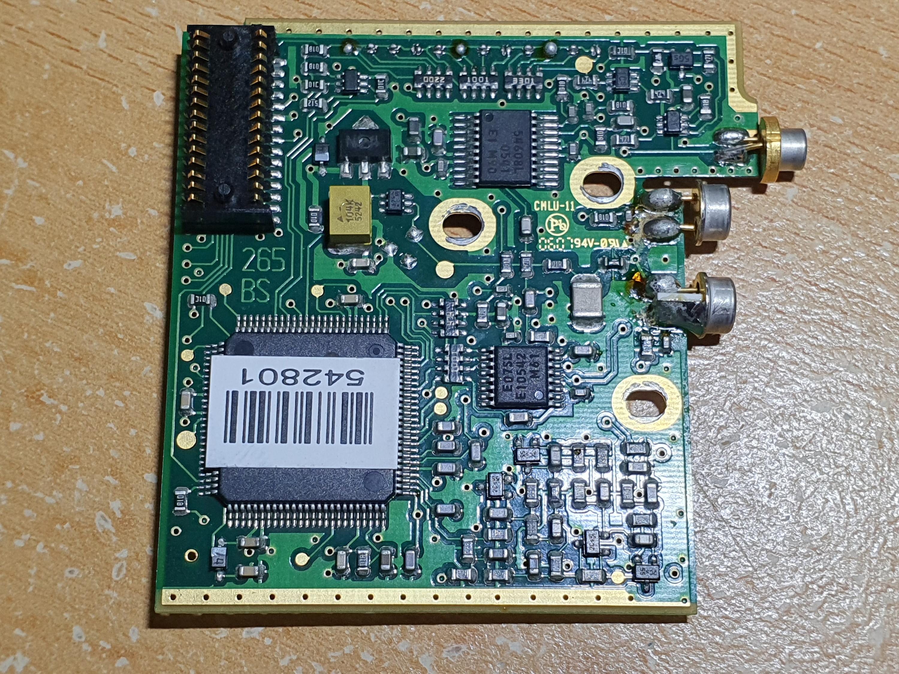

    Did you check the interconnection sockets between the boards? Other than that there isn’t much in there like a laser level for example. The only other thing I can think of is that these laser emitter and receiver is knocked out of alignment, or as you said one being dead or giving the wrong information.
    My bet is the alignment / service is being done through software on this rig and there is nothing much you can do to fix it. Would be nice if it would be as easy as a cold solder joint somewhere.

        might have a cracked trace if its been dropped

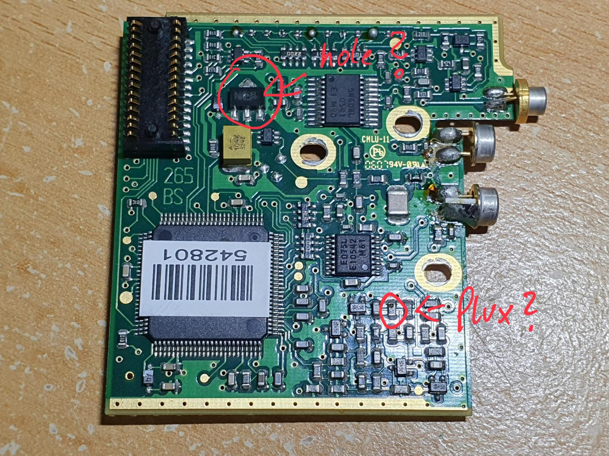

          You seem to have a burnt resistor. Top row of components bottom right on the 2nd photo.

            Looks like flux to me on that resistor? Like this?

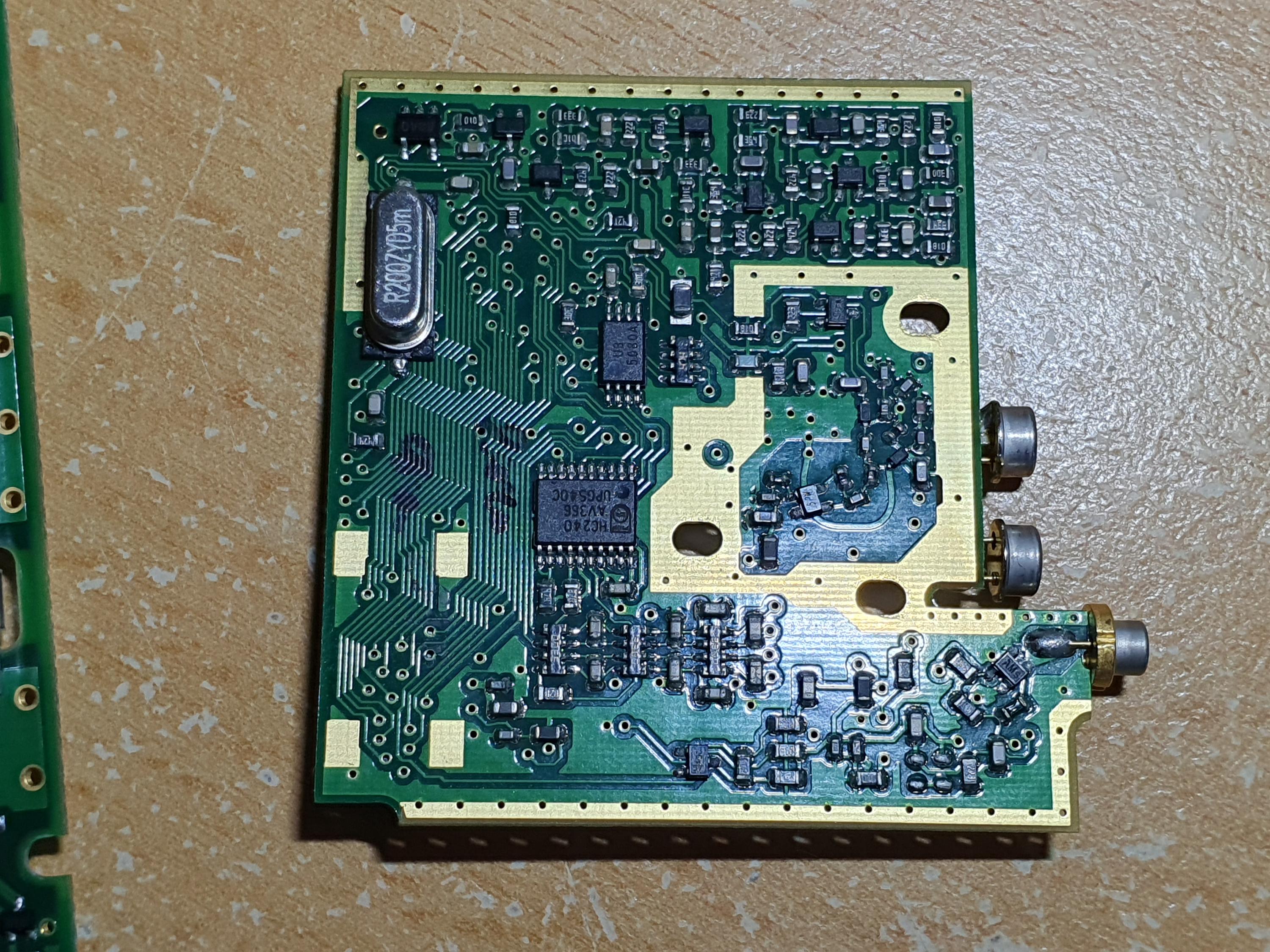

            Maybe check the crystal out if it is swinging…. If not, it will render the board as dead.

                Re: Hilti PD30 Laser Range meter Error 276
                Nope - no key gets it going unfortunately.
                The indentation in the regulator you circled is not a hole. I doubt such a low power device would have enough juice to physically destroy components anyway.
                Also, yes, that's flux residue...
                My old man also suggested something that didn't cross my mind: planned obsolescence: after a certain number of measurements/power cycles, the thing simply refuses to run and returns the mysterious error code, forcing you to get a new one. By the time this happens, it's already WAY past its support/warranty date.....

                        did you check that crystal?
                        • Dannyx
                          CertifiedAxhole
                          • Aug 2016
                          • 3912
                          • Romania
                          No scope sadly....unless I just go ahead and replace it blindly. Even so, if the crystal were bad, I doubt the tool would even power on, nevermind actually display anything, which it does.
