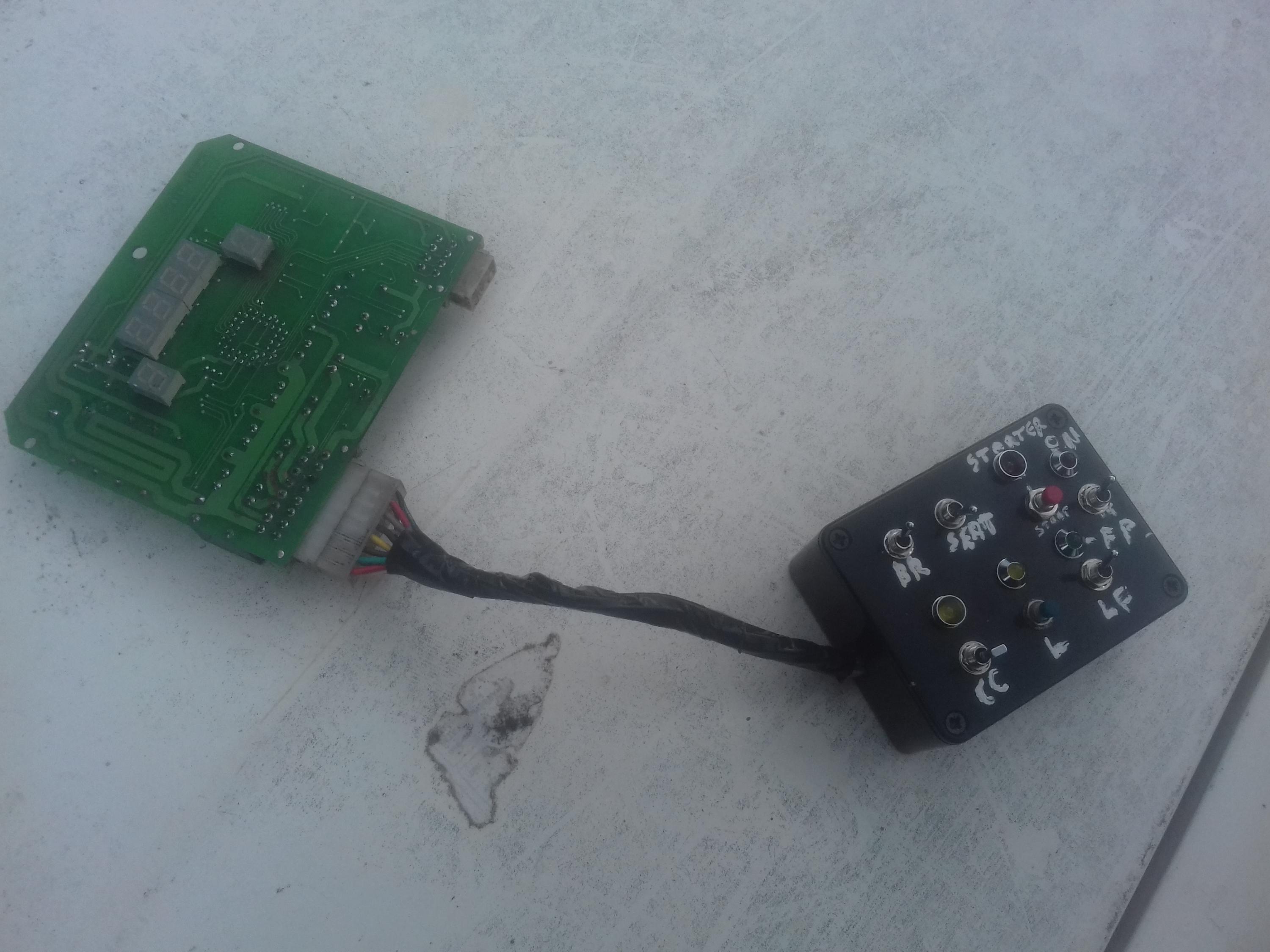

    ok so i built a box to test the electronic dashboards on countax ride on mowers , all works fine and can test all functions with the aid of switches buttons and lights . only thing is the engine rpm that i cant check so need some sort of oscillator i can put together with parts from my stock . and need confirmation where to connect it to on the board . engine kill is short to ground and with it being connected to the coil i presume the signal comes from there .
    thinking will need 1000 to 3000 rpm variable .
    will post pics of my build later .

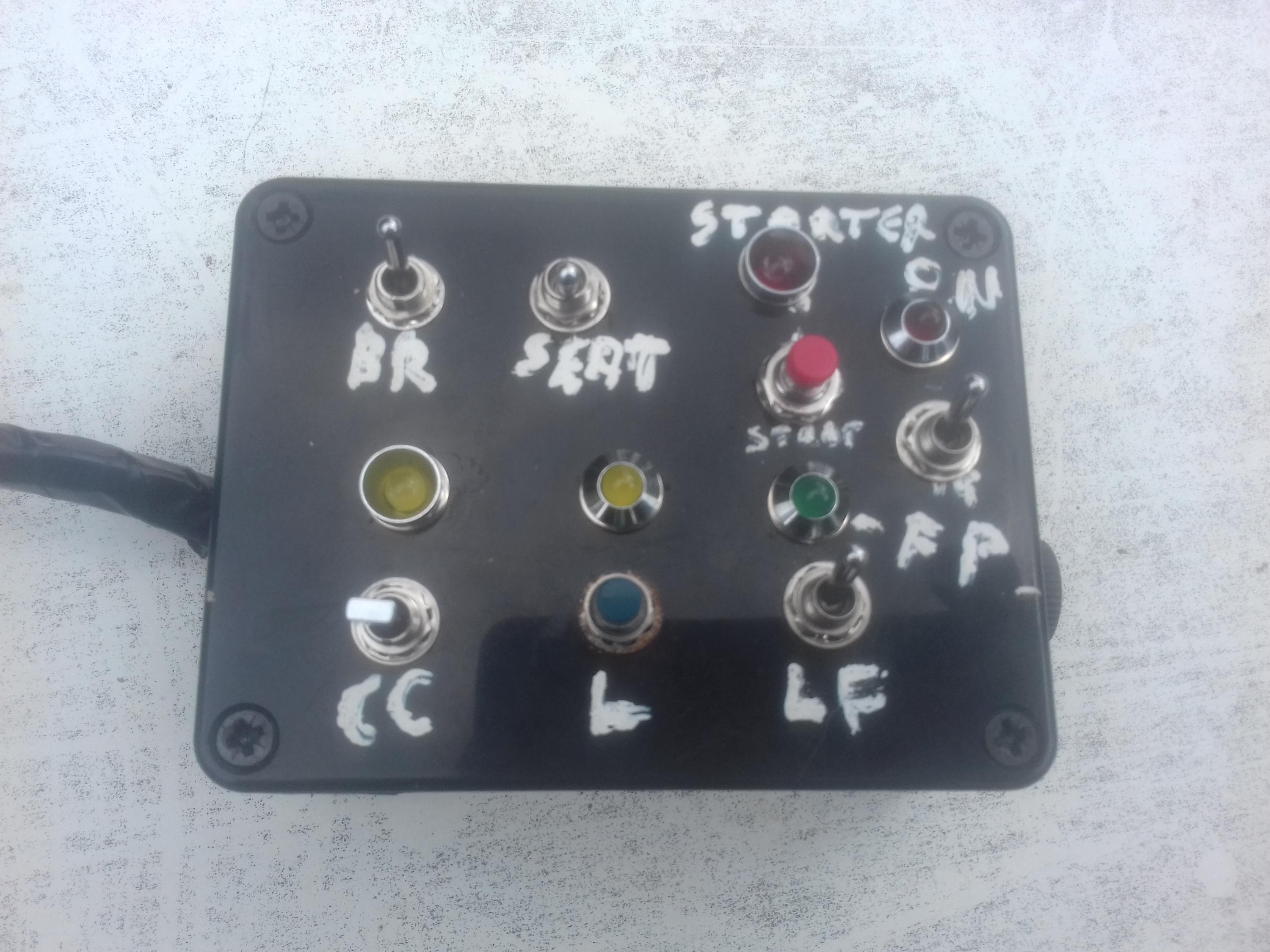

            Re: i built a test box but need help
            ok as promised a couple of bad pictures .. ignore the rough and ready look .its a prototype
              • 31051
              lol - thats quite a mix of led mounts
              have to start calling you Mustie2 if your gonna make a thing of small engine repair

                everything apart from a dc socket that i bought is from what i had lying around here that i got off freecycle and all brand new in packets . as far as i know its the only oms diagnostic box in existence . oms is onboard management system . its made my job loads easier . next upgrade will be a 16 pin socket so i can then make the various leads for other boards . thinking of using car obd stuff for that .
