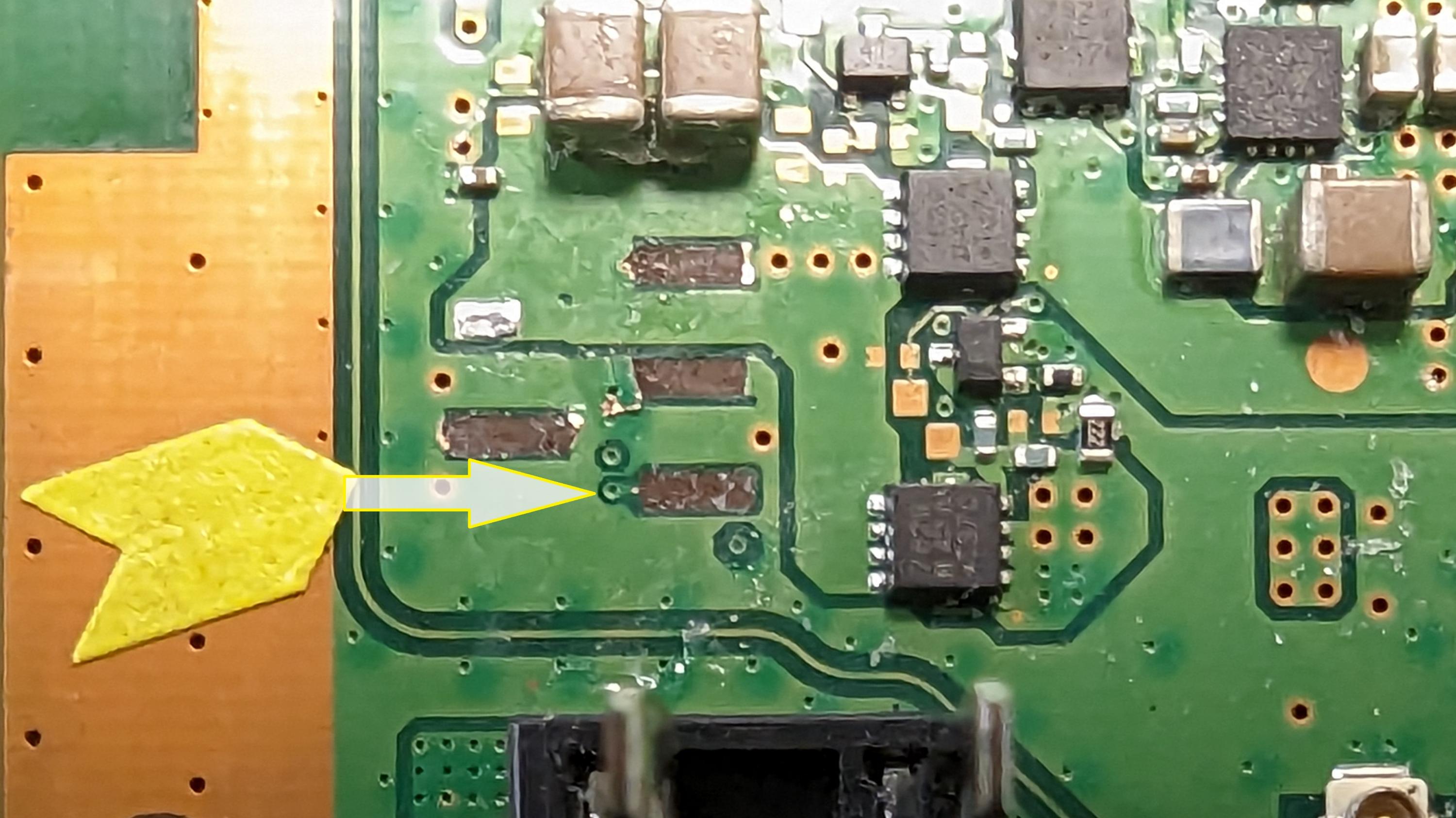

    Ps4 saa-001 broken connector

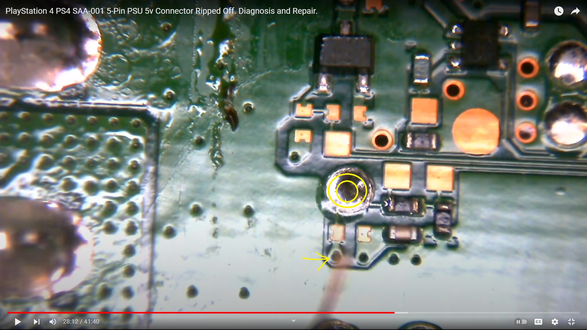

    Does anyone know where I can run a jumper wire to I believe its a power supply cable connector

    Re: Ps4 saa-001 broken connector
    Directly to the via (small circle) that your arrow is pointing to is what I would use to be honest.

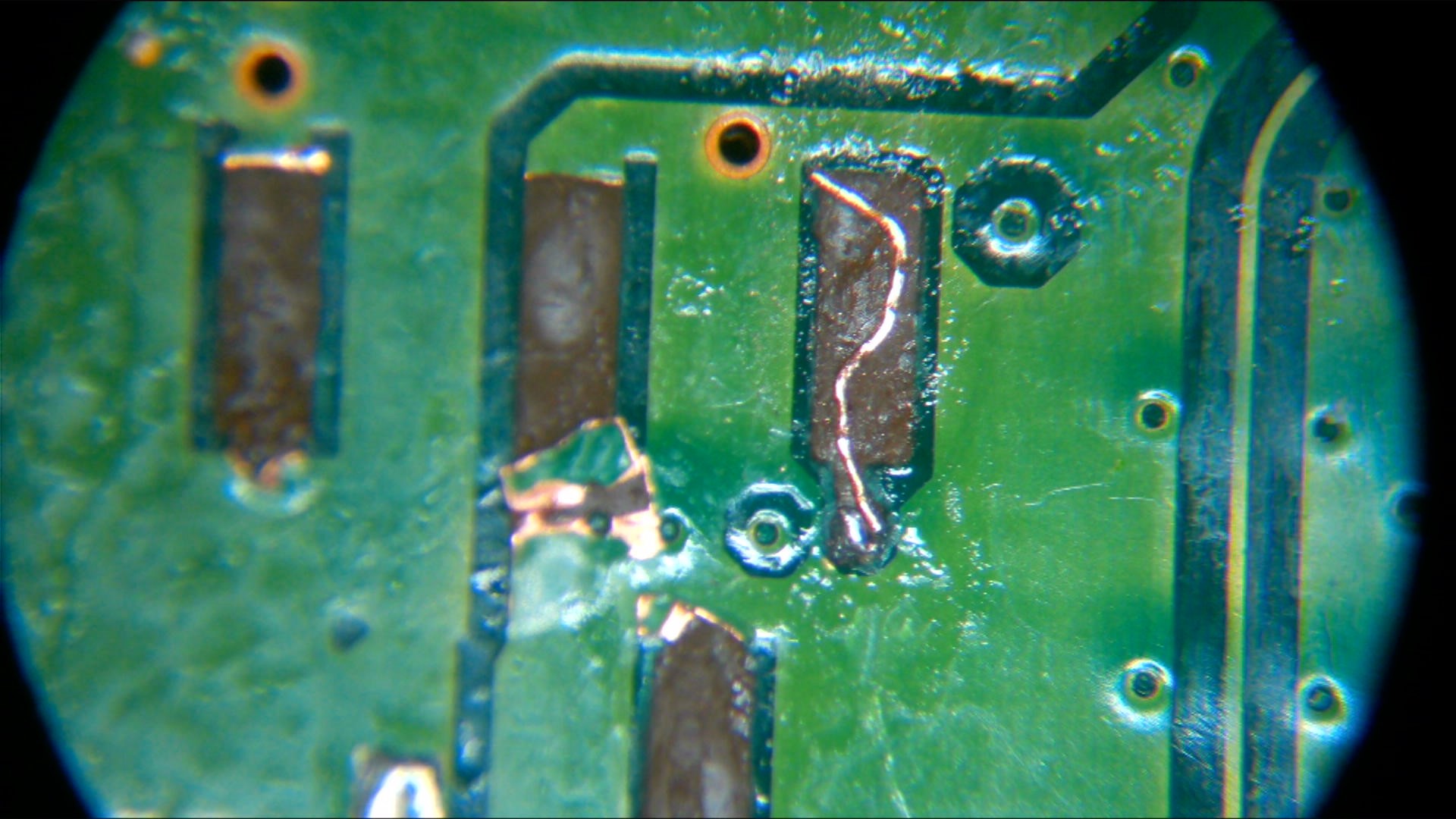

      I trust my skills however this came to me with the connector broken and glue was placed on to attempt to fix it (a kid tried to clean it) exposing the copper and soldering to it is a gamble IMO but I'll do it anyway
        maybe?
        Open to suggestions
          Here, watch this video https://www.youtube.com/watch?v=Nba6HsO7RBU
          Here is the via location on the other side of the board
          Just search Google images for ps4motherboard saa-001
            Thanks for the reply, I'll keep it in mind if I have to do this kind of repair again.
            My ghetto fix actually worked
