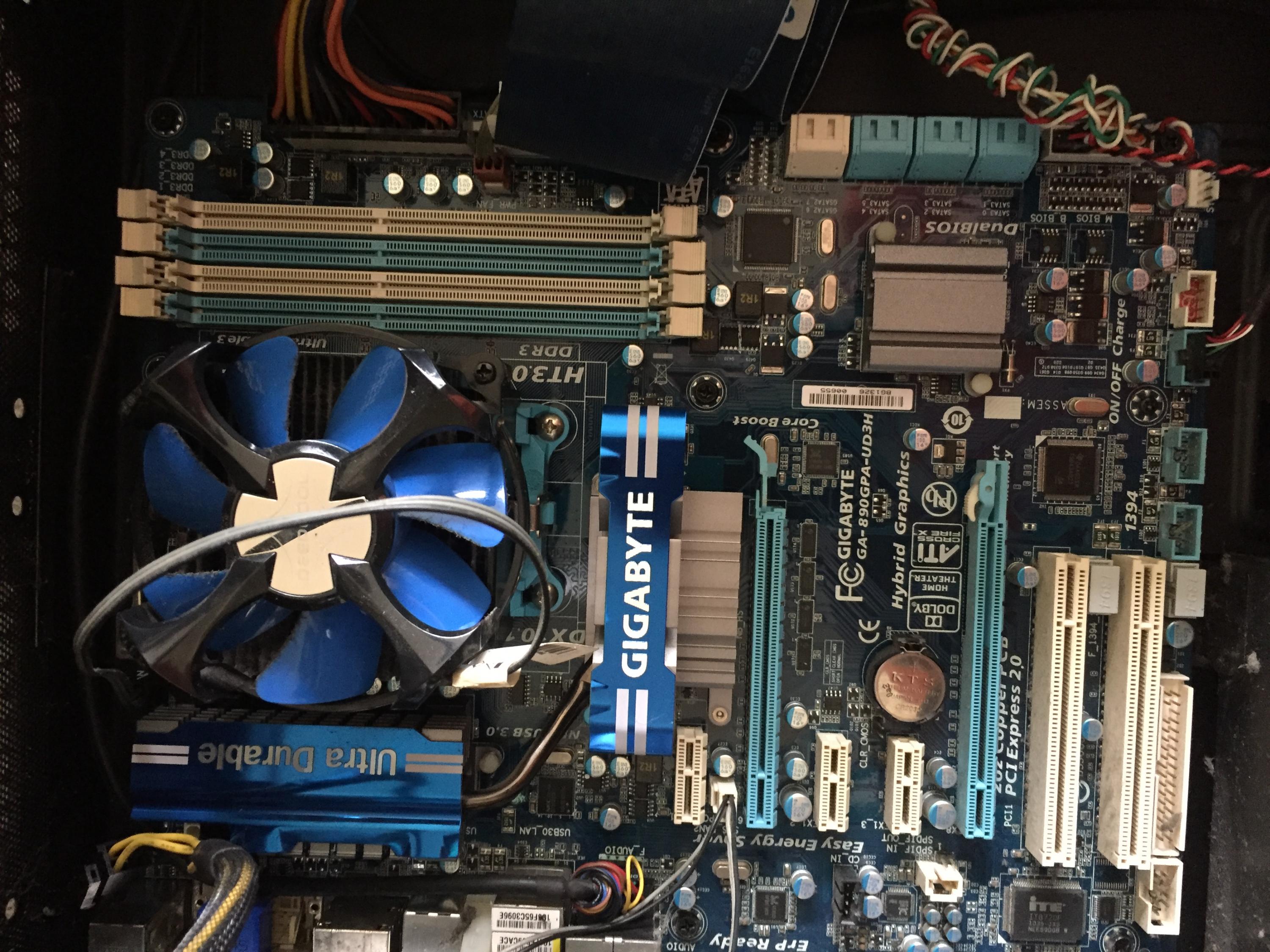

    I need a working bios on this desktop motherboard GIGABYTE GA-890GPA-UD3H please the board has two bios chip

    Go to gigabyte support, choose board revision, download bios,extract bios .

      Re: GIGABYTE GA-890GPA Desktop pc bios needed
      thanks smdflea my board is the same on the link picture you provided does this rev 2.0?
        Rev 2.0 https://www.gigabyte.com/Motherboard...UD3H-rev-20#ov
          I am confuse because all the image are the same and no rev written on the board. I have uploaded the image of the board could you confirmed please what revision should i download
            here is the image of the board could confirm please if it is rev2.0 or up?
              • 20781
              The revision number will be on the edge of the board near the ITE i/o chip .
                ok thank you i already saw it its rev 2.1
                  when i downloaded the file for revision 2.1 it has only 1 file but this board has 2bios chip
                    • 20781
                    Xpress BIOS Rescue - google it .
                      ok thanks so the other chip is the backup chip, so should i flashed only the main bios chip?
                        i flashed both the same file still the same issue turns on fan spins but no display
