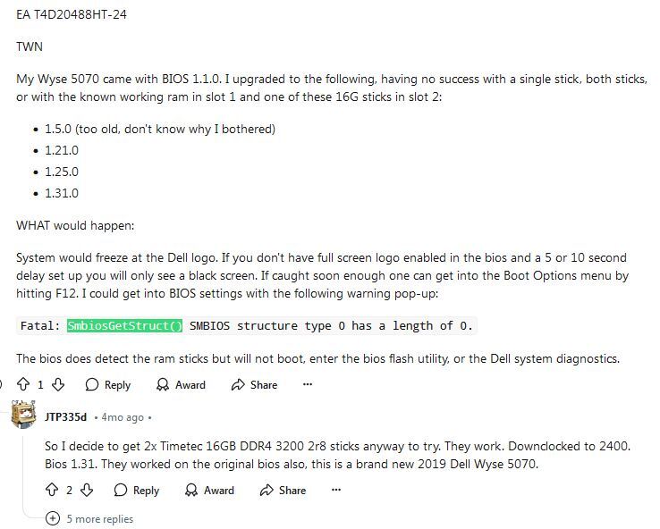

                      can anyone help me fix my bios. An error pops up every time "Fatal :smbiosGetstruct() SMBIOS structure 0 hasa lenght 0" when i try enter to bios. S/N 90T8KT2

                          Power button blink 4/1 orange only now.

                            Try only 1 stick of RAM ,or different RAM. The issue could be RAM compatibility https://www.reddit.com/r/HomeServer/...0_ram_upgrade/
                              Men you are amazing it really works. Thaknks soo much
