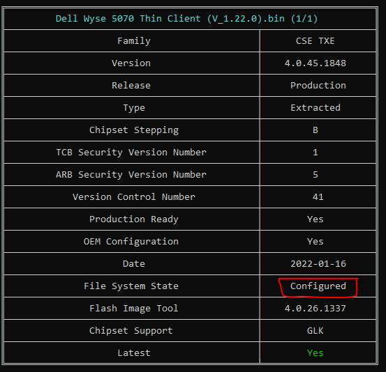

    Hi there! As stated in the title of the thread, one of our problematic Dell Wyse 5070 does not update its BIOS. Is anyone here able to help me by cleaning the BIOS regions and possibly updating the BIOS to ver. 1.20.0?
    The service tag is FMWF5P2.
    I got a dump of its original BIOS with version 1.1.3.
    Thanks!

          Here's your New BIOS, try it and let me know the results.
          Unfortunately, the power LED blinks now. 2 blink pause 1 blink.
          + 4 blink pause 1 blink = CPU config issue or CPU issue

              Have you tried to use another CPU? Because you said that the blinking code is pointing to a CPU issue.
              No no, the machine works with the dump I have posted. There's no CPU issue. It happened after flashing the BIOS you provided.
                Flashed 1.1.3 old BIOS again, machine starts and boots normally, but I can't update its BIOS..

                    Why you can't update the BIOS? Is there something preventing you from updating?
                    It's preparing the update, but then restarts and boots directly into the system without updating.
                        I guess that the ME firmware needs to be cleaned or reinitialized.

                          Re: Dell Wyse 5070 BIOS update not possible
                          Problem solved after cleaning ME region. Updated BIOS without any issues, all fine right now. Thanks to everyone who tried to help! Thank you too, hardware1.

                              Can you describe more how you cleaned the ME Region? Because this device doesn't contain ME Region! It's a TXE Region and I have already cleaned it before give it to you.
                              Yeah sorry, it's TXE (CSTXE). I cleaned it by using the dump as base file. Then I replaced the TXE FW with 4.0.x.1235_B (don't know the exact name), flashed the new image, booted just fine with old 1.1.3 BIOS, then I simply used F12 menu to update BIOS from USB but before that I did make sure that the TXE was initialized using fptw64 -greset. I updated to 1.7.0 BIOS without any issues and then went for the latest BIOS. Machine works perfectly fine. Saved 28 ThinClients from our company. They had all the same issue, as users of the ThinClients turned off the machine while it was updating BIOS, (most likely when it was updating TXE region?) which then resulted in dead machines. All machines work perfectly fine now and I did it in less than an hour xD
