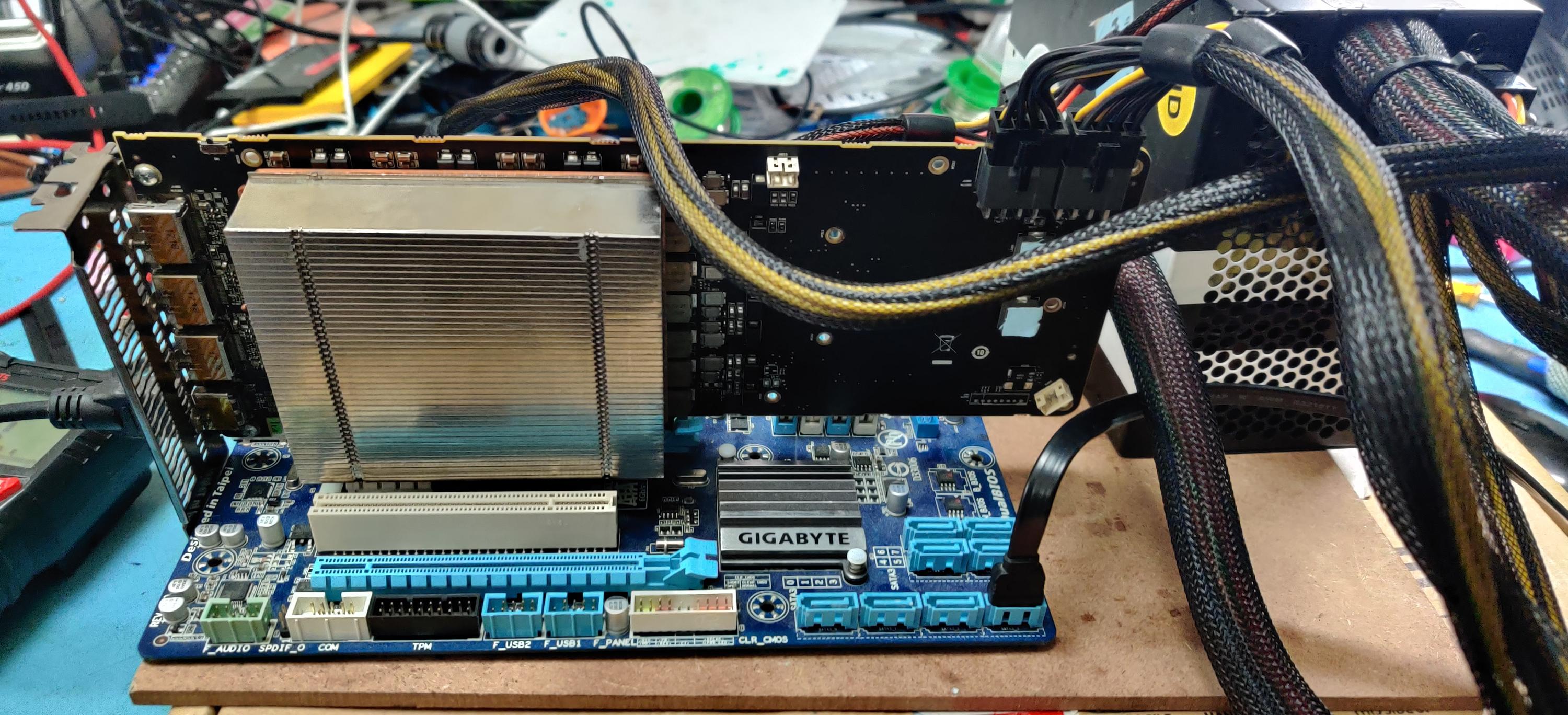

    The card shows display fine and runs as normal, but the fan isn't kicking in due to missing PX_EN signal.

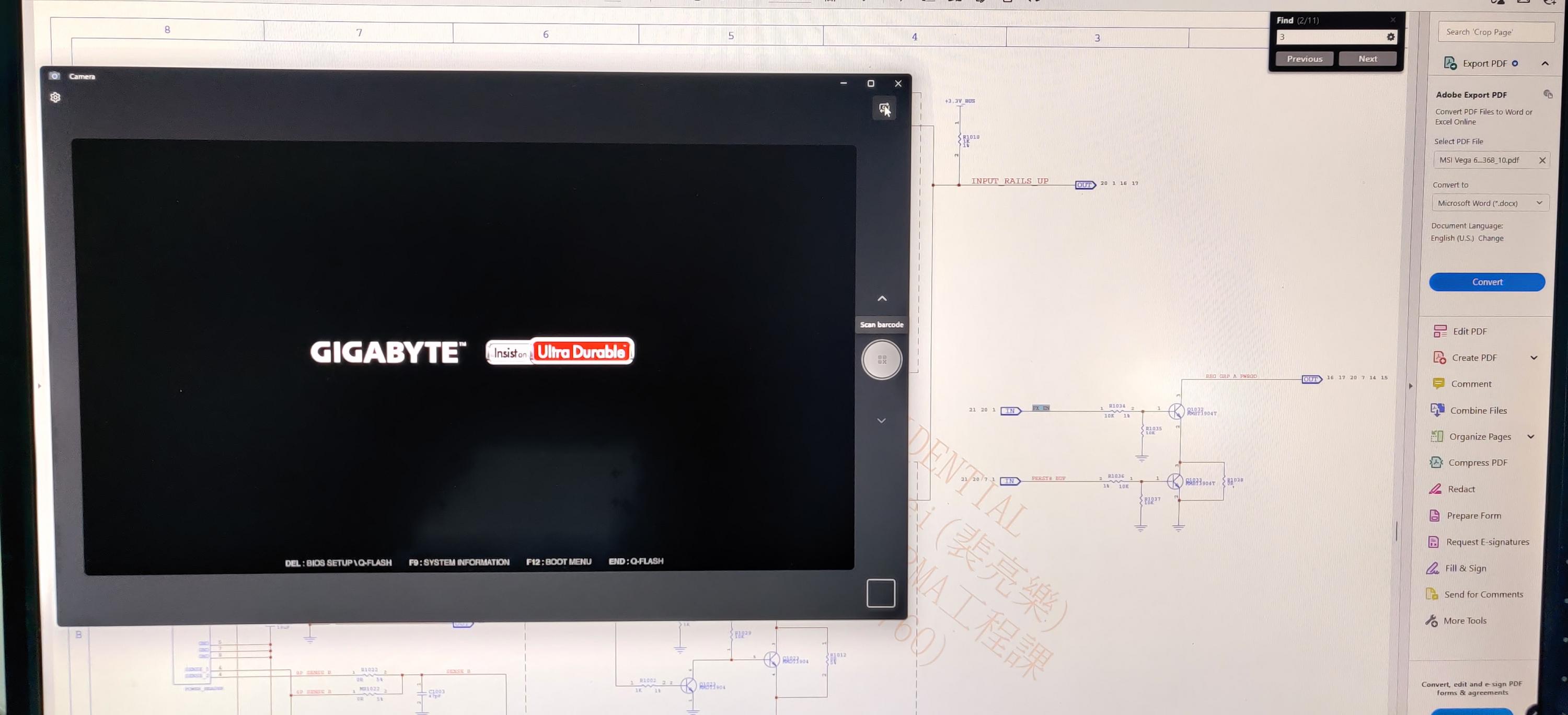

                      I've uploaded 2 pics. One of them showing display output. PX_EN still missing but I have 3v at Q1032 pin 3. Can't make sense of this one.

                          That seems like normal behaviour. PX_EN, when high, pulls REG_GRP_A_PWRGD low through Q1032.
                          REG_GRP_A_PWRGD itself is powered by 5V through a voltage divider and a 0 ohm resistor.
