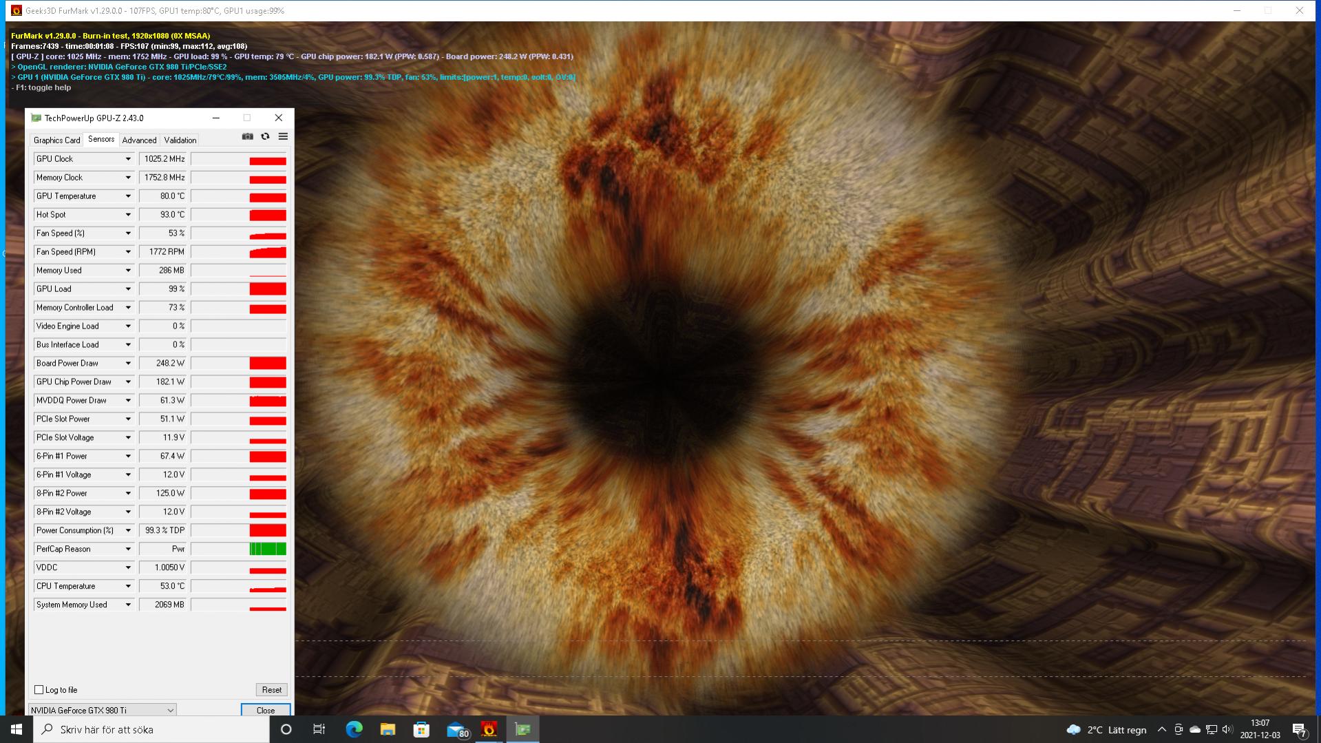

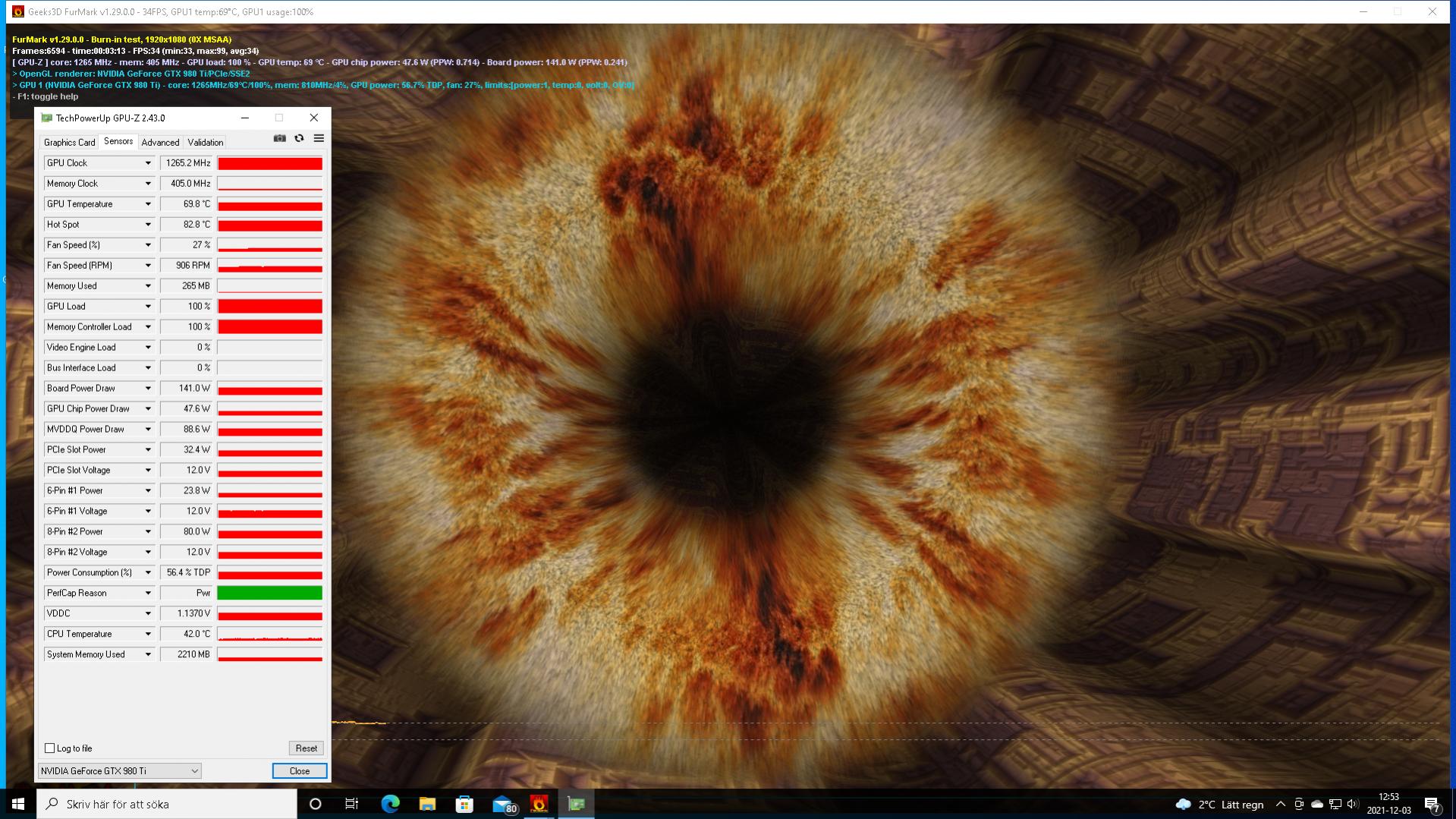

    Hello.
    I`m learning electronics and graphicscards so im new at this.
    I`m having issues with one of the evga 980 ti sc+ i repaired a bad mosfet on.
    The issue is its terrible performance and i noticed memclock to be stuck at
    405mhz. I tryed ddu, flash different bioses (even one from my working evga
    card), checked voltages and seems ok but im no pro. The other card work as it should with same drivers/bios/computer.
    I`m stuck atm and hoping someone have an idea of whats wrong.
    I attached furmark test of both cards
    /Ken

      Re: Low memclock evga 980 ti sc+
      As seen on attachment for The bad card, its not getting hot. Also fans, sinks and thermalpads are good / ken
          Thnx, but accually i saw that video. Its not the same issue unfortunally. His card cant detect memory type due to modification. My card detect memory normaly.
          Only thing i noticed is that my card starts at normal clocks and also pcie 3.0. After a couple of seconds it drops memclock and also pcie to 1.1

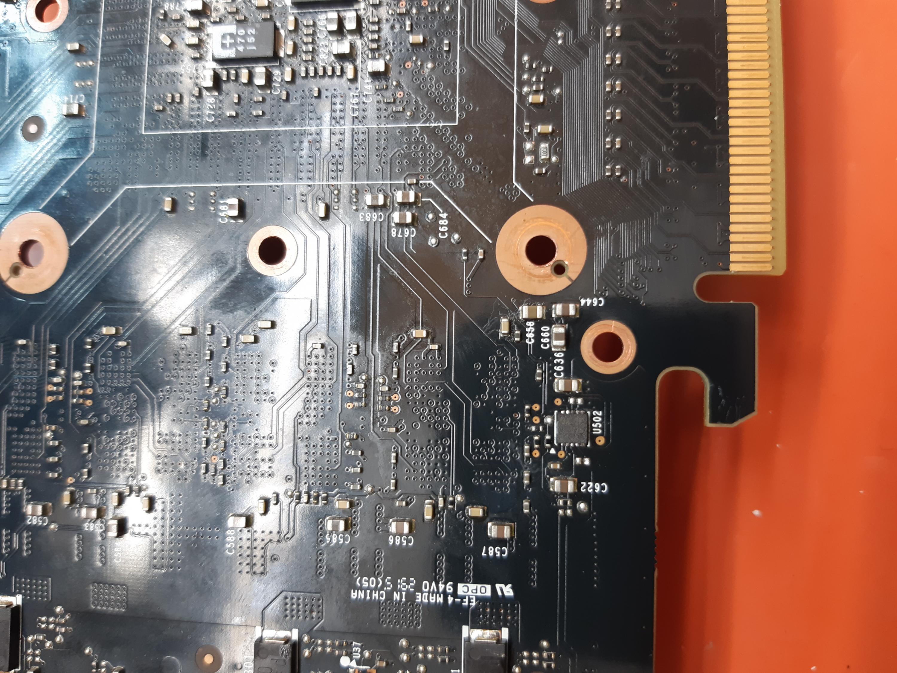

            Ok, for future reference.
            I think i found the problem.
            This pex voltage regulator? (Or display rail. Pls correct me) Was bad and shorting the nearby caps to gpu.
            It did output 1,0-1,1 volt (same as my working card)
            I have yet to assemble and try the card.
            Check attachment for u502.
            • Ken123
              • Oct 2021
              • 58
              • Sverige
              Well, i changed that chip and card only flinched at boot then was dead. I did some measurements and got to the conclusion that all needed voltages was present except pex. Changed it again and now voltage is present.
              Tryed the card and wasent detected. Felt wierd so i tryed mine and it also wasent detected. Did I kill both cards when measuring? Is that possible?
