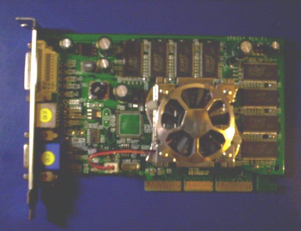

    Hallo
    I'm read this forum quite often and i learn more ebaut computer equipment. So i try to fix something. For begin I'm buy and successful fixed GF5200FX next GF2MX400 and ... I'm try FX5600 but it isn't so easy. for begin i'm re-caped this card... it help but ........ when I run 3Dmark2001se i seen a few vertical and/or horizontal line. and is's change. ftp echivment ist quite good. Next when i continue test card will crashed and i must restart my computer.
    For time i have raplaced cap it is posible to play for a game for example NF2U or Airfix dogfighter but view isn't clear. I can obserwe same kind visible of shape and image blurring(some times). I think it is case of Voltige Regulator - APM company .... but i'm not sure.....
    if you konow something useful i will be grateful for your answer for this post.

    Re: Gf5600fx
    post a pic of your card.
    sounds like you have a few more caps to replace.

      Re: Gf5600fx
      Unfortunetly i have replaced all capacitors. I used "hitano" i think it is quit good, because when i used it before i have good result. However graphic 2D and 3D graphics when i replaced capacitors is going better , but i have stil artefacts in 3D. I suspect APM2014 (N - mos enchanced power driver) but i haven't ony one to replaced.
      Recently I,m looking in Net for ony sheme(description) of voltage in GF card but i can't finde ony one. I wiill be very gratefuly when anybody help my find some one.

          So i try to add picture my card GF5600Fx, this is real picture but cappacitors is replaced.

            So finaly I add picture <happy>
