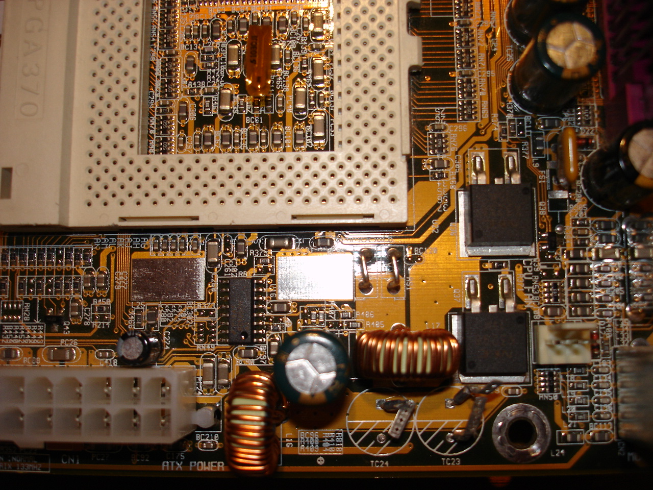

    Scored this GA-6VXC7-4X-P by the kerb, complete with Celeron 900, one 256mb SDRAM DIMM and a TNT2 M64 AGP card
    Worth saving seeing it's built around VIA's 694X chipset, their final edition for Coppermine
    Problem is, two capacitors are torn off, at TC23 and TC24, just behind the PS/2 connectors
    Can someone tell me what are their specs please

    Re: GA-6VXC7-4X-P torn off capacitors
    probably the same values as the other caps (same size) around it..
      Scenic is right. The values are probably the same as the others around it.
      Those capacitors seem to be part of the VRM. In nearly every board I have seen, identical capacitors are used throughout the VRM.
        I've seen a few motherboards where there's two sets of capacitors.
        Most of them are in the first set: those filtering Vcore
        But there's a couple in the second set: those filtering the VRM input. These are the first to go bad when a cheap PSU is used.
        I would guess a good way to be sure if the missing caps are filtering Vcore is to use a DMM to check if the missing caps are in parallel with the surviving Vcore caps
          Check with DMM and find out if they are high/low side VRM or something else.
              Torn-off caps are not in parallel with the existing ones, which are 1200uf 6.3v
              The board fired up after I put in a pair of 1500uf 6.3v
              Hope to hear from someone what the actual values need to be
                Check the voltages on those new capacitors - if they are connected to 12V you'll end up having more 'torn off' capacitors soon as the case and half of the internals heads towards the sky
                  Looked for photos of that section of board but couldn't find any.
                  My guess is those are VRM-high and probably in parallel with that one next to them.
                  And, that caps on other side of MOSFETs are VRM-low.
                  Can't tell without tracing the circuit.
                  I did find one photo that showed those missing caps but the values weren't positioned to read them.
                  They -looked- from the back side to be the same as the still present one next to them but that's not very reliable.
                    YES, that needs checked but I think he's okay.
                    Socket 370 GA boards I've seen all used +5v for CPU.
                            Thanks for looking
                            Everything works with the substitute 1500s, but those caps are slightly warm to the touch, whereas cannot feel any warmth in the ones nearby
                            Would like to have manufacturer's original values as replacements at TC23 and TC24, for peace of mind
                                pfrcom, I can confirm that the original values for capacitors TC23 and TC24 are 1200 uF, 6.3 V, not that you're likely to be concerned anymore. I have this board in front of me right now. The capacitors in these positions are Choyos. The rest of the caps on the board are bad quality too: G-Luxons and GSCs.
                                  I traced out the circuit on the GA-6IEML when I recapped the first one.
                                  It has two 1200uF 6.3v in parallel with two 330uF 25v on high side [PSU side] of VRM.
                                  I've been replacing all 4 with 1000uF 6.3v MBZ and they are happy campers.
                                    Thank you very much TJ2 - it is reassuring to know what I put in would be within tolerance of the originals
