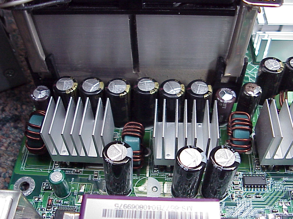

    hp board with blown panasonic fj
    this thing looked like a clogged up cloths dryer when it came in.
    panasonic fj.
    ncc kzg and kzj.
    odd mix of all these on vcore.
    i used mbz on the 10mm parts and 820@2.5 polys on the 8mm.

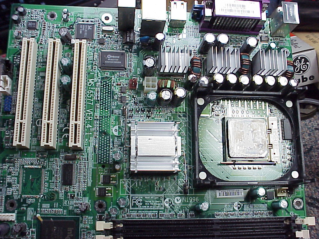

    ooh MSI

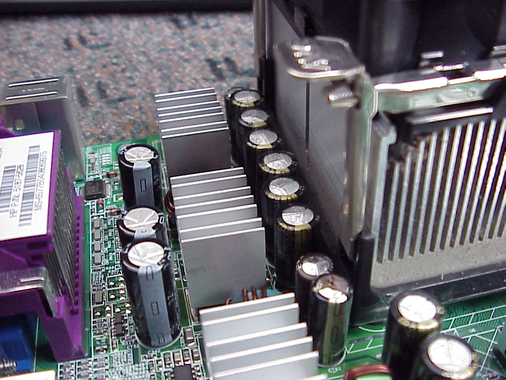

      Re: hp board with blown panasonic fj
      Originally posted by willawake
      ooh MSI
      Yeah, MSI MS-6577 aka Xenon: there are some specs on HP site.
      So another case of caps "glued" to the heatsink: did the manifacturer believe P4s were as hot as old P3s?

          Yep, nice, cool place for those caps to sit. I don't see any reason why they might've failed ???

                      Well with them that close to the heatsink you mine as well heatgun them and kill them quickly so you can cut out the middleman .
                      I've seen Rubycon's, Nichicons, and UCCs. Killed by bad placement that and using 85Cs where 105Cs were needed of course. Some bulged and others needed to be sniffed out with my trusty ESR meter.
