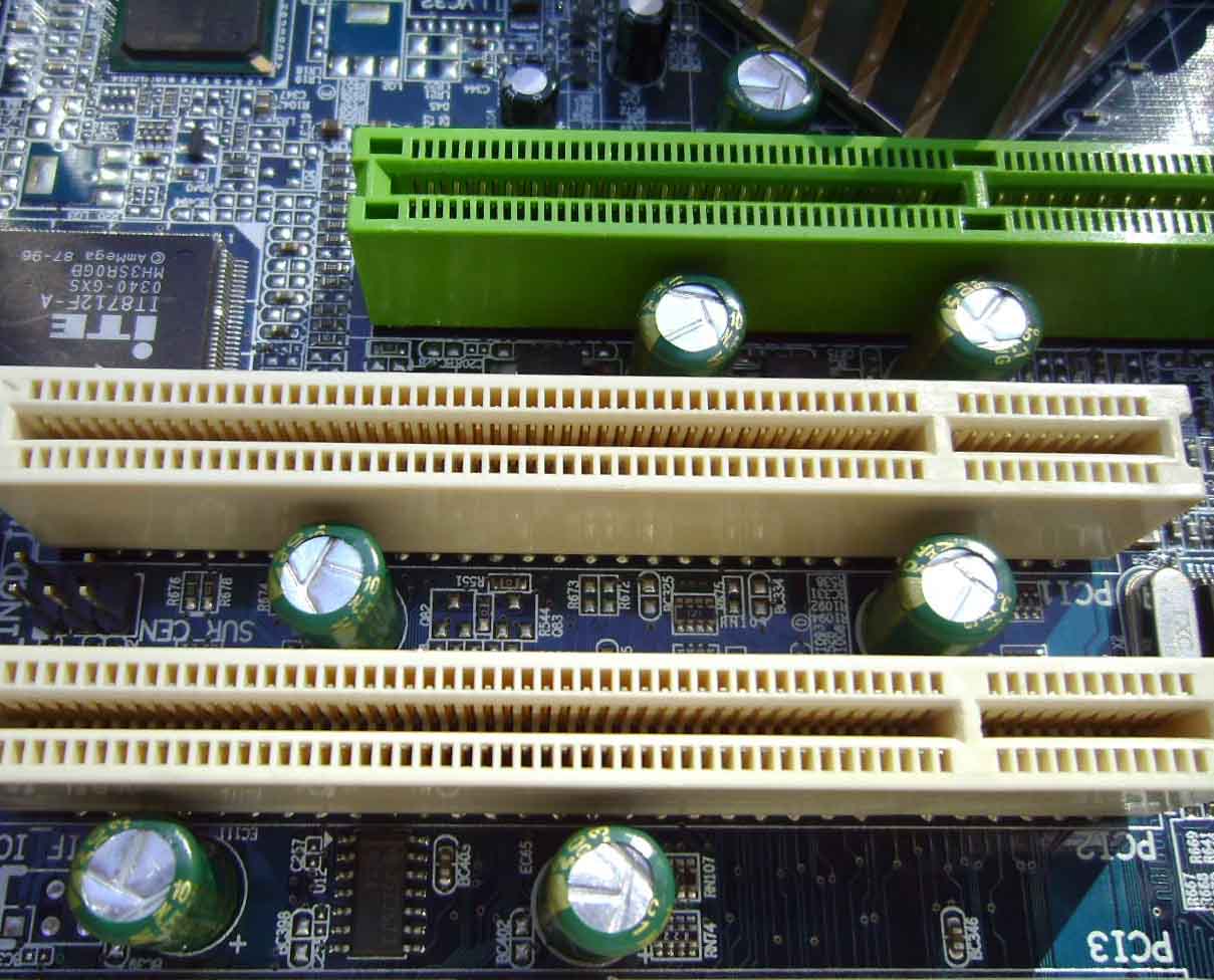

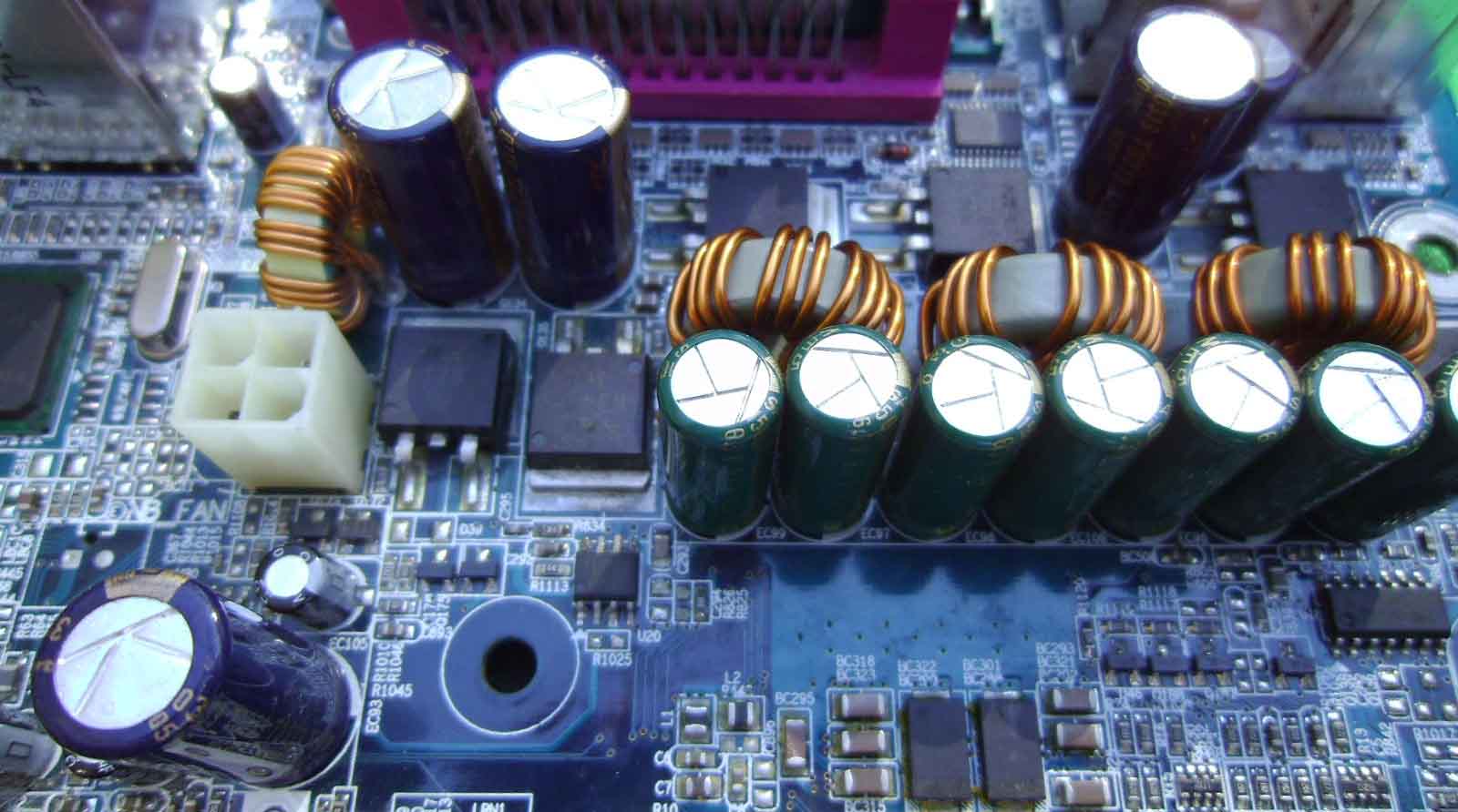

    Acquired this recently, and found hard to believe ...

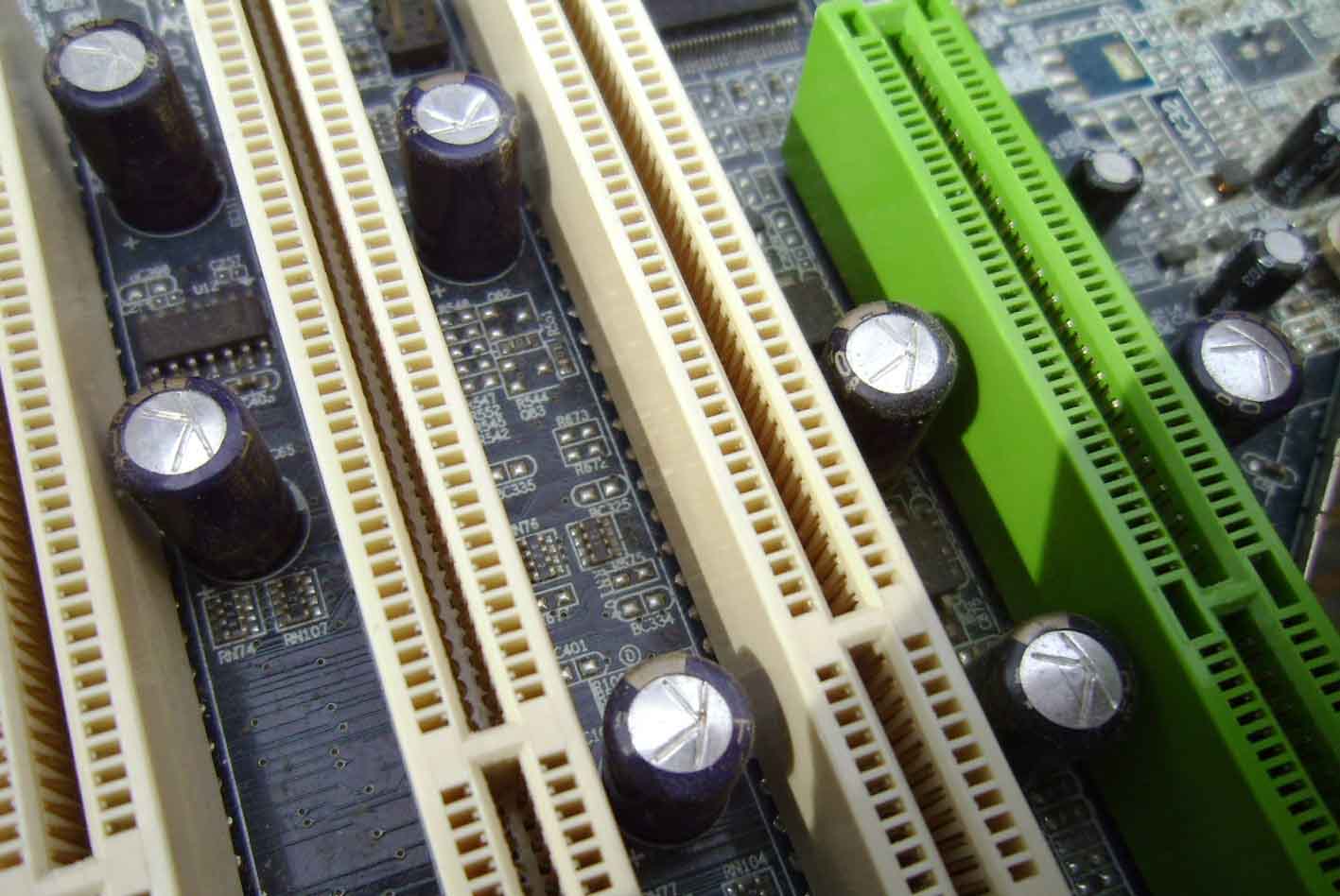

    ... five bloated Rubycon MBZ around PCI and AGP slots

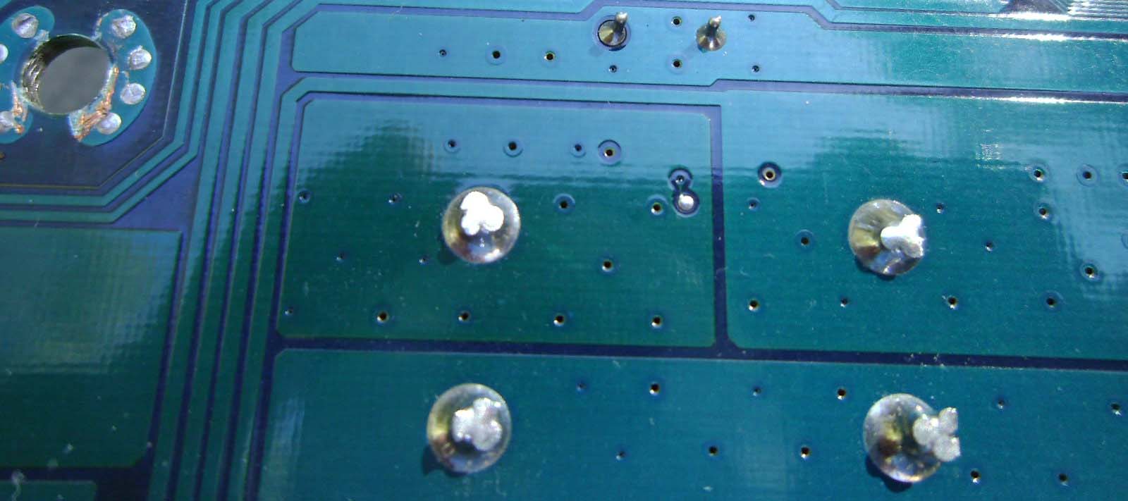

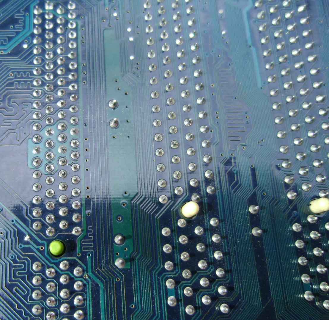

    Perhaps not too surprising when one sees heat discolouration underneath the FETs between AGP & PCI1
    Matched by discolouration beneath VRM
    Latter weird, considering VRM has Rubycon input and Sanyo output

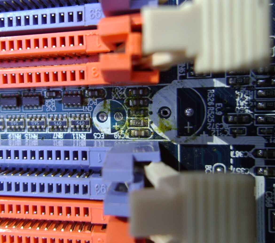

    Was advised board had been liquid cooled, and stopped working reliably if multiple DIMMs were used, after a leak

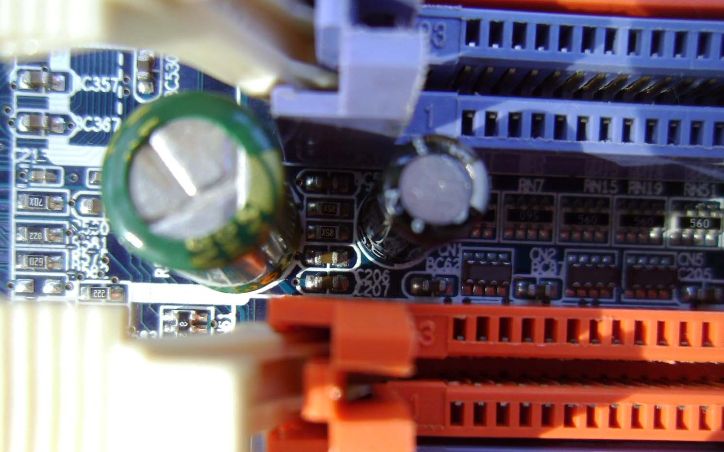

    So I also removed caps between memory slots, to find
    Bloated MBZ replaced by Sanyo WG - also replaced two non-bloated MBZ
    DIMM area, after clean-up

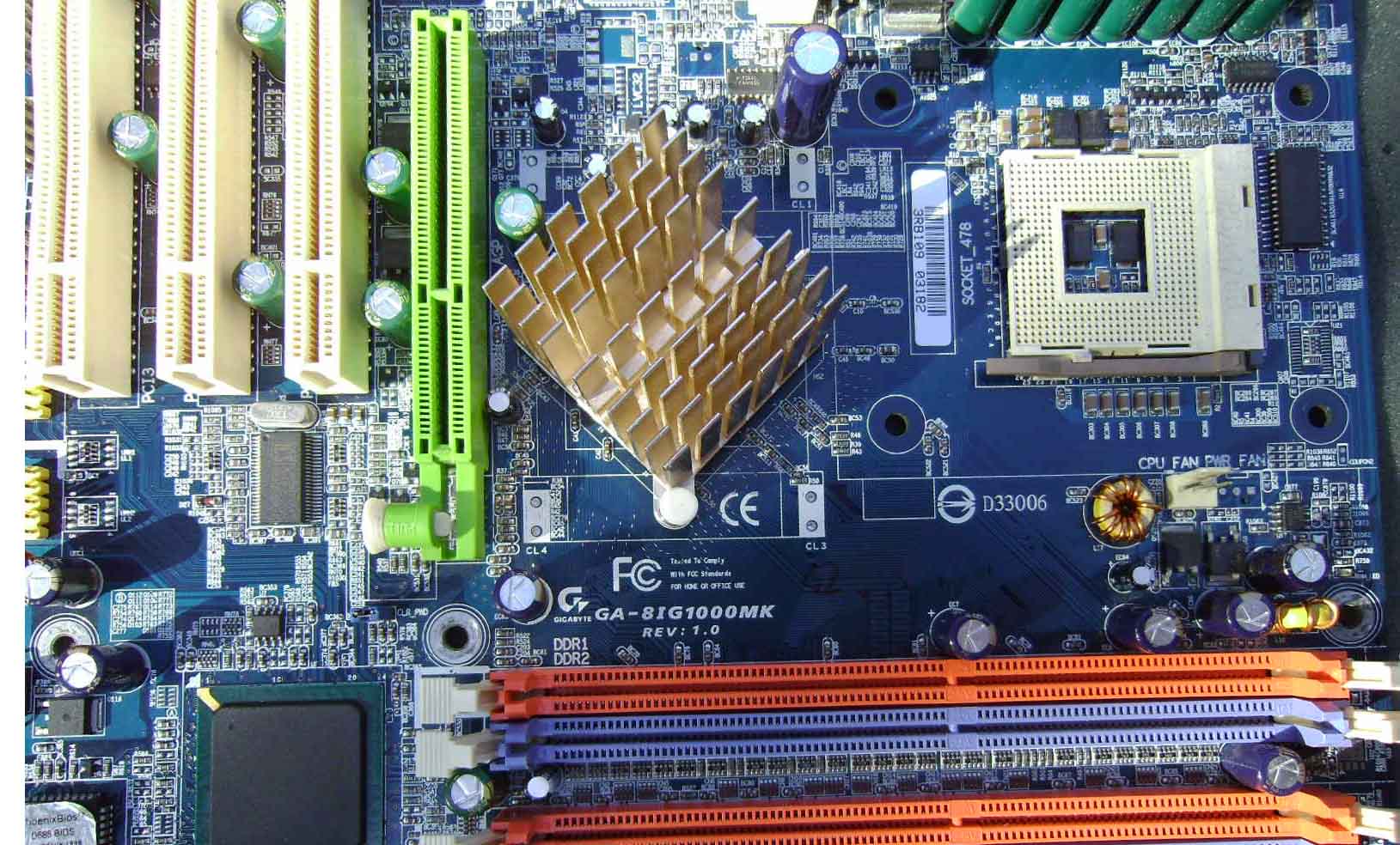

    Board overall, after cleaning off coolant stains with wet microfibre cloth
    Could be worse though
    Unfortunately multiple DIMMs are still not reliable - board's BIOS swaps between OK & Fail for 2.5V health status
    However two DIMMs were OK for four passes of Memtest86+
    And did a clean XP install without an issue
    Then Prime95 didn't even get through a single pass
    And stress test of Aida64 also didn't go too far
    Aida64's sensor display showed some weird numbers for 2.5V - swapping from ~0.8V to ~1.7V
    However Aida64 also showed 5V as 4.1 - but DMM measured 5.03 on spare Molex connector
    PSU is a recapped Antec SL300S
    Caps between AGP & PCI1 heat up to temperature most unpleasant to put finger on
    Where to go from here ?

    The attachments don't work. The link in red shows bad 2004-2005? Nichicon HM and KZG. No surprise there. The software sensors are never reliable, best not to place any trust in them (but the low +5V reading could be a pin or two on the ATX 20-pin connector, if it really is low). Is there any discoloration underneath the DIMM area? Any chance of trace corrosion (as the resulting effects of the leak from the liquid coolant) or oxidization that may be causing only one DIMM to work, even after cleaning the board? The two linear regulators by the AGP slot, I would imagine, do run precariously hot. No surprise there either.

            I should have known better ...
            ... the penny finally dropped that I was using a 3.0 Northwood with a missing pin
            So I swapped in a 3.0 Northwood with all pins intact, and you've guessed it ...
            ... self-tests 1024K and 8K of Prime95 passed, and continuing
