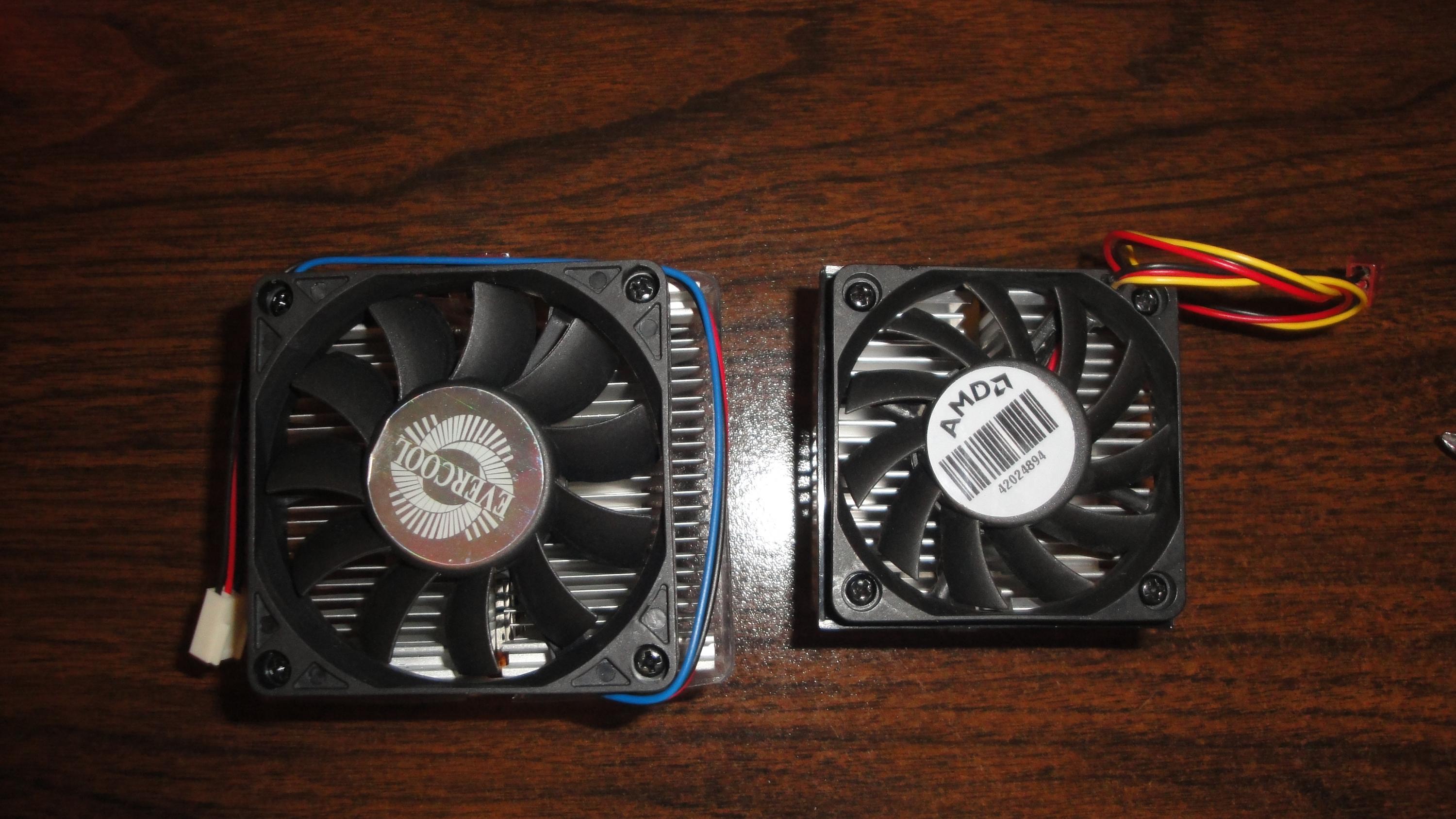

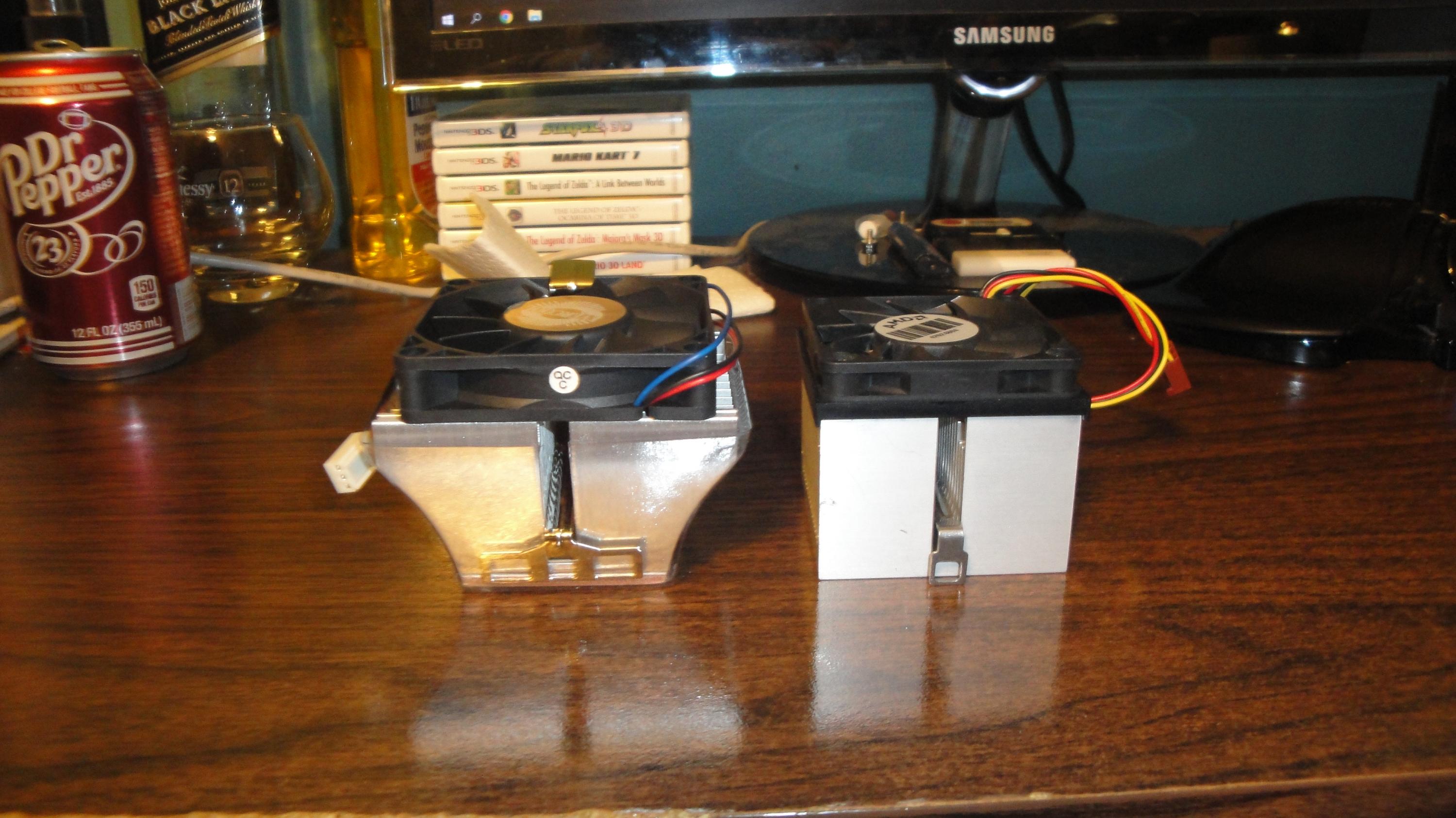

      Got the MB back today - looks cherry. I got everything put back in place except the CPU cooler - I'm getting a new one with a Copper base and possibly bigger fan to go on the newer Barton core. This new cooler has three hole attachments on each side of the CPU socket, not the single hole kind on the old CPU. I'm sure either will work, but peace of mind.
      I also got my two new 16MB EDO RAM sticks in today, so now my Windows 95 retro system has a full 64MB (4x16MB) of memory instead of 40MB (2x4MB + 2x16MB). Now I have to figure out how to sell these other 4MB SIMMs. Maybe Vogons people will have someone who wants them for a retro 286/386/486 DOS build. I remember 8MB going a LONG way back in 486/33 MHz days.

        Bigger cooler, copper base, bigger fan, what's not to like?

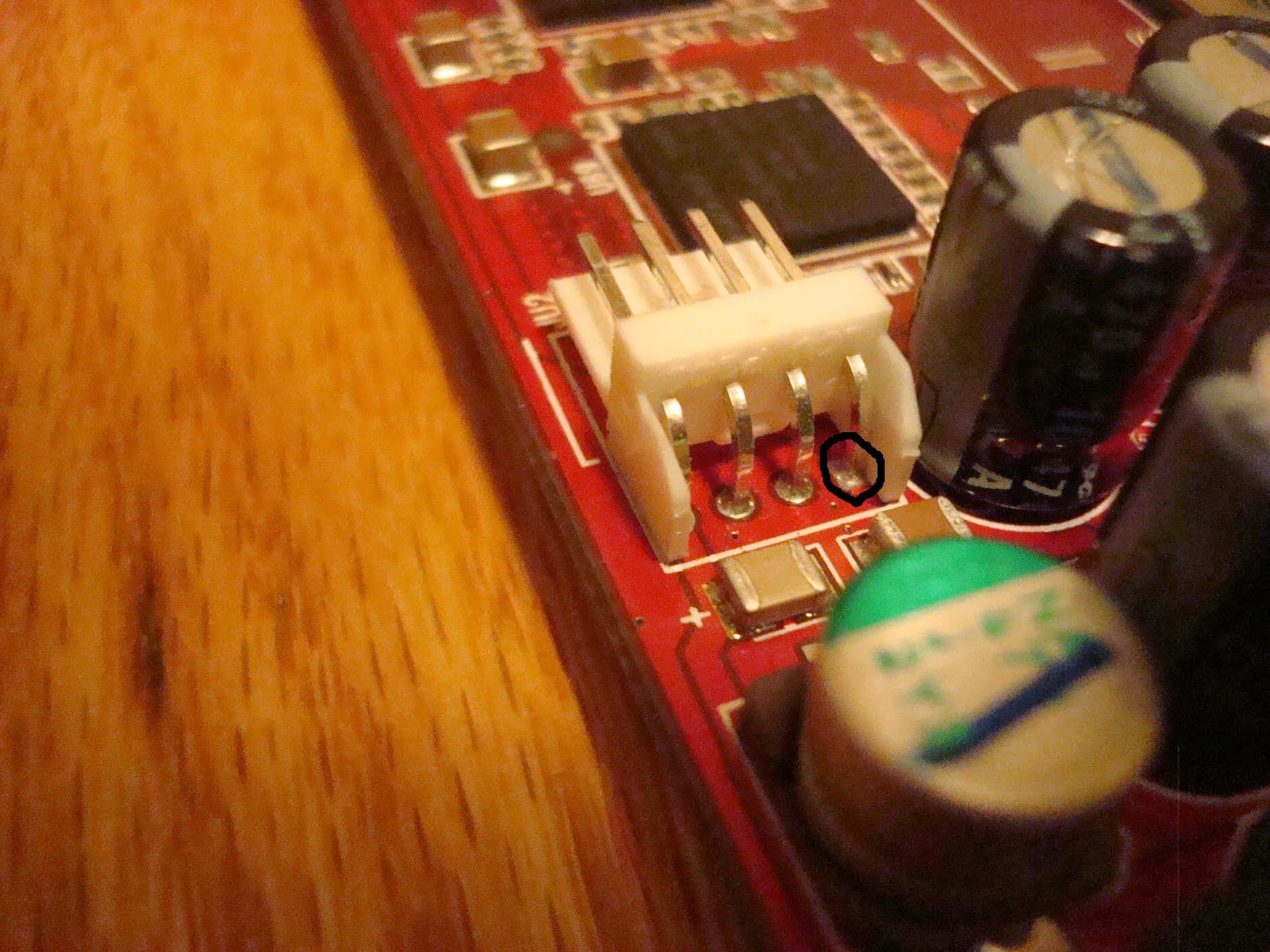

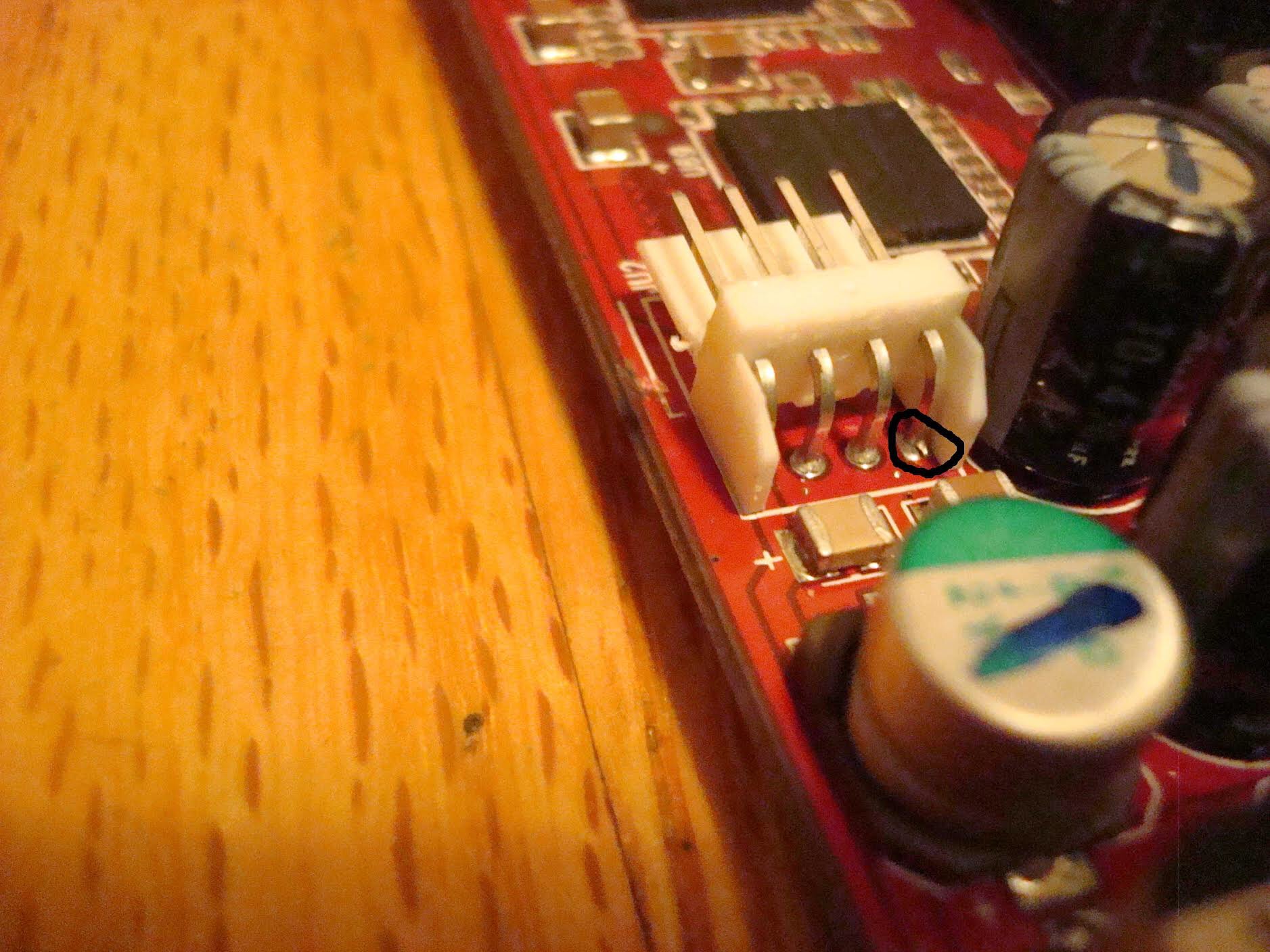

                              Well, I know this thread of discussion is a bit long in the tooth, and perhaps the OP stopped caring about the X700, discarded it, and moved on completely by now. But it's somewhat difficult to help troubleshoot the card without knowing what it looks like, IE the stock capacitor choice, etc... it would help to inspect and peruse the underside and overside for bad solder joints too. Did you try cleaning the contacts with isopropyl alcohol by any chance? Does the card have an auxiliary berg (floppy connector) that mandates a floppy connector for additional power drawn from the +12V and +5V rail (or possibly an auxiliary molex connector for the same purpose)? And if it does, do the joints look cracked at all at the top or bottom, like in the images below?
                              Ideally, it (the connector) would look like the following image:
                              It should NOT have lifted and cracked joints, like this:
                              I could be way off and the issue could be much closer to what Chaos suggested, a chipset incompatibility issue, it could even be a bad BGA chipset or RAM... there could even be a faulty MOSFET on the card and only a multimeter would really tell you that. I also want to elucidate what I said about flux before... I meant paste or liquid flux and not plumber's flux (regarding how flux helps heat transfer from the tip of your soldering iron to the joints soldered to the PCB itself). That stuff is corrosive and will eat traces. I hope the card didn't suffer any ESD damage as well.
