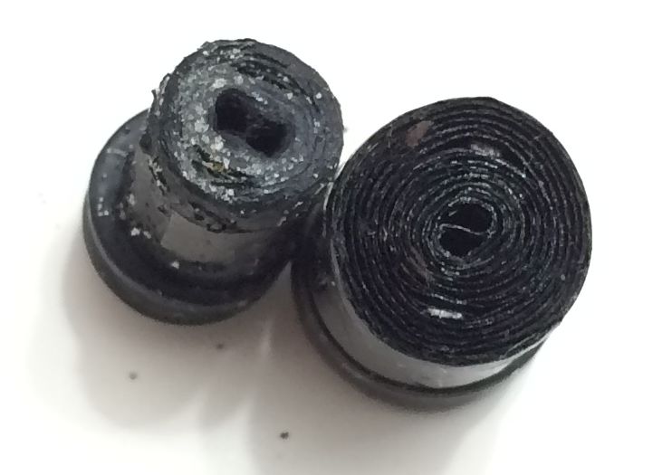

          Let's face it, it's been more than 15 years since Rubycon released the first low-ESR caps on the market with an agressive aqueous electolyte that proved itself reliable. They invested money in the exploration of chemicals that would stabilize the electrolyte. The Taiwanese and Chinese manufacturers are either too lazy or too stupid to figure out how to do this themselves.
          Heck, they can't even produce quality butyric acid capacitors (Nichicon PW, Panasonic FC equivalent).
          What has happened is that most of the electronics have moved to polymer capacitors. But guess what? The polymer insulation material is expensive, and you can't use them economically where bulk capacitance is needed.
          And if you think that all polymer capacitors are created equally, then you're wrong:
          On the right is a Sanyo SEPC. On the left is a fake Chinese Samxon ULR. The polymer on the left has degraded to a point where the layers have fused together. Bits of polymer on the outer layer are flaking off on the outside.
          Teapo is junk, period.

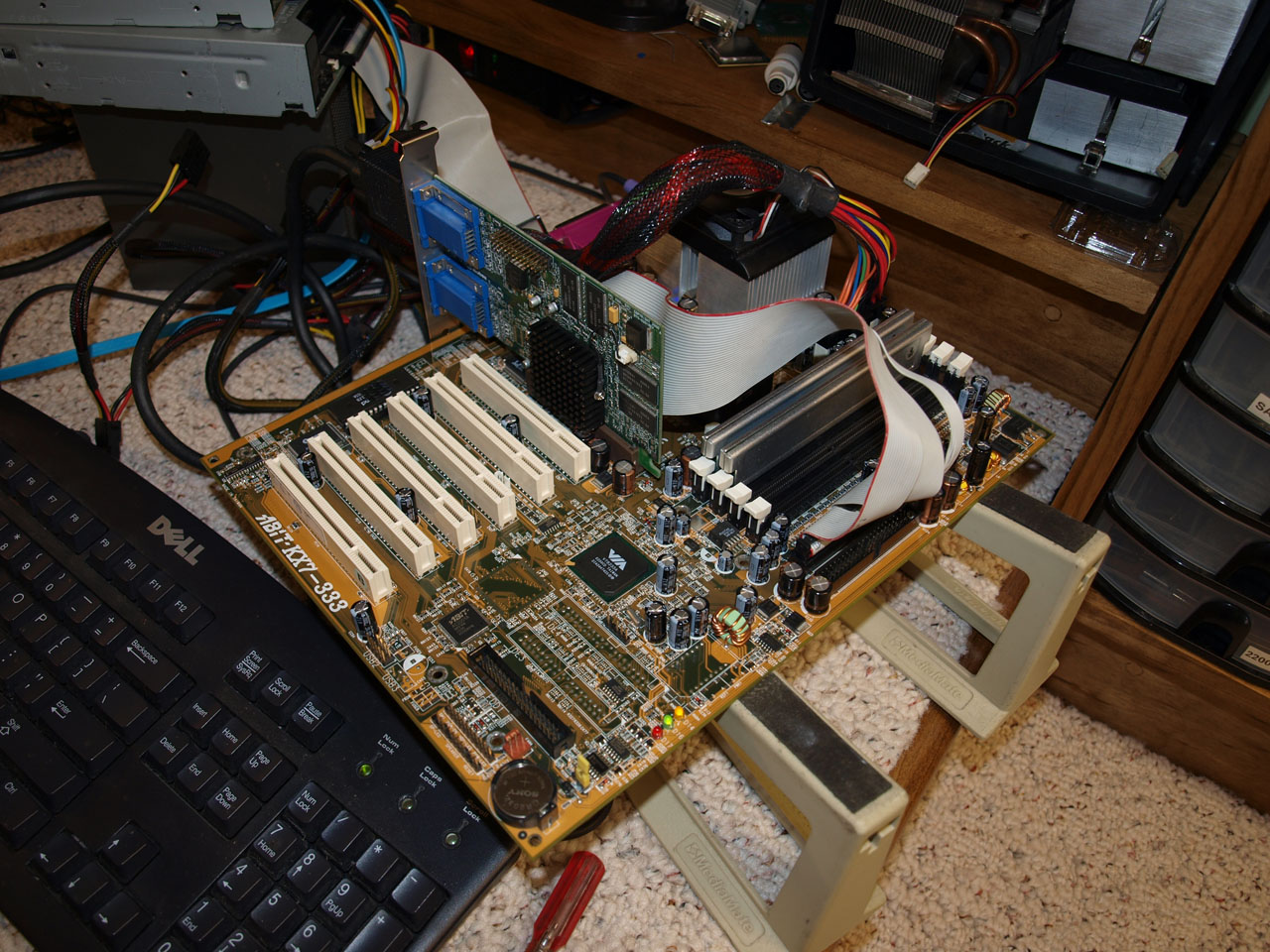

                  So...yeah. He got the MB today and told me something to the effect of: Yeah...your sh**'s f***ed up, mate. And I'm like: What up, bro? Sh** worked when I sent it to you! Fix that sh** and send me the bill!
                  Ok, so maybe he didn't use any bad words...but yeah. LOL

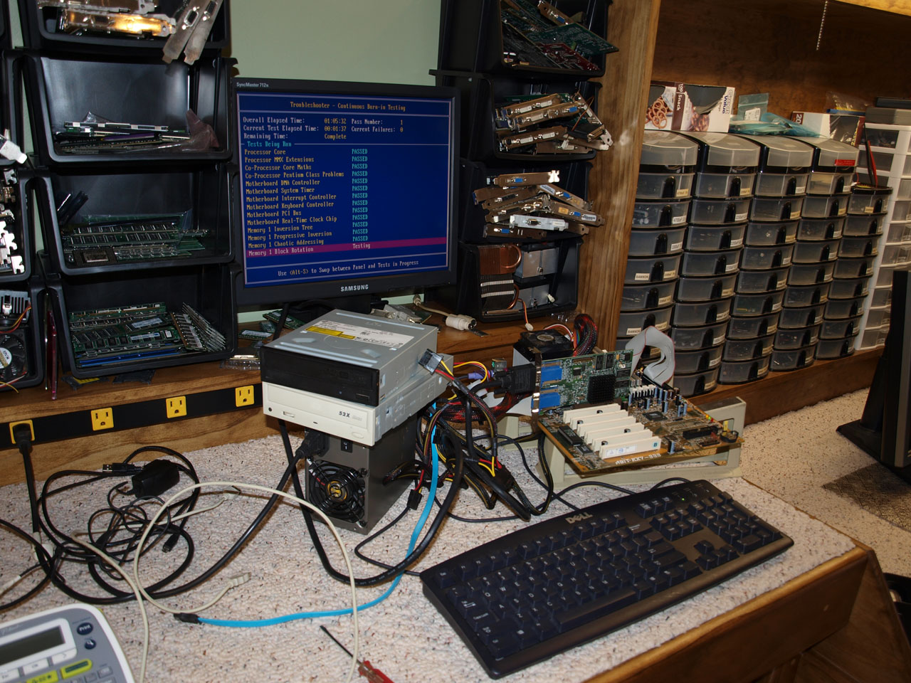

                        Re: Abit KX7-333
                        Yay for making a board support processors it was never intended to run, it was intended for t-breds & palominos... With manual settings, it posts at the correct speed, but the BIOS doesn't see the CPU as the XP 3000+ (Barton core) it should see it as....but 166FSB
                        Too bad its not the RAID version, it'd have the last release RAID firmware embedded now....I'm too good at this kind of stuff...
                        Workmanship second to none!
                        Stable and passed all testing.
                        I impress myself sometimes!!

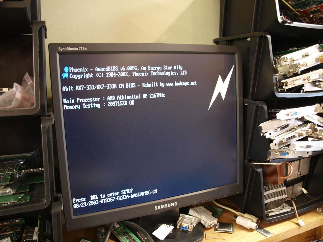

                          Re: Abit KX7-333
                          errr what?! how'd u get the bios to display your own custom strings "rebuilt by www.badcaps.net"? gotta teach me how to do that kind of bios hacking lol!
                            #33
                            Re: Abit KX7-333
                            Did you....reflash my BIOS? LOL After all the time I took trying to re-flash it myself months ago! >.<
                            Guess a guy's gotta try to badge his work somehow. But I'm the guy that takes off car dealership badges if I buy a car.
                            When it had the Palomino in it, it said
                            Main Processor: AMD Athlon XP (tm) 1800+ 1531 MHz
                            But I've booted that Barton core into Windows XP and it says it's an Athlon XP 3000+ in the System Properties window, so I couldn't give two shits if the BIOS doesn't see an exact model number. Windows XP is what matters. LOL
                            I think the only thing the MB won't support on Barton cores is reading from the internal thermal diode of the CPU, but there's a thermal diode right underneath the CPU chip on the MB itself anyway.....so meh.
                            And another thing - all of the CPU settings in the BIOS all work at either 100MHz FSB or 133MHz FSB. Yet the chipset and the board was advertised as a 166 MHz FSB (333MHz total). But NOT ONE setting in the BIOS actually went past 133 unless you went MANUAL (as we did here) and pushed it to 166. The RAM is rated up to a 200MHs FSB, so it'll be stable.
                            I'm curious, what all changes did you make to the BIOS?

                              Re: Abit KX7-333
                              Changes to the BIOS include last revision firmware for the RAID model. The CPU microcode is still stock for the CN revision, and of course my spam. There were some 3rd party revisions to the CN that added microcode for the Barton core.....but there were known stability issues....so no...not using it. I actually built a lot of gaming systems using this board way back when.
                              These boards are tricky to flash, which is why you probably had issues....you don't know the secret..
                                      I am not surprised. The shady Chinese manufacturers can take any decent design and make it worse. Being a polymer does not automatically mean it will be perfect.
