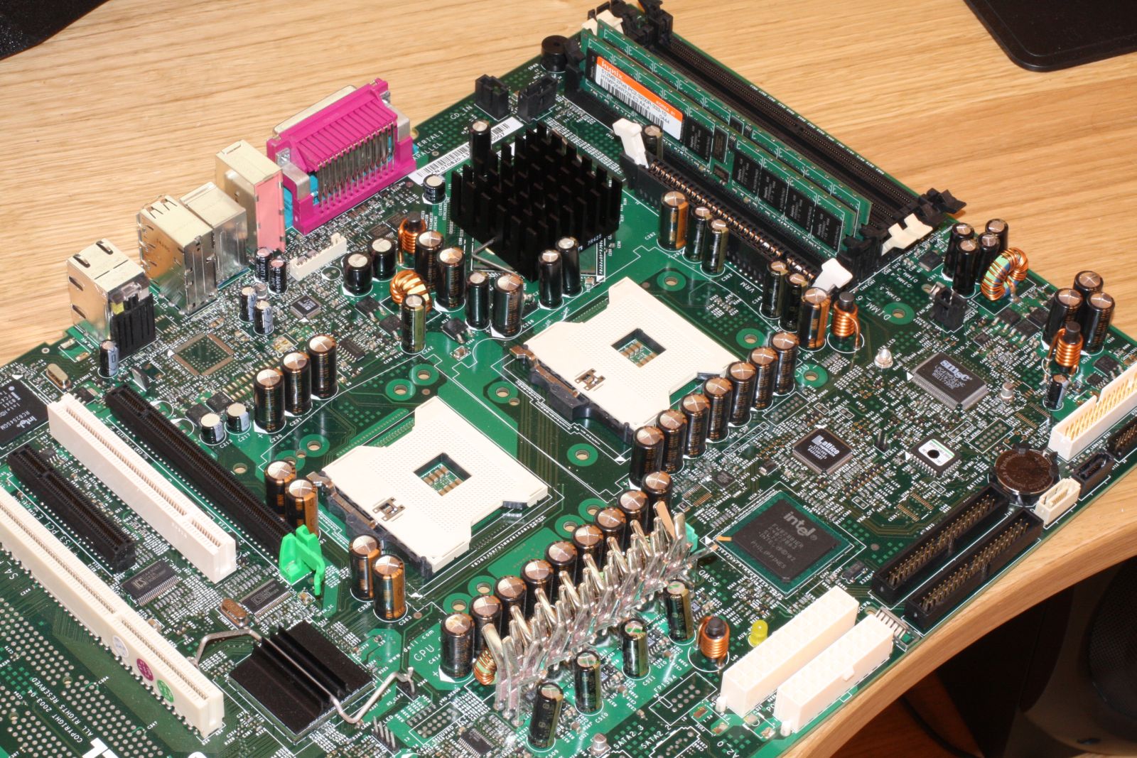

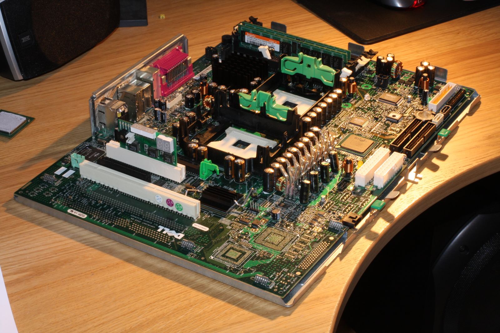

    Hi, found this in the electric trash pallet at work
    A Dell workstation, dual Xeon capable (Has a Nocona 2.8Ghz CPU installed) The system can accept the newer Dual Core Xeons I am told just by upgrading BIOS to atleast A06...
    It does not POST, the front diagnostic LED's switch on only LED no 2 in amber, which is PSU fault according to Dell...
    Pretty good diagnostic if you take into account what has happened to it's capacitors...
    It has 31x bad Nichicon 2200uF 6.3v HN(M) capacitors Manufactured week 22 year 2004 rated 105°C
    The rest of the caps are Rubycon and Matushita and they are fine...
    I am going to replace the Nichicon caps with Samxon I think, but I heard that Dell changed the caps on this very mobo to solid polymers, does anyone know if they made any other design changes to accommodate for this?
    If not I think I should go with solid caps instead, what's your take on it?
    In any way I'll need to order the caps because I'm out of 2200uF 6.3v caps...
    The PSU looks very nice, good caps and very overdesigned (it's rated 550W) Model is D550P-00 P/N DPS-550DB A DELL P/N D1257

    Re: Dell Precision 470 Workstation
    great score!
    if it were my box it would use 820@2.5 solid polys which i have a ton of.
    bet its fine once recapped.
      If possible, solid caps will be good choice, but cost will more expensive, because there is too many bad Nichicon HM 2200uF 6.3V D10mm.
      If you want to costly, then replace with Samxon GC 2200uF 6.3v/10v is also OK.

        Ok, thanks Big Pope, I think I will go with the "cheap" alternative of GC caps... (Since I can't be sure it will work after a recap seeing as it doesn't POST)
        Also considering I don't know what else Dell redesigned in the layout... Maybe other coils and mosfets where used for the solid caps aswell?

          • dood
            Deputy dood
            • Mar 2004
            • 2462
            man... I've never seen so many blown caps on one board. I wonder how long it was working with partial blown caps before it finally died...
            Ludicrous gibs!

              dood; yea, especially seeing how it's an dual CPU board but to my knowledge only one CPU was installed!

                What diameter are those bad Nichicon 2200?

                  Diameter should be 10mm in the photo.

                      But anyway, awaiting caps from Big Pope, and yes, diameter is 10mm and height is 20mm

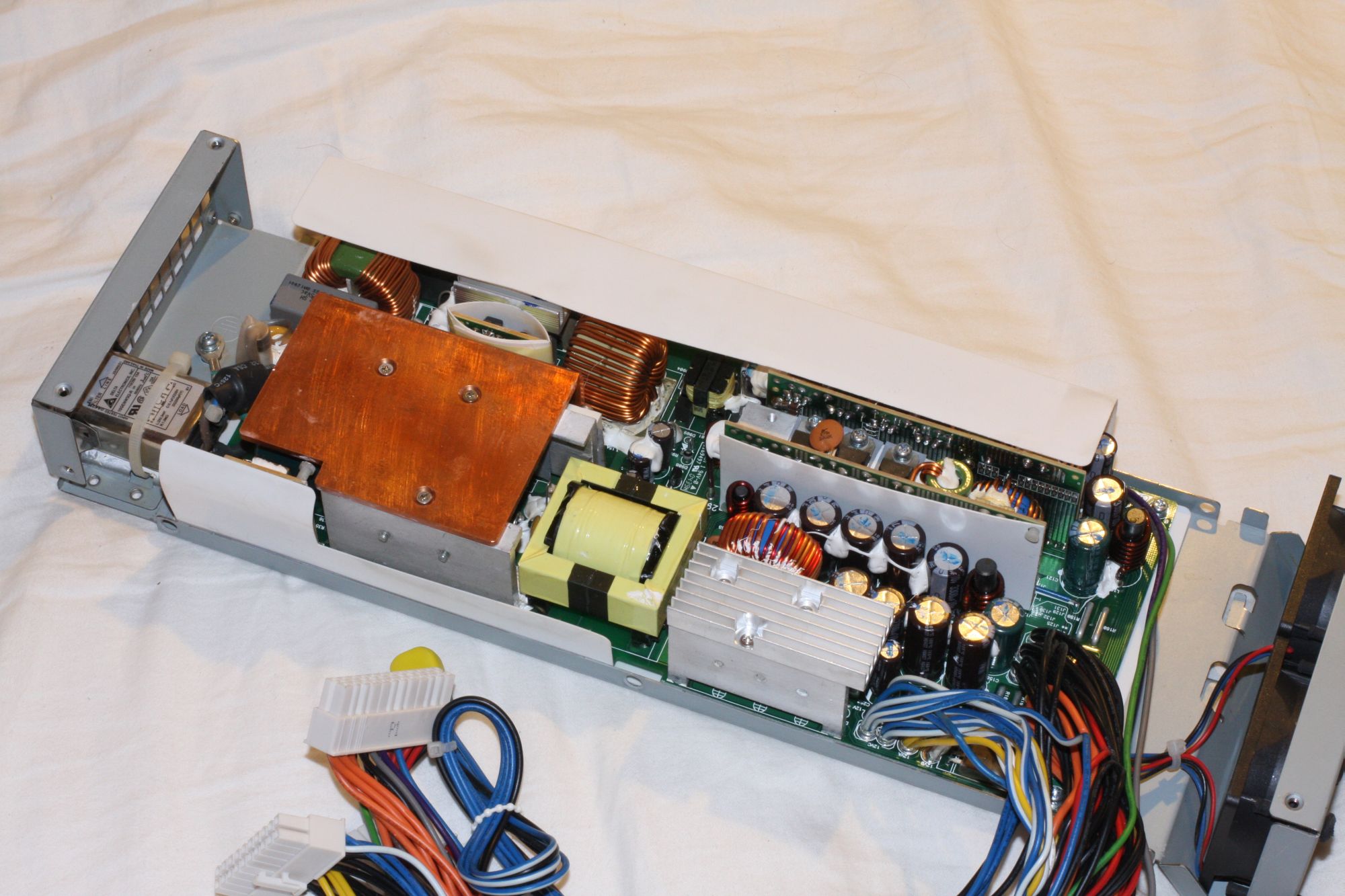

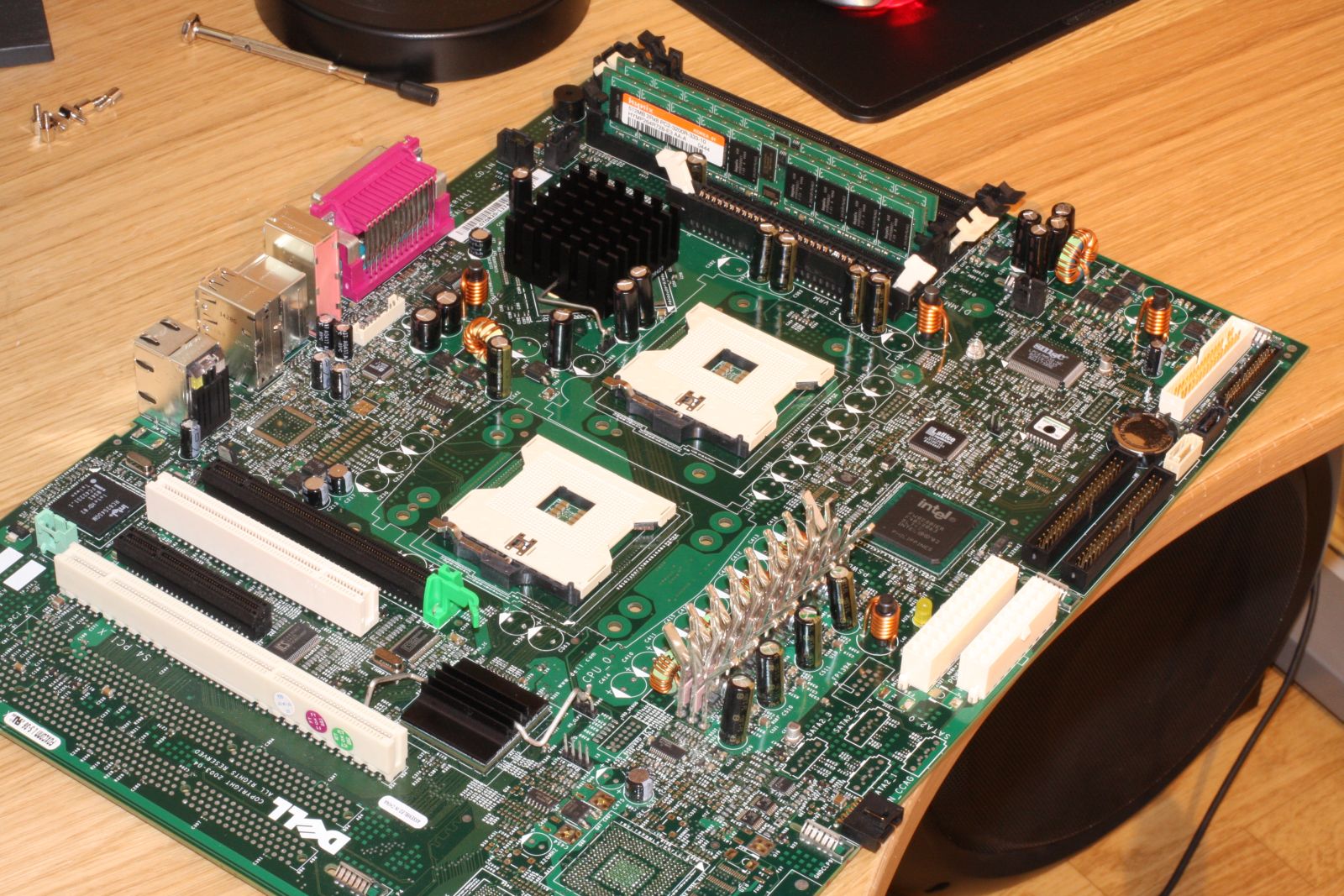

                          Got the mobo recapped now, took a long while
                          Some massive ground planes leading away all the heat from the soldering iron!

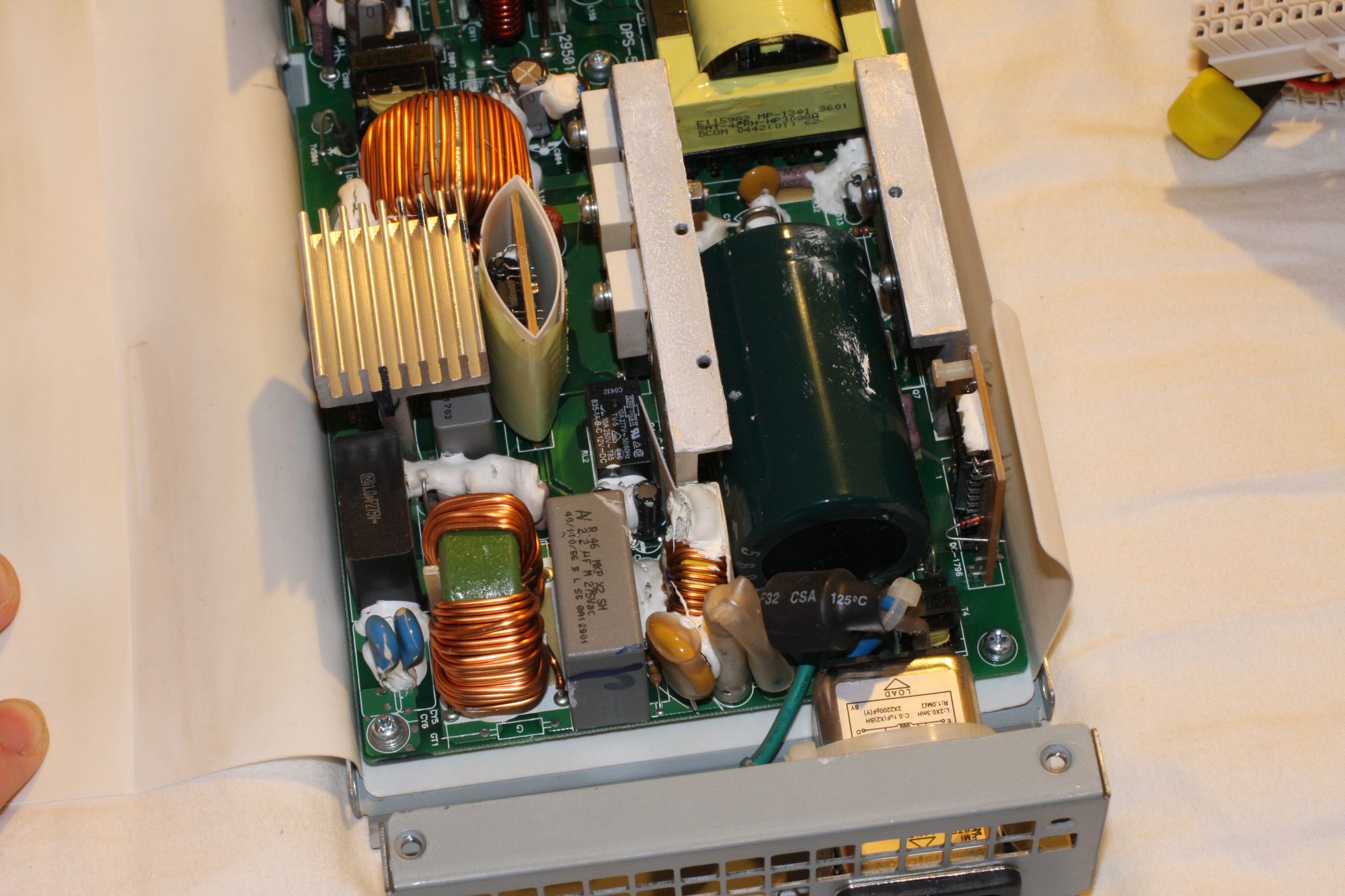

                          However I still had the same issue when trying to power on; A click from a relay is heard from within the PSU
                          5VSB is present all the time, but the other rails don't become active it seems
                          The fault is not in the mainboard; I tried running the PSU bare bones only shorting the green wire to ground but it just does the same thing...
                          (I had an old harddrive and fan connected for load but they didn't even budge...)
                          I think it's strange because the PSU looks pristine inside, it's one of the most well built PSU's I've ever seen
                          Can someone give some pointers to where I should look for possible faults, and where I should take more pictures?
                          The PSU is not a standard ATX spec, it's some weirdo Dell thing with one 24 pin contact, one 20 pin and a third going to a breakout giving the HDD/FDD etc cables...

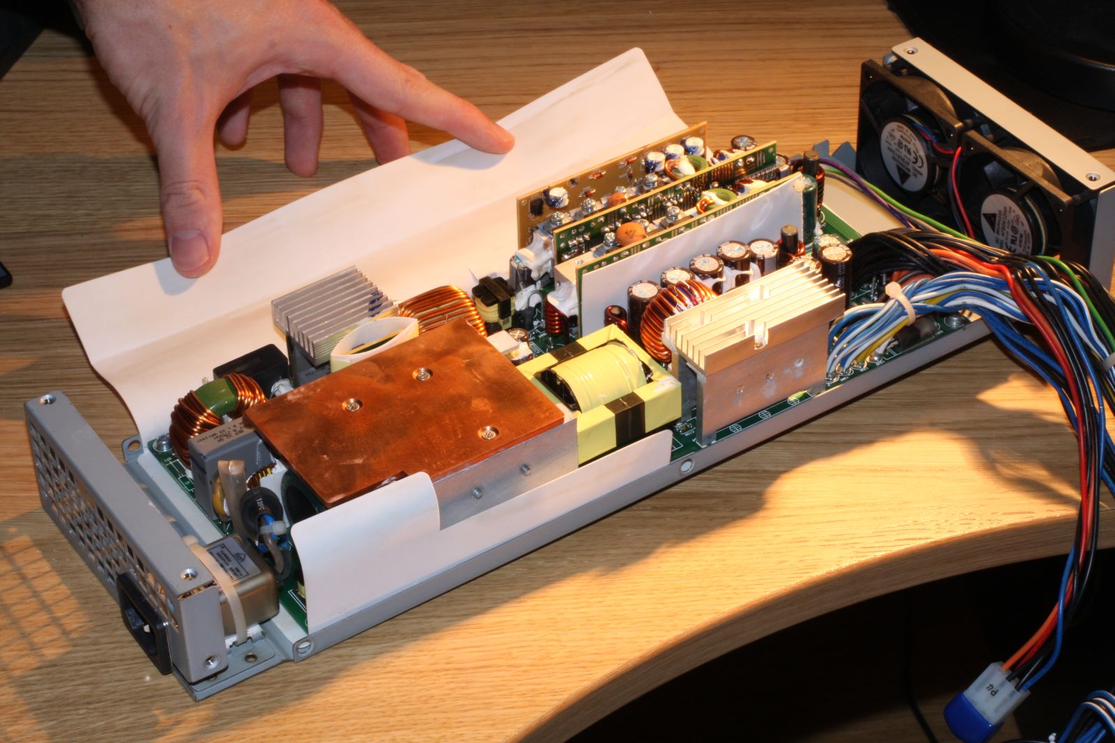

                            More Pictures...

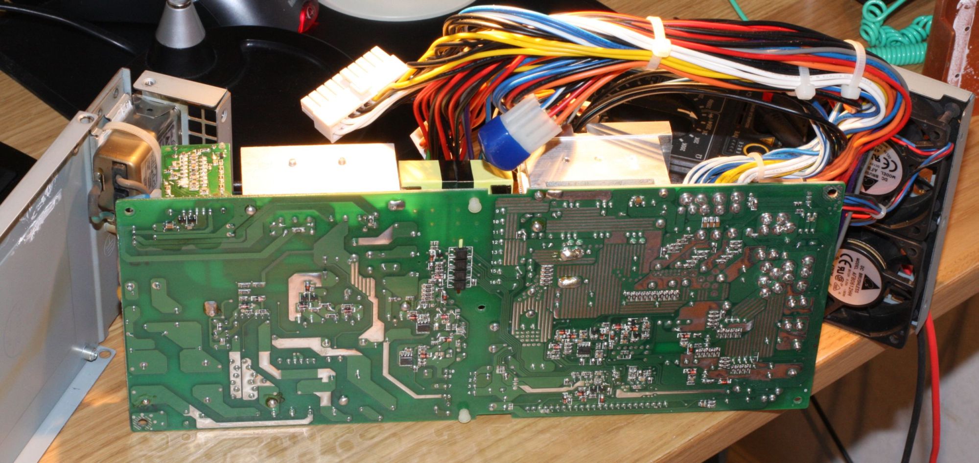

                              Lastly one of the H/V area with the copper heatsink removed (sorry for the multiple posts, 10 min rule...)

                                Bought a new PSU on eBay (Plus the DMS-59 dongle for the Quadro 280 GFX card)
                                System is working fine now
                                Had some issues booting; turned out RAM was installed in incorrect slots when I got it from my company...

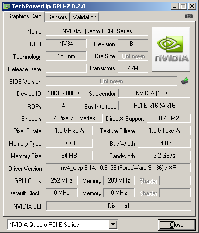

                                        The graphics card in it isn't worth the PCB it's printed on, nVidia Quadro NVS 280, based on NV34. It's the slowest POS I've had my hands on for atleast the last 10 years (well, maybe not but you get the picture)
                                        3.5fps in Rthdribl, don't get me started on actually running Solidworks 2009 on it or anything else, the slideshow is the worst I've seen!
                                        Apparently based of Geforce FX 5100, which was a replacement for Geforce 4 MX which was really a Geforce 2 MX but only worse to begin with...
