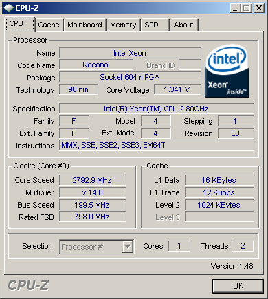

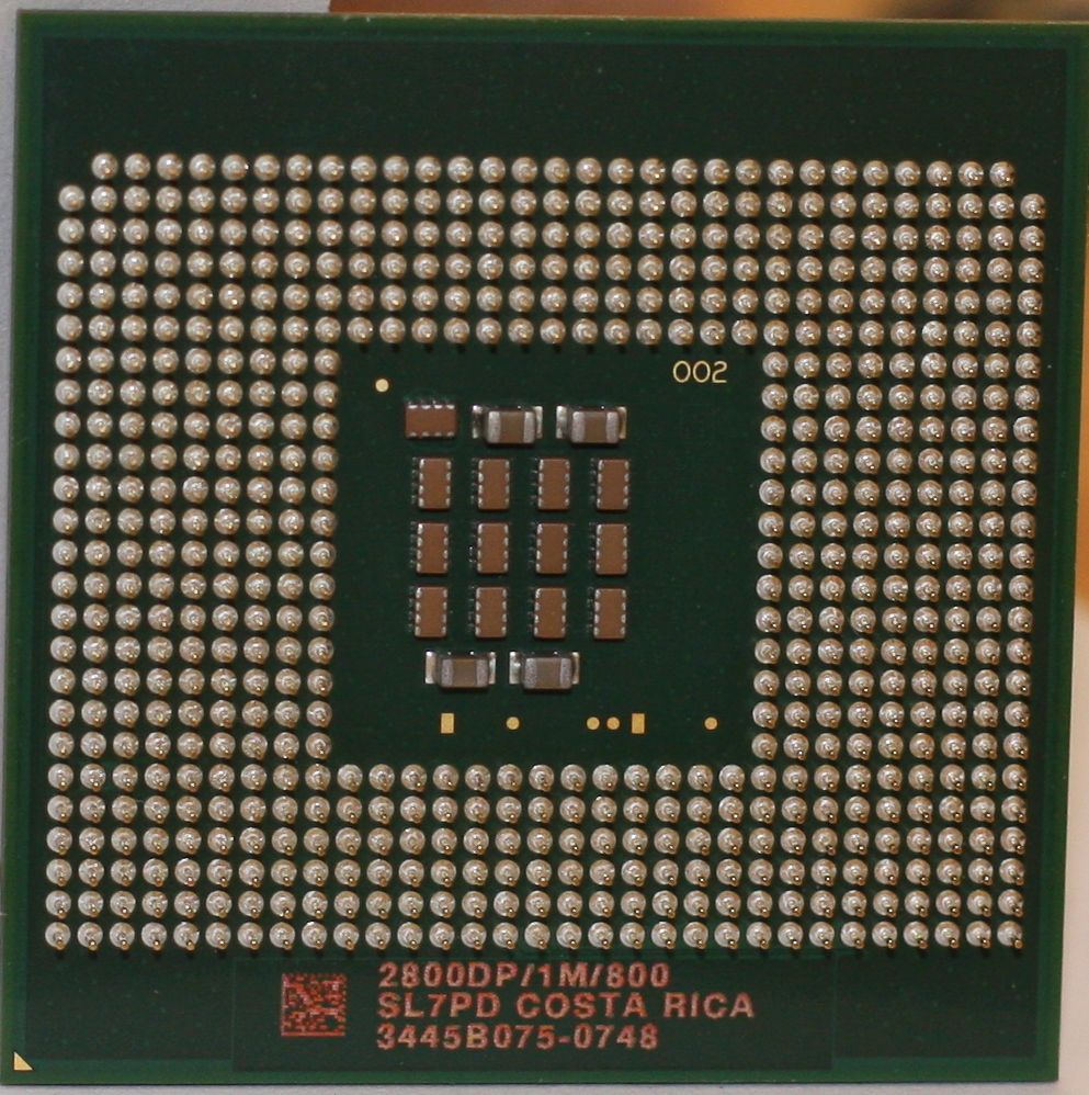

A Dell workstation, dual Xeon capable (Has a Nocona 2.8Ghz CPU installed) The system can accept the newer Dual Core Xeons I am told just by upgrading BIOS to atleast A06...

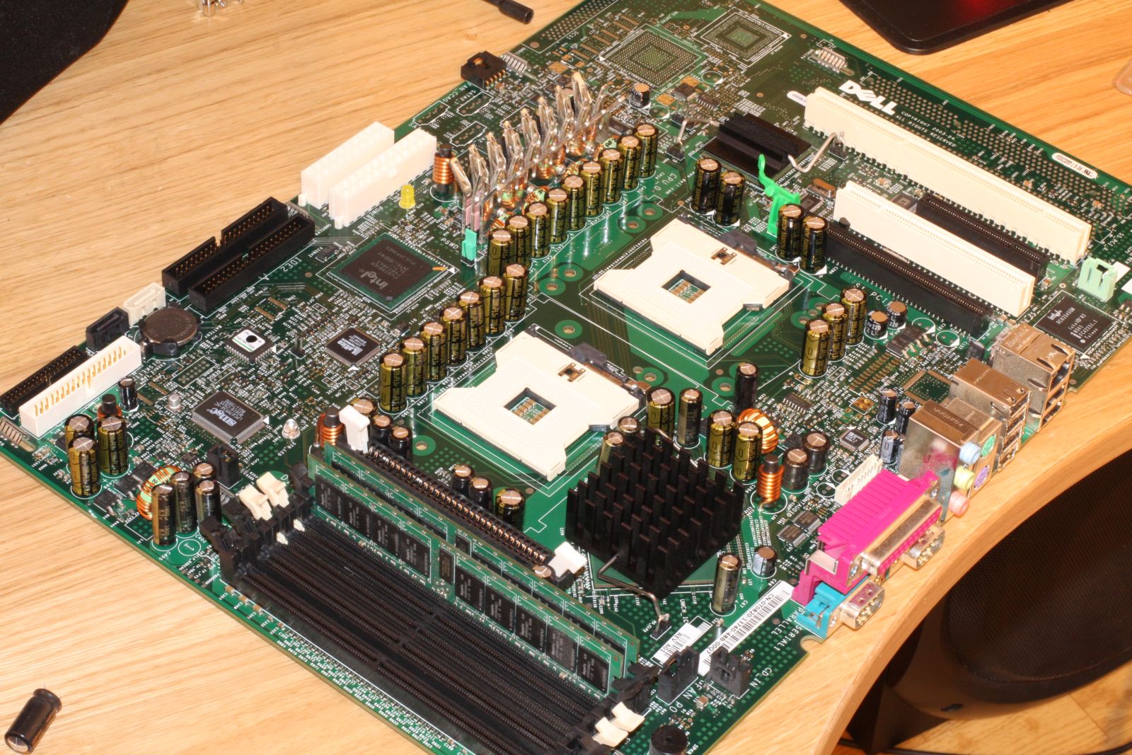

It does not POST, the front diagnostic LED's switch on only LED no 2 in amber, which is PSU fault according to Dell...
Pretty good diagnostic if you take into account what has happened to it's capacitors...
It has 31x bad Nichicon 2200uF 6.3v HN(M) capacitors Manufactured week 22 year 2004 rated 105°C
The rest of the caps are Rubycon and Matushita and they are fine...
I am going to replace the Nichicon caps with Samxon I think, but I heard that Dell changed the caps on this very mobo to solid polymers, does anyone know if they made any other design changes to accommodate for this?
If not I think I should go with solid caps instead, what's your take on it?
In any way I'll need to order the caps because I'm out of 2200uF 6.3v caps...

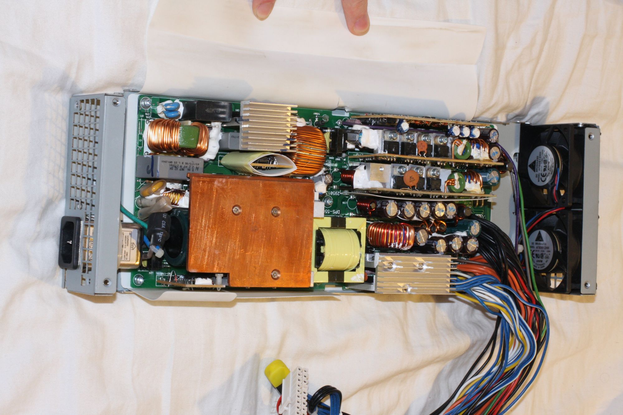

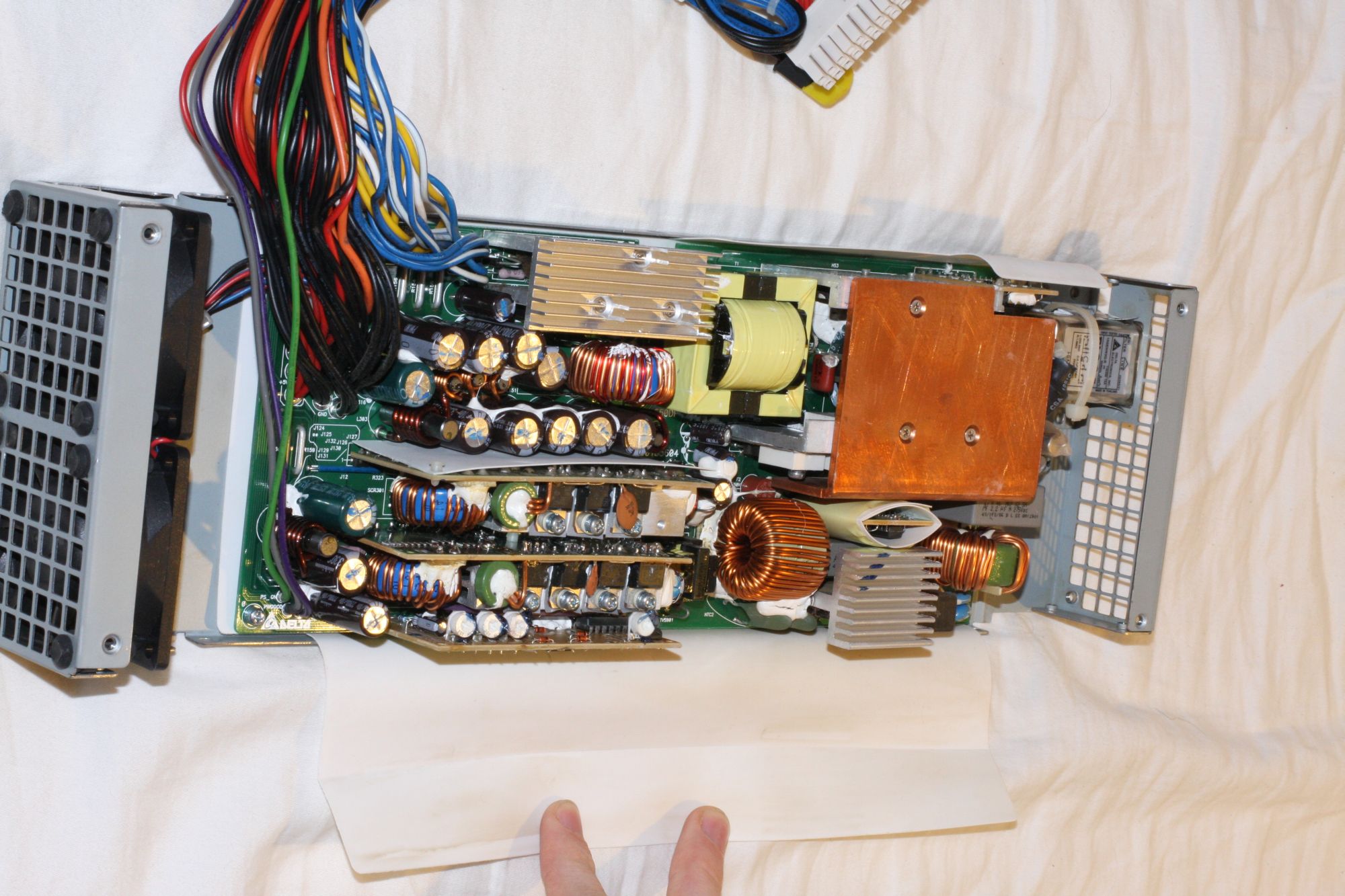

The PSU looks very nice, good caps and very overdesigned (it's rated 550W) Model is D550P-00 P/N DPS-550DB A DELL P/N D1257
