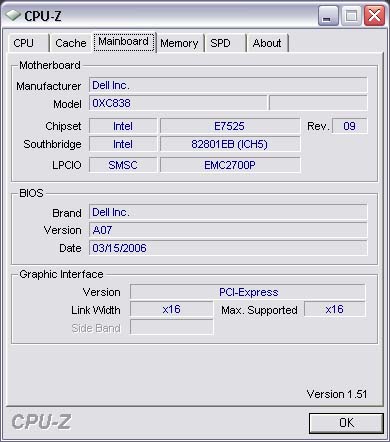

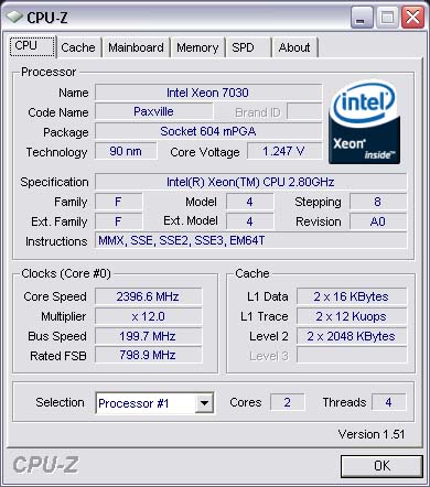

                              The only way a SL8MA Paxville CPU will work on a Precision 470 or Precision 670 is to have a specific motherboard in each. Dell has this way of tweaking their boards for upgrades, but not making all their boards compatible with the upgrade (i.e. SL8MA dual core processor). I had a similar issue a while back with a Dell Dimension 8300 board and have seen many other similar cases on the Dell forums.
                              For the 470, you need Dell Part # 0XC838 or XC838 (same board, but the part # gets interchanged often). You'll need BIOS A07 to make it happen. I just installed dual SL8MA processors in my new XC838 board and my 470 is noticeably faster. It shows up as "Dual Core" in the BIOS screen and CPUZ shows all the specs of the processor, including dual core. I've got hyperthreading on so my task manager shows 8 processors now.
                              If anyone has a 670, you need the XC837/0XC837 board and the SL8MA will work. It's well documented on the Dell forums and it was the similarity of that part # to the 470 board that made me try it out. I couldn't find any confirmation online that the 838 board would work with the SL8MA, but now I know first hand it works.
                              I got my XC838 board on eBay. Seller's ID is totski1970 (run by a very cool guy named "Ron"). He doesn't list the part # in his auctions (just look for his 470 motherboard listings), but he will give you the board if asked. I paid $75 + shipping (buy it now). If you're patient, I think his starting bid is $45 and he's sold them for that in the past. Most other eBay sellers are asking much more than that for the XC838.
                              Ron told me he gets asked often for the XC838, but never understood why until now.

                                #35
                                Re: Dell Precision 470 Workstation
                                p.s. See CPU-Z screenshots attached.
